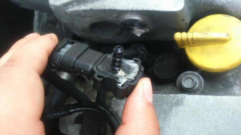

And right on cue, my MAP sensor died on me in the car park, a quick look I discovered this:
The rubber bung was missing so the cheapo previous owner decided to try and use foam sticky pad to remedy the very loose fitting :( ('cause we all know glue sticks to hot metal right?......) so I had a nice mile walk to the nearest motor factors that was open (Mill) and £60 later my 172 was starting like a dream, it also doesn't hesitate low revs like it used to. Also, a huge bonus is that the TC and ABS lights which were on, have turned off! I've also ordered my cambelt, waterpump and dephaser etc so that should arrive soon and I'll have a smooth running, rattle free 172 :)

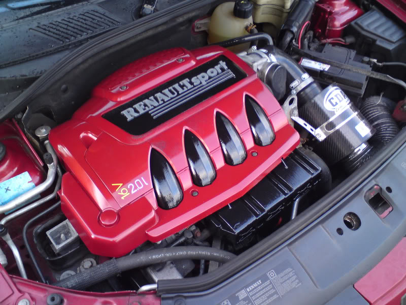

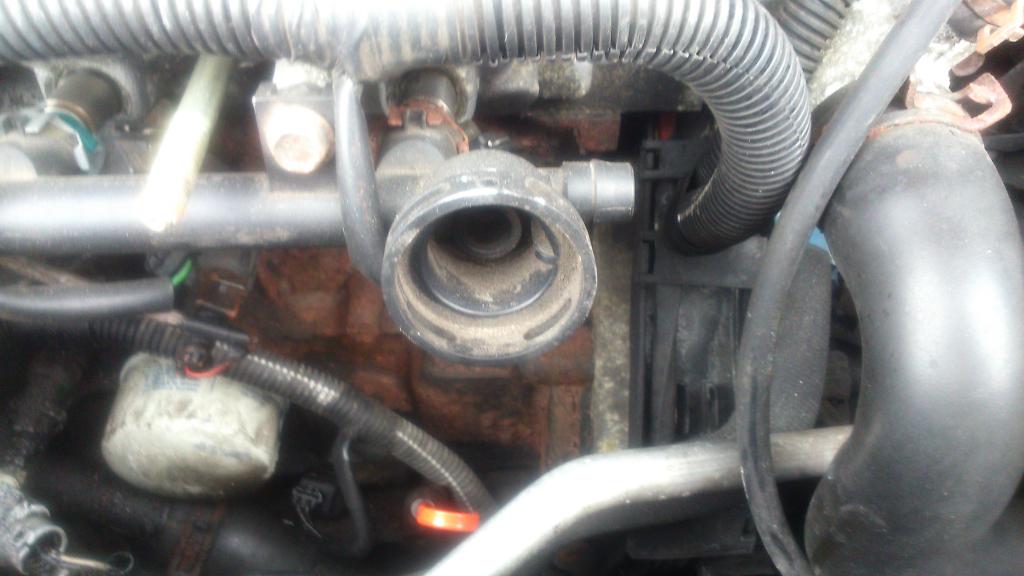

Ok another update in my quest to solve the infamous lumpy idle/ random misfire issue. Decided to service the clio today, opted for NGK plugs, 5w40 Fully Synth. oil and a MANN oil filter. So I took off the injector rail cover to find this:
Am I right in thinking that open hole should not be urm.....open?
When swapping out the plugs I noticed the previous owner again went down the El Grande Cheapo route and put in Bosch Super 4's :( Anyways, put the correct plugs in, new filter, new oil and after the Mrs focus jump started me, the car fired up to it's usual lump idling self. The car sounds much smoother and alot of the noise previously heard from the dephaser has quietened right down?. Plugged her in and still got p0300, tried to clear it but it wouldn't for some odd reason. Turned her off, ignition again and cleared the code, switched her off and that's where I'm at. Next going to try coil pack but after alot of reading, I'm not holding my breath as it could be a huge list of thing casing this lumpy idle and p0300 code. Worth noting it doesn't cut out at all, and will idle lumpy all day long with no other hiccups so to speak.
  Many.
That is where the fuel pressure regulator goes on a Ph1, renault just didn't bother changing the casting.
Depending how bad your misfire is, it could be dephaser/incorrect cam timing anyway. Coilpack/leads are common, as are injectors.
You can't clear codes while its running, thats pretty normal across a lot of cars.
  2003 Clio 172 Sport

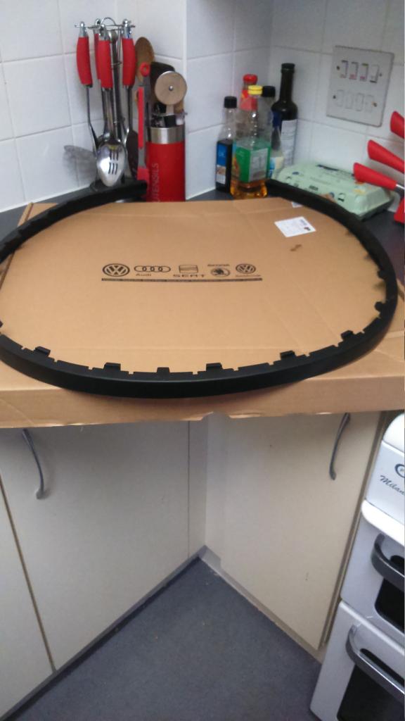

Ok folks some small updates. P0300 code has gone. Haven't bought much in the way of mods just some little bits to keep me ticking as I'm saving for the dephaser, belts etc to be done, most likely by Dan @ SJM. Was toying with the idea of doing it myself but getting stage fright about it haha. The lack of splitter was annoying me and right before forking out for a Renault item, found the posts about fabia ones. So picked this up for a mere tenner:

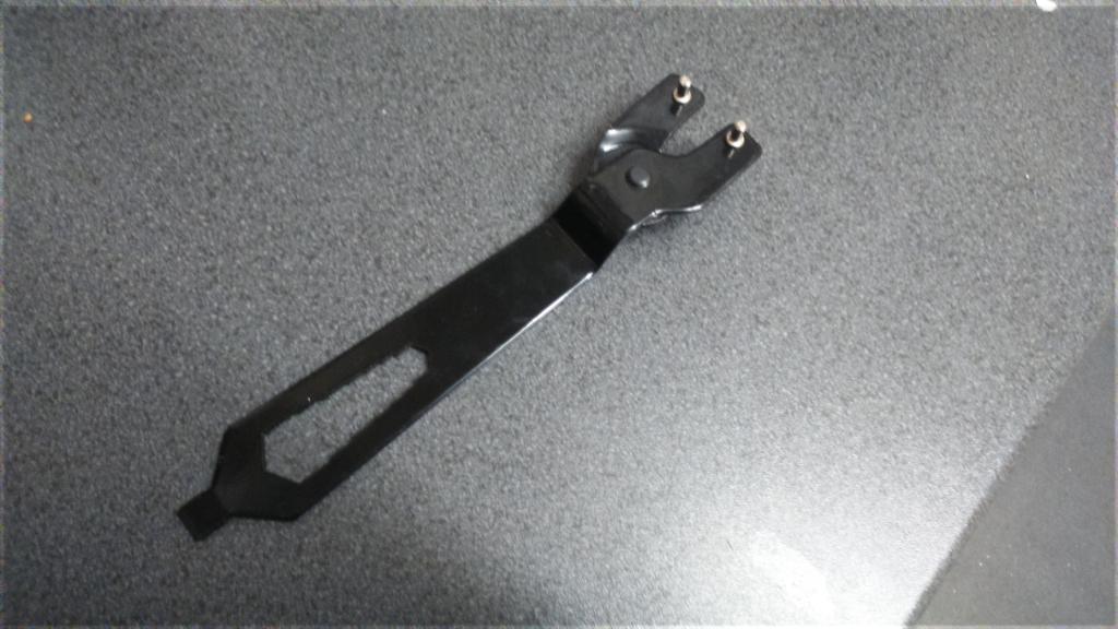

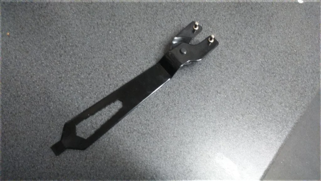

Want some decent weather now to get it on :) Also the mrs pads and discs needed doing, and the clio came with some pads so thought why not. I remembered how annoying it is trying to wind a caliper back with pliers so thought I'd give this little gem a go:
The head is adjustable and the handle has stepped increments to make an all in one spanner. Only £3 so if it's pants no bother but if it works, happy days :)
