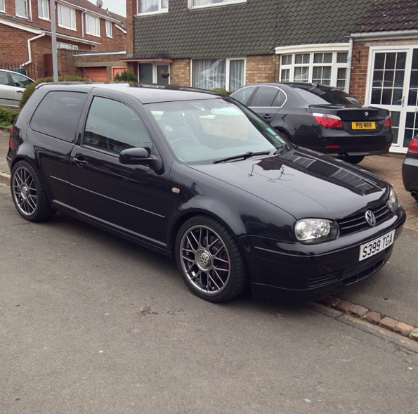

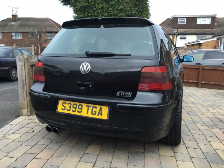

Tints were removed by my cousin before I got it :) although I liked them IMO the black on black look is awesome. The pic was taken in late August last year. Planning on getting more pics up later tonight but its in a garage so quite hard to get good overall pics of the car.

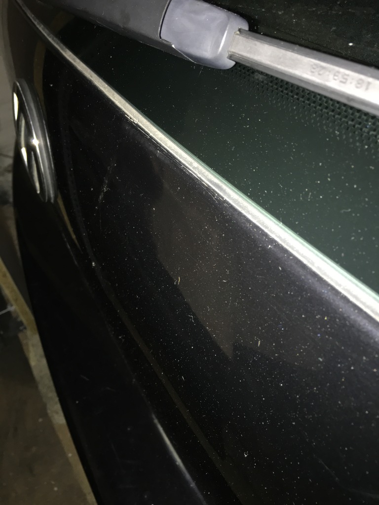

Crappy paint chips on the side of the car:
I reckon it was sprayed over at some point but not cured as there is orange peel.

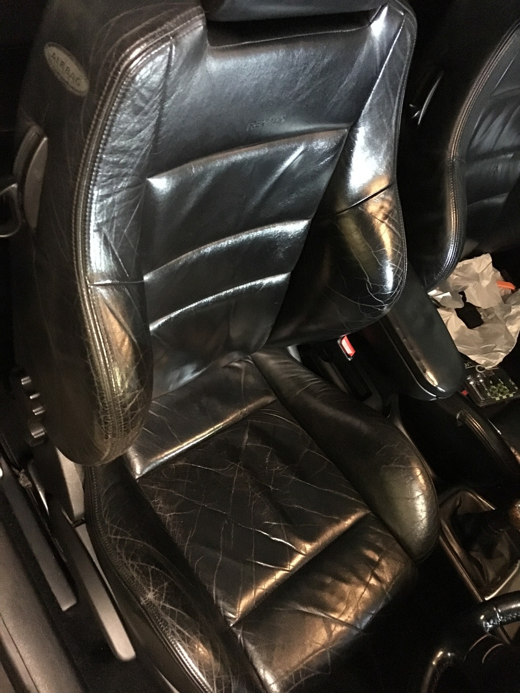

Crappy crack marks on nice leather recaros:

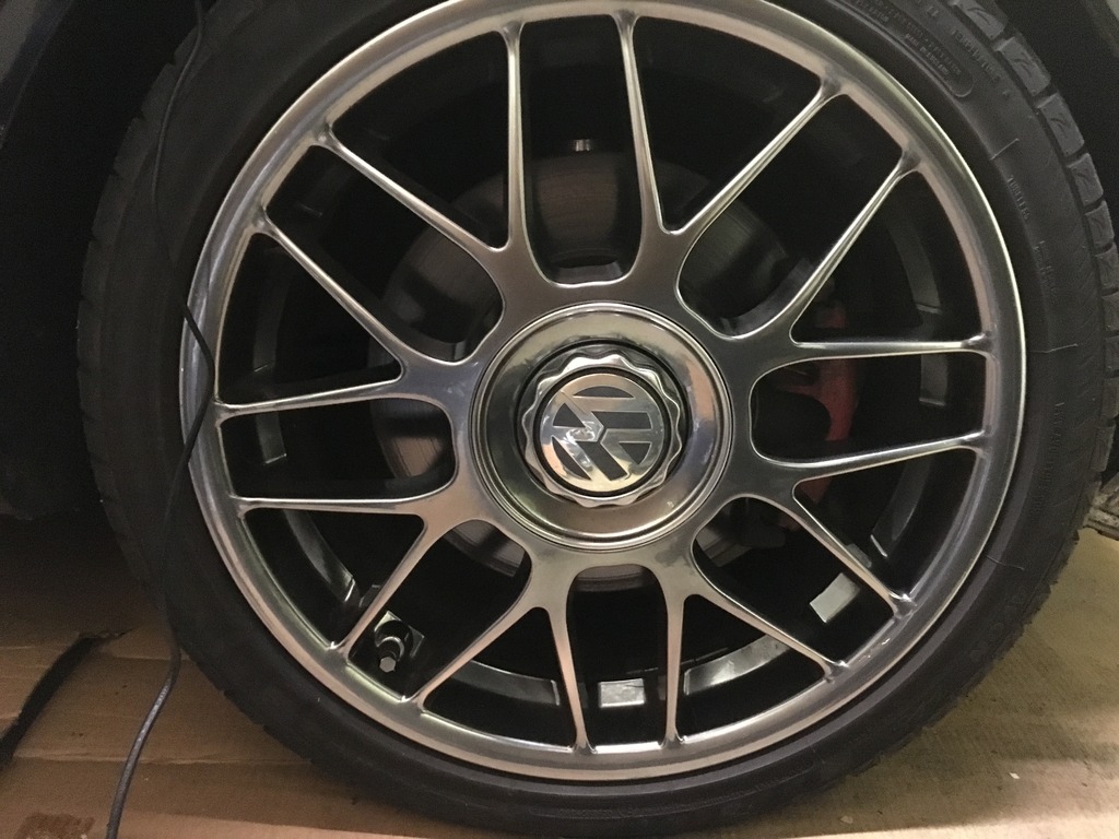

Crappy centre caps stuck on wheel:

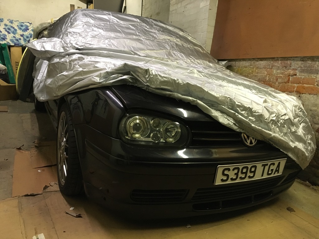

Those lights are gash, makes the car look surprised, like it's seen something that's upset it.
they don't look that bad when the cars uncovered (see very first pic at top) tempted to either spray the chrome black or to tint them darker slightly to make them look less bright.

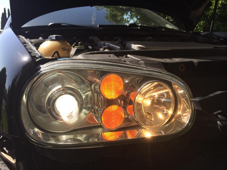

They arent genuine MK4 Xenons as the genuines do not have have a spot light built in. They have two indicator lenses instead as shown below.
JonnyK
Honorary Member
  500 Bhp Golf R 7.5
^^ i'm confused. Are you saying the lights you posted are different from the OP's? they look the same to me!
  RS4
They are different. Look at the picture I posted. It has two indicators built into the headlamp. Now look at the pic the OP posted - they dont have the two indicator lenses built in
The ones I posted are factory optional Mk4 xenons which are standard on the MK4 R. It looks as though the OP has aftermarket project headlights.

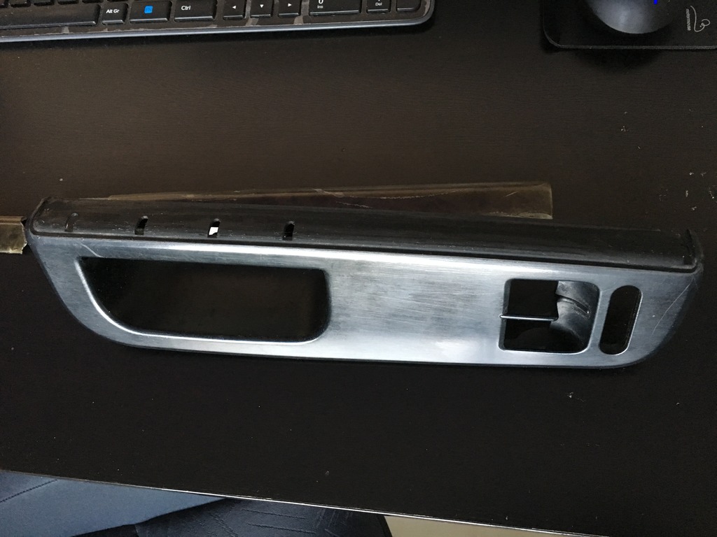

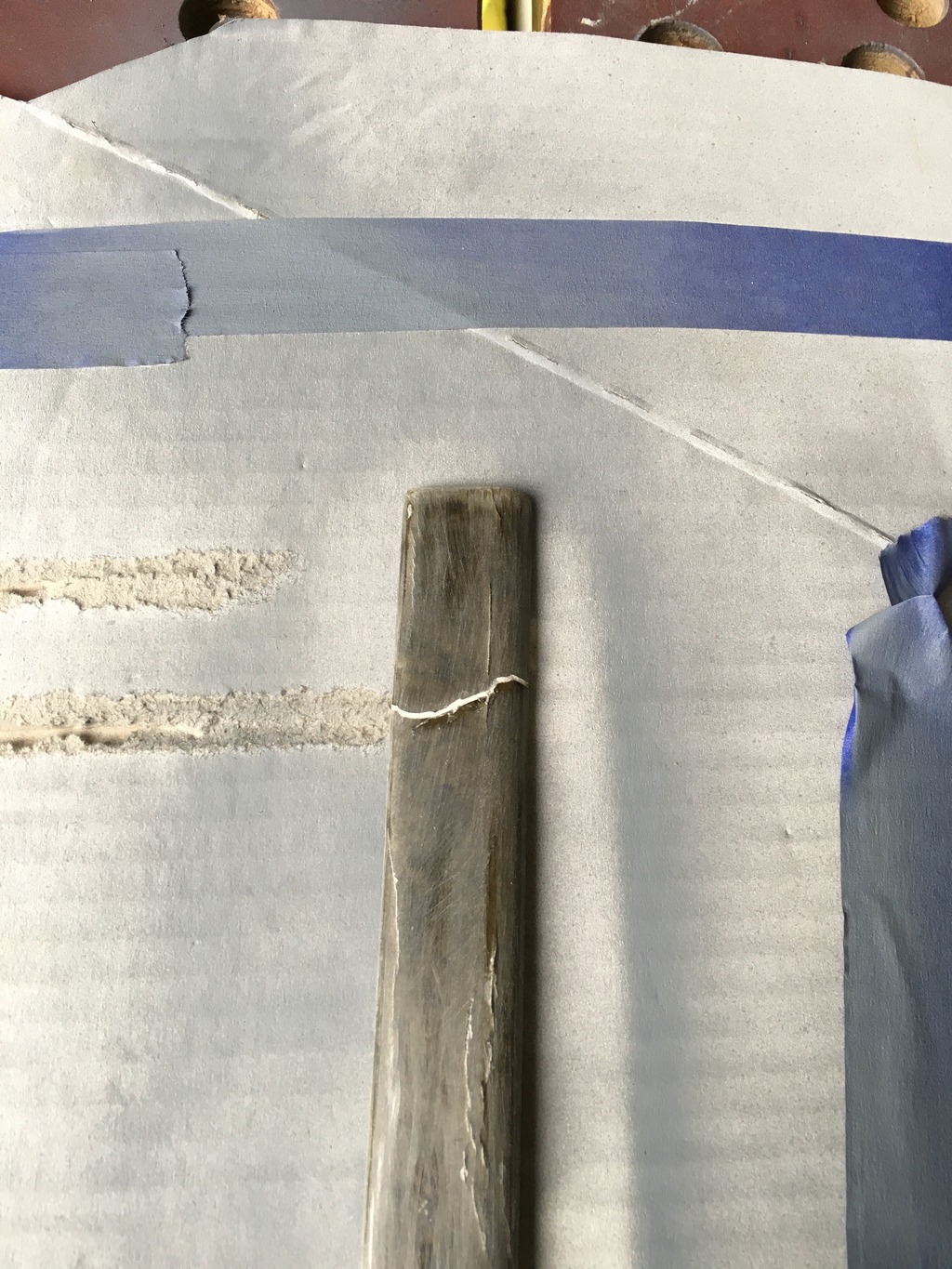

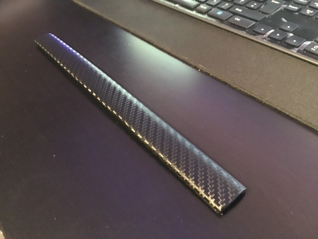

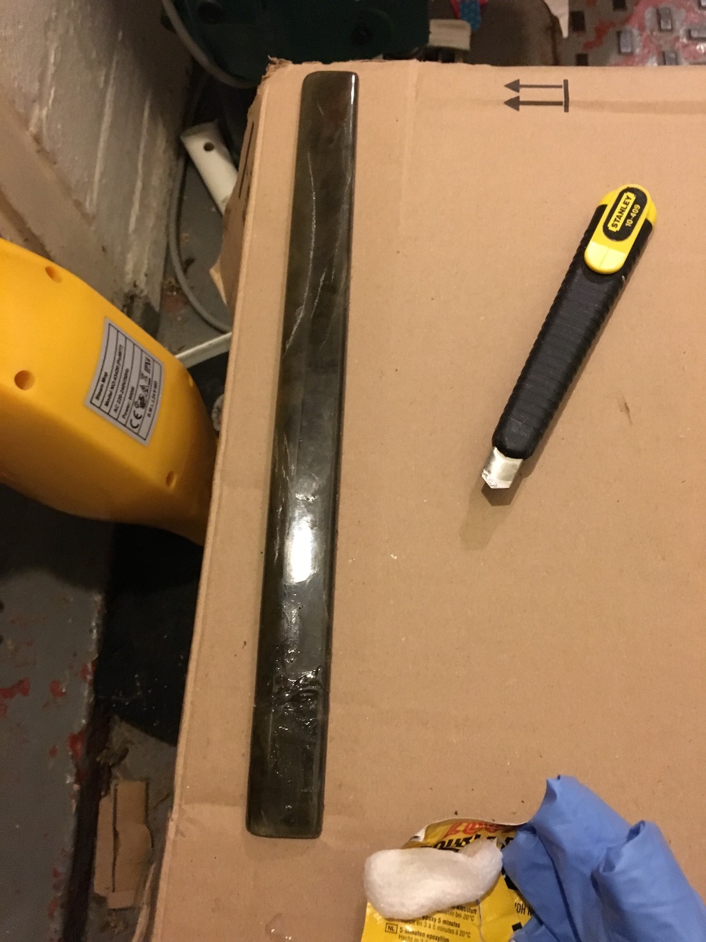

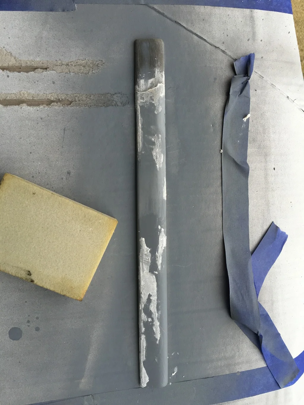

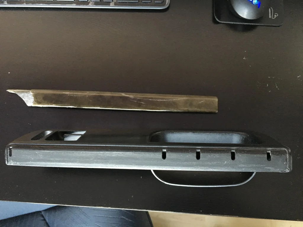

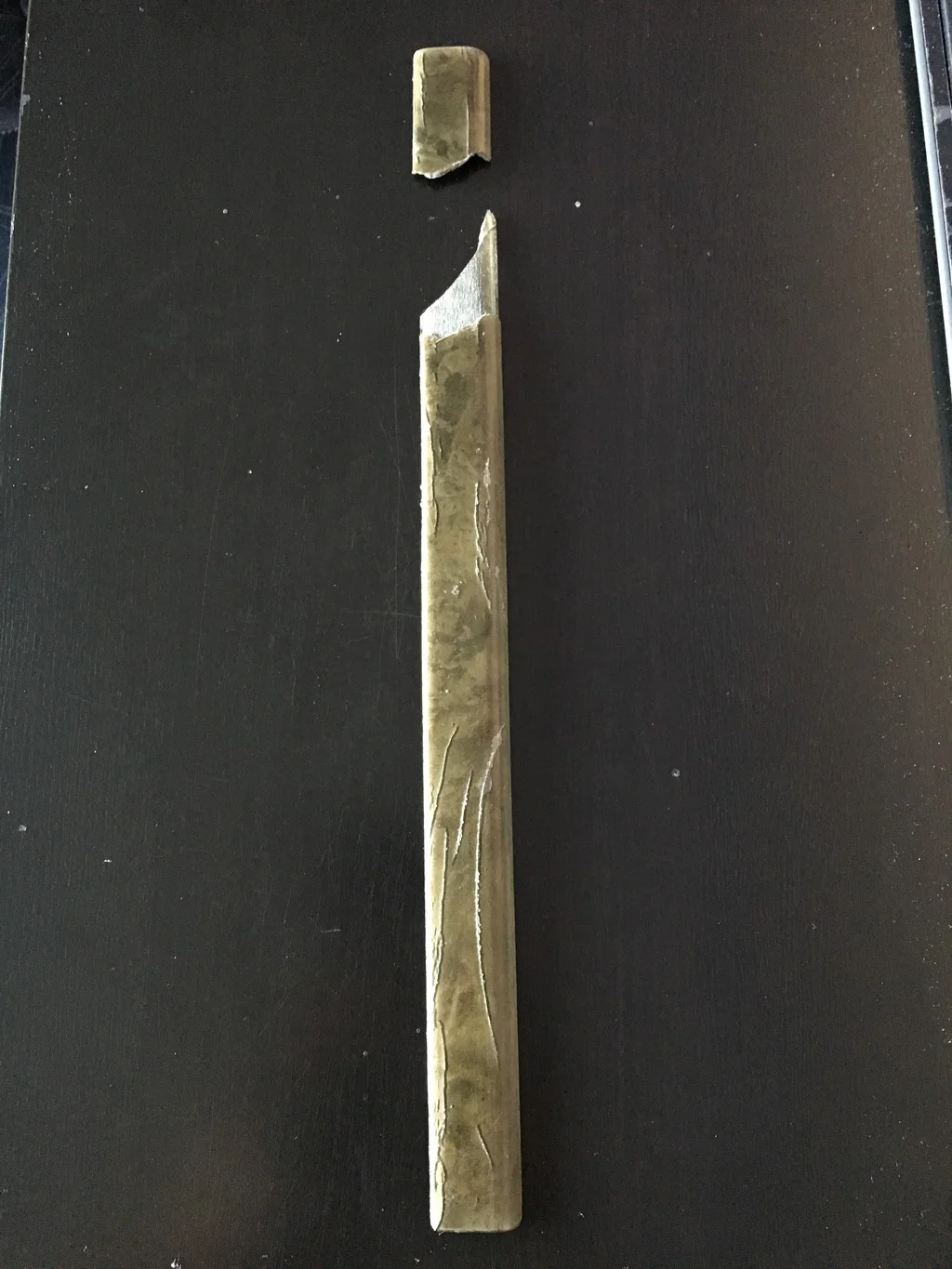

So it seems that I have the only golf in the world with trim on the drivers side interior window switch thing. Being unsuccessful at finding a suitable replacement for cheap I decided to repair the trim I had.
To begin heres the broken piece and the door trim.

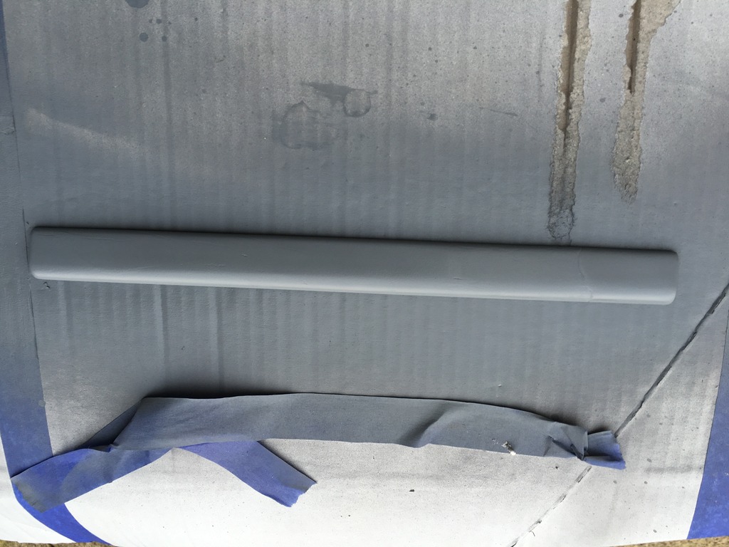

I used some epoxy to stick the trim back together and to make sure it bonded properly so that it reduced the depth of the crack (hehe 'crack')
I then proceeded to use light filler and sand gently the surface so that any cracks or marks were removed.
Rince and repeat...
Sanded back and primered:
This is where the pics ended for the prep work.

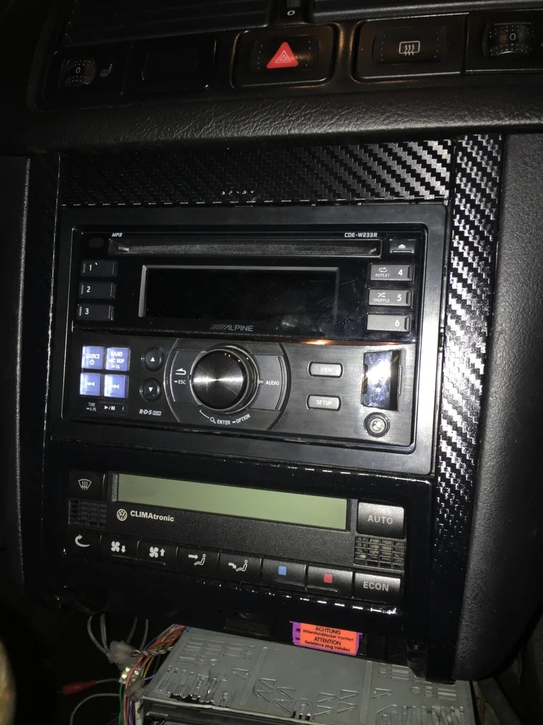

You're probably wondering about the finish I am going for and that is 3M Carbon vinyl. Generally piano black finish is my favourite but it looked so boring in this particular interior so in goes the carbon!
All done ready to go on:

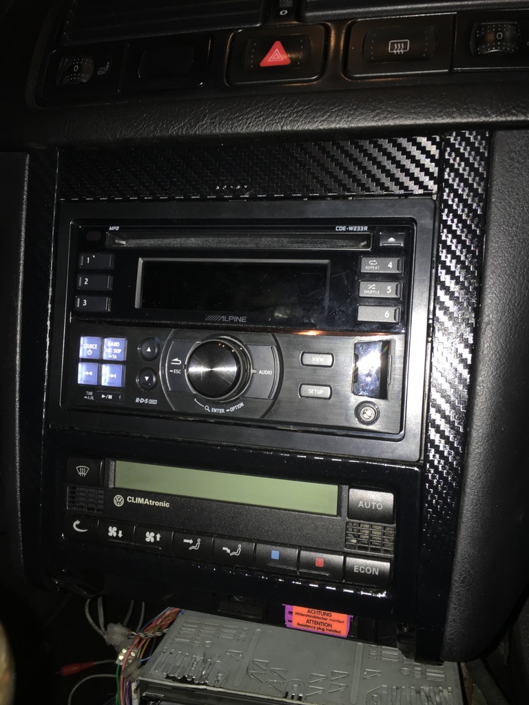

Also decided that the trim might aswell be refurbished:
[/URL][/IMG]
Where it stands:

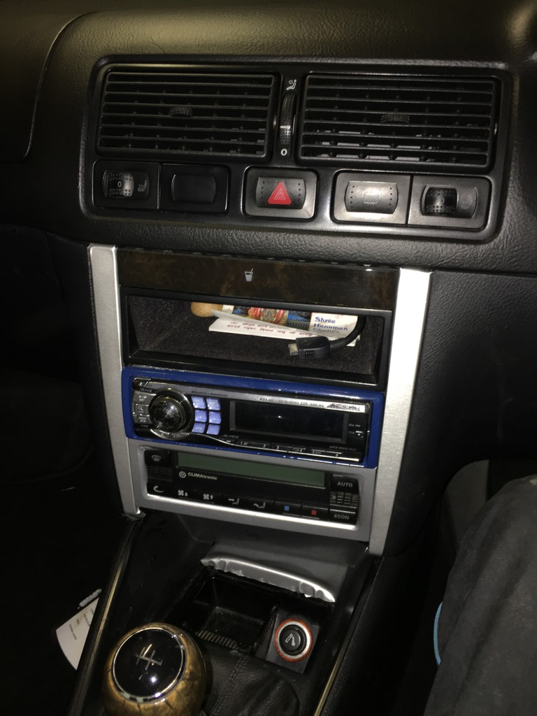

Because I'am maddeningly in consistent here's a pic of the new dials I picked up for the Golf. Being from 1999 it does feel dated but these bring it up a little bit.
M90SR
Having gone with carbon fibre interior accents I also pondered with the idea of spraying the wrap in gloss to give it that gloss carbon mclaren look. Needless to say I failed but it does/doesn't look that bad. Most of the CS lot would not approve of the carbon and would say gloss black well with the sprayed wrap you get both.
Heres a pic of the cup holder done in just wrap and has NOT been sprayed, and the bottom A/C controls wrapped and sprayed:
What you thinking?

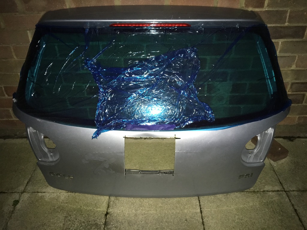

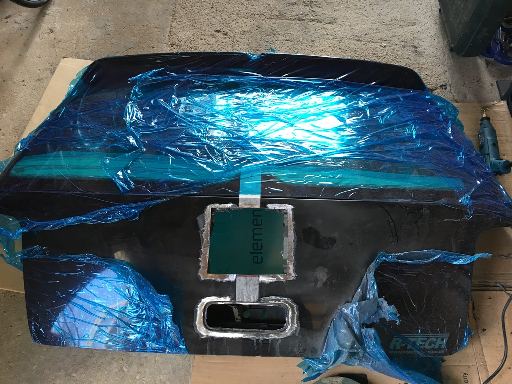

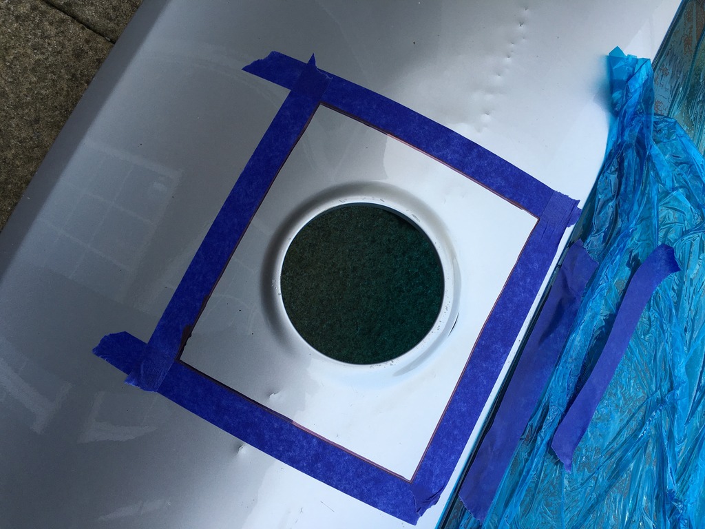

So been a while since I have updated been busy doing the one cosmetic mod I think all MK IV owners should do and that is the MK V boot latch mod.

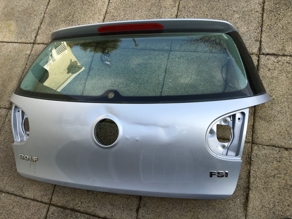

I didnt intend on doing this mod the opportunity just became available. Basically my good friend had a rear end shunt in his MK5 Golf so naturally the first thing you ask is how much he'd part the boot for. To which he then just gave it to me (not like that) through his back door (literally).
So I had the full setup MK5 boot lid with mech and wiring harness (which you dont need).
Wasted no time stripping and cutting. Using precise measurements I set about cutting the boot latch mech out.
Anyone want a MK5 boot lid? Got a small hole in it Im sure a little T-cut will sort it....

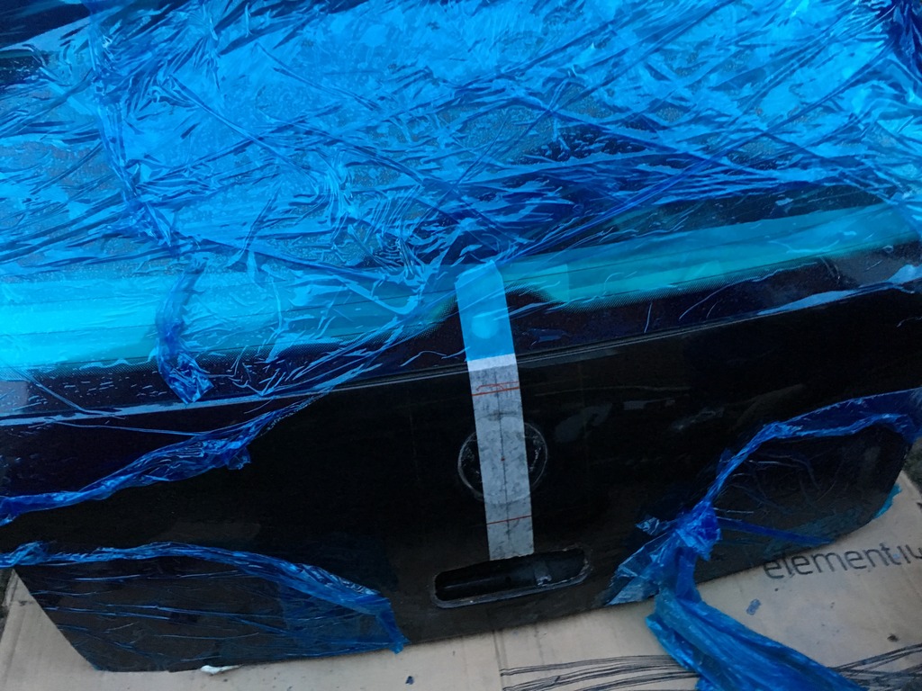

I started my marking the centre line for the boot. The masking tape was used only for me to write on it has no other purpose in this.
Skipping ahead to when the cutting was done and some grinding (not like that) to place in my mates garage.
So I like to try things myself so I can learn and to understand the work involved. I did the welding which was not bad but not good enough (I didnt know at the time) so I continued with body filler using fiber glass filler to build up the strength. Then handed it over to my body shop guy who done the welding properly and filled and painted the boot.

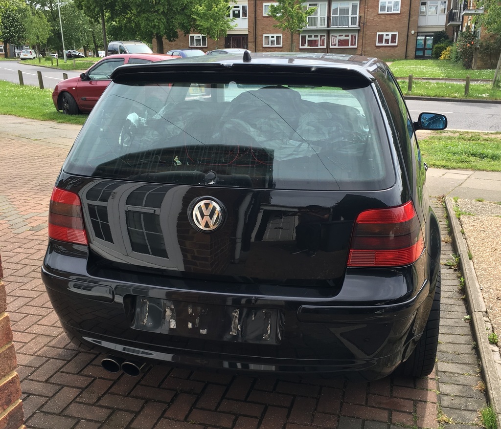

The finished result:
The badge has to be replaced with the original MK4 one which a 3d plastic looking one whereas the MK5 one is a GEL sticker kind of thing and it looks bad.

Anyway, loving the rear end, never seen that MK5 rear boot mod. That's great. Finishes the rear off nicely, good work. Good to see the tints have gone.
