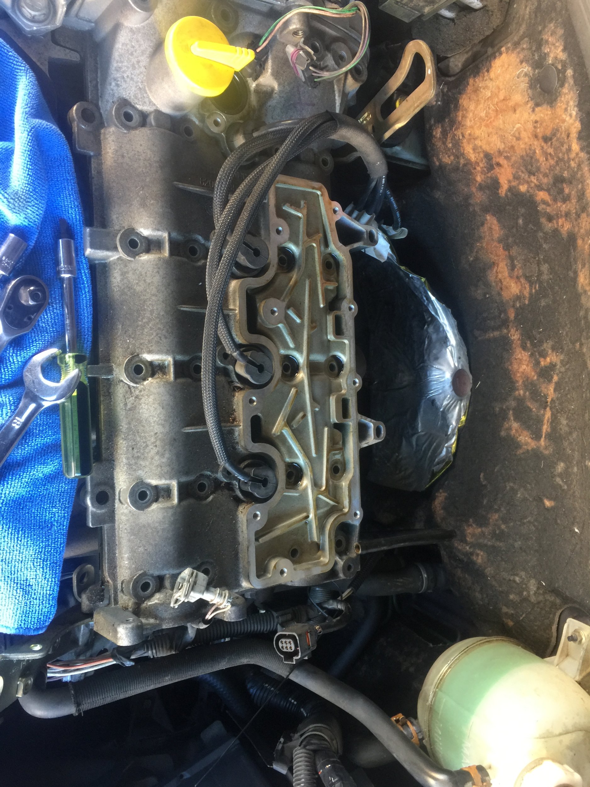

hey everyone i was thinking of doing my rocker cover on my 172 clio 2.0L 16v, i can't find a lot of information on it. i would love it if someone has a tutorial how to take the rocker cover off. my friend at work told me i have to take the timing case off. any tutorials for anything to do with motor or timing belt would be amazing. looking for workshops manual for clio 172 2002 2.0L 16v too.

The cam cover holds the cams in place mate, so it's not just a simple case of undoing all the bolts and lifting it off. It's a full cambelt and pulley job off too, and looking at your picture you're now going to need the cam cover resealing.
Welcome to the world of a £450 bill to sort it. You would've been better off cleaning the cam cover up in situ, masking it off and painting it as is.

if that's a picture of yours then i'd be getting the bolts back in before you start messing around and end up in a bit of a mess :wink:

thank you for the advice but i am looking for tutorials
