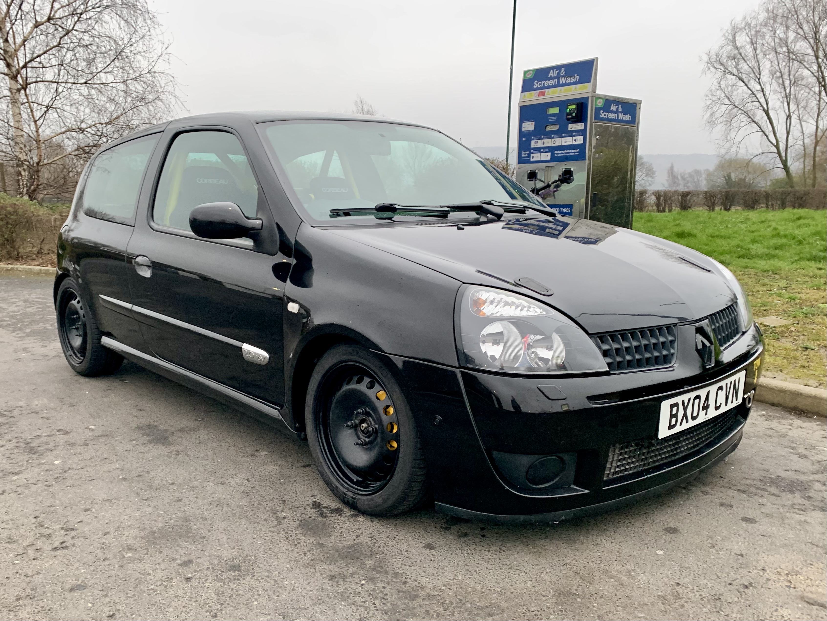

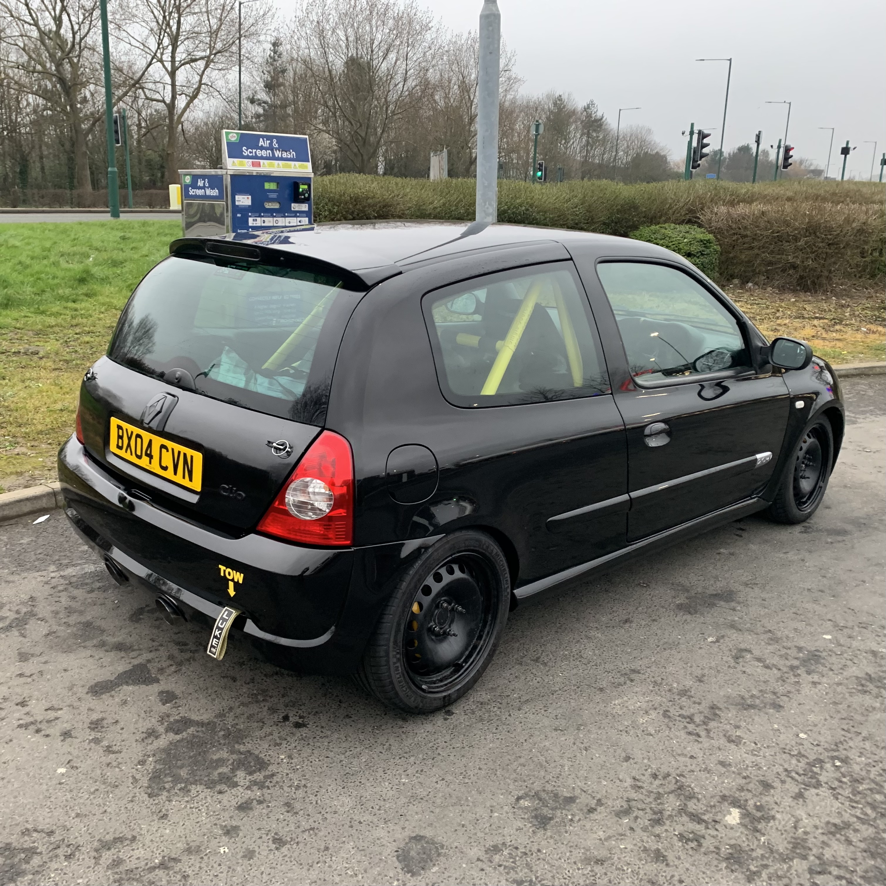

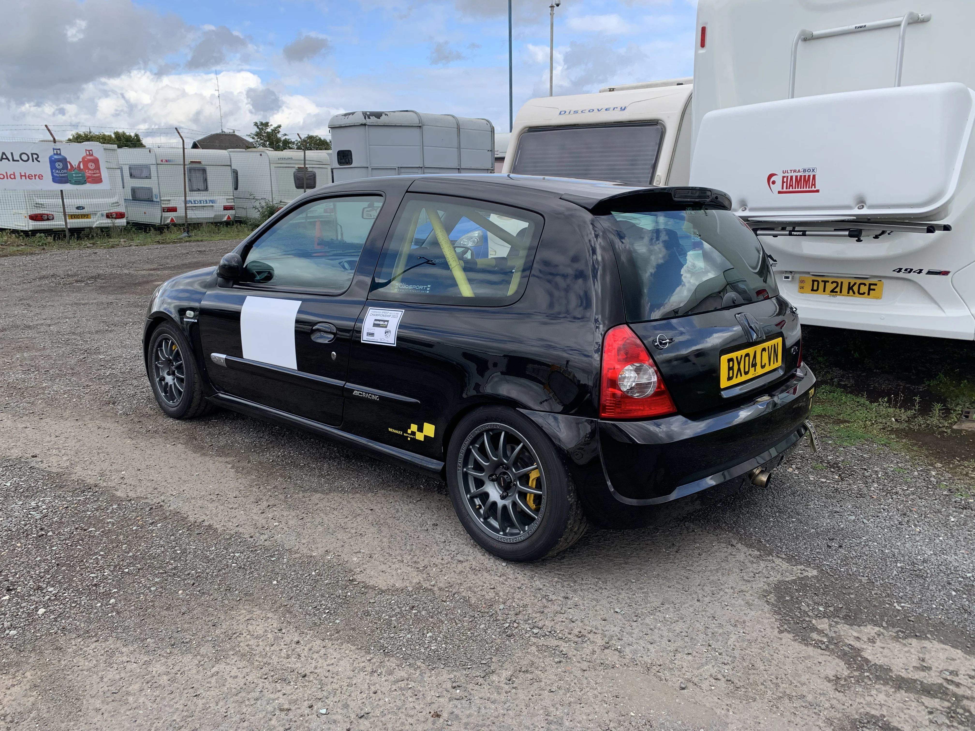

Great day at Croft, although we were having so much fun we never got any pictures 🤦🏻‍♂️
Here‘s one from the arse end on the way.

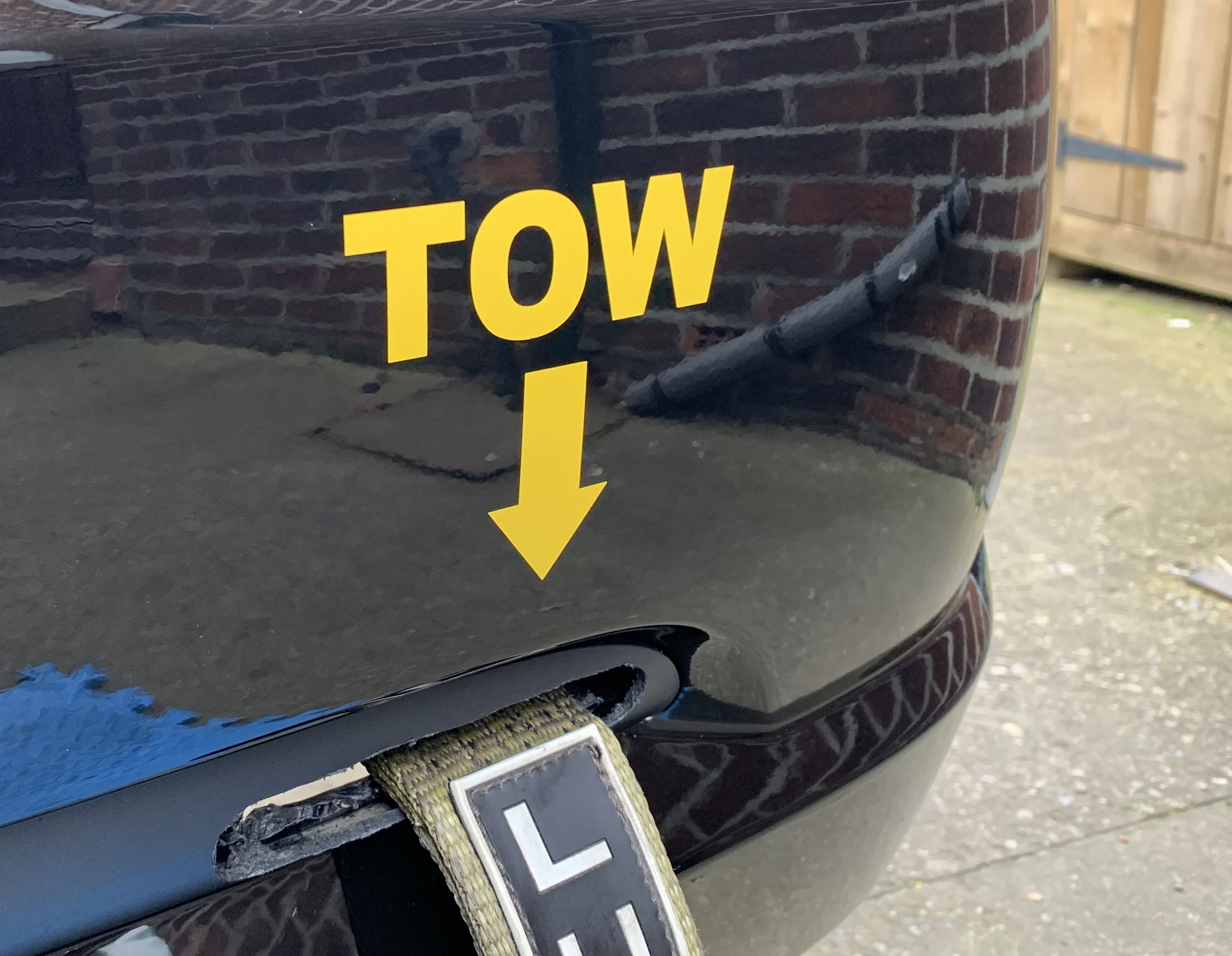

Met @SharpyClio for the first time. Good to meet you fella and thank you for the loan of the towing eye. We got sorted in the end.
@Brigsy popped in with his missus and Bumblebee 225 and we had a good old natter.
Lots of fast machinery there today and a ridiculous amount of Red Flags. Never known anything like it, which just goes to show the lack of talent that turn up to these events these days. It’s a bloody track-day for god sake.
Anyway, back to the car.

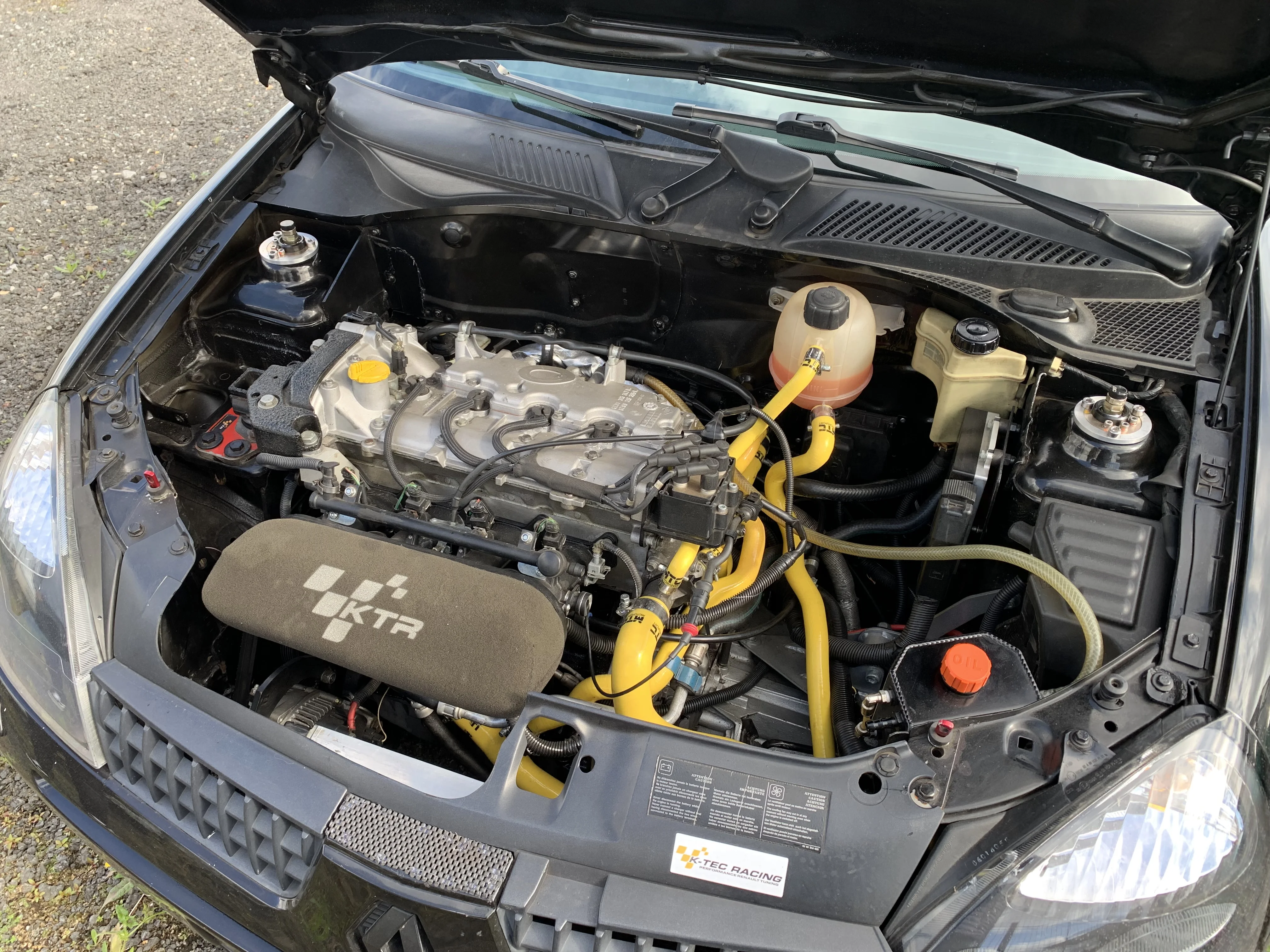

Engine : Awesome. This is a seriously fast Clio and I mean fast.
Gearbox and Gripper : Brilliantly set up and you can get all the power down.
Steering : Garbage. I’m going back to EPAS
Suspension : If I hadn’t of had my other circuit car I’d have been happy, but it’s just not set up for my tastes.

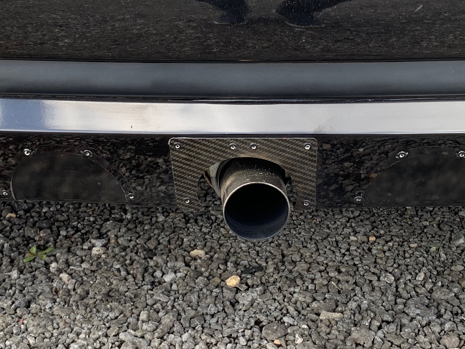

Exhaust : 97 decibels at 5,500 rpm. Happy with that.
Driver : s**t. I’ve gone back over 😂

What's the engine spec again mate
Wossner Forged Pistons 12.8:1 (83mm)
Catcam Performance Camshafts 421s
Wossner one-piece Uprated Valve Springs
MLS Head Gasket / Seal set
Cylinder head Clean / De-coke
Hydraulic Lifter set
Head Bolt Set
Arp Con-Rod bolts
King Crankshaft Big Ends
King Crankshaft Mains
Crankshaft thrust washers
Keyway crank
Jenvey ITBs (45mm)
220.6 bhp/178 lbs ft torque

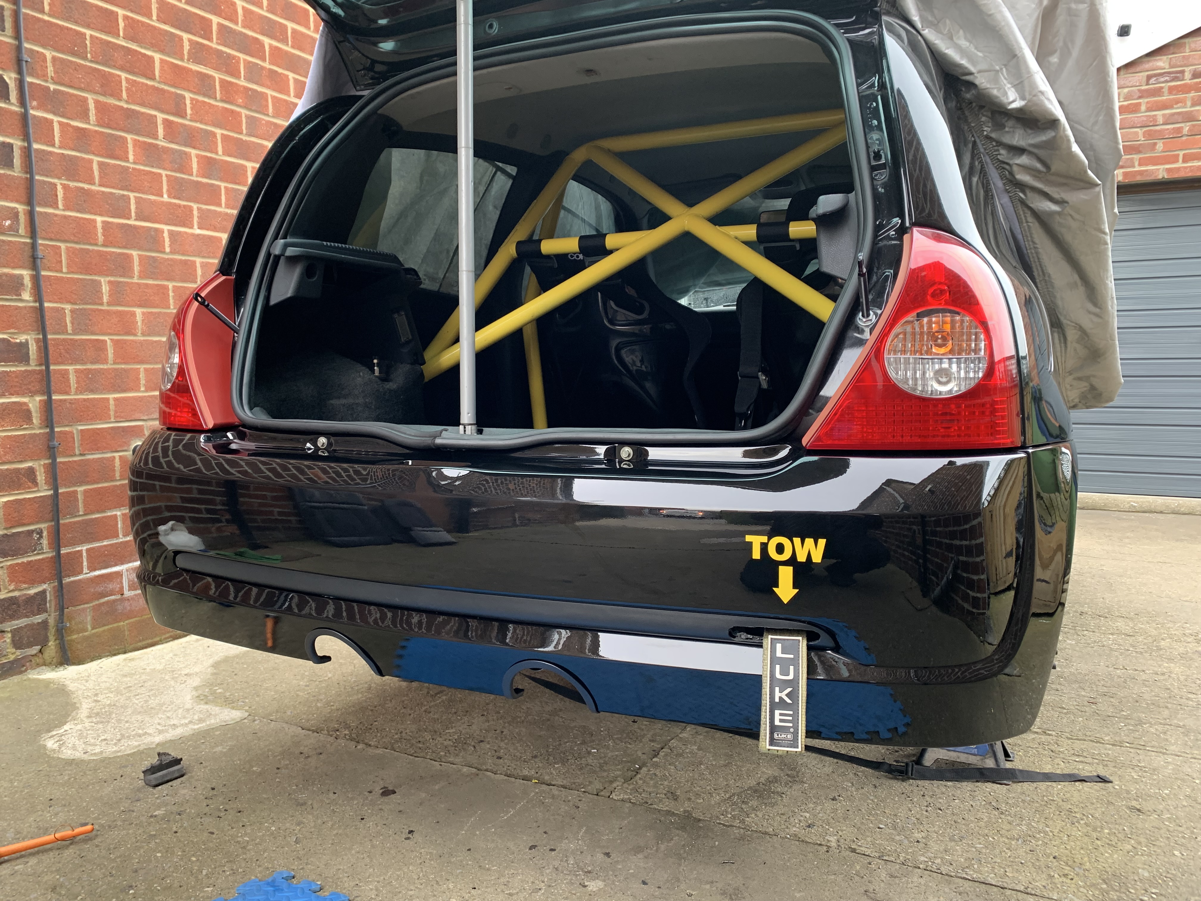

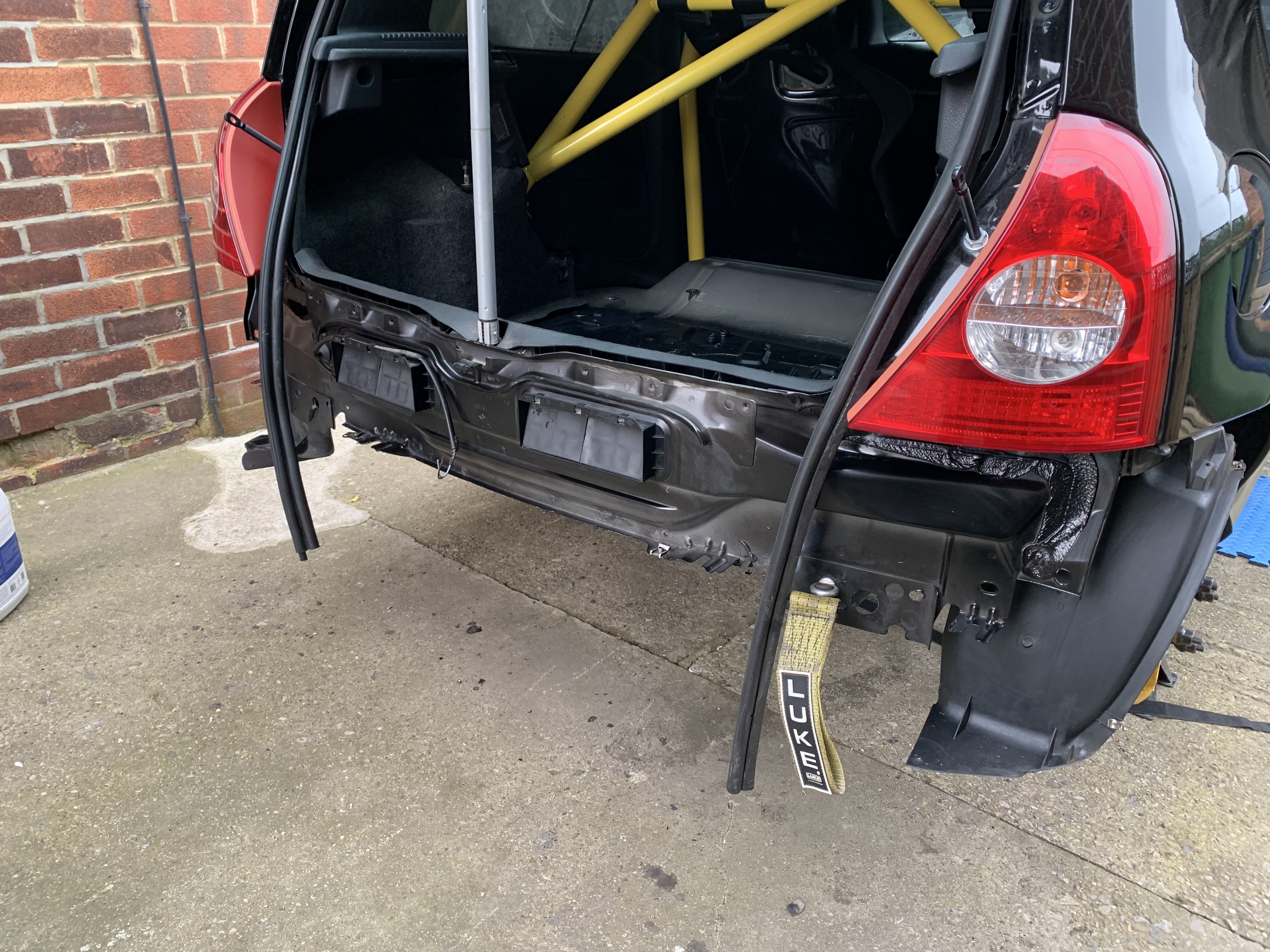

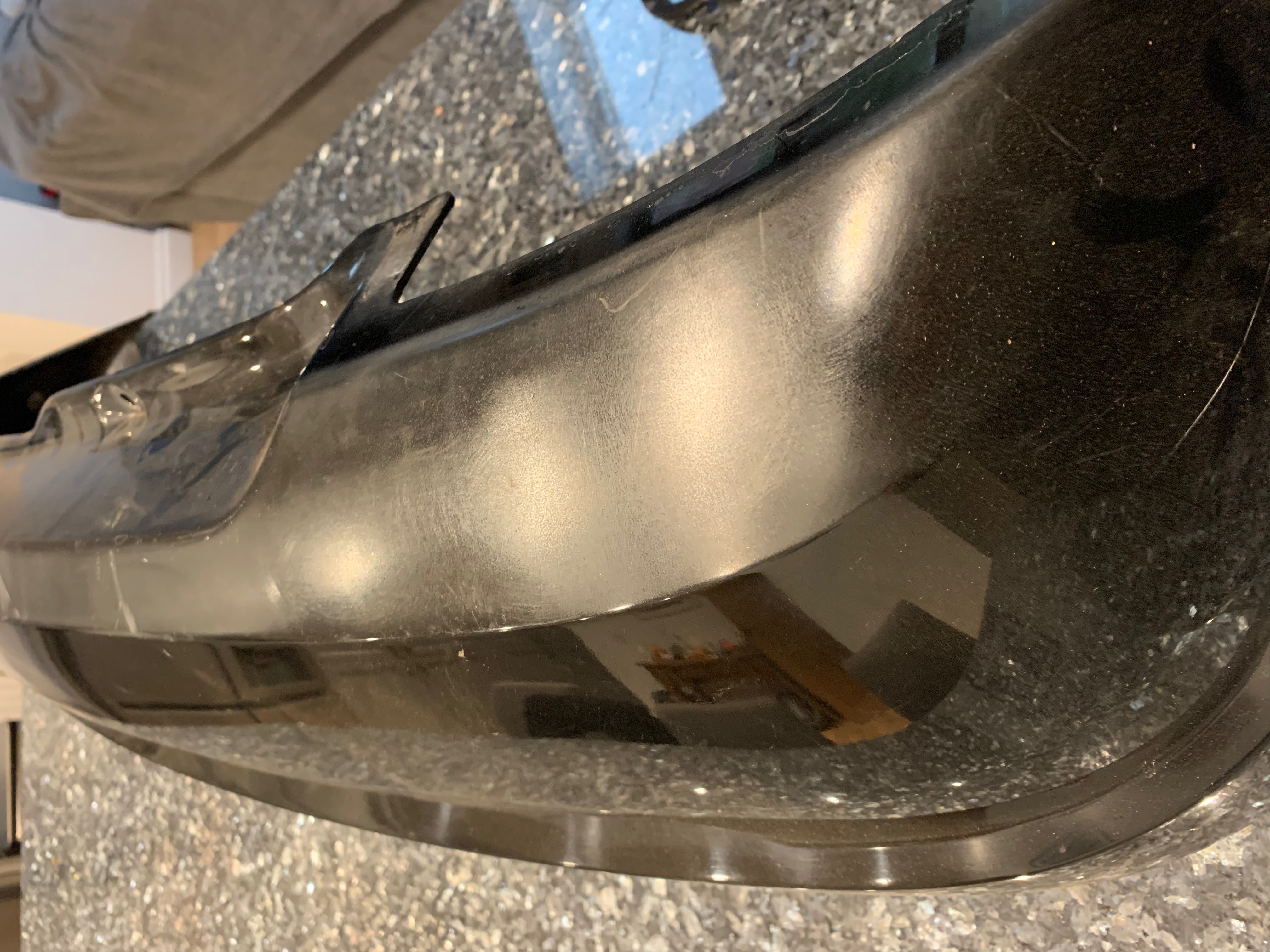

@Mr Underhill Remove the tape on the Bumper?. :)
Just there as a precaution as there’s a bit of wear on the quick release mechanism that holds the bumper on.
It causes the ends of the bumper to lift slightly and whilst I’m sure it’ll hold without the tape, I don’t want to be that guy who halts a trackday session if a Marshall thinks the bumper is falling off.
I always call the TDO over to discuss anything like this before hand, so if he’s happy, I’m happy.
Unfortunately the tabs inside the arch have been removed, so it’s not like I can put a u-clip in there and a bolt to secure it. I quite like the tape to be honest because #Trackcar

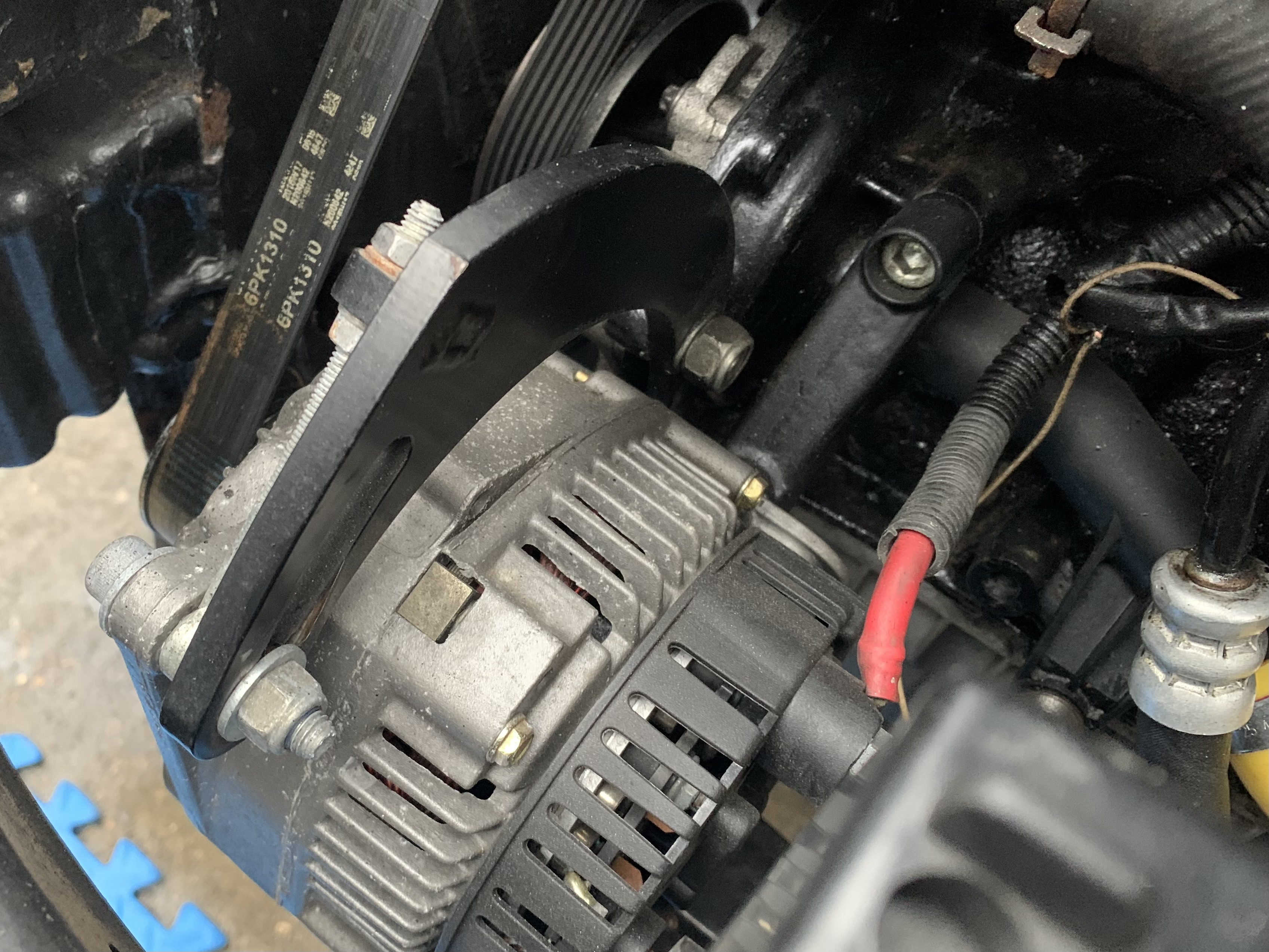

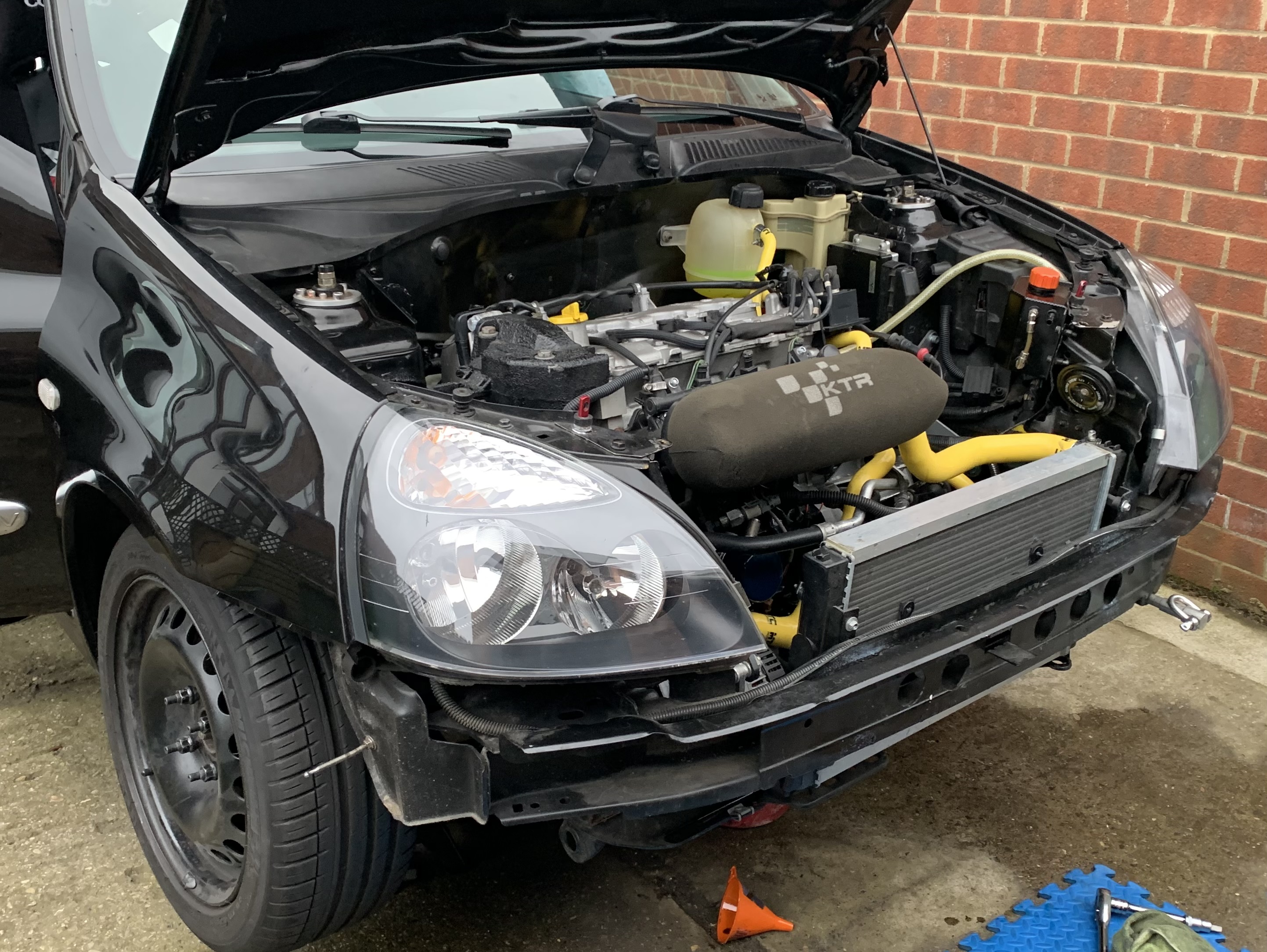

A bit of a mixed day. Spent the morning putting the 172 Cup delete kit on, but all the while I kept thinking it was going to be tight with my new radiator.
I went for a fabricated Aluminium rad from Pure Motorsport. Tis a thing of beauty 😍
Began cutting out some of the metal to make it fit and damn, the pas pipe and bracket get in the way.
It’s not out by much, an inch or so.
Even if I get a custom high pressure pipe made, I’ll still need to cut a chunk out of the bracket, which isn’t an option I want to take.
Oh well, these things are sent to try us. Tools down, hot bath and a cup of tea me thinks.
Thank you for reading.
Mr Underhill

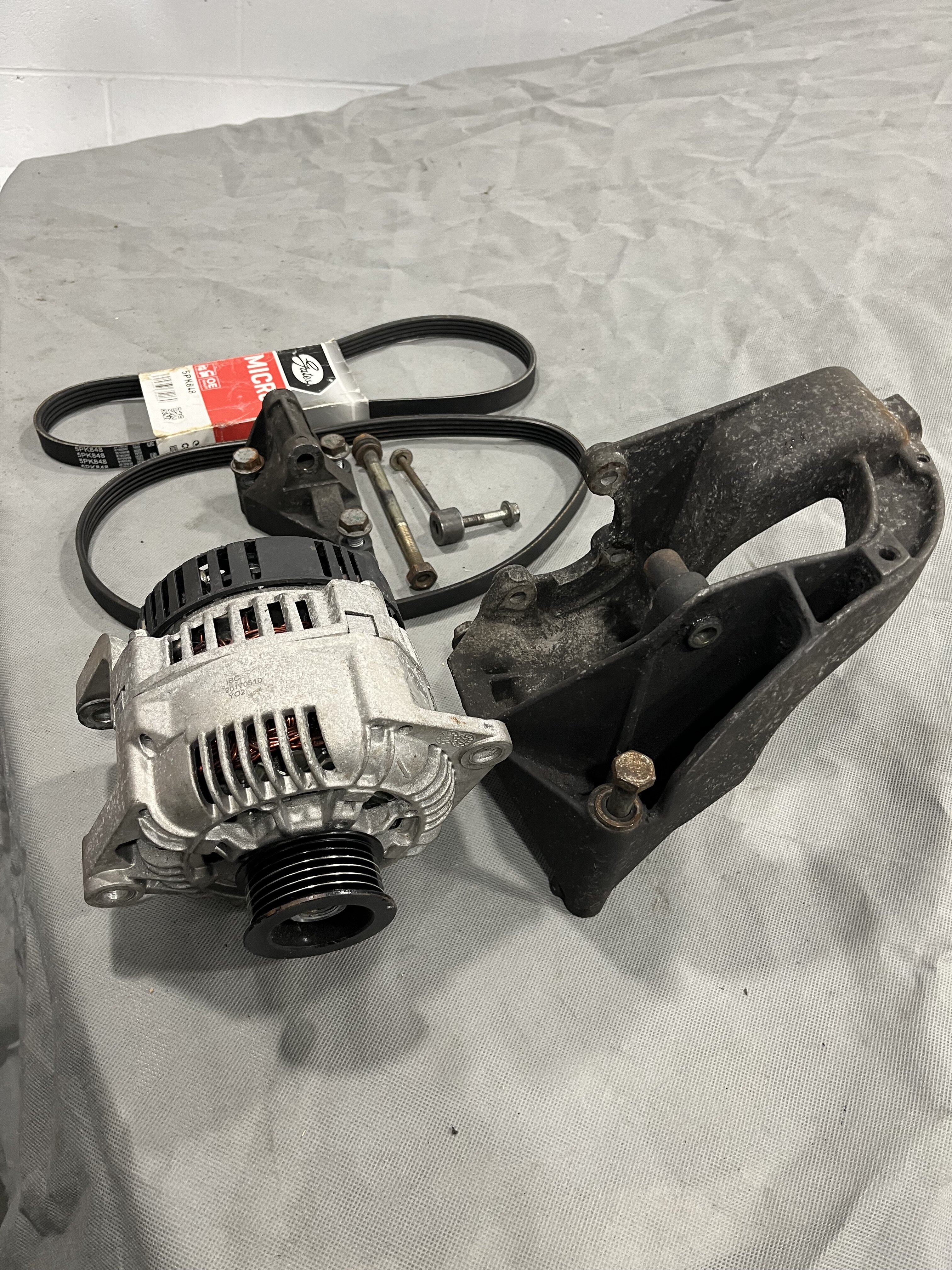

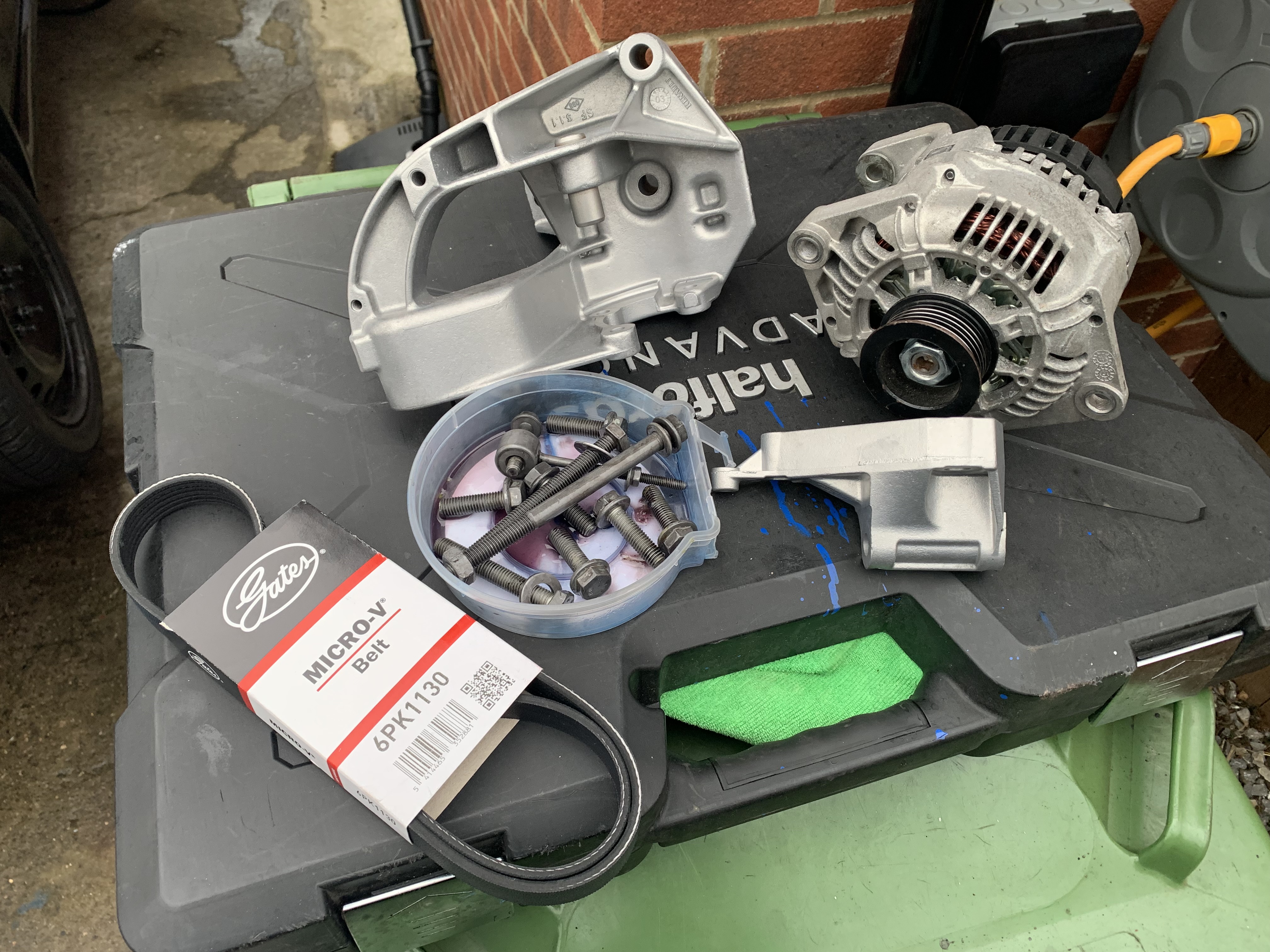

Managed an hour tonight - finally no rain.
Whipped the Cup delete kit off - probably won’t be needing that now - and attached the power steering pump to the original upper bracket. Then mocked the radiator up with the Schroud.
It looks the dogs but it’s going to be tight with twin 9 inch fans and the alternator in.
A bit of gentle persuasion is going to be required 🔨 me thinks.
Nothing organised this weekend, so weather permitting, I should be able to make some progress.
Thanks for 📖
Mr Underhill
Another fight tonight, but I think I’ve got the better of it.
Put the other delete kit back on with new belt and moved the PAS pipes further back to allow for fans.
Next problem is getting the radiator to seat properly on the subframe.
As you can see it’s tight.
Too tight! 🖕🏻🖕🏻🖕🏻
I’ll just ream the holes a few mm and we’ll be good to go.
