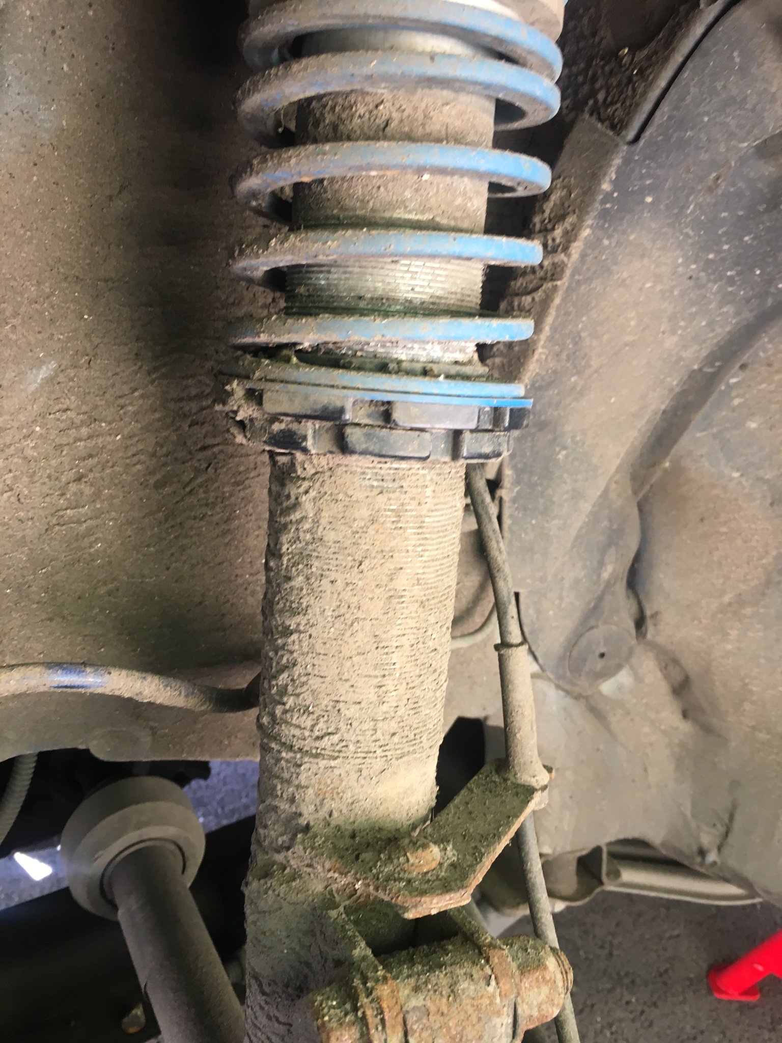

- sorted grotty siezed coilovers, pics below

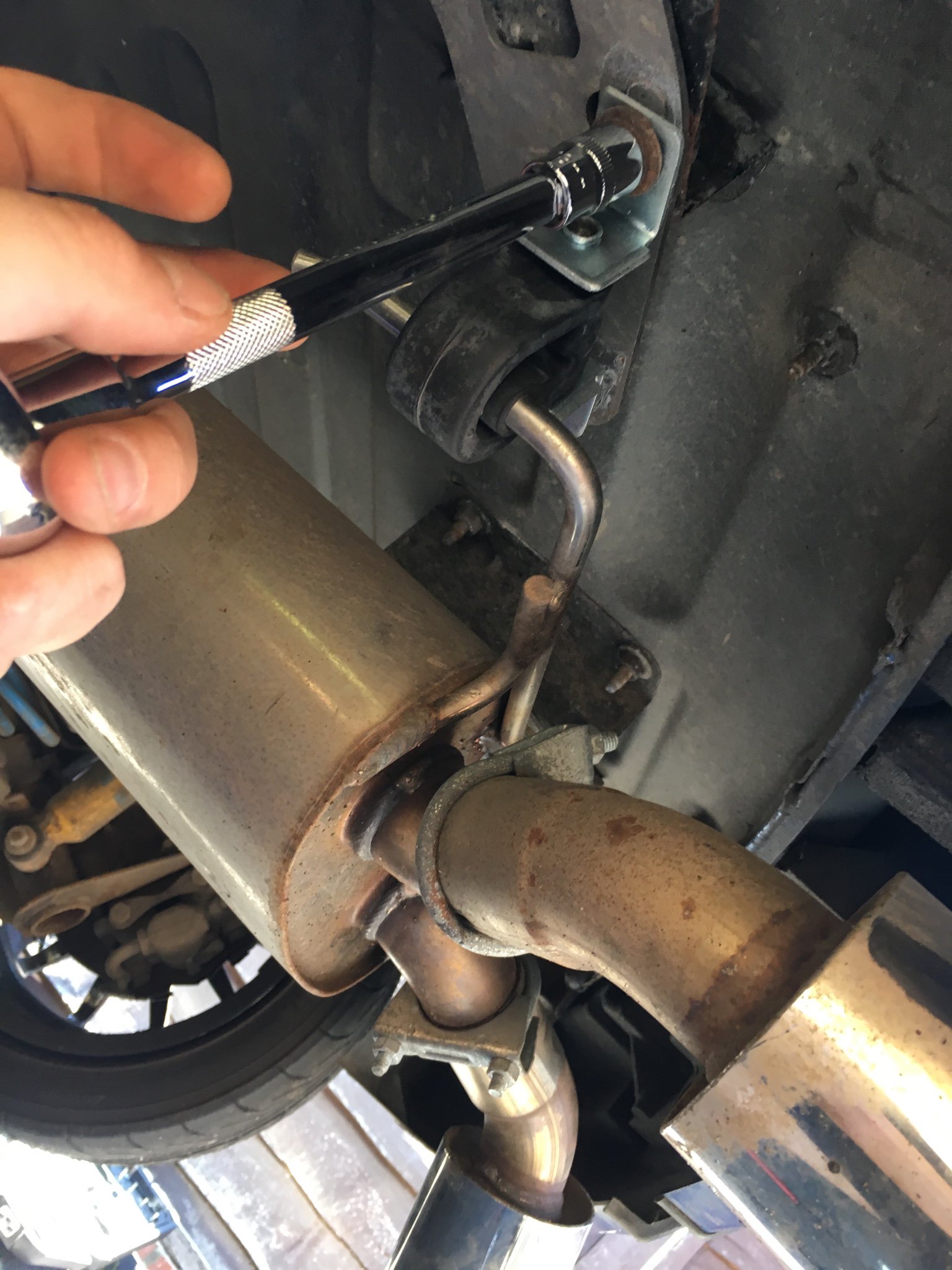

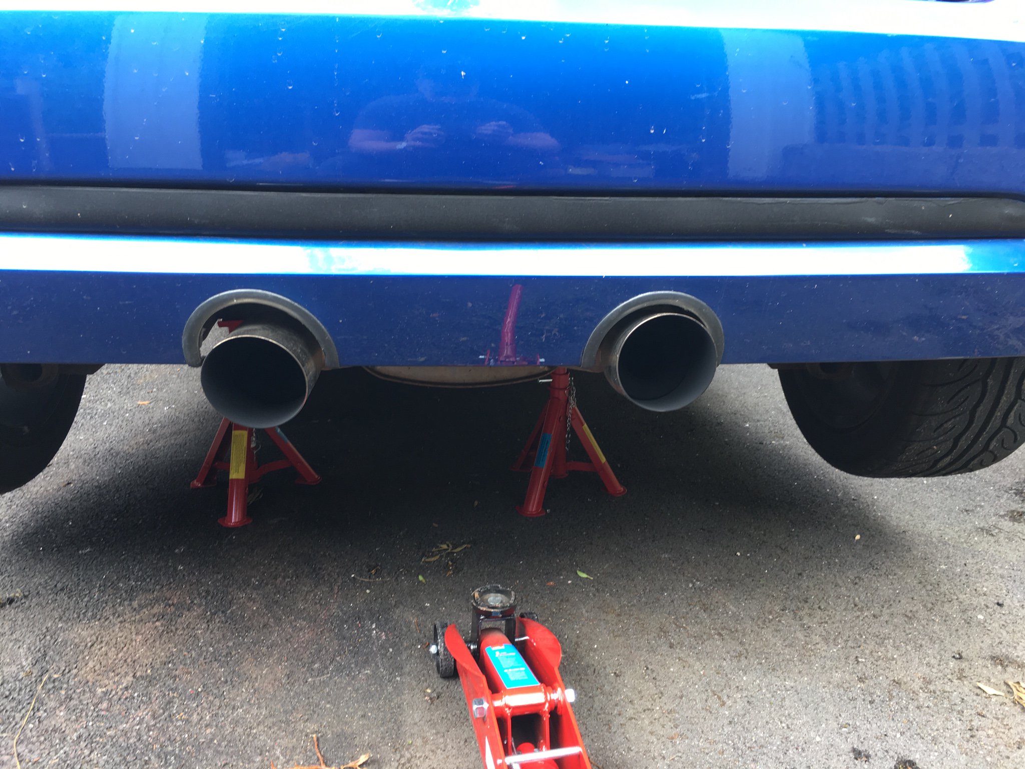

Sorted knackered exhaust mounts and realigned exhaust. Used cable ties on new bushes to hold.

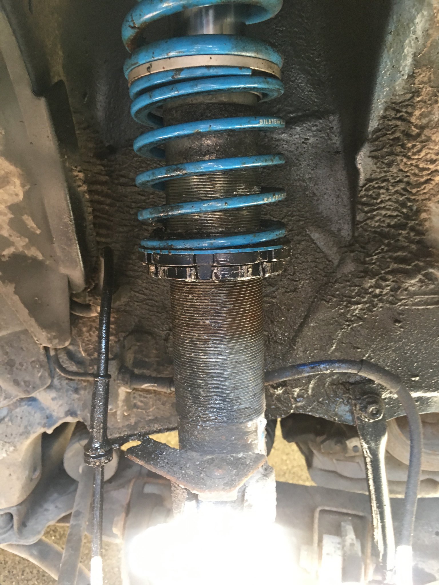

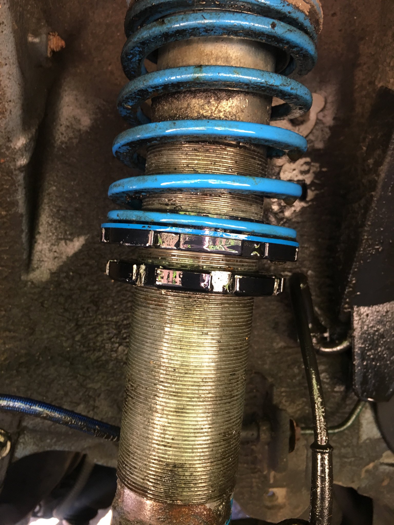

Next was to sort the coilovers. These were looking very unloved and siezed bad. An afternoon of soaking, hammer, flat head, wire brush and back in business.

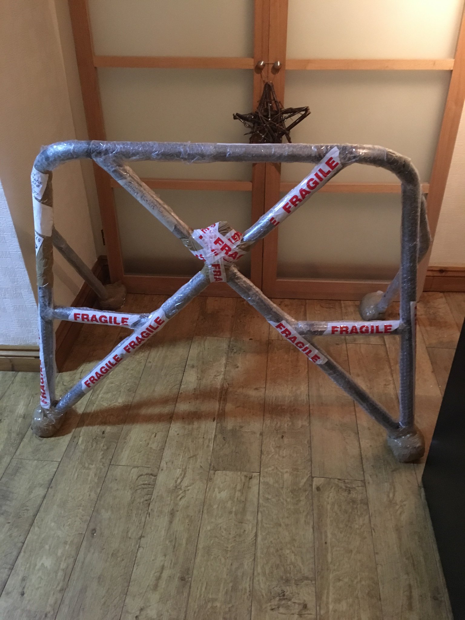

Cage ordered from eBay, will get some pictures up shortly as what's a thread with no shiny pics!

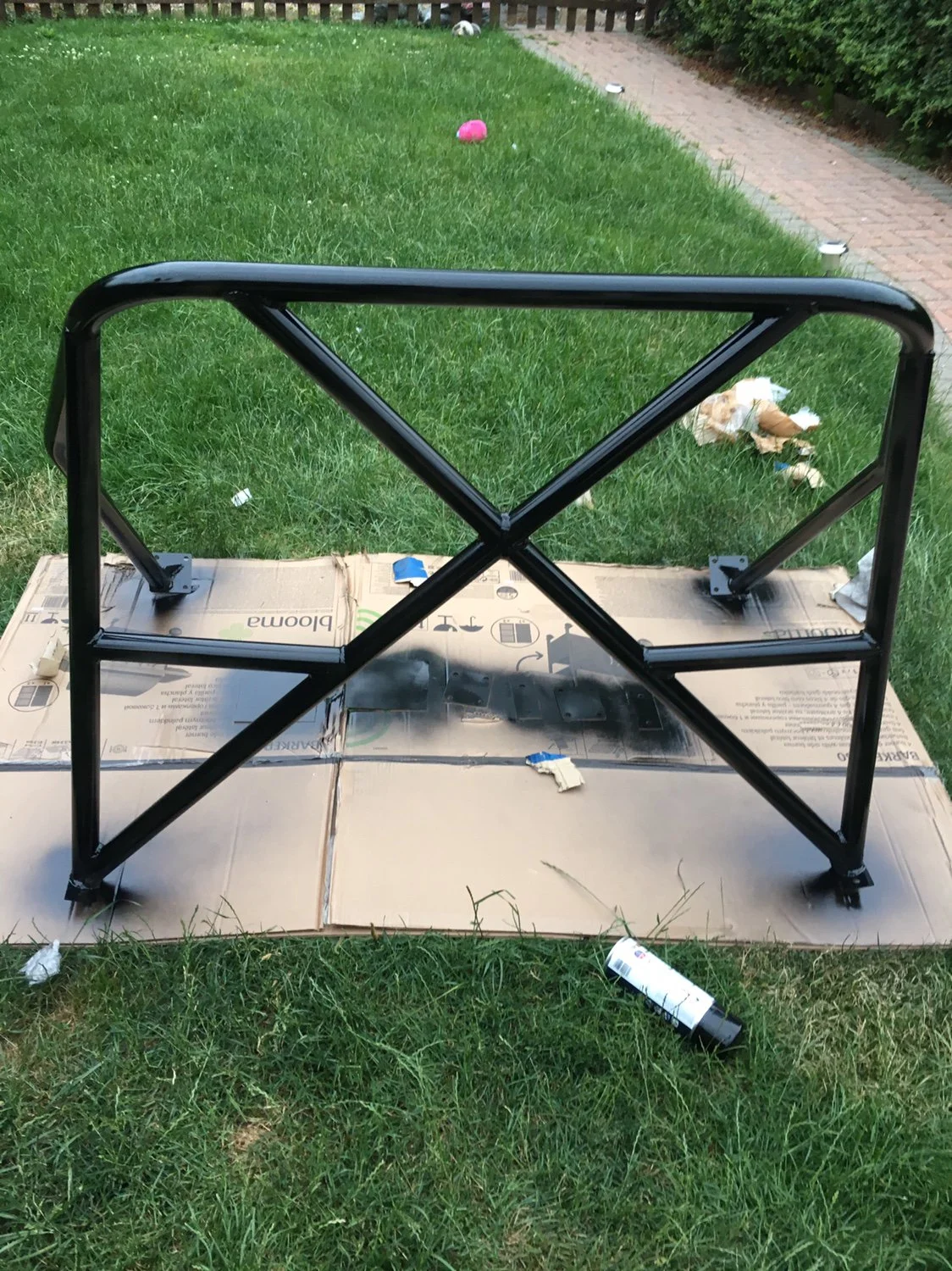

I also had a riveting Friday painting this bad boy
After Oulton and hopefully donnington in a couple of weeks I aim to get it fitted. I am slightly concerned my dad will be driving at Oulton. [emoji23]

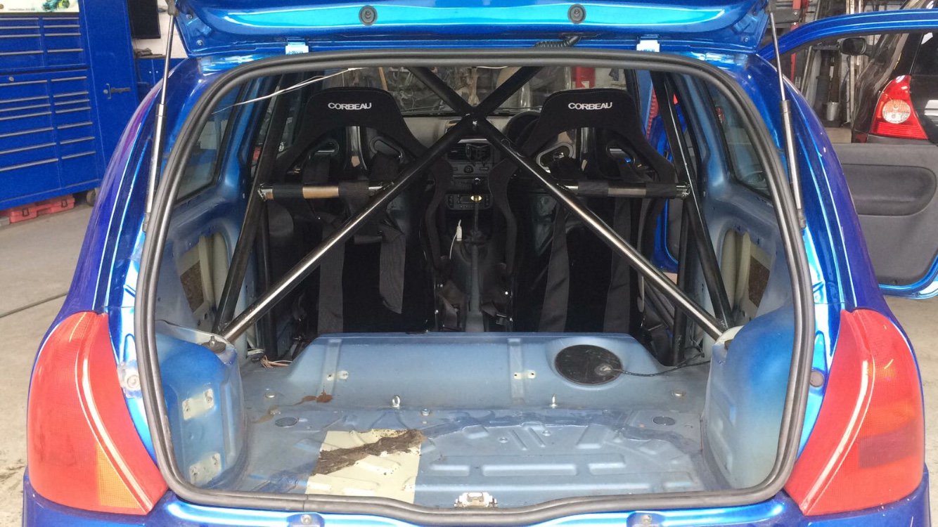

Car is getting the cage fitted this weekend with a member from here!
Can't wait to pick it up
  BMW F30 / Clio 182
Sure dude, the seller doesn't list them anymore but can still produce them. I contacted him off the email on his website
alachi57.
I'll get some pictures of mine when it's done, should pick up this week.
@JonC219 is doing mine for me and replacing some of the spreader plates with more robust units. Dude knows his stuff!
Will get pictures once collected.

You wouldn't think it would make that much difference to the stiffness of the chassis...
But then again it was a tight fit! It's basically 'braced' on each corner.

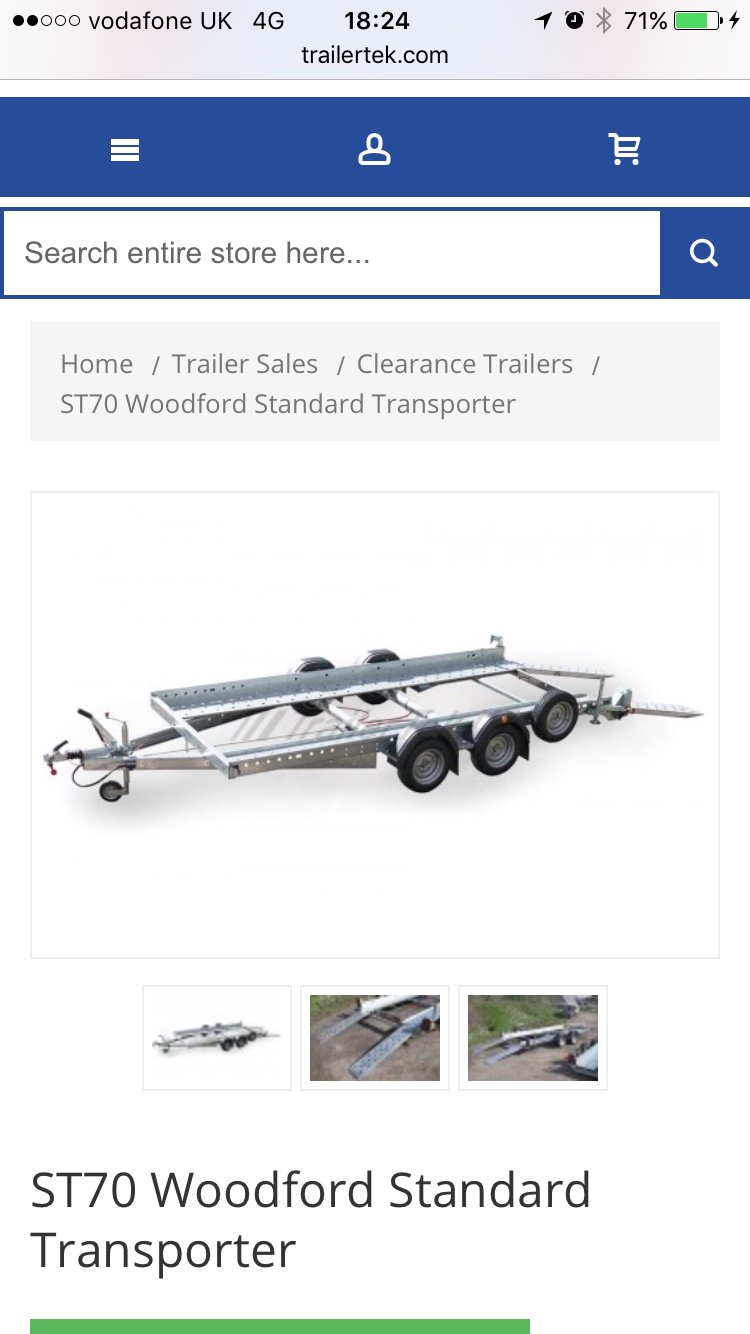

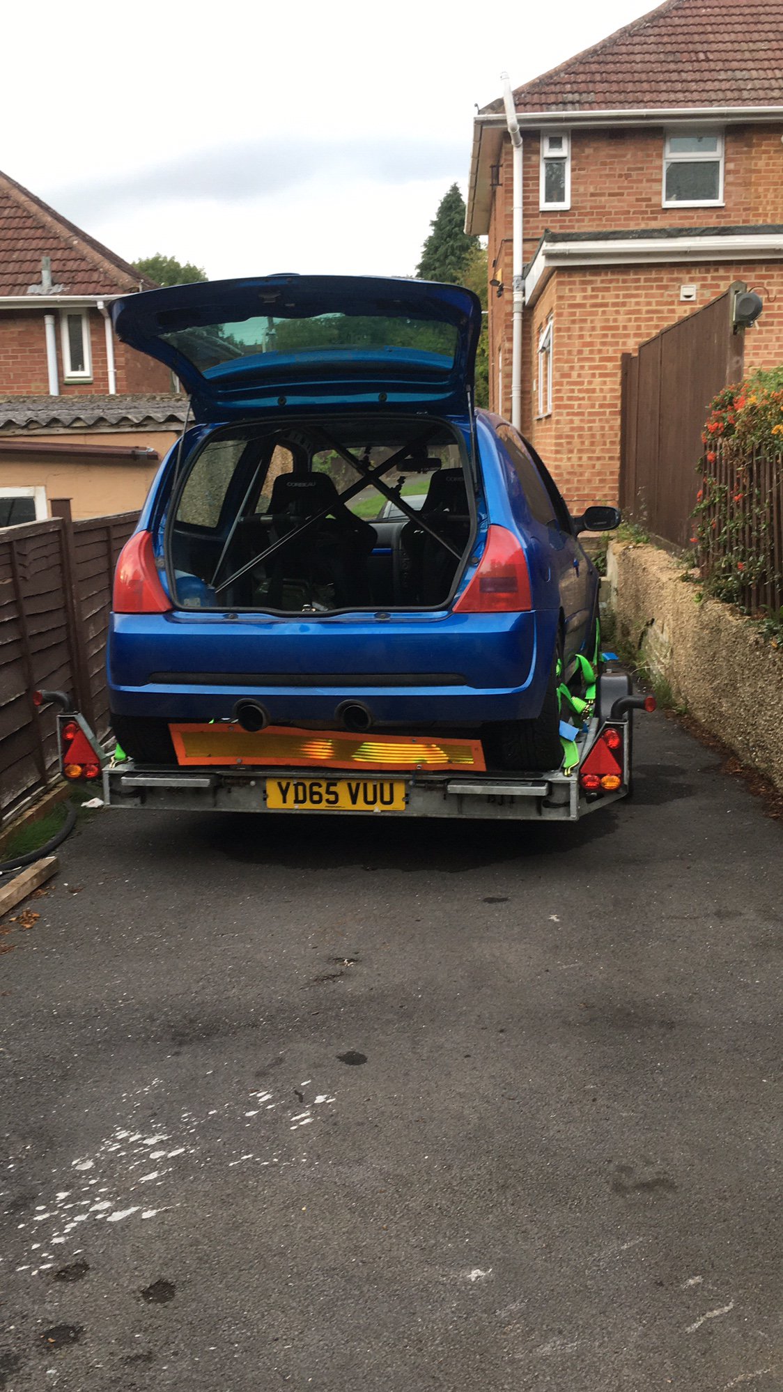

So passed my trailer test last week after nearly cocking up the reverse manoveur due to a bad case of the yips.
I've put a deposit down on this trailer and have my towbar being fitted August 18th.

Also, looks good on its chariot!
