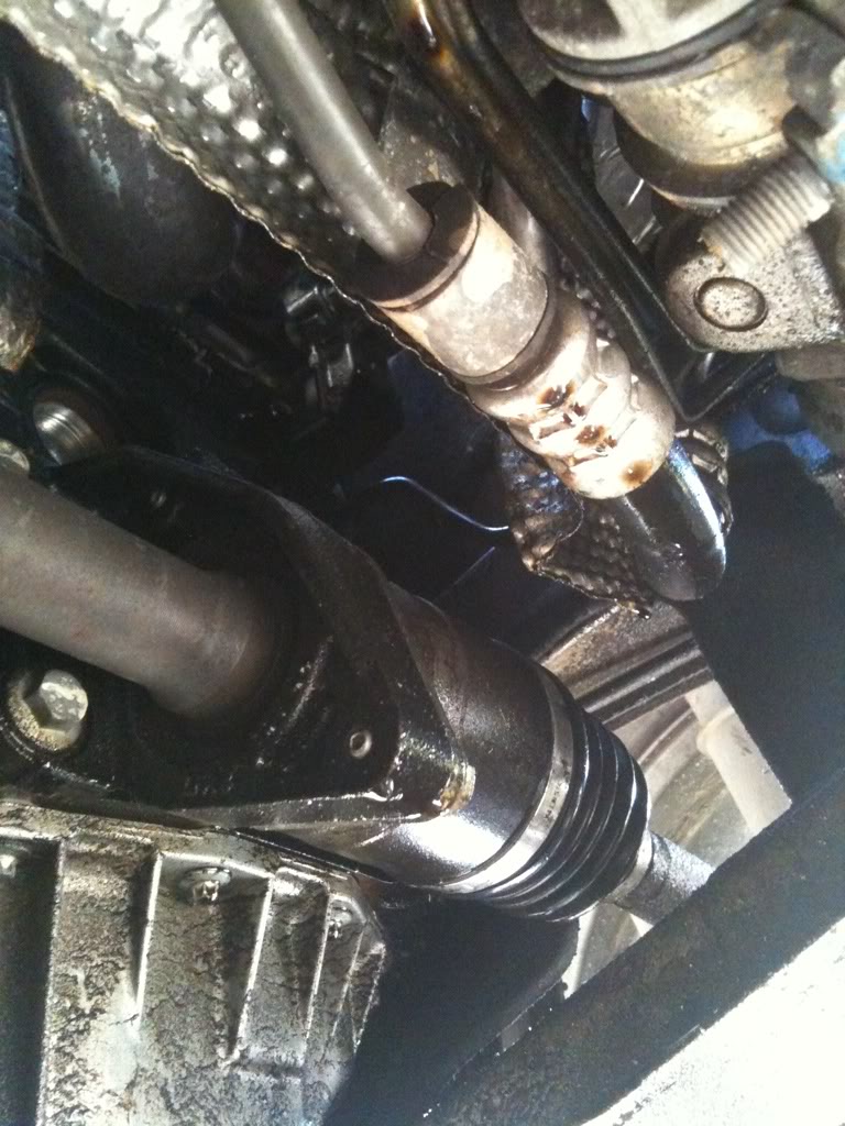

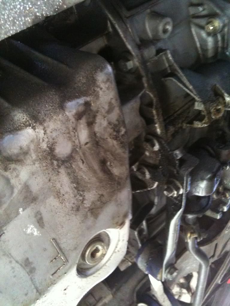

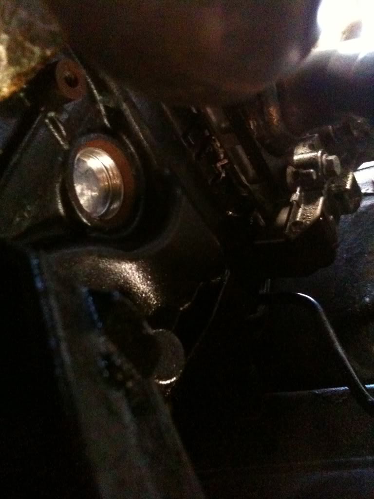

Noticed I've got an oil leak a few weeks ago and been keeping an eye on it. Got it up on axel stands yesterday and can't see where it's coming from!! It seems to be coming from the timing belt side of of the engine and either beside the timing belt or at the back of the block.
Any ideas where it's leaking??
Where are common leaks?
Here's some pics not very good but they might help.
Yeah I tryed checking there but it didn't seem to be coming from the rockers. Such a tight engine bay to work in I can't see much.

Well I've had another look about and the oil is definitely coming from the timing belt side of the engine and not the back, oil is on the top of the alternator. If the oil is leaking from the cam seals or dephaser does that mean it's a timing belt off job?
How can I tell if it's the camseals or if it's the dephaser?

This is really anoying! so far I can't find the leak and the closest specialist is rs tuning I think which is about 5hrs away. I don't want to go all that way for it to be a simple job.
