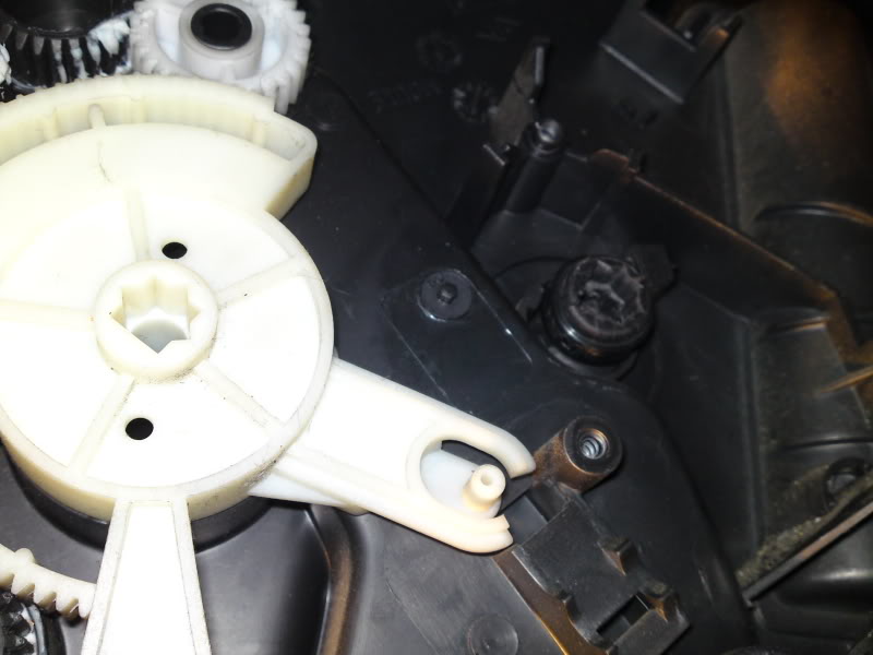

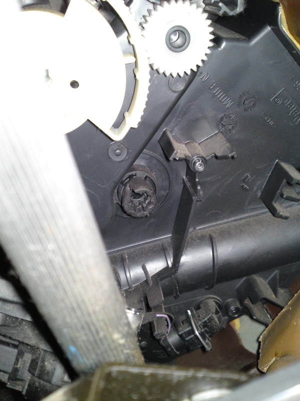

This little chappie is the spindle for the heater control flap - as you can see it has been split astunder in true Clio fashion... the silver shaft is the steering wheel column, this is a job best not attempted by the tubby/clumsy/profoundly incompetent...
7mm tiewrap applied to keep it together, getting the cover back on here again was a right faff - have to line up two splines in the right place at the same time - right down by where your left foot normally lives...
  Clio dCi65 Dynamique
The black splines should look the same as the white ones in the above pic - star-shaped with one flat side, like a "D", the servo should fit into the flat side of the "D" so rotate the splines until they do...
Bolts are all 8mm ;)

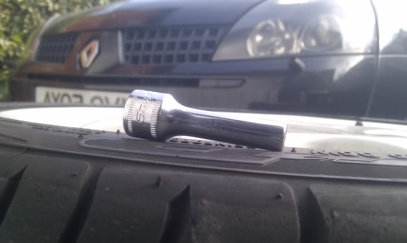

I found it pretty tricky to get a normal 6mm socket or spanner in on a ratchet, or on an extension bar so ended up using this 6mm long socket which was perfect as you could turn it without using any ratchet :) very handy
