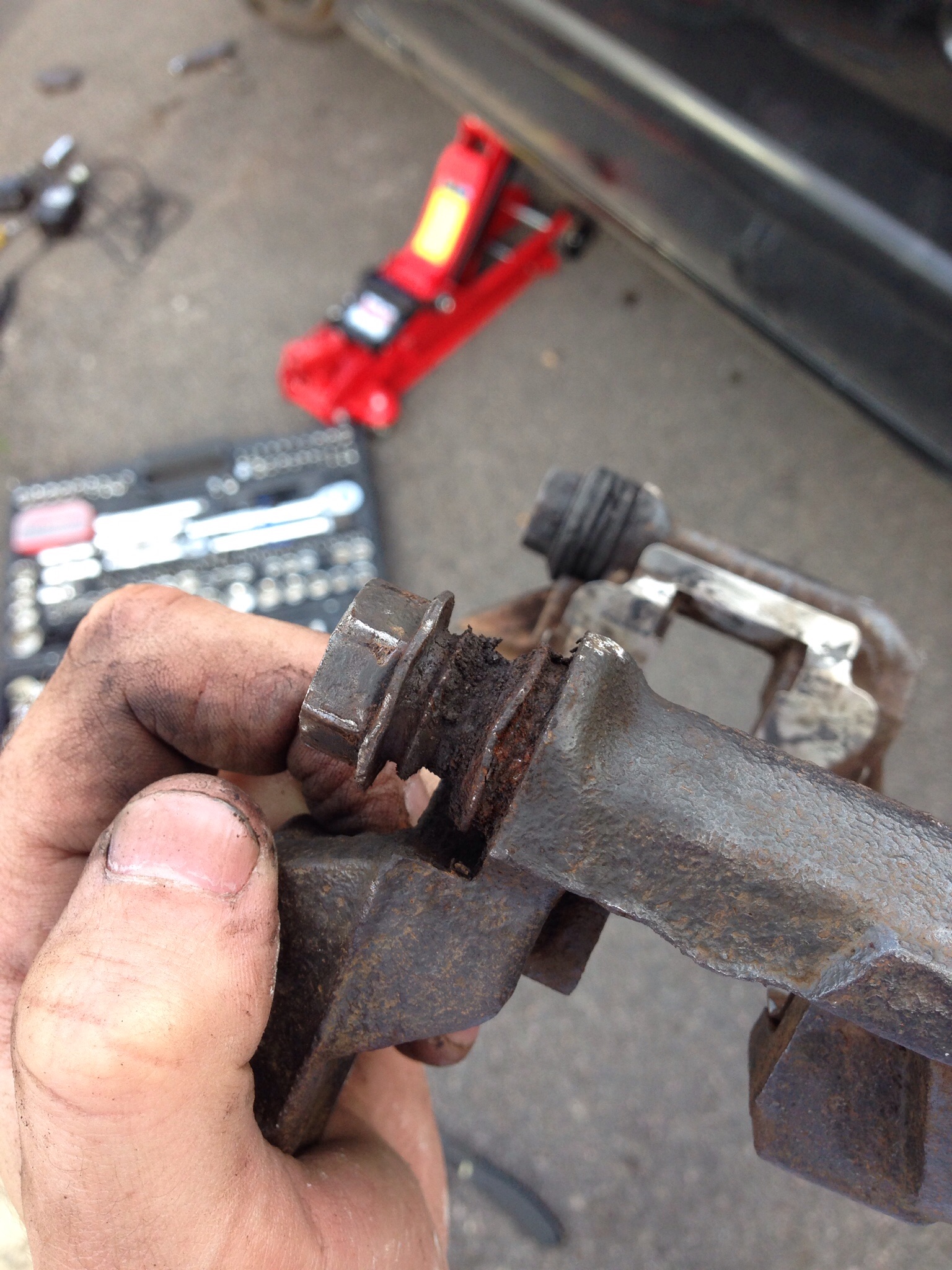

Slider pins always seem fine until they aren't serviced properly for a decade.
I removed the seal on this to find the pin had fused to the carrier.

Slider pins always seem fine until they aren't serviced properly for a decade. View attachment 123852 I removed the seal on this to find the pin had fused to the carrier.
This is exactly why I ordered new ones.
It's better to have them and not need them.
