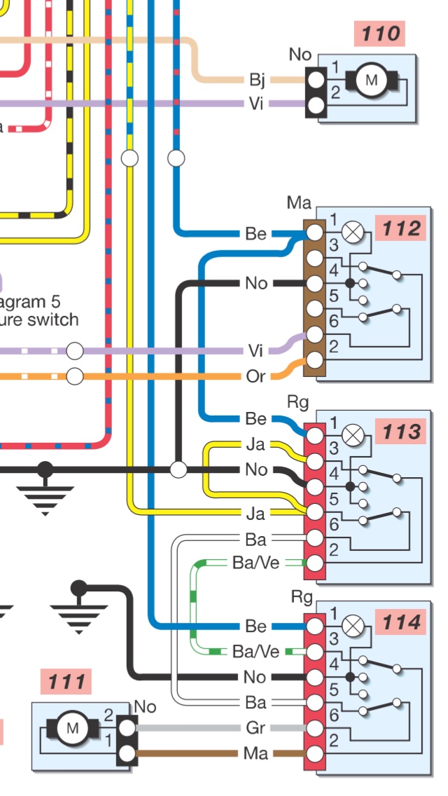

Both the wires from the UCH to the motor are intact , as it functions downwards . IE a circuit with 2 wires only swapped by the UCH to change direction.
The issue here is , either the switch doesn't tell the relay in the UCH to switch (a faulty switch ) or the UCH doesn't operate the window upwards when told to by the switch , IE a faulty relay
Check powers and earths at switch and trace wires back to UCH to confirm ok .
  172 Ph1
You need to have 12v at both wires at the motor when switches are at rest position .
If you don't , then start tracing it back
111 is passengers window motor
113 switch for passenger on right door
114 Passengers side window switch on left door
