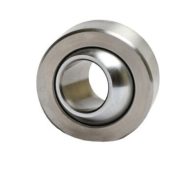

After some replacement bearings for the PMS top mounts, but I was just wondering whether anyone knew where to get some of the 'uprated preloaded' bearings from besides direct from PMS?
I've seen the normal standard ones here - http://www.mcgillmotorsport.com/m18-spherical-plain-bearing-gek18t-teflon-lined-704/
and they're soo much cheaper than buying the same from PMS, but I was just wondering whether anyone had a link to others.
What's the actual difference in the two?
Cheers!

Probably a bit late but im having trouble understanding how a spherical bearing can be preloaded?
I was always under the impression that preload was acheived by aligning both bearing races in a certain way
and spherical bearings only have the one "race" as far as i can see.
Im not an engineer by any means but interested in how things work, so correct me if im missing something here

The pms uprated top mount bearings are minebea if I remember correct (have ordered them before) I know the rear beam uprated ones are definitely minebea. Preloading a bearing is typically when you have more interference on the outer race to reduce end float, and I think this might be the case as the preloaded bearings seemed to be a bit harder to press in.

I've got ktec ones now mate. Just ordered some SKF bearings, and i'll laser cut out some washers from PTFE at work.
