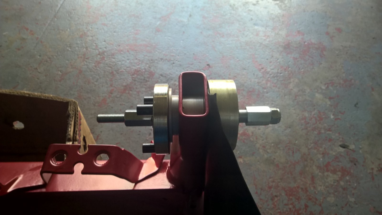

I replaced the beam on mine as the old one was bent. Not sure how much work it is with the beam still attatched. You need one of these tools to get the bush in though
  Clio 172 Merc ML55
I replaced the beam on mine as the old one was bent. Not sure how much work it is with the beam still attatched. You need one of these tools to get the bush in thoughView attachment 178886
Funnily enough I replaced mine for the same reason.
I used a bench press for the casings but you'll need a second pair of hands if you do it that way.
Apart from the hassle of changing the bushes you'll probably need to at least partially drop the fuel tank @RichValver as the bolt through the bush is pretty long

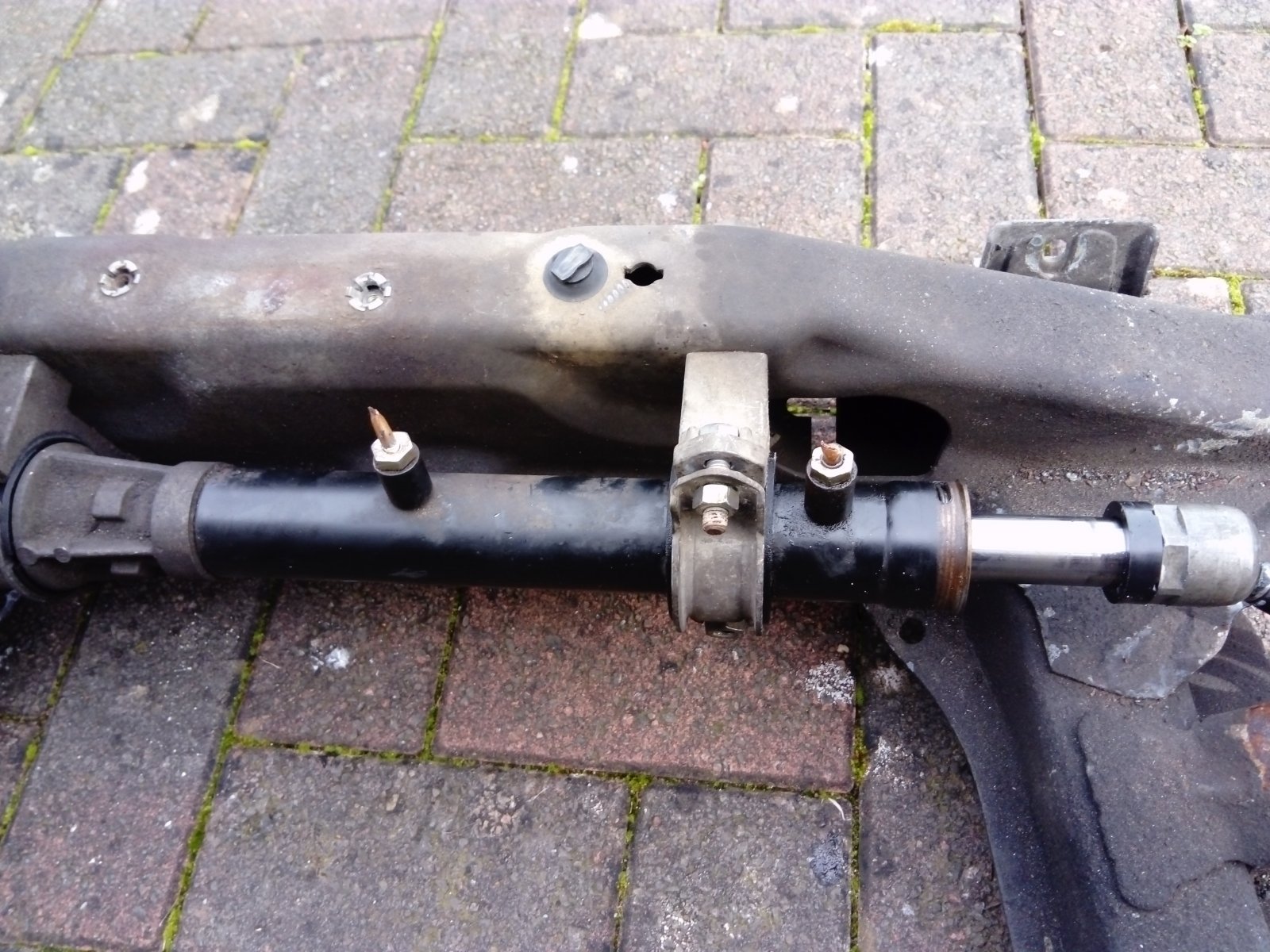

On my 172 Cup I replaced the lower arm bushes with OEM, replaced the rack bushes with nylon ones, and all the top mounts with OEM ones, bar the rear beam - I poly'd that one.
  Clio 172 Merc ML55
Now that looks like what I was after- now to find a fitting guide
4 bolts hold the rack to the subframe, unbolt, lift rack out of its housing, remove old bushes and fit new ones (they're split so the come off and go on really easy, with a hole to align on a lug) fit rack back onto subframe and bolt back up.
Worst part of the job is access, it's fairly limited if you're led on your back
