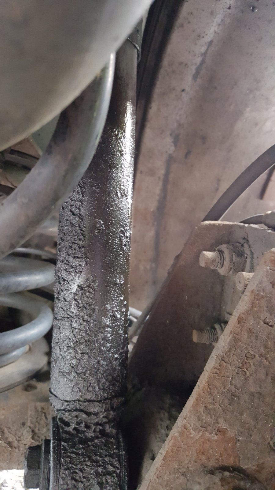

I have zero mechanical knowledge. Literally zero. Here's a pic.
Is this buggered? The other one doesn't look like this. Are they expensive?

Nice one, cheers guys. Are they specific to cup pack/non cup pack? Need new driveshafts as well so I will get bent over in preparation. Damn thing.

Get cup rear shocks
Jekyll
All rear shocks will be the same fitment, just cup ones are slightly stiffer I believe. Down to personal preference. Definantly change both at the same time, even if the other side seems ok.
Also, I have had a J&R driveshaft fitted for a while now and no issues whatsoever. Mine was passenger side.

Rear shocks are very easy to replace yourself - is the one that's leaking banging away as you drive along?

Yeh, if you want to start learning about doing little bits on your car, I can think of much worse and harder jobs than changing the rear shocks :)
Jekyll
Jack up the car on the rear beam, then place the axle stands on the rear seal jacking points. Undo the top nut which I think is 17mm, but you'll need some small adjustable for the top of the shock in case it spins.
Then it's a 18mm for the lower shock bolt. I normally lower the jack a tad so it's not so much pressure on the rear shock when undoing the lower bolt.
Reverse the effect when refitting new ones :smile:
That's how I do it anyway, others may use a different technique. But as @leeds2592 said, there is worse jobs to do. This is a great DIY starter job.
