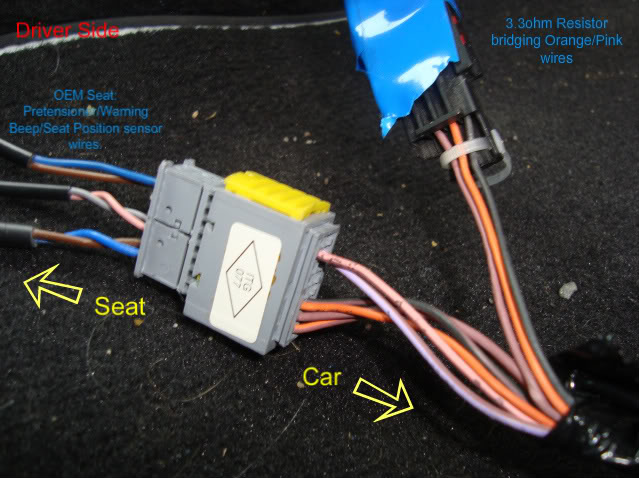

The only thing you need to disconnect is the seatbelt pretensioner. follow the cable from the seatbelt clip near the hand brake. there is a grey connector and you slide the yellow bit away from the grey connector.

Took me a while to work out how to unplug the above.. put a precision screwdriver or similar flat under/up the yellow bit so it pulls up.

Thanks all - is it located underneath the seat? As that's where I can see the grey and yellow clip.
