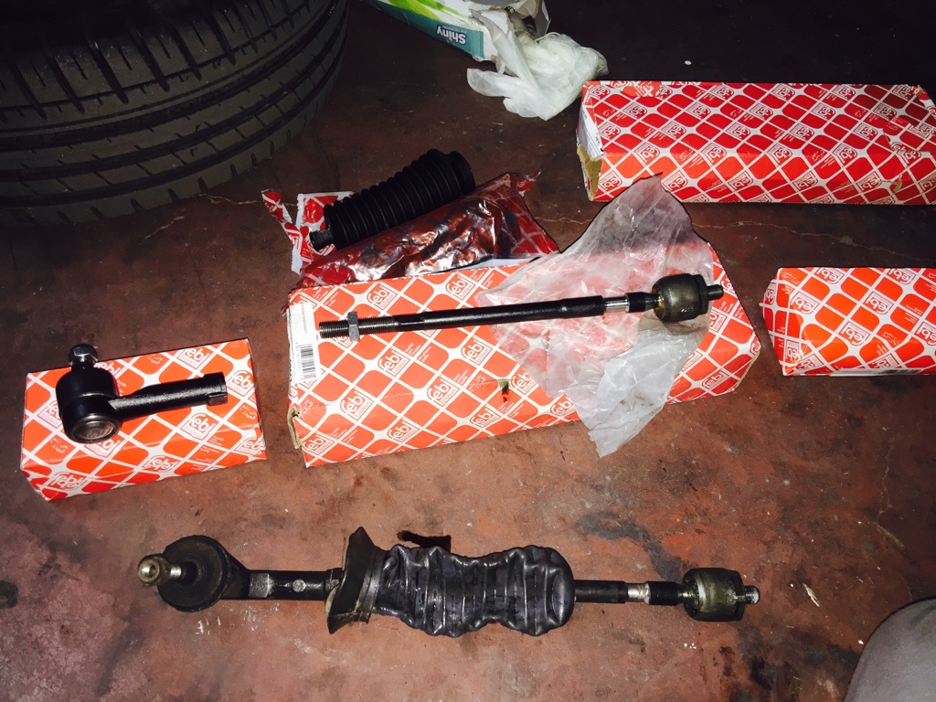

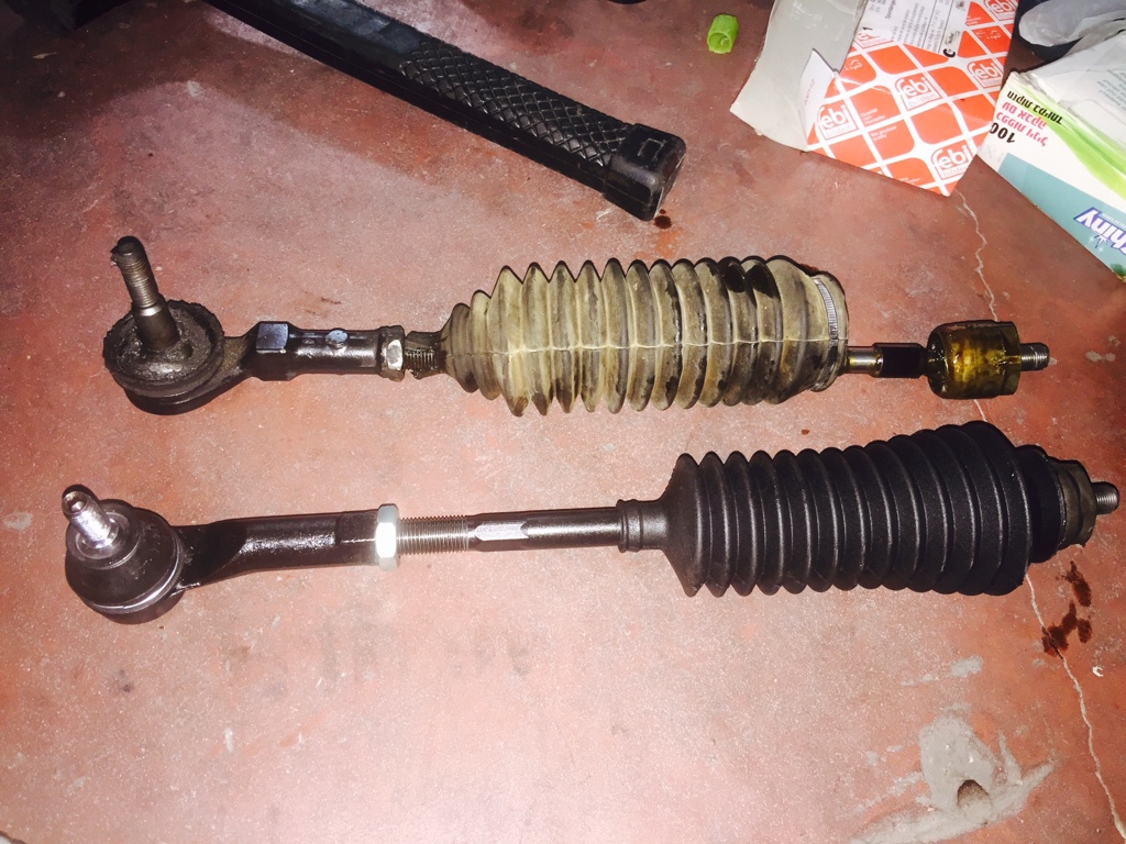

I just replaced my clio 172 ph2 tie rods and end tie rods (balljoints) and i want to share with you the process.( the parts are Febi parts)

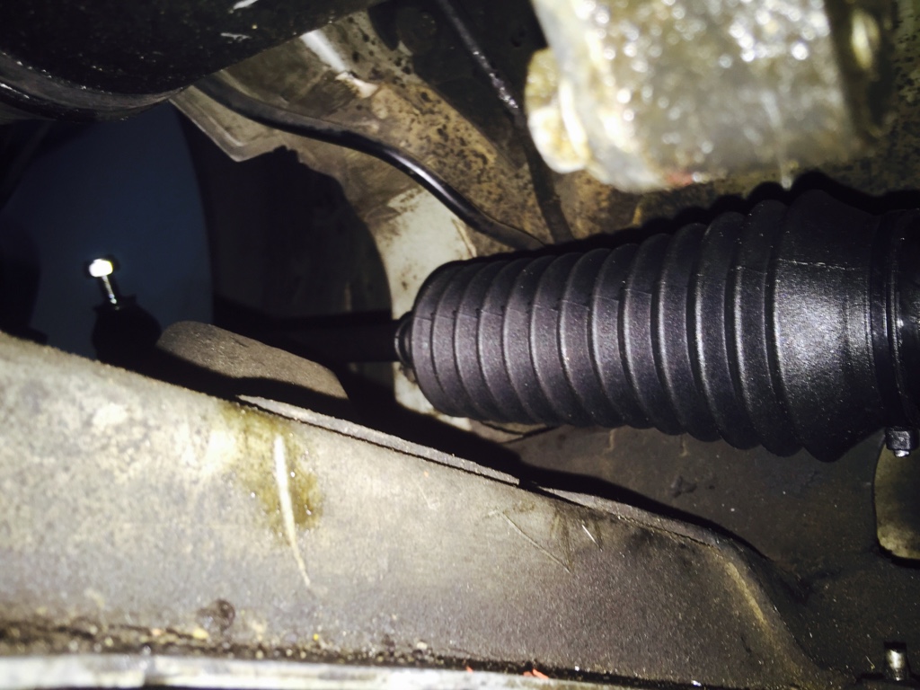

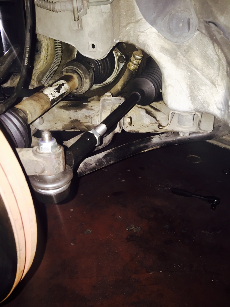

1. Popping the wheel out.
2. Remove to lower engine plastic cover (just for better approach)

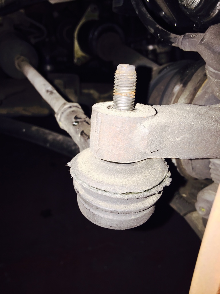

3. Unbolt balljoint screw and hammer it out (if hard you can move the hub back and forth while knocking)
4. Cut the zip tie that holds the rubber cover and move the cover to convenient place( you can cut it completely off course)

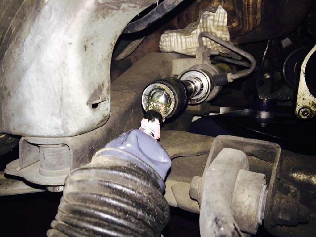

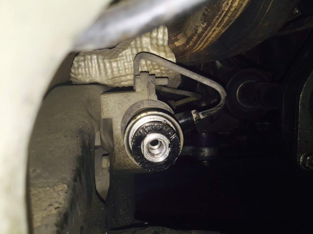

5. Open the tie rod with the correct tool and remove it from the car.

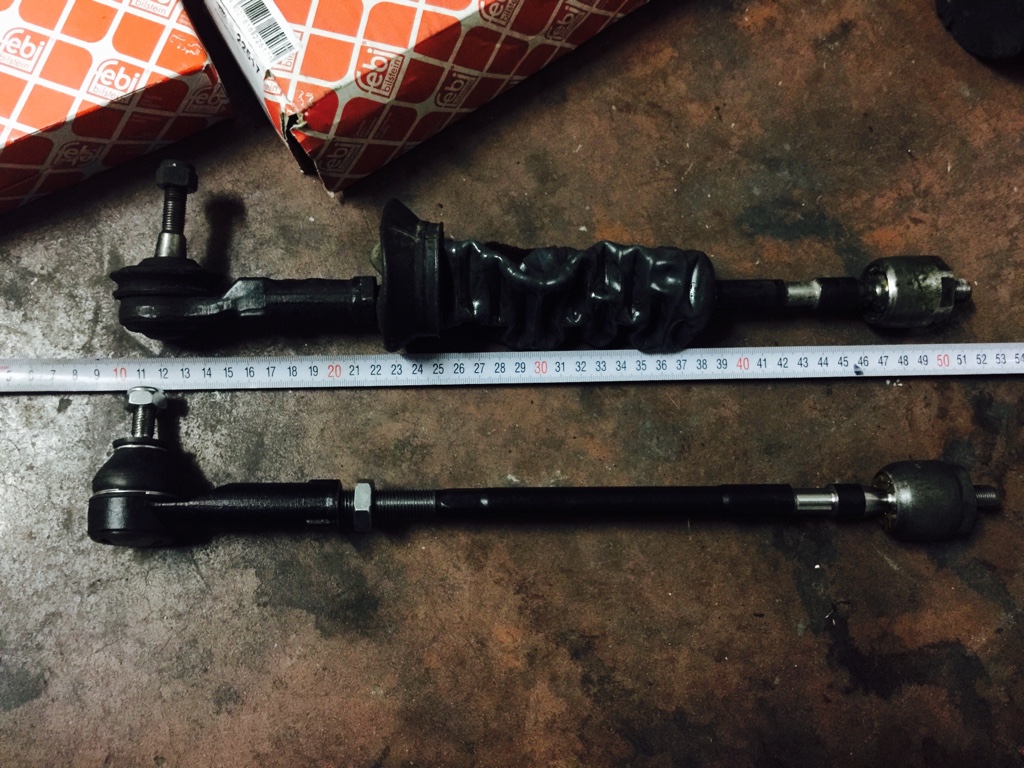

6. I measured the length of the old one and tried to make the new one at the same length.(because the balljoint are not at the same size and shape it was hard to measure)

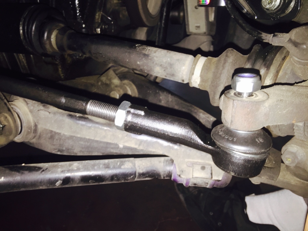

7. Put the rubber cover on the tie rod then bolt on the balljoint. Now bolt the tie rod to the steering rack (you can spin the balljoint by hand- it will help to screw in the intire rod) and then tight it with a tool( my friend recommended to put a locktite to the tie rod threads)

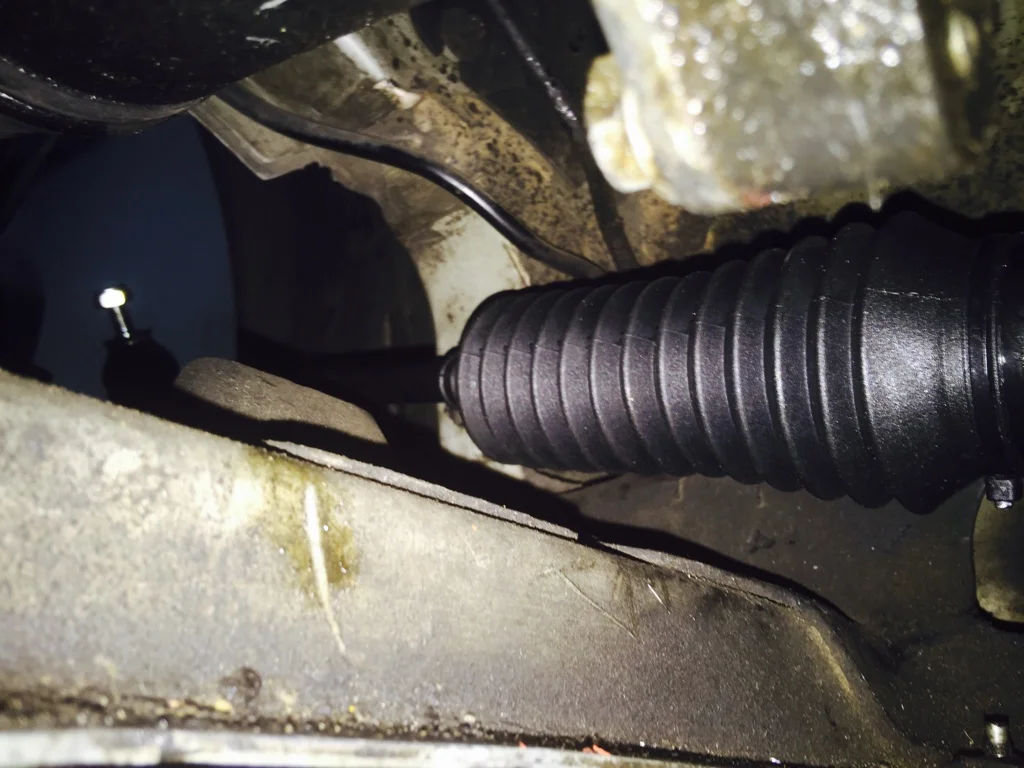

8. Put the rubber cover on the steering rack and zip tie it.
9. Put the balljoint in to the hub and tight it with a torque of 37 nm.
10. Put back the wheel and do the same on the other side if needed.

Some pics:
