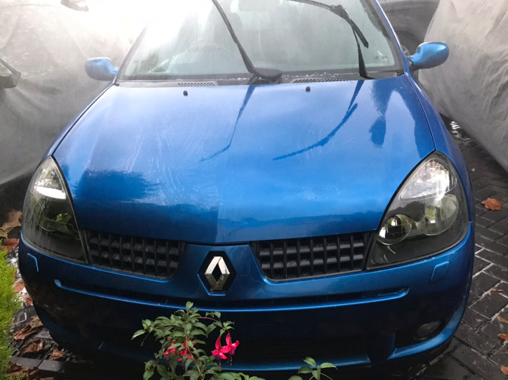

Is the front wonky?
Some good touches, much cleaner!
Now you say that it does look a bit off centre but I can assure you that its as straight as its going to get:) its where the previous owner had a coming together with a high kerb and pushed the bumper out and tried to repair it himself :fearscream:and now its a bit oval Lol,will get it sorted properly eventually but its quite low on my to do list.SJ.

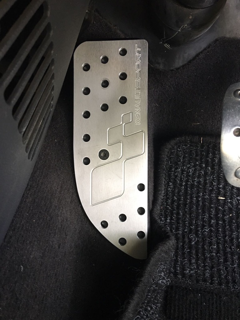

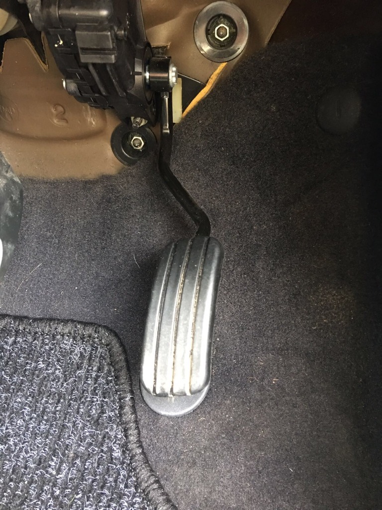

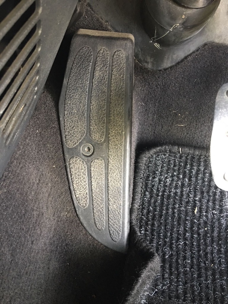

The job for today was to change over the accelerator pedal and spruce up the foot rest with an added addition.The Gas pedal that came with my car was rubber but the brake and clutch pedal are metal so it looked well...."kind of out of place":blush:So after sourcing a working replacement that functions as Renault intended,I proceeded to swap them over.
How the Pedal and footrest was...
And now:cool:...
My car is slowly moving in the right direction but still has a far distance to go until I am happy.SJ.

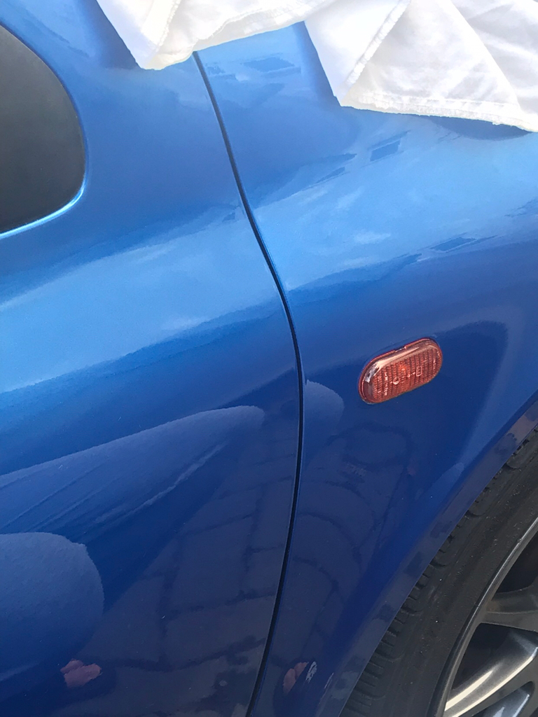

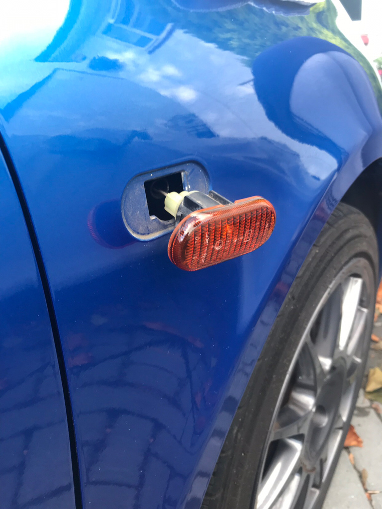

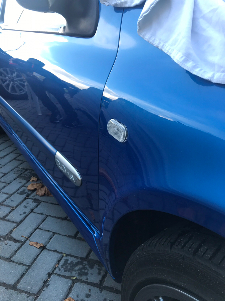

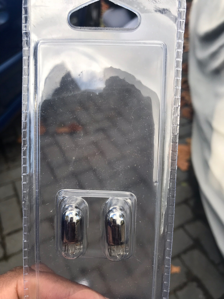

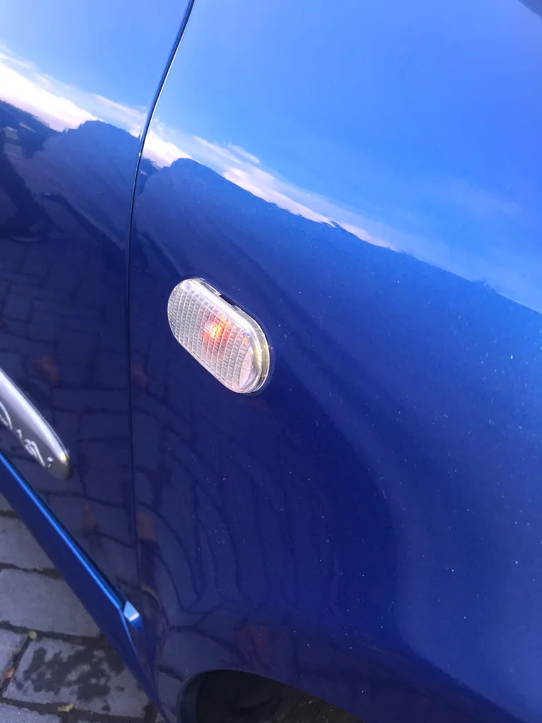

Decided to freshen up the look by losing the amber repeaters and changing them out with clear repeaters and silvertech bulbs...

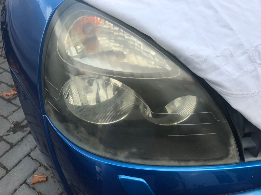

Also gave the front and rear headlights a quick buff up...but will need to go over them again as I’m not happy with them just yet but will do that at another time when I purchase another headlight polish kit...

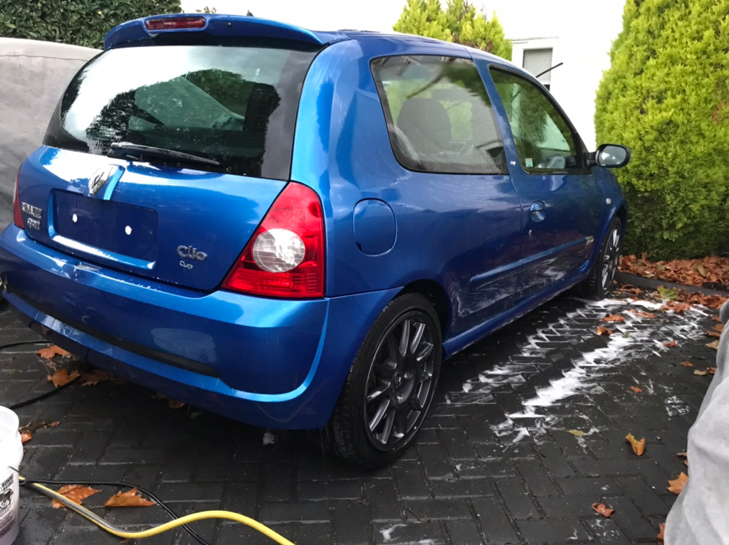

Also decided to take off the number plates and give the car a good clean up underneath,i have new plates on order will change over when they arrive...

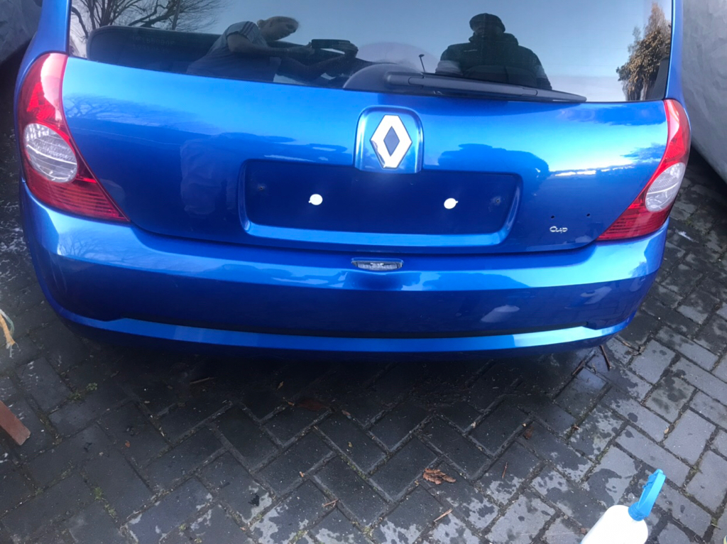

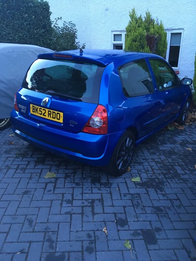

Not much done really just abit of debadging...
I like the way that some members have put that new style badge on where the Clio badge on the right of the boot is,looks more updated[emoji1417]Their bloody expensive though for what they are loool but I have decided to just get one and stop complaining about the cost...One more thing new wheels ordered inspired by Mbeau choice on the black RS that I sold him[emoji1417]So I’m really looking forward to receiving them,they are an oldie but a goodie and suit the Clio perfectly[emoji1476].SJ.

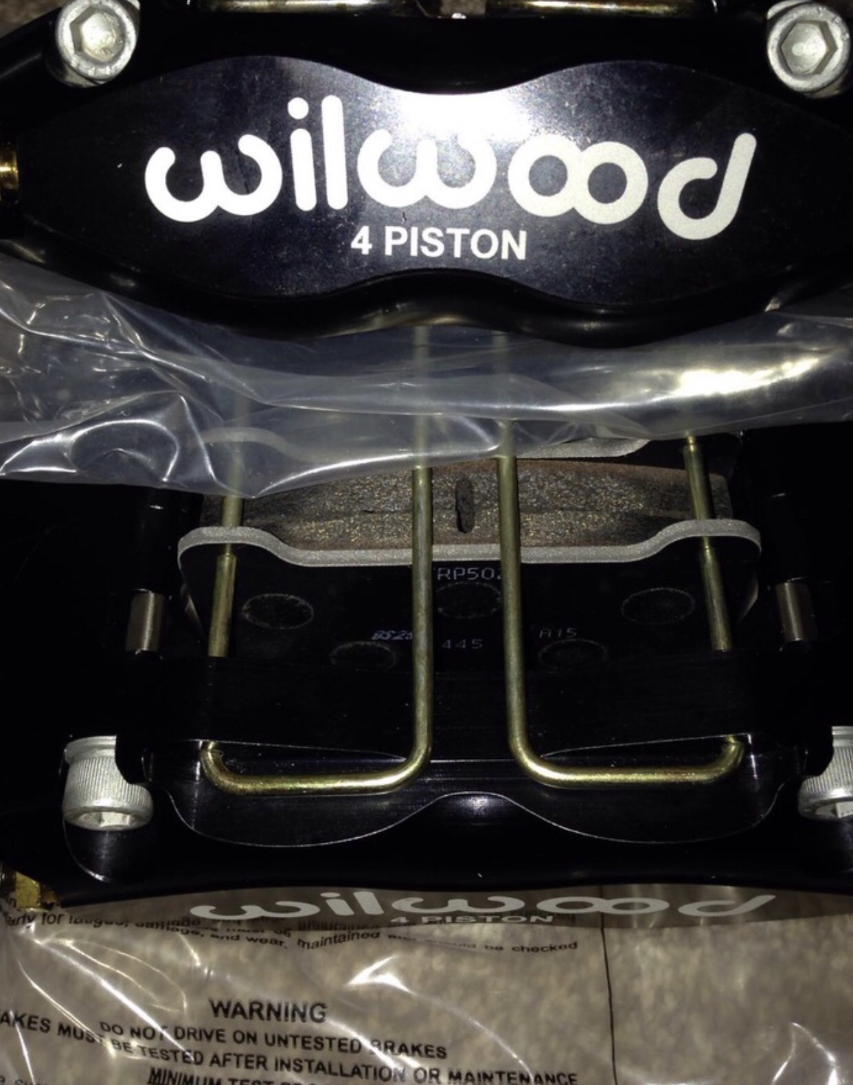

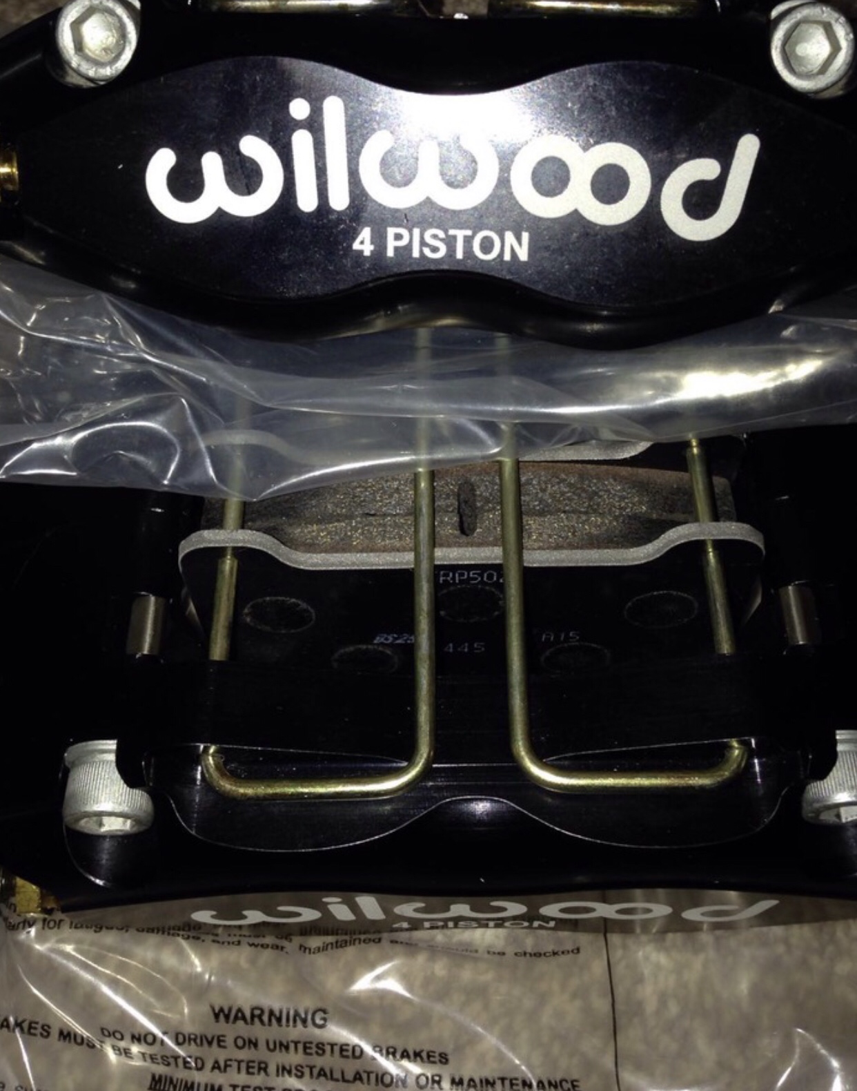

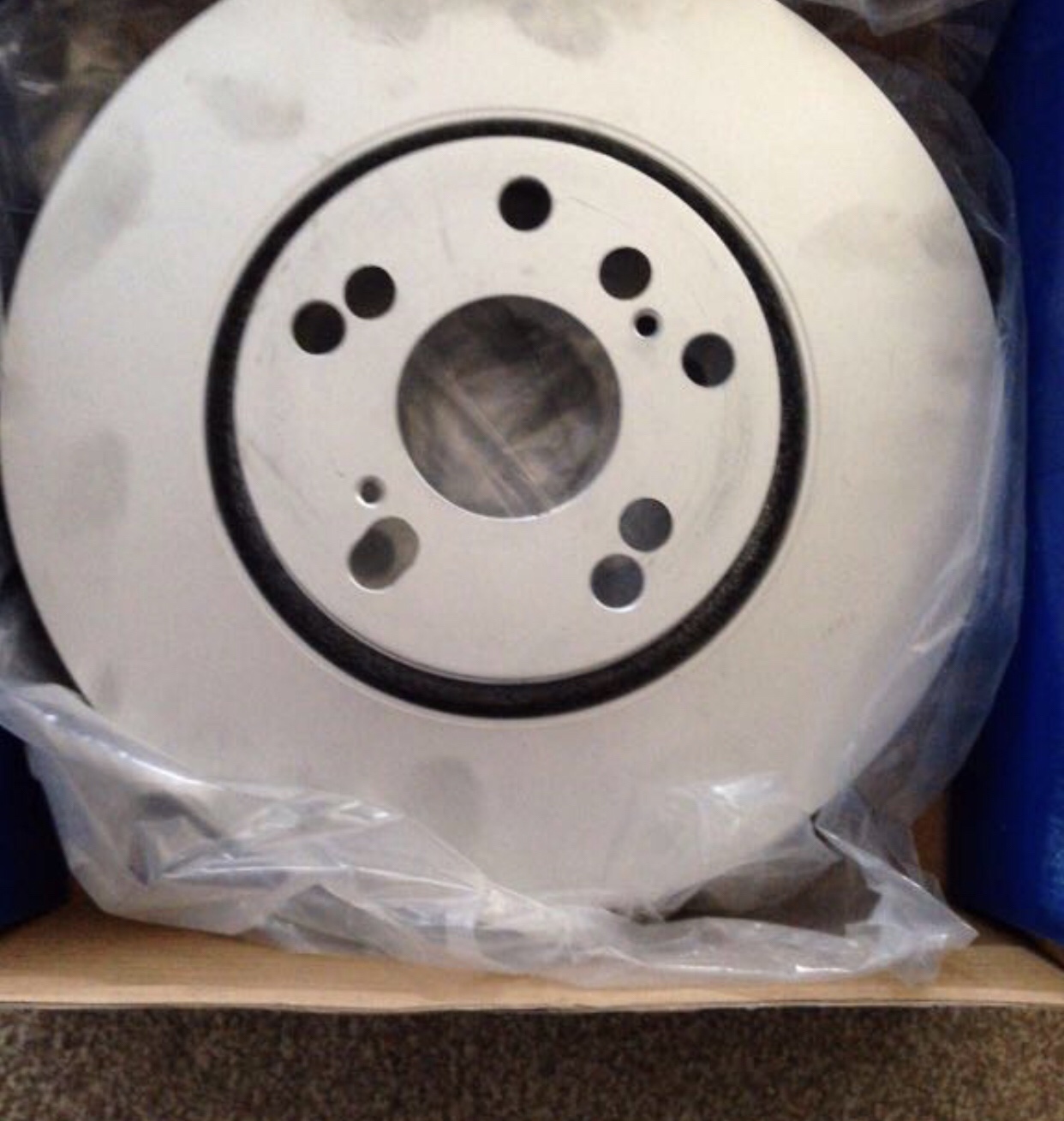

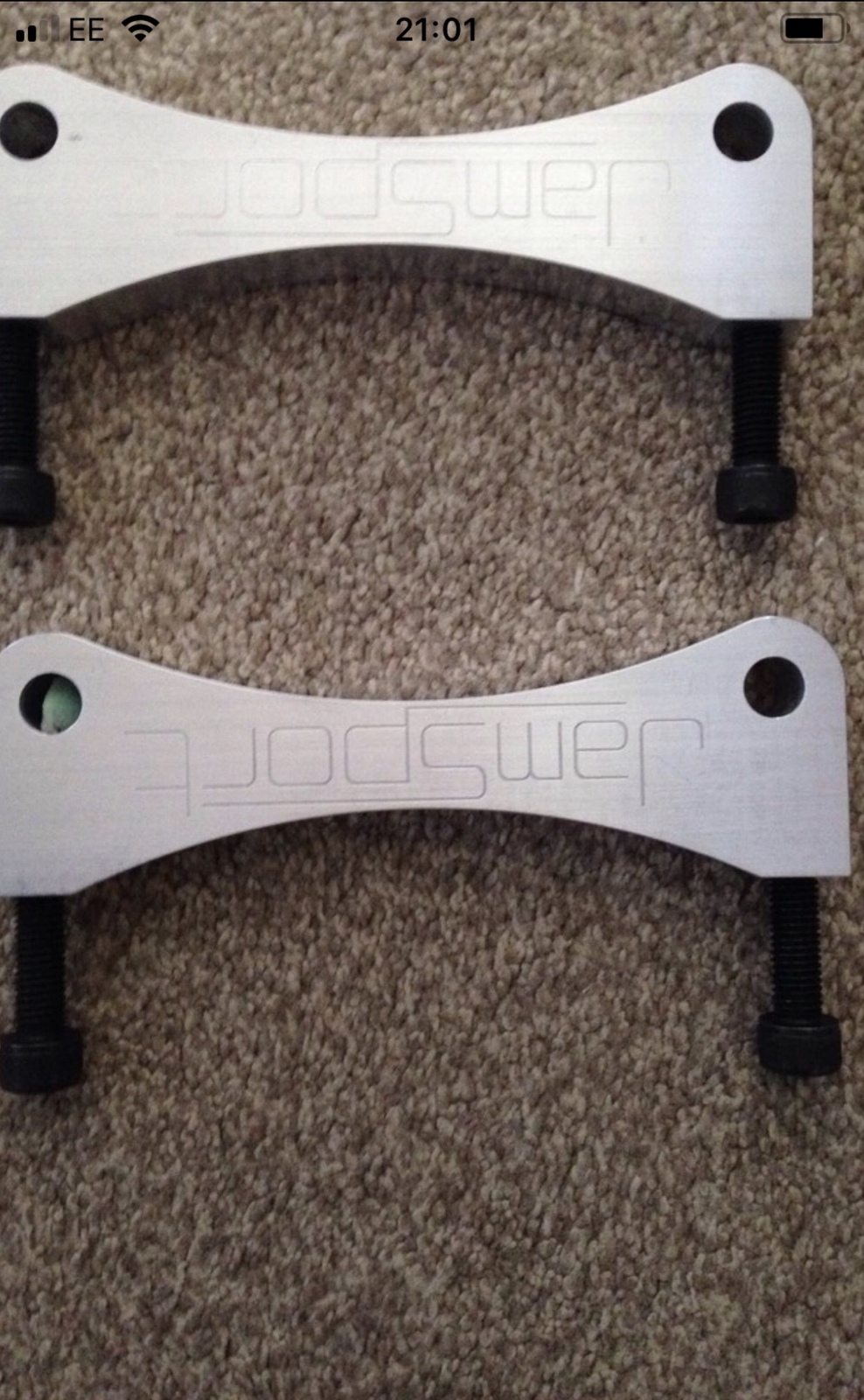

Well a purchase that I had made a while ago has finally turned up...my new Wilwood four pot calipers[emoji1417].
I was originally going to get Brembo’s as I know that they are a quality caliper”bulky but they work”[emoji6]but decided as I was going to run 15” inch wheels that the Wilwoods was a caliper that can be fitted under them with minimal fuss...As my Cup project is going to be a forged rebuild eventually with some forced induction running through it,I have decided to get as much of the supporting modifications done as possible,before I tackle the heart of my project....My wife decided to give the top hats a spruce up for me,as I had purchased some VHT caliper spray paint...
I am also looking to rebuild and freshen up my rear calipers to match the fronts.That’s all for now folks[emoji6]still waiting on my new 15” wheels to turn up,hopefully they come this week.SJ.
Make sure you clean up that mating face before fitting or you'll be constantly retourqing wheel nuts

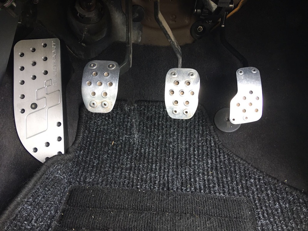

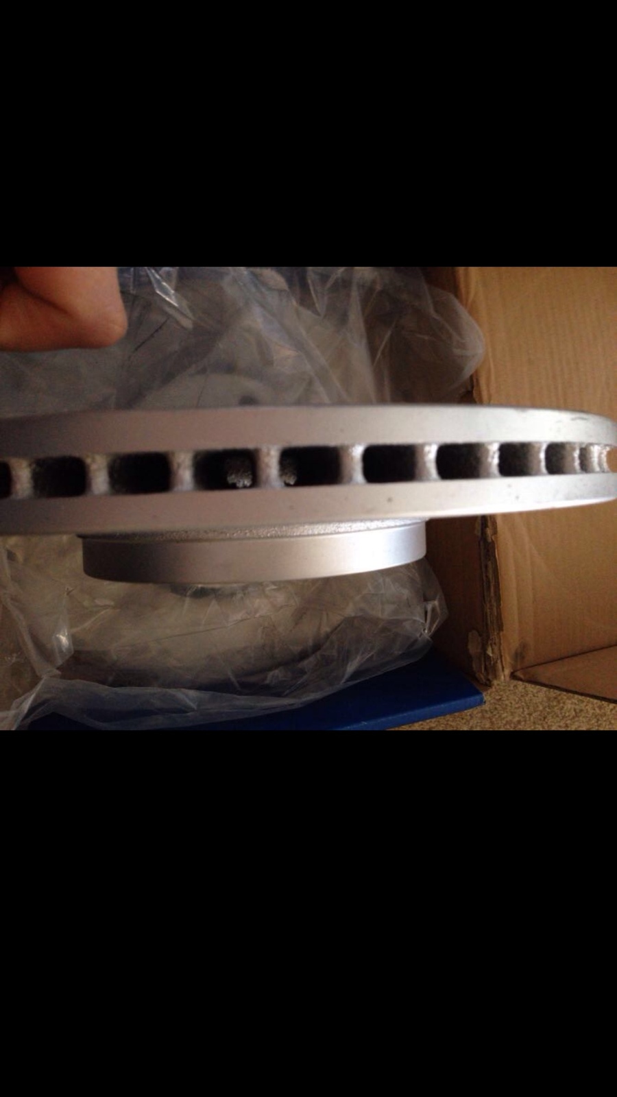

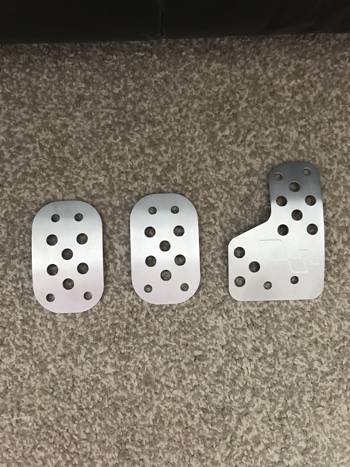

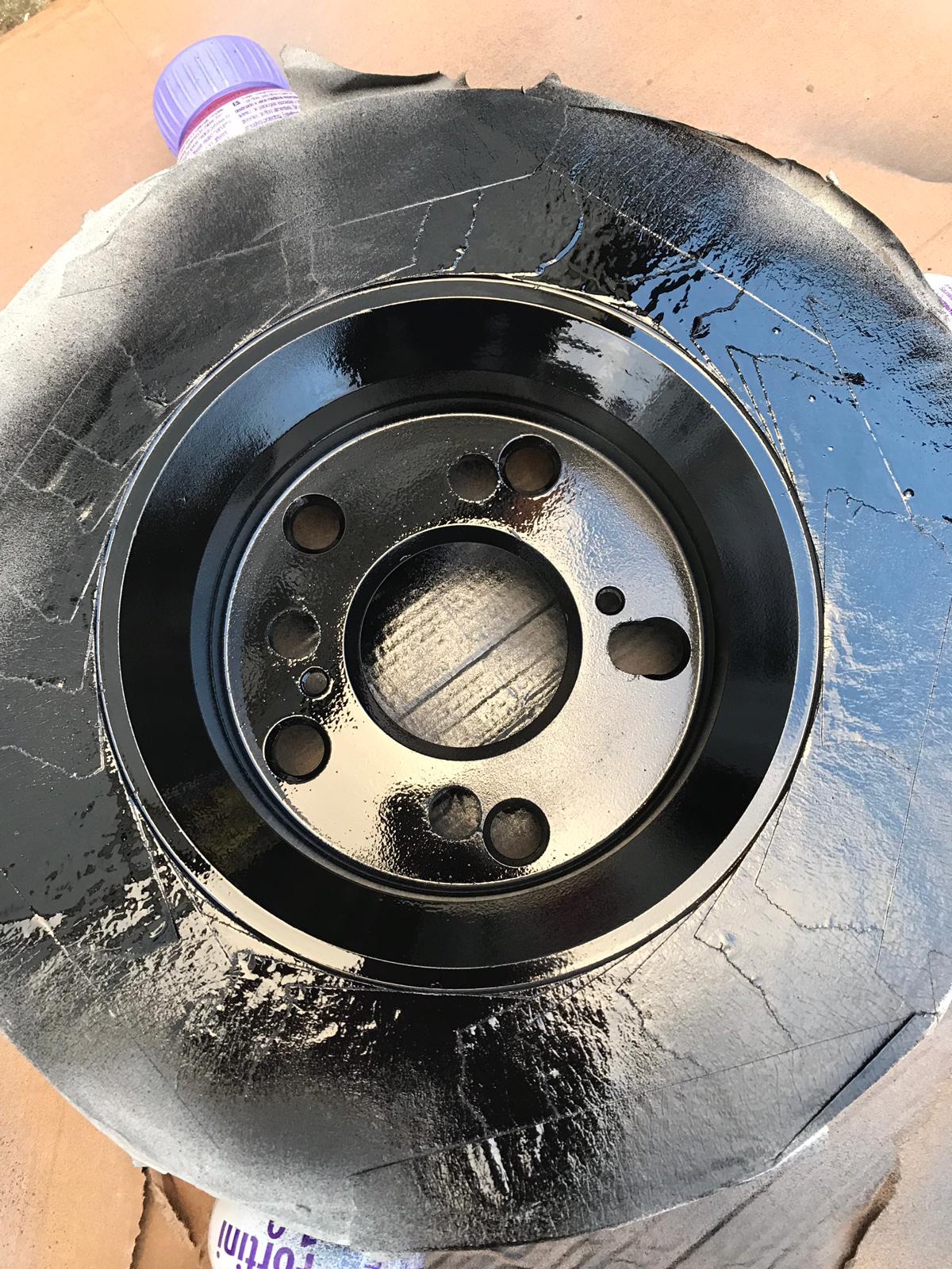

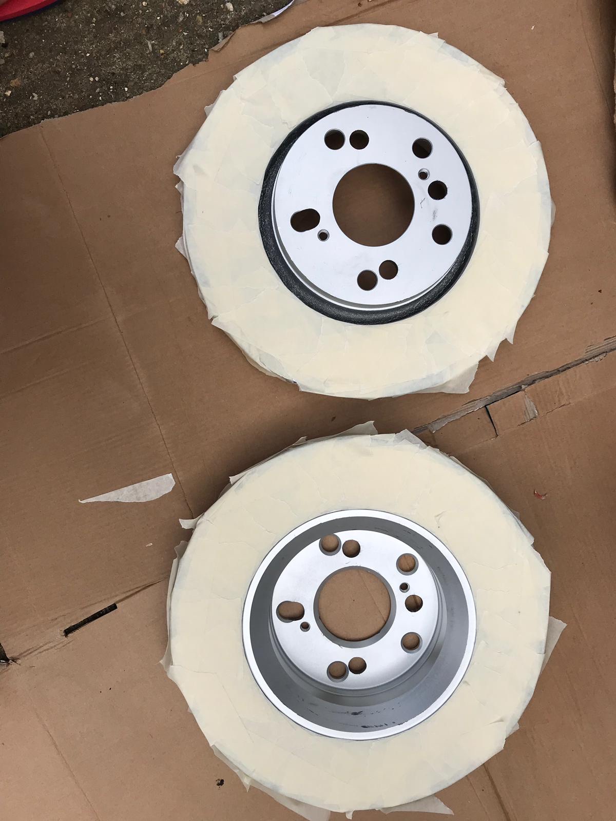

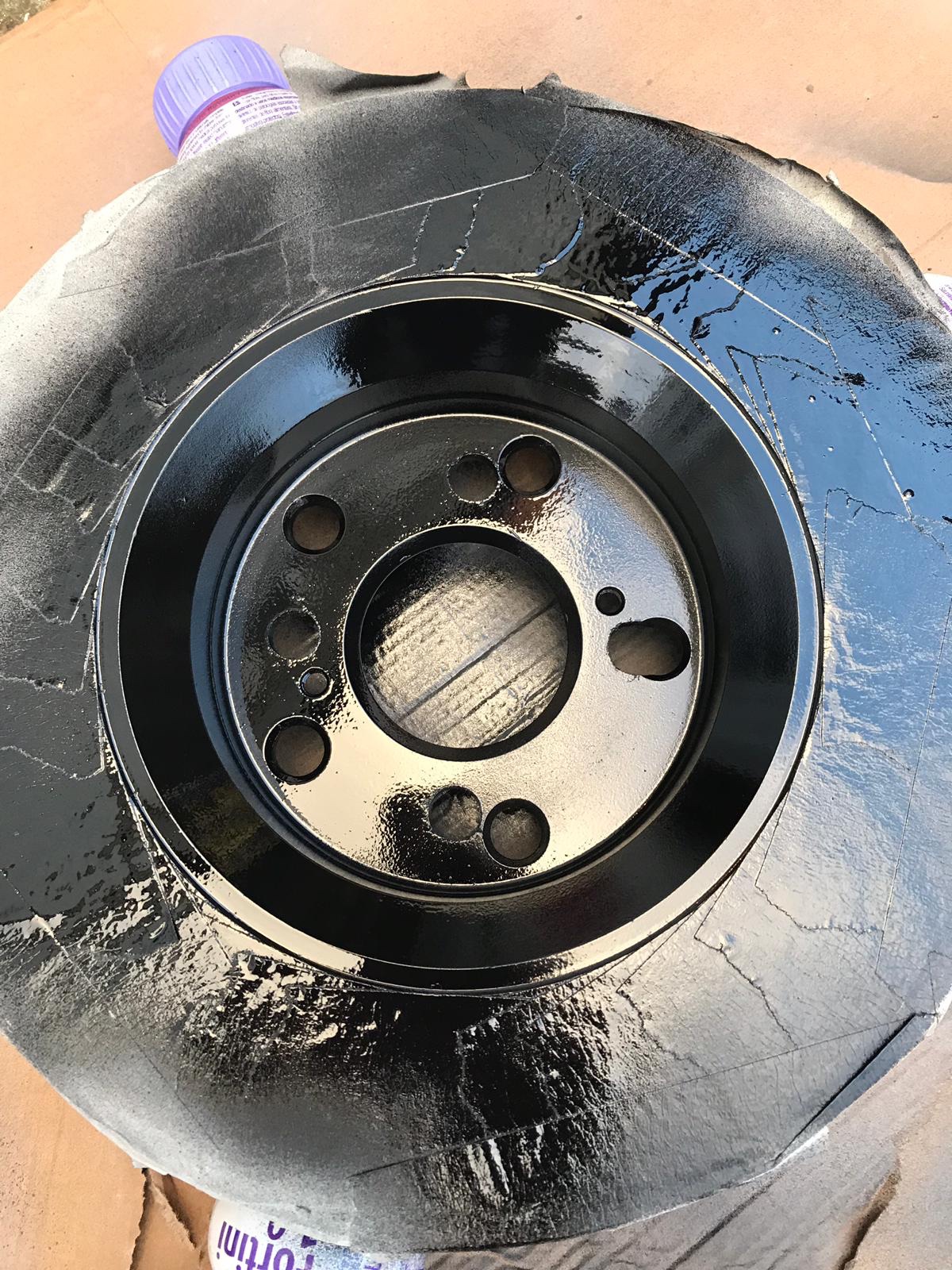

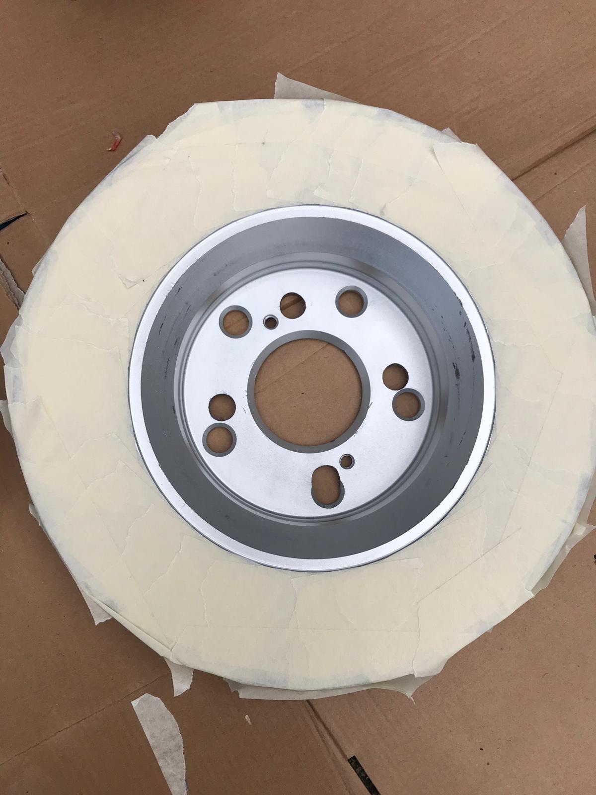

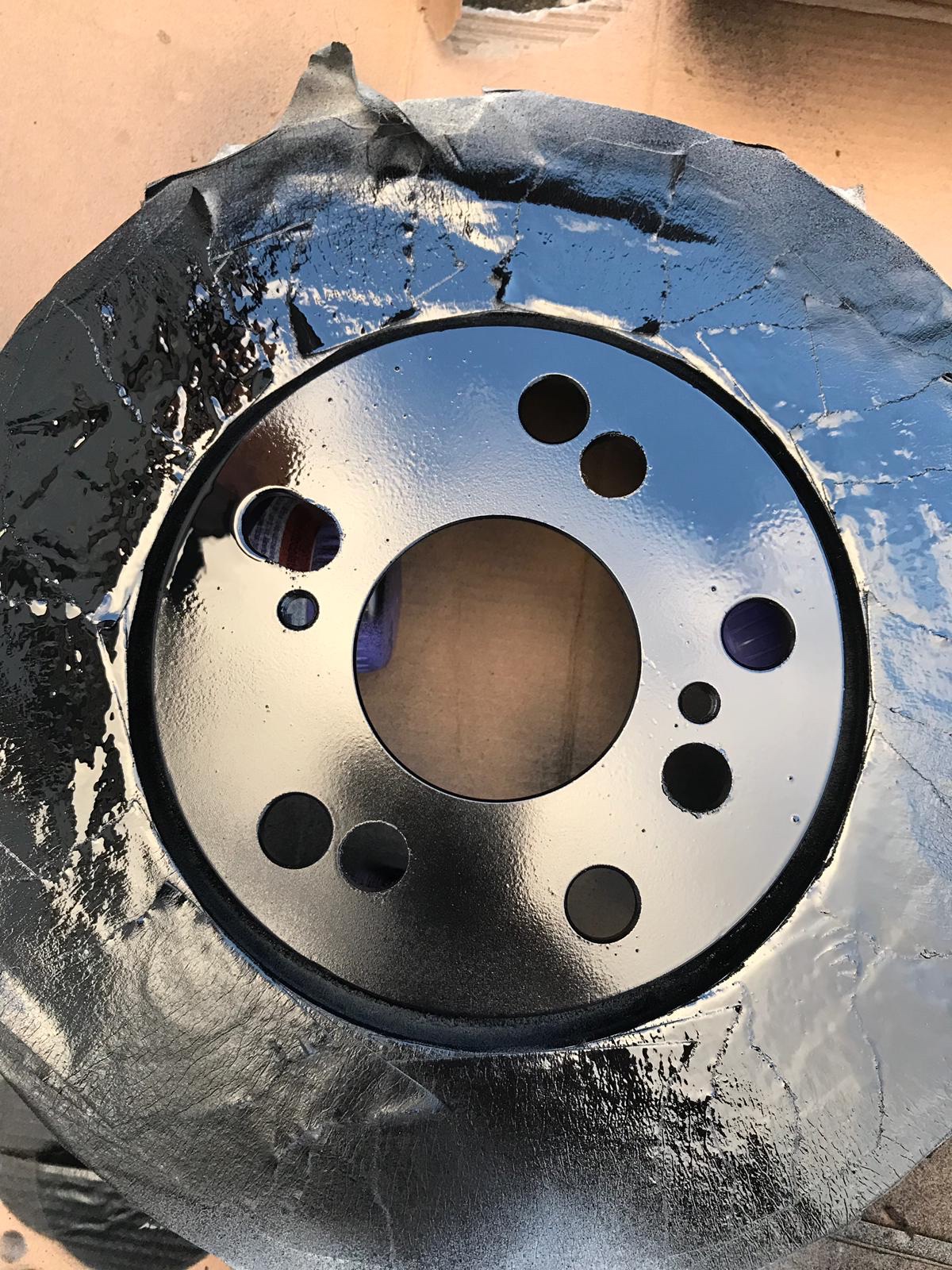

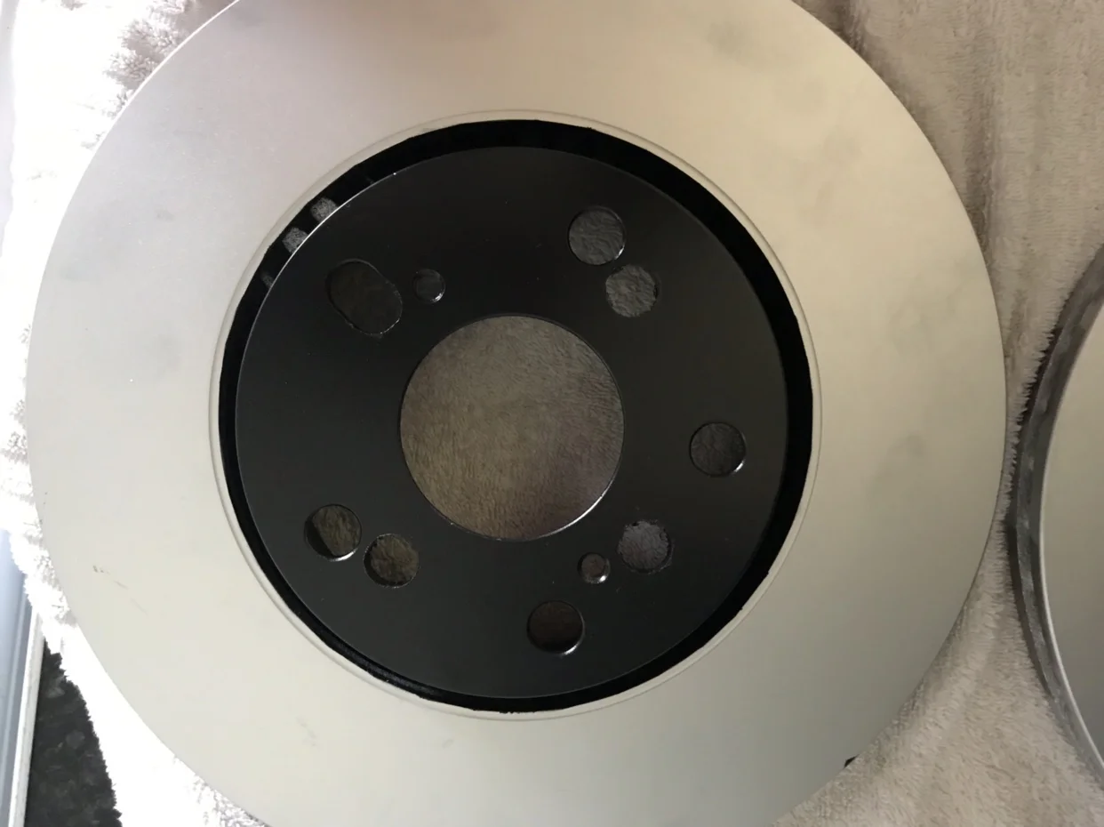

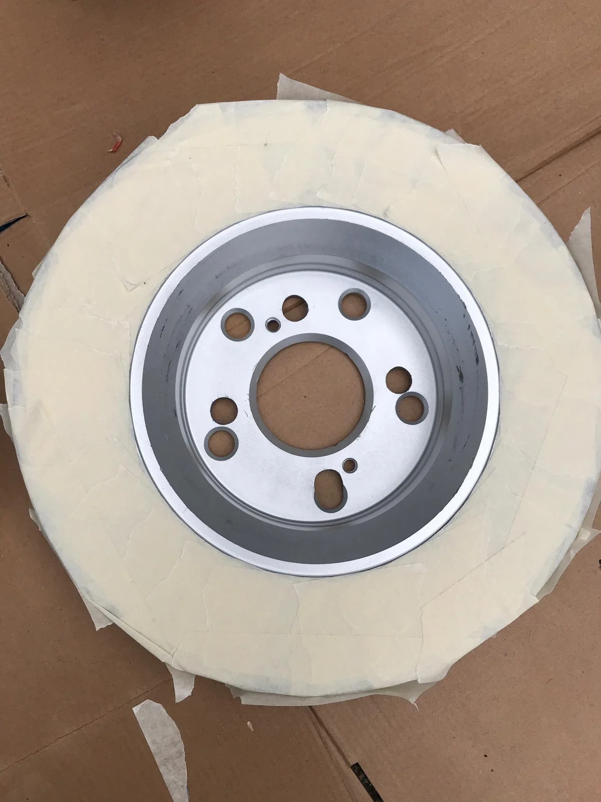

Got the complete set of peddles to match my footrest that is now installed in my Cup,will be fitting them next weekend on my day off.

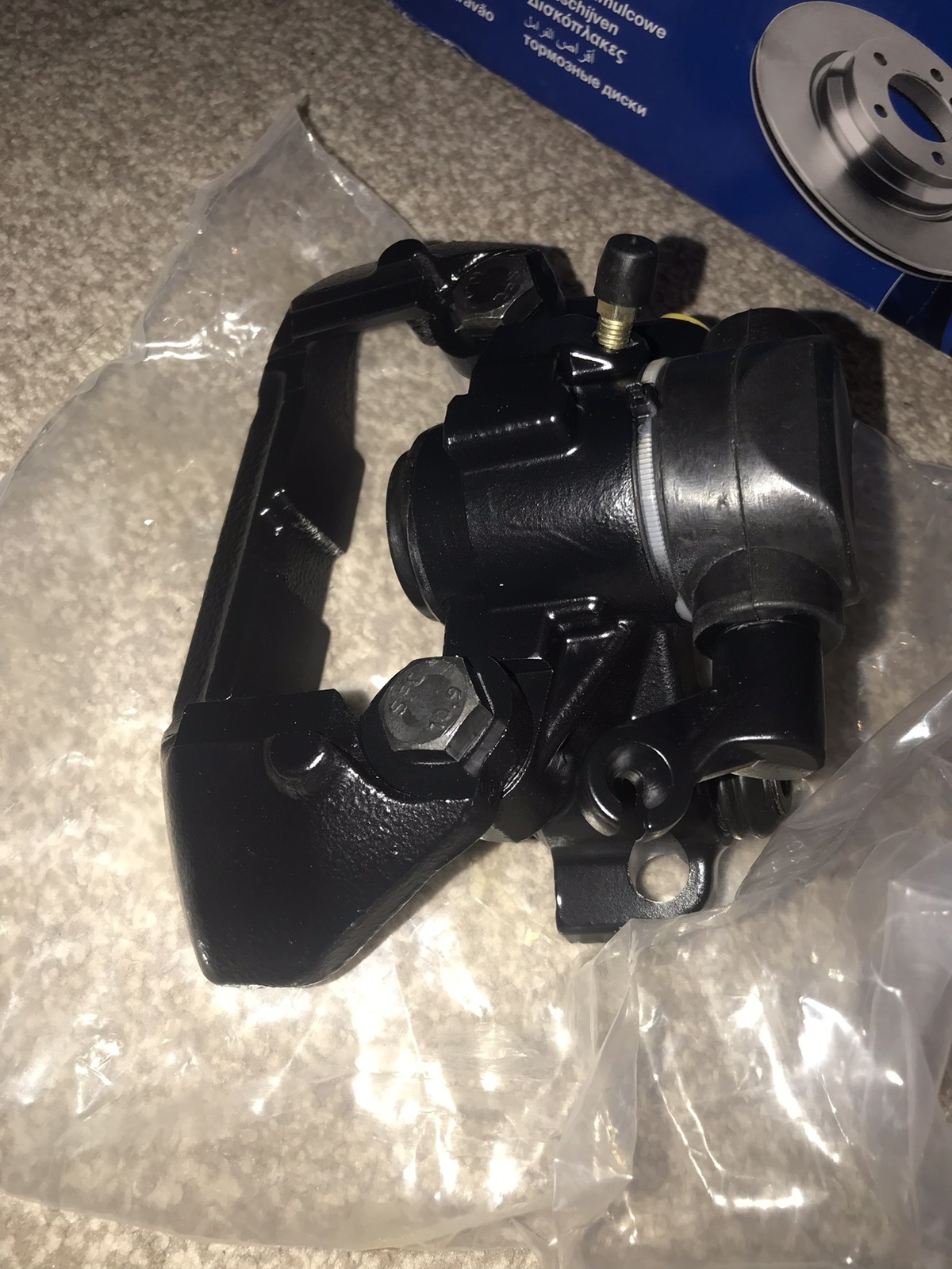

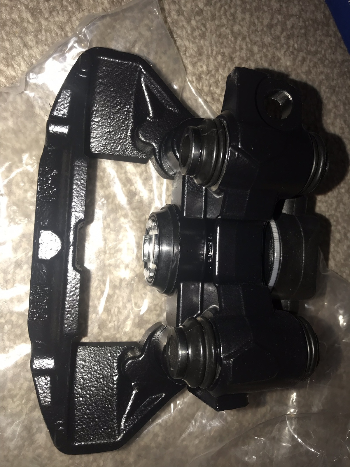

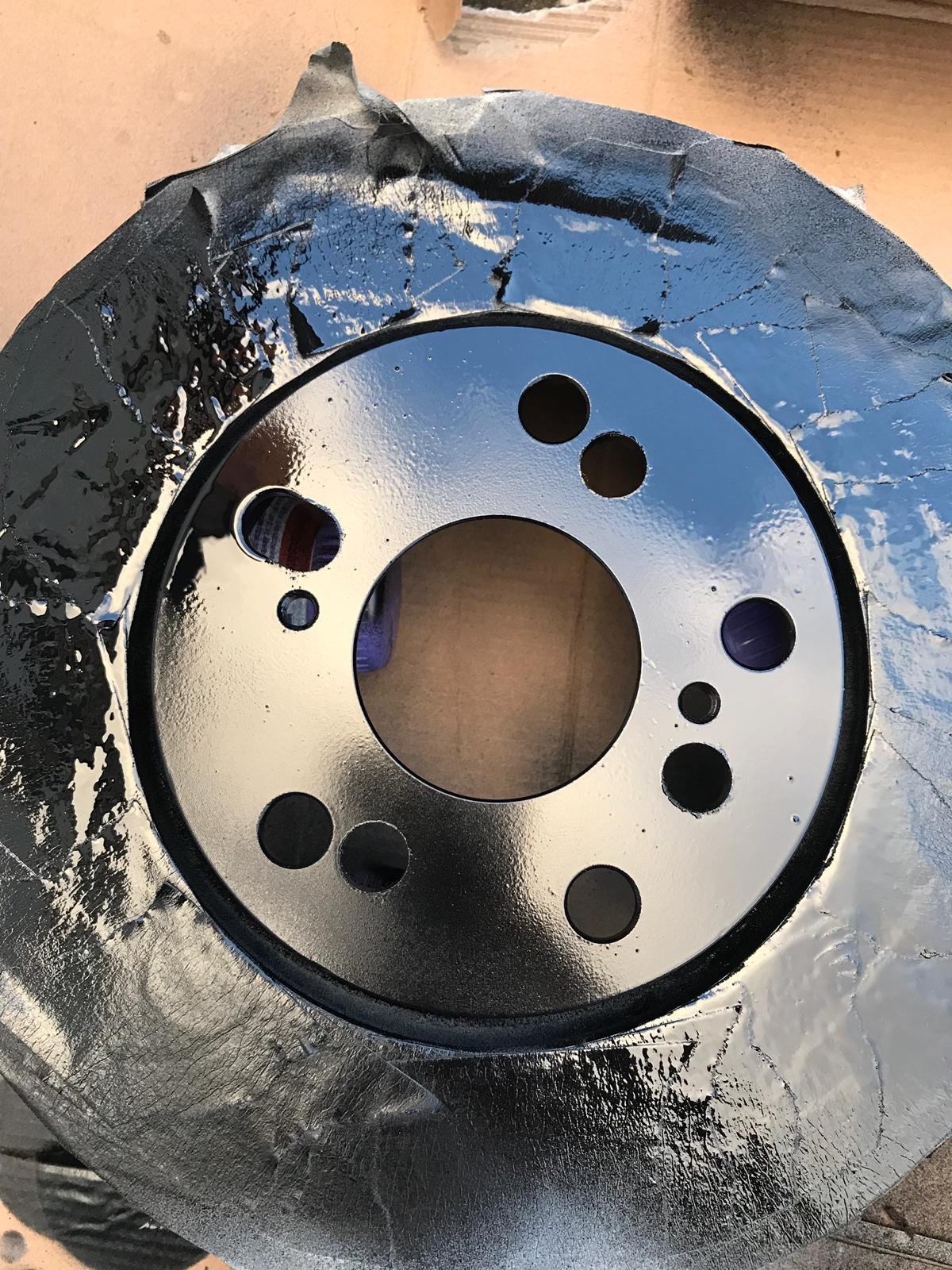

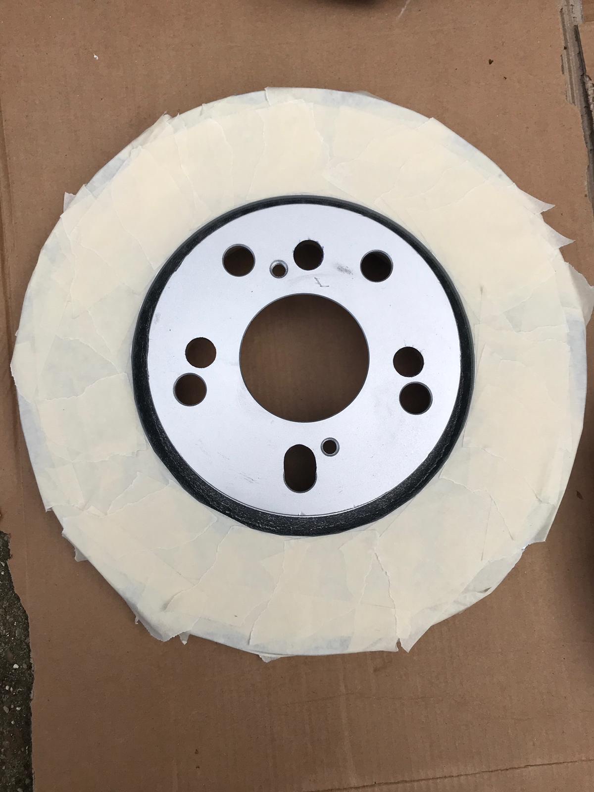

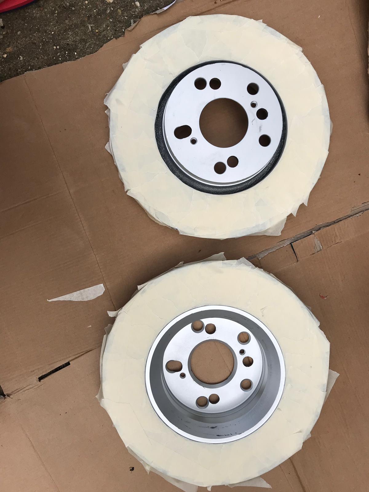

Also finished spraying the fully refurbished rear calipers with VHT calliper primer and a couple coats of VHT black caliper paint...
They will also be getting a wheel ceramic coating added to them for longevity protection to prolong the finish.I will be fitting new rear disc along with new rear brake spacers that I purchased off of George@RTR parts...that I highly recommend for his customer service fast delivery and excellent prices[emoji1417]More to come as soon as the bank manager allows i.e “The Wife”[emoji33]...SJ.

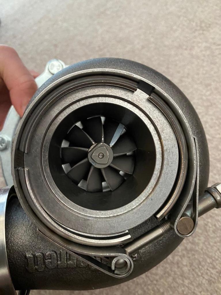

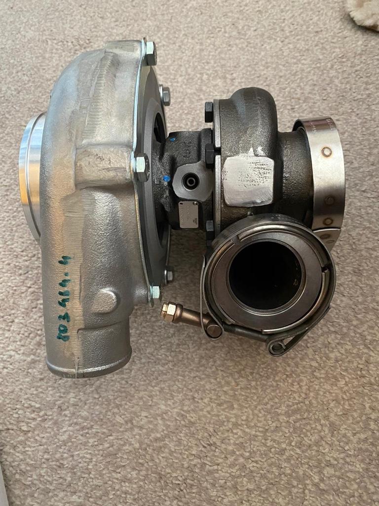

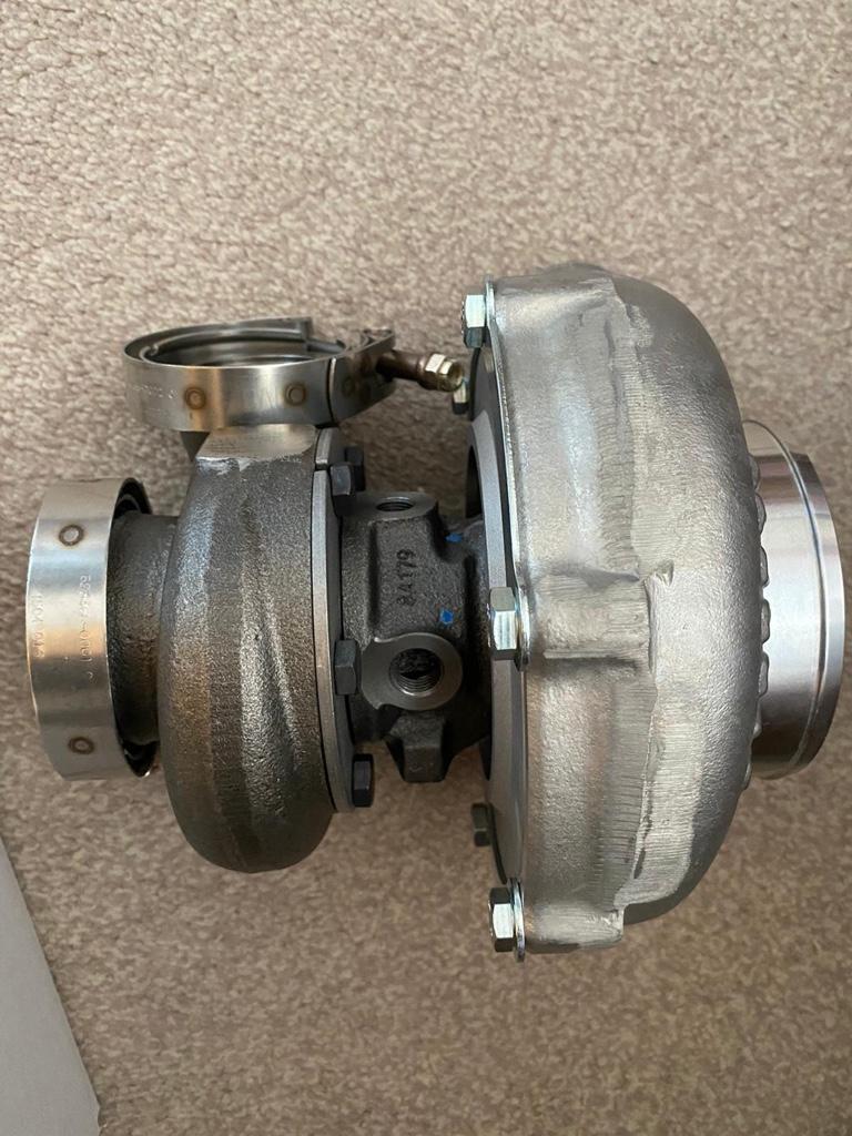

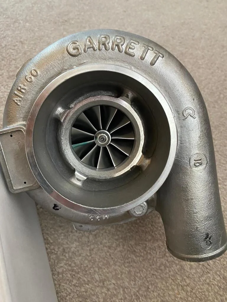

Right first things first my new turbocharger “GTX2871R” direct from my mate at Garrett turbos,i thought that I would start with the turbo as their is no going back now,plus i have a custom turbo manifold being made up as my turbo will run all round Vband connectors...
More to come of the other parts just taking pictures:)

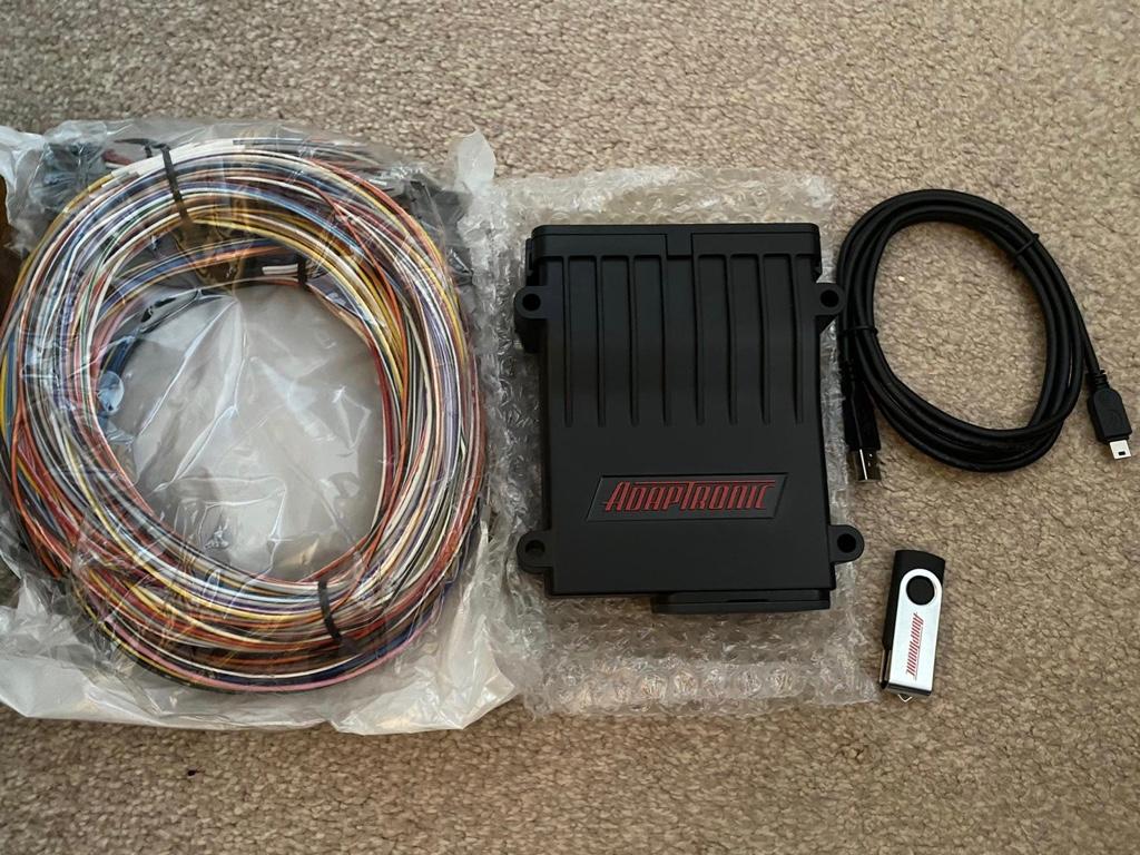

And last but not least the brains to eventually keep every part happy,a new Adaptronics ecu and loom...
my wallet is smoking now Looool...

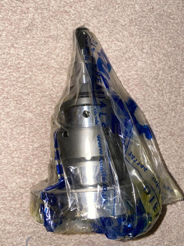

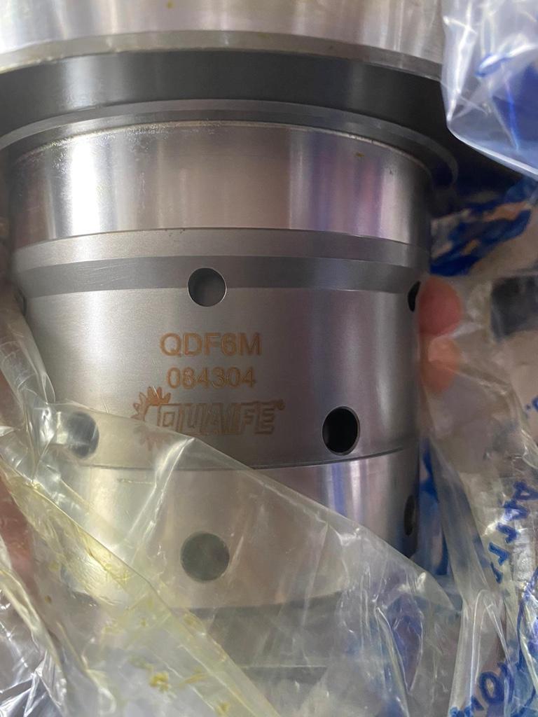

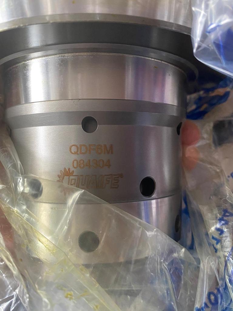

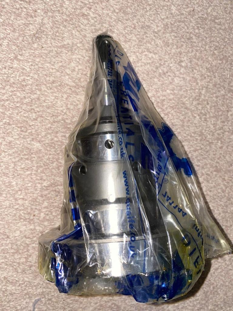

As i am looking for my car to have a chance of handling the power i thought that a quaife diff would be a necessity...View attachment 1462333
Sent from my iPad using Tapatalk
Send me a picture of the batch number on your diff mate - you may need to send it back as they’ve had a few issues with certain batch numbers.
I’ve had to send one back to them for a box I’m currently rebuilding for someone. 🤦🏻‍♂️
Where would I find the batch number mate?

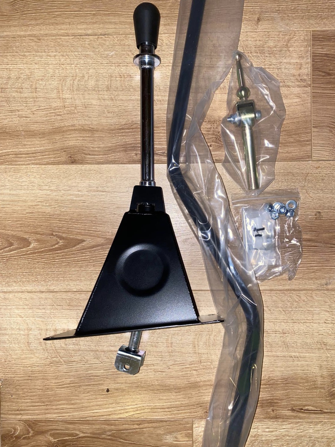

Well I said that I would not spend no more money but after cooking dinner for the wife and giving her a foot massage;) i convinced my wife to buy me a PMS gear shifter it was not essential but a good friend of mine had a bad accident in his Clio and had the PMS shifter that he purchased a while ago stored up but it was still brand new never fitted...
So I practically stole it off him for a Ton and a bottle of Jack Daniels...RESULT(y)
