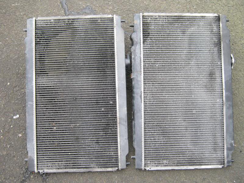

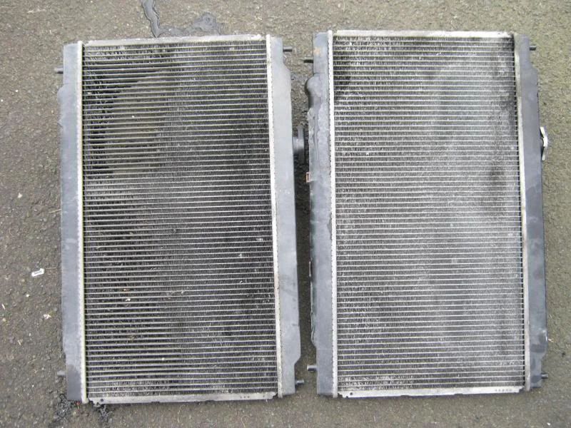

just fitted the rad i got from the breakers afew weeks ago, old one's on the left I'm amazed the temp never went up on track with this lol -
both 10mm bolts sheared off on the rad brackets which was a ball ache, filled the rad with some 5yr mixed coolant from euro car parts!

drilled out and tapped a new m6 thread in for the rad brackets so the rad's all secure again now!

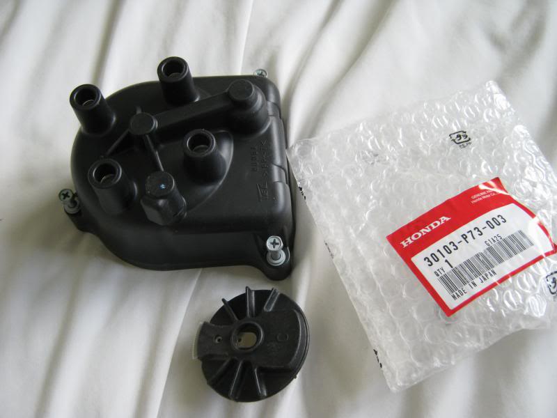

it's been misfiring intermittently for the past few months so finally bought genuine rotor arm and dizzy cap from tegiwa -
went to change the rotor arm and the screw was previously rounded off from overtightening by the looks of it (old cap and rotor arm wasn't genuine so had defo been changed) so had to drill that out, then I noticed a wire had spliced/broken inside of the dizzy and whilst drilling out the screw I broke the plastic casing that goes around the magnetic part of the dizzy so I went back to the breakers and picked up a new dizzy with a really good condition rotor arm and cap so theyre good spares, all fitted with the new parts, lined the dizzy up by eye to the slots on the old dizzy (was easy as from the oil leak on the vtec solenoid gasket last year there was still oil over the slots so was easy to see where the penny washers lined up on the bolts holding the dizzy on), will get it checked in the near future but the car feels great again!

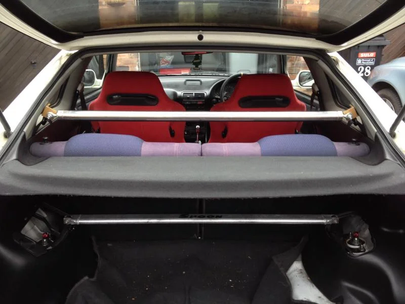

ive also bought a c-pillar strut brace to mount my contour hd on for trackdays in the future!

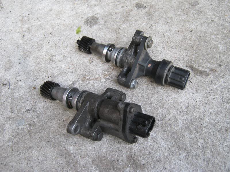

since changing the dizzy, cap and rotor arm it hasn't misfired once (still need to get the timing checked) but now the speedo's playing up, it was playing up when it used to misfire intermittently and now it's still doing it so I got a couple of these from the breakers -
URL=http://s652.photobucket.com/user/jamierigby/media/IMG_4040_zps1024be14.jpg.html]
[/URL]
theyre vss/speedo sensor's that drop into the top of the gearbox, fitted the one that was the exact same to mine, yet to test it but fingers crossed no more speedo playing up and the car holding back and ecu light coming on lol

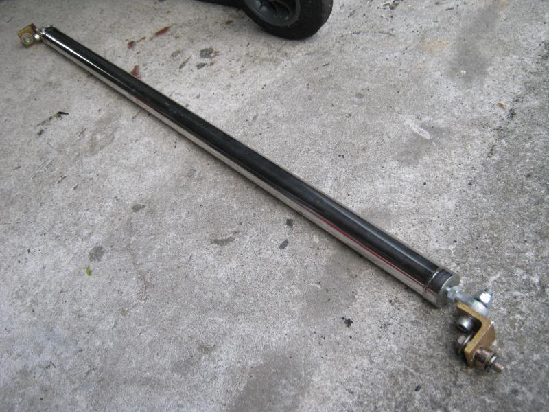

bought this, a custom made c-pillar brace -
really well made, the only reason I've bought it is for trackdays to mount my Contour HD camera off for some high revving track footage, yet to try it as it'd be right in the way of the passengers heads whenever there's someone in the back

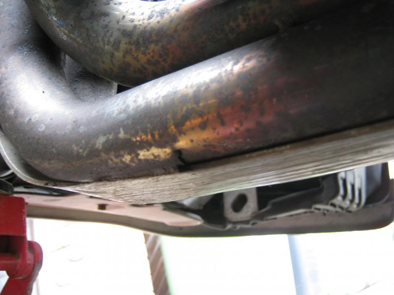

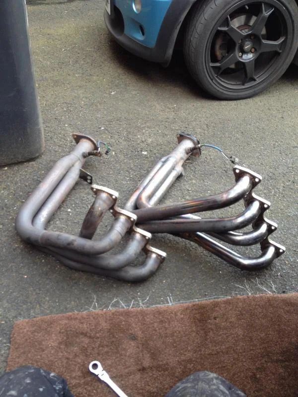

lastly my manifold's cracked -
need to get it welded up asap before it gets any worse, cheap japseed crap! on the lookout for a DC Sport or 98-spec manifold!

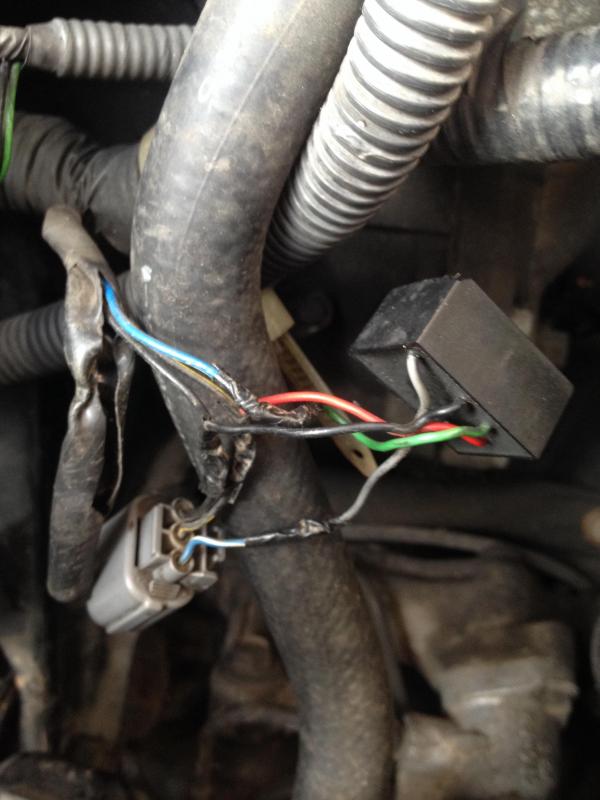

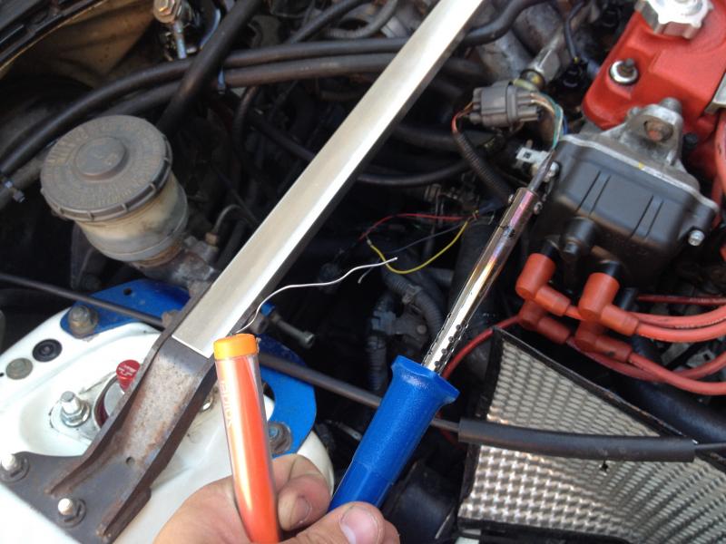

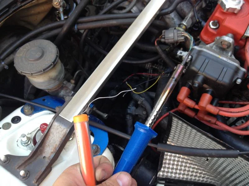

so... obviously I tested it after fitting the speedo sensor, no joy, tried the 2nd one I got, no joy... after some research and asking people questions and running a diagnostic and it showing error code 17/speedo sensor it must've been this playing up -
...the kph to mph convertor that's wired in right next to the plug for the speedo sensor, so Ive cut it out and linked the wires back to how they are normally and ITS FIXED f'in finally, just now I have a speedo in kph which is abit crazy but I'm going to order a new convertor and tee that back in.

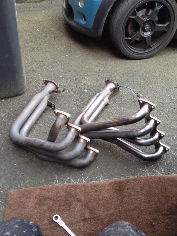

the other bits ive done in the last month are a new manifold to replaced the crap cracked one, a very rare 5zigen 4-2-1 -
car feels abit more 'free-er' with this on and sounds a tad more raspy

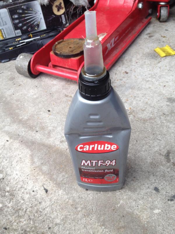

changed the gearbox oil which was a blag as it taken over an hour to fill it back up as it just poured out if you rushed it, used the proper grade stuff -

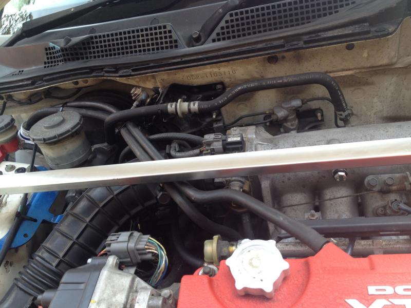

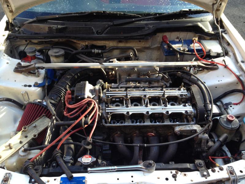

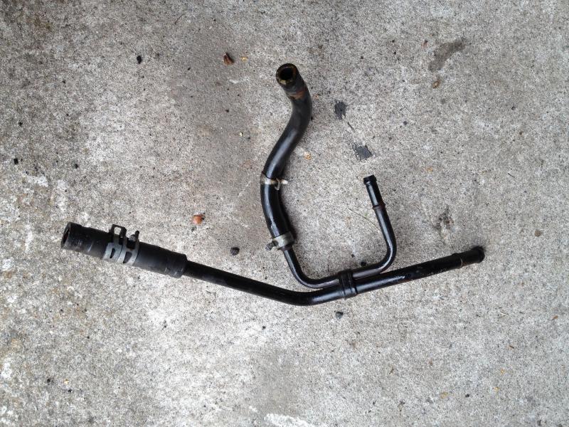

removed this pipe... -
to make way for a catch tank with removing the pcv valve and blanking the inlet you can just make out under the strut brace -

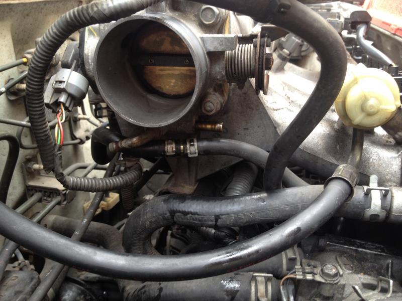

and the other part of that metal pipes for a 8mm coolant hose that runs to the TB, so ive bypassed that to lower intake temps -

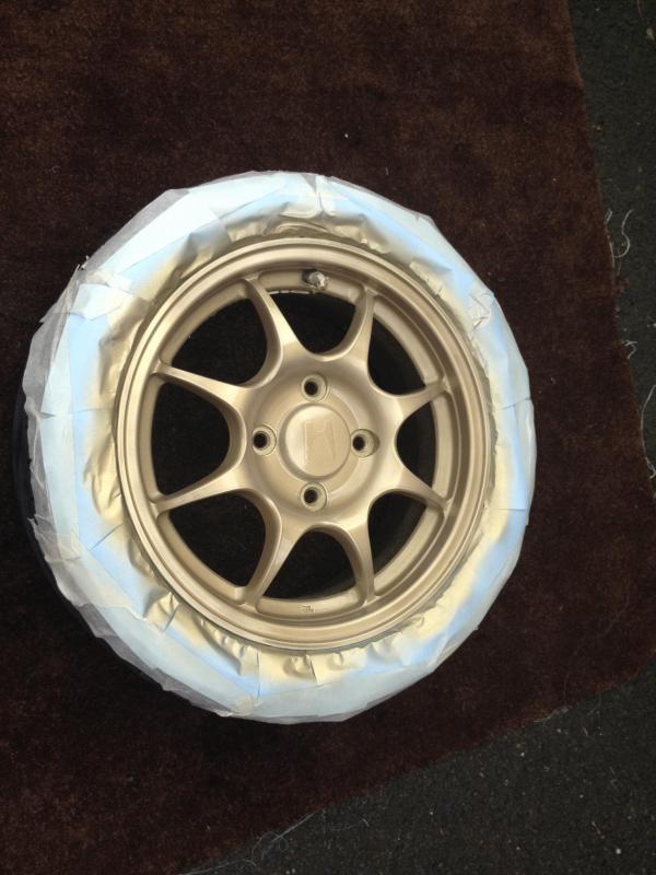

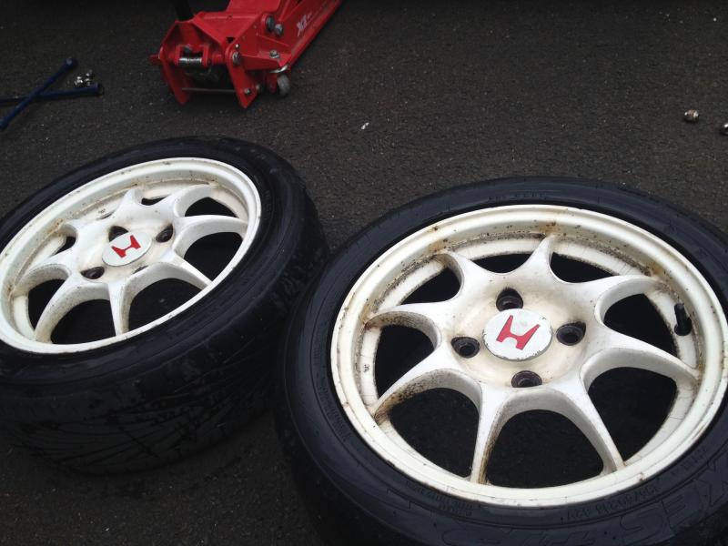

Wheels needed a refurb and been meaning to do them for ages so a couple of weeks ago I gave them a go... Washed ready for sanding, can see just how bad they were -
So I went for a colour change -
Hammerite smooth gold... I think it made the car look very dated so decided to sand them back and paint them white, the primer reacted so I've had it in mind that they were going to be powdercoated but decided against it and bought these instead ...
Rays Volk TE37 15x7j ET40 with 2 brand new and 2 with 3mm left Yokohama Paradas, I bought some Michelin PE2s last week off Black Circles I may see if they'll return them once I've done Afew more miles on these Paradas to see if I think they're good enough to stay on

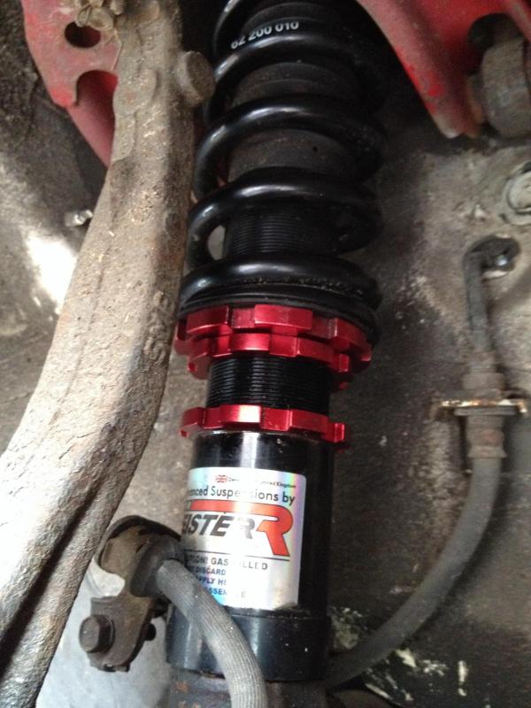

Changed the springs on the coilovers from 8kg front 6kg rear as I have the Zeta S coilovers and bought a pair of 10kgs from MeisterR for the fronts and fitted the 8s on the rear.., MUCH better it's how a teg should feel now... lowered the front afew MM more than the rear this time as I've only put 1 turn of preload on them instead of like 10turns on the old setup.. It's much better now it's going to be mega on track now when stiffened up and for the road on fully soft it's like it was fully hard on the old setup so win win happy with them!

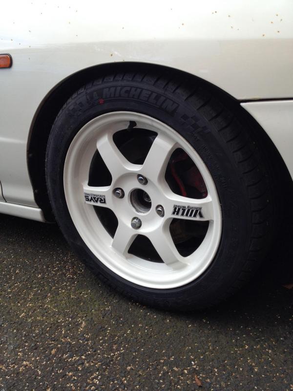

Michelin PE2s fitted -
Only done 60 or so miles normal driving on them so not proper bedded in yet but they already feel awesome

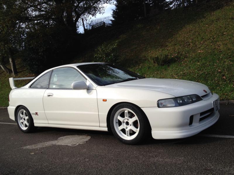

I've ordered a spoiler from the states so to suit that I've had to drop the ride height a tad...
I was thinking of dropping it 10mm all round but it turns out it was only 7mm from all the way down on the fronts even with 20mm of thread showing -
.. The coilovers have hit the bottom of the body/it won't wind in anymore if you get me.. Im not too fussed but i just find it weird that there's still 20mm of threads showing when there's 0 preload on the springs
So the ride heights now like this, think it's perfect anyways tbh -

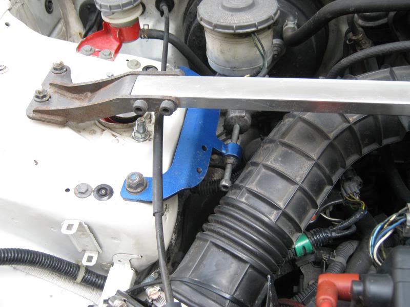

Also fitted the c pillar brace ready for oulton in a couple of weeks -
I thought it would affect the head room in the back but it doesn't so it'll be staying in permanently

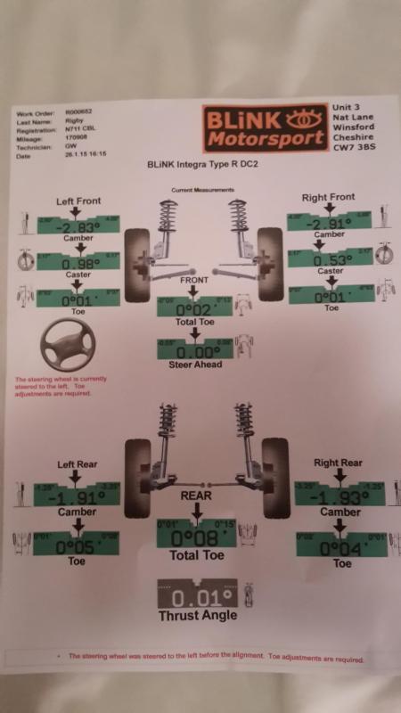

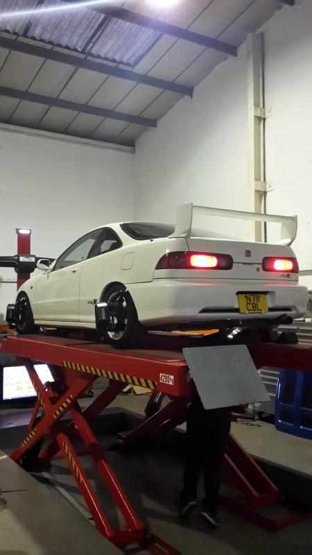

So, fitted new track rod ends and been back to blink Motorsport to have the alignment done again since lowering it, have -3 camber on the front, 0.02 toe in overall.. -1.75 camber on the rear and 0.06 toe in

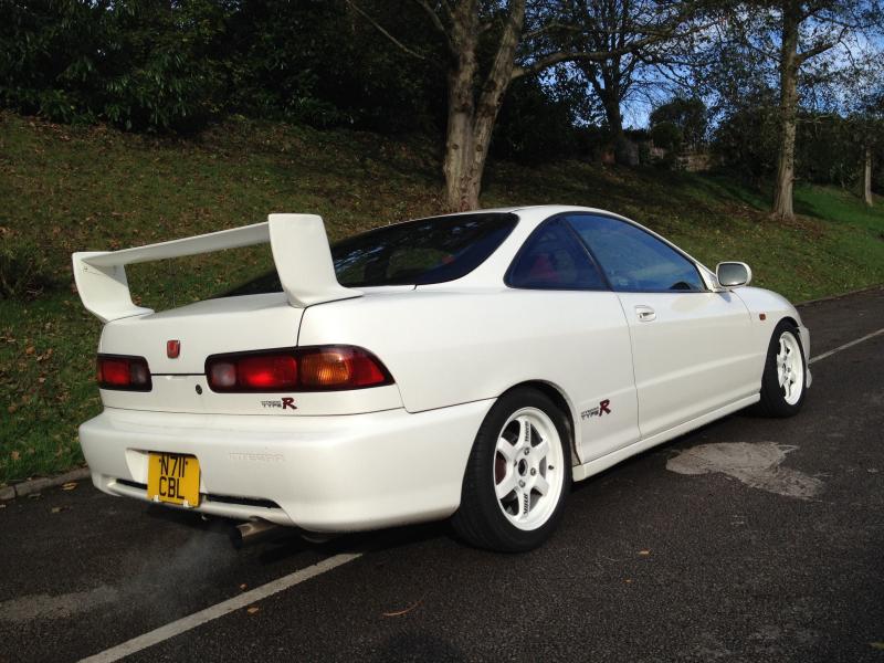

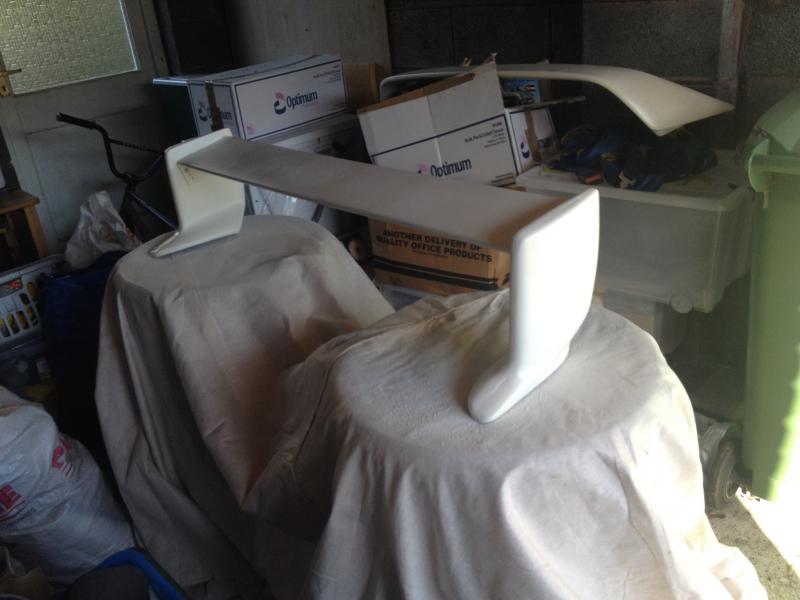

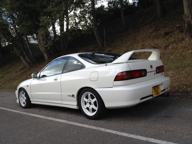

About 5 weeks ago I ordered a mugen replica wing from the states, arrived last week..
Sanded, primered, sanded painted then lacquered -
Pic of the car without the own wing on, looks so American haha -
New wing fitted -
Love it think it looks proper aggressive with the wing, wheels and lowered ride height!

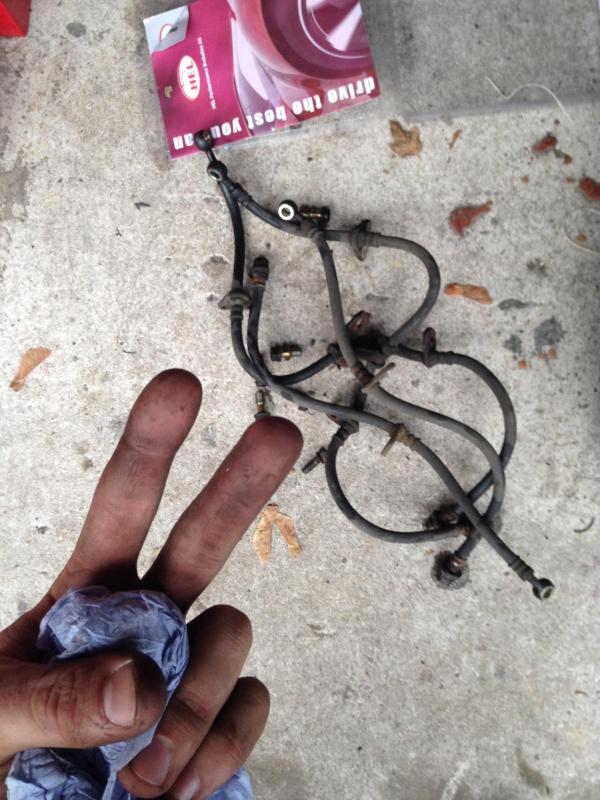

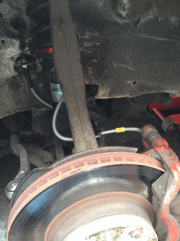

Changed the brake hoses for some HEL braided ones -
All bled up but both front nipples are leaking ever so slightly, wasn't happy with them when I replaced them back in May but they never leaked so I left them but now I've ordered some more to try!

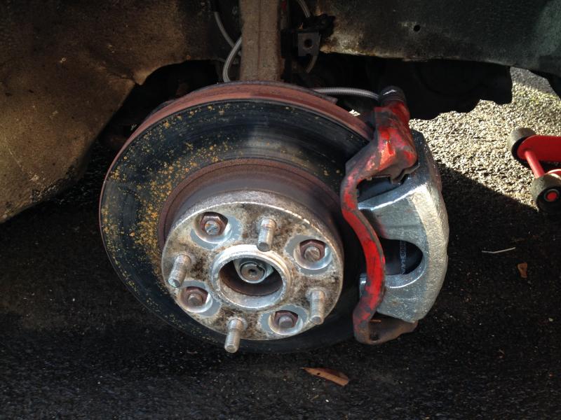

Moving on... The other leak was from the threads on the bleed nipples, after trying 3 sets and still leaking I bought some new rebuilt calipers from euro car parts, fitted along with a new set of DS2500 pads -

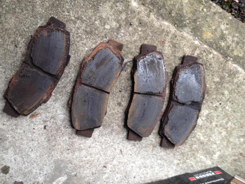

Old pads all evenly worn with 4-5mm left after ~18months use and 3 trackdays -

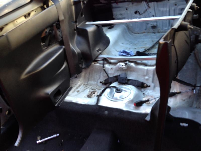

So, rear interiors still out for now as I still need to attend to a leak on the back of the OSR rear arch quarter in the boot side waters still getting in ever so slightly from the spray off the road
I've had the rear bumper off and under sealed all the rear
Had some Krust stuff on all the surface rust on the inside and smooth hammerited over it all

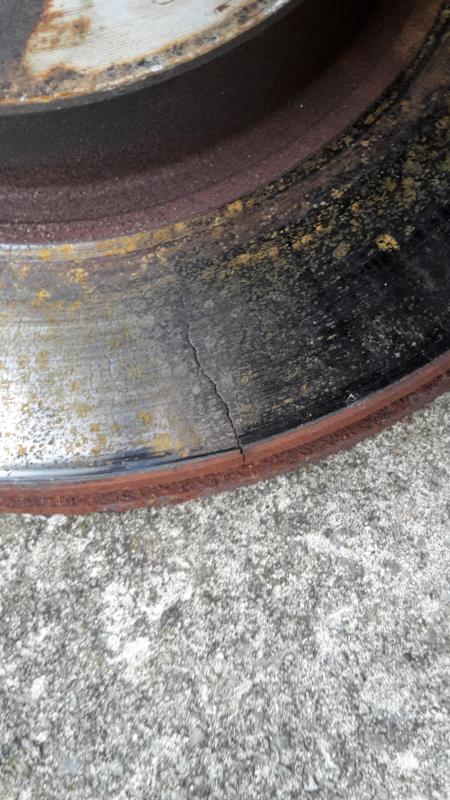

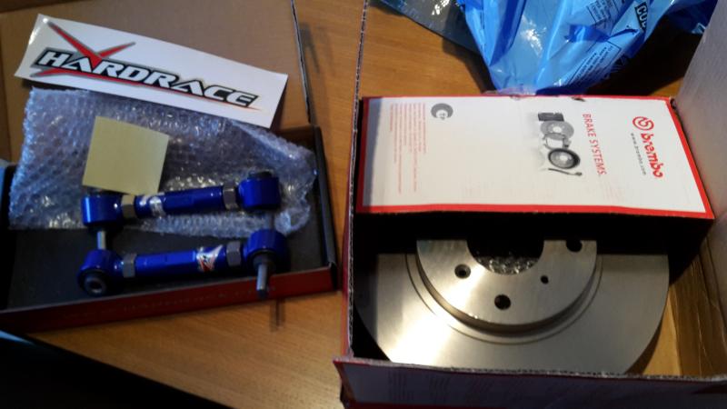

I've had a very slight what feels like intermittent wobble under braking so I've got a new pair of discs along with new rear camber arms as the inside bush shat the bed on the skunk2 ones -
removed the discs after having to nip to B&Q for some new drill bits to drill out the grub screws I found this -
haha so hopefully that'll explain the slight wobble, yet to test it with all the slush and salt on the roads!

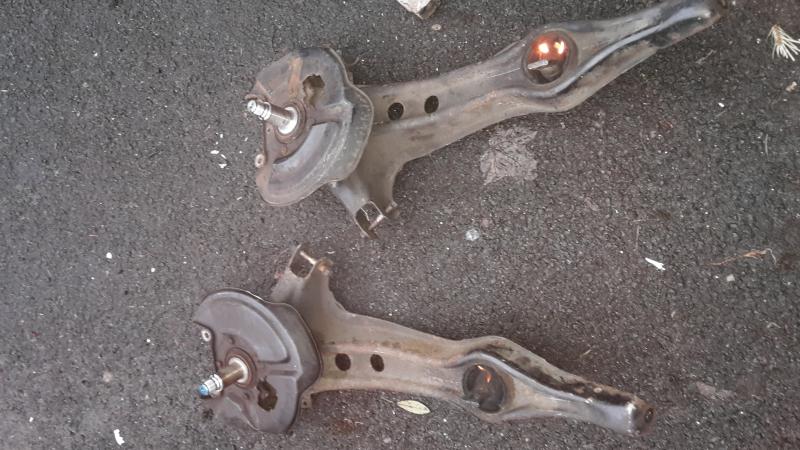

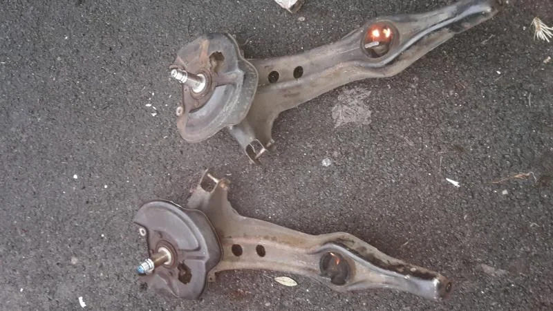

Changed the rear camber arms and noticed my rear trailing arm bushes need attending too so I'm just going to get a decent pair of arms from the breakers with some good bushes in them

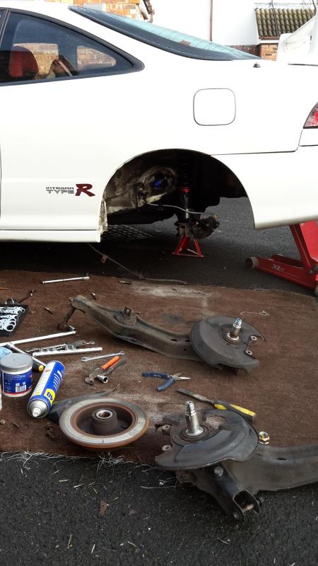

  JDM Dc2

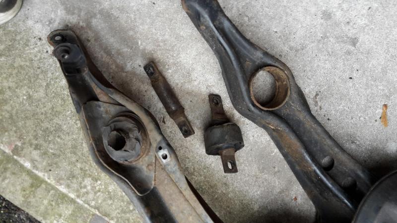

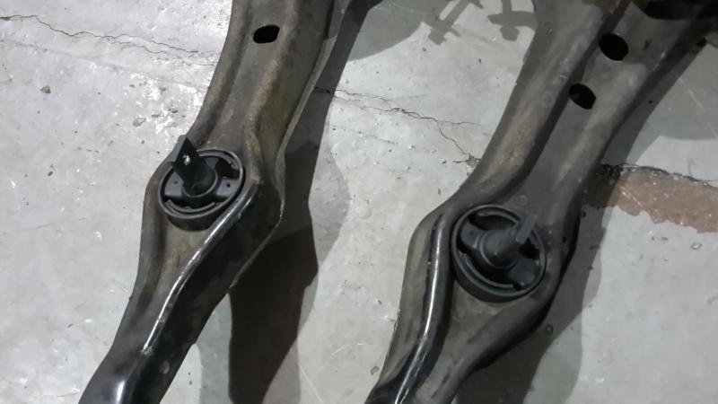

Got a pair of rear trailing arms from the breakers and stripped them down, got a pair of brand new genuine bushes too so burnt the old ones out ready to have new ones pressed in tomorrow
New genuine bushes pressed in -
then today I swapped them over taken 90mins per side -
Only one bolt sheared off luckily it was only the handbrake cable clip all the bolts came out reasonably sweet all copper greased back in
old bushes have seen better days aha -
