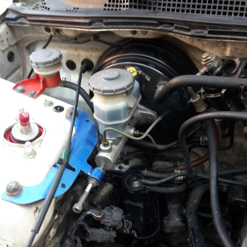

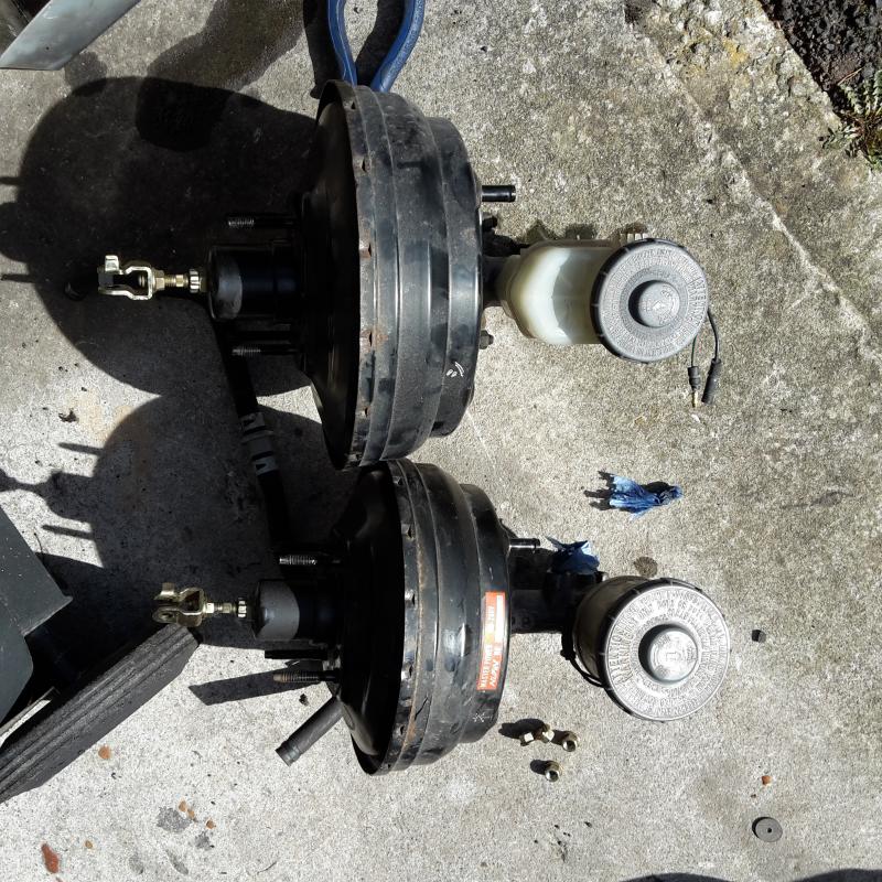

Picked up a uk/98spec servo and mastercylinder last week here it is next to the 96spec one -
Much larger and fitted -
was very tight to fit even with removing the brace and releasing the fuel filter, ended up splitting the clutch reservoir hose squeezing it past!
Needs re bleeding again as I ran out of fluid but I went around the car once so it's safe to drive again for now still very spongey atm tho

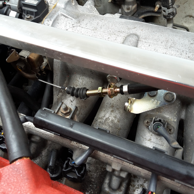

also got some BWR adjustable rear toe arms and a genuine ek9 throttle cable to fit this week

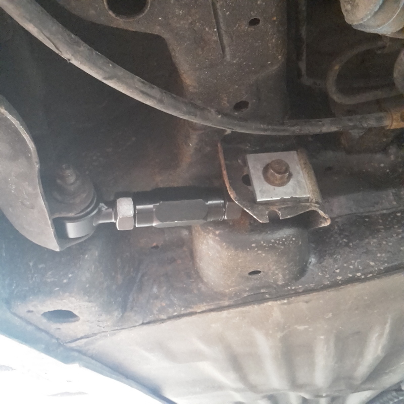

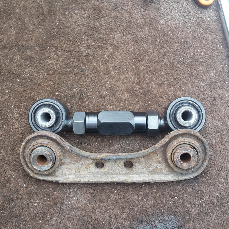

So, toe arm comparison, ~4mm longer even at the tightest point -
fitted, going to get that plate welded on so theres no chance of that moving again on the slots -
ek9 cable, there's 2 part numbers the one I gotten from tegiwa is too short... -
so I've moved it over so the ek9 bracket is just on one hole on the intake manifold so it's fitted for now, got another cable on the way over from japan to compare hopefully it'll be the right one

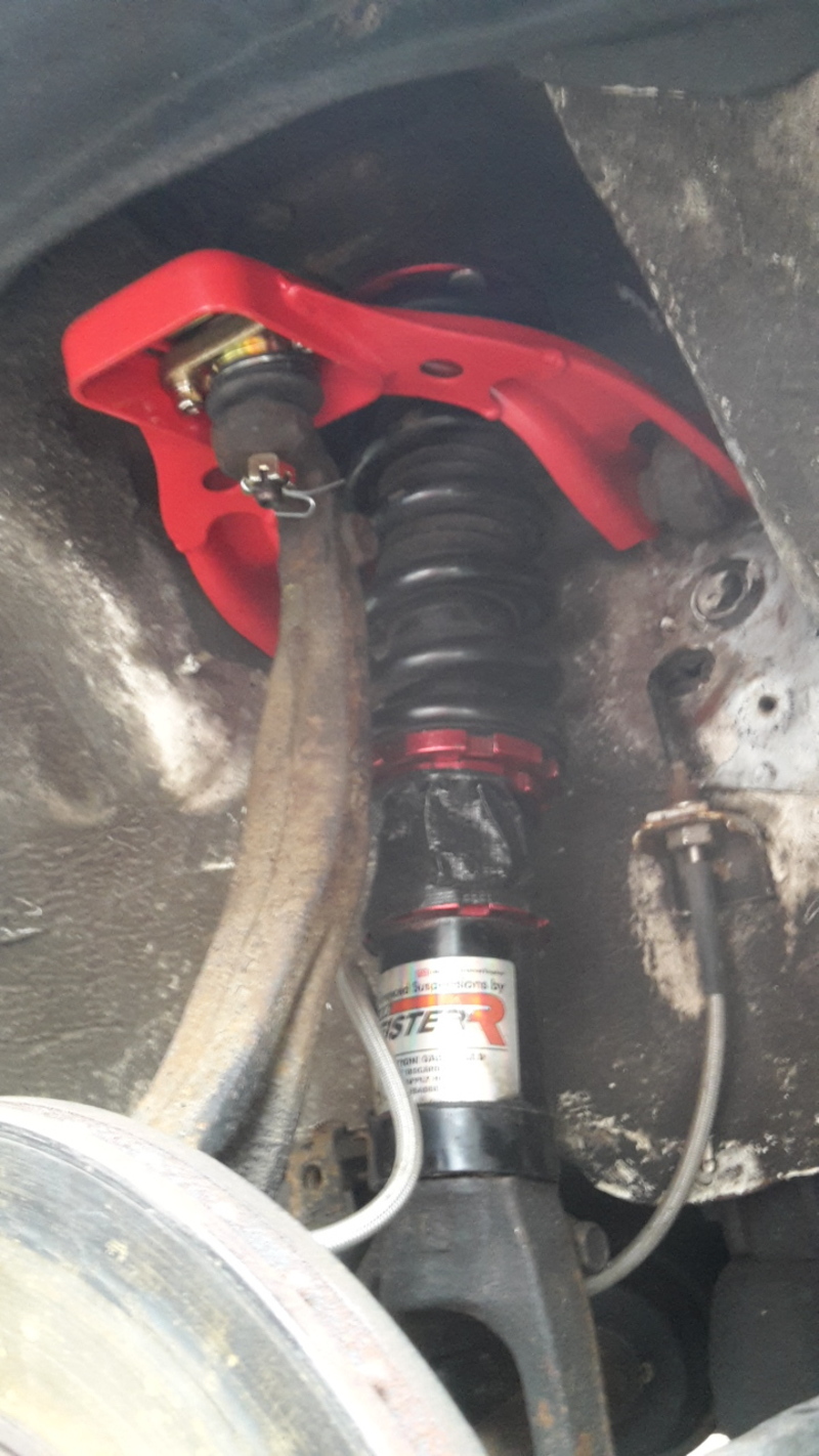

It was understeery at oulton the other week so I done some research and roll centre adjusters / extended ball joins are a must on lowered tegs so I ordered some and fitted them yesturday, had to remove the hub made the job easier, fitted -
I planned on raising the car 5mm so to counteract the 25mm extended ball joints I raised the front 22mm and 5mm on the rear and it's spot on now

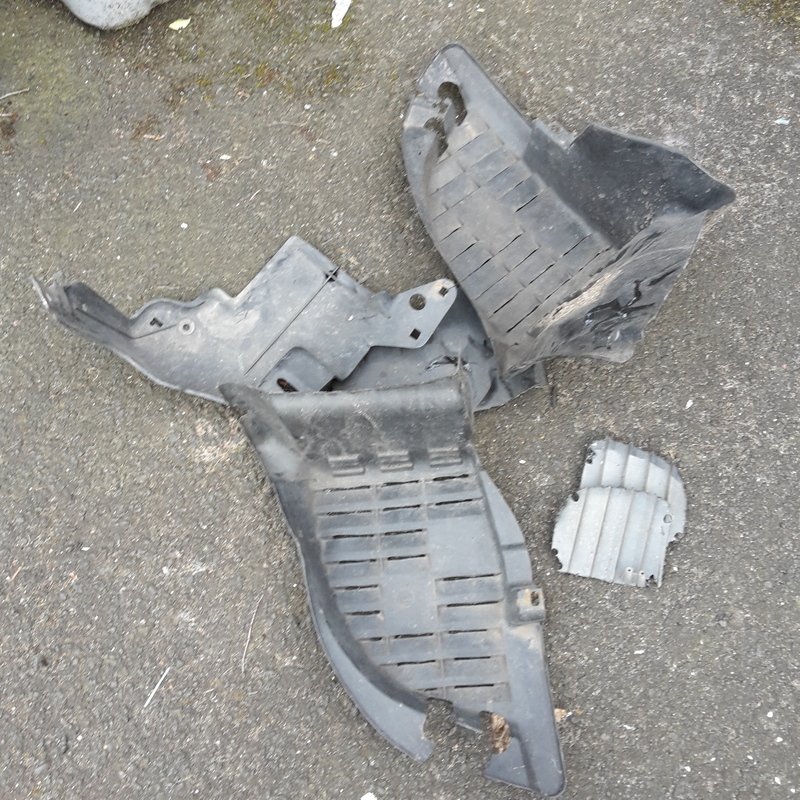

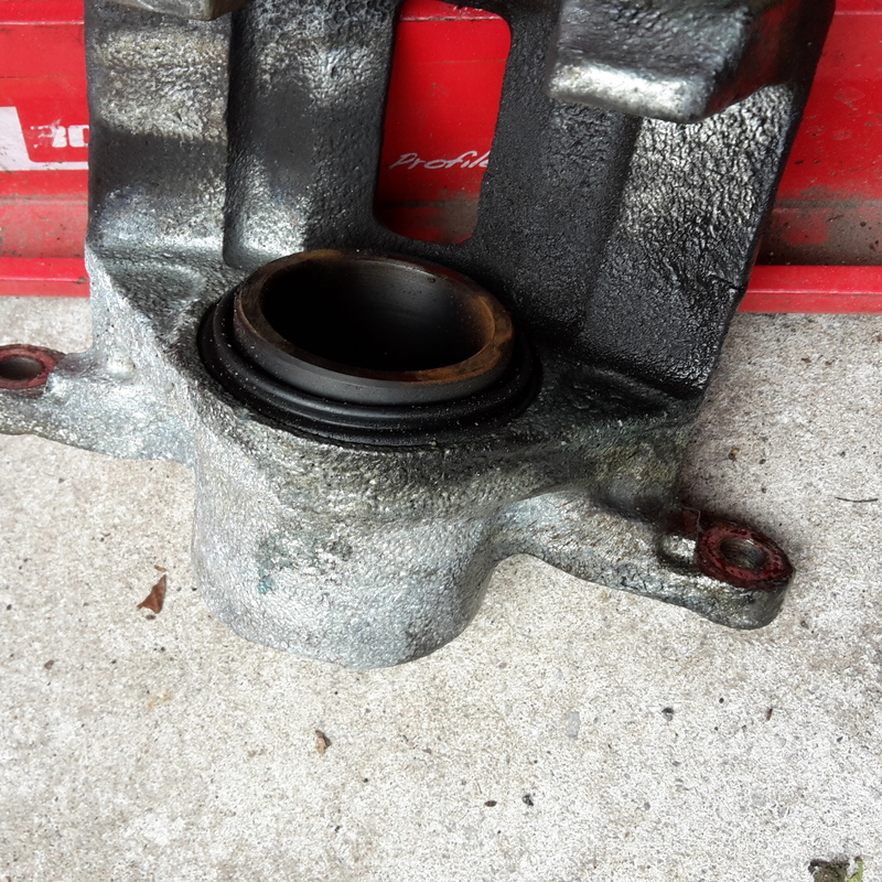

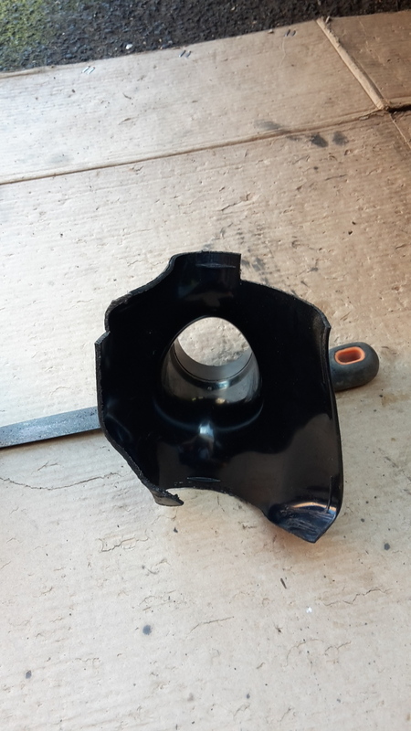

Removed the dust guards on the front discs to help with brake cooling whilst doing that I noticed fluid had been leaking past the piston seal on one of the new refurbed calipers -
So Euro car parts swapped that for me as they're in 12 month warrenty, all bled up again with the new Ate typ200 fluid yet to test them!

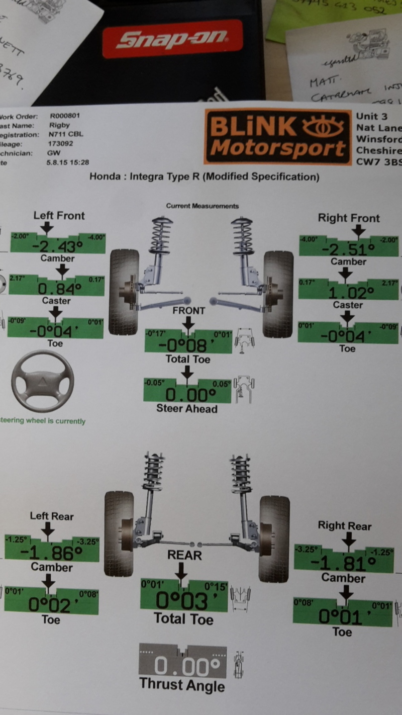

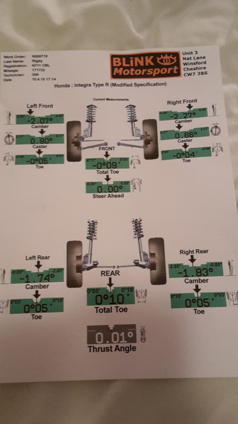

Had it aligned last week, with it being raised a tad I've lost a little camber on the front which im not fussed about as I've had it set to toe out now so less camber will reduce tyre wear on the insides with it toeing out -
drives better than ever now!! Also had them square plate washers tacked on on the rear toe arms so no chance of them sliding again!
Also received the second ek9 cable and and it's much better so fitted that and sent the other back!

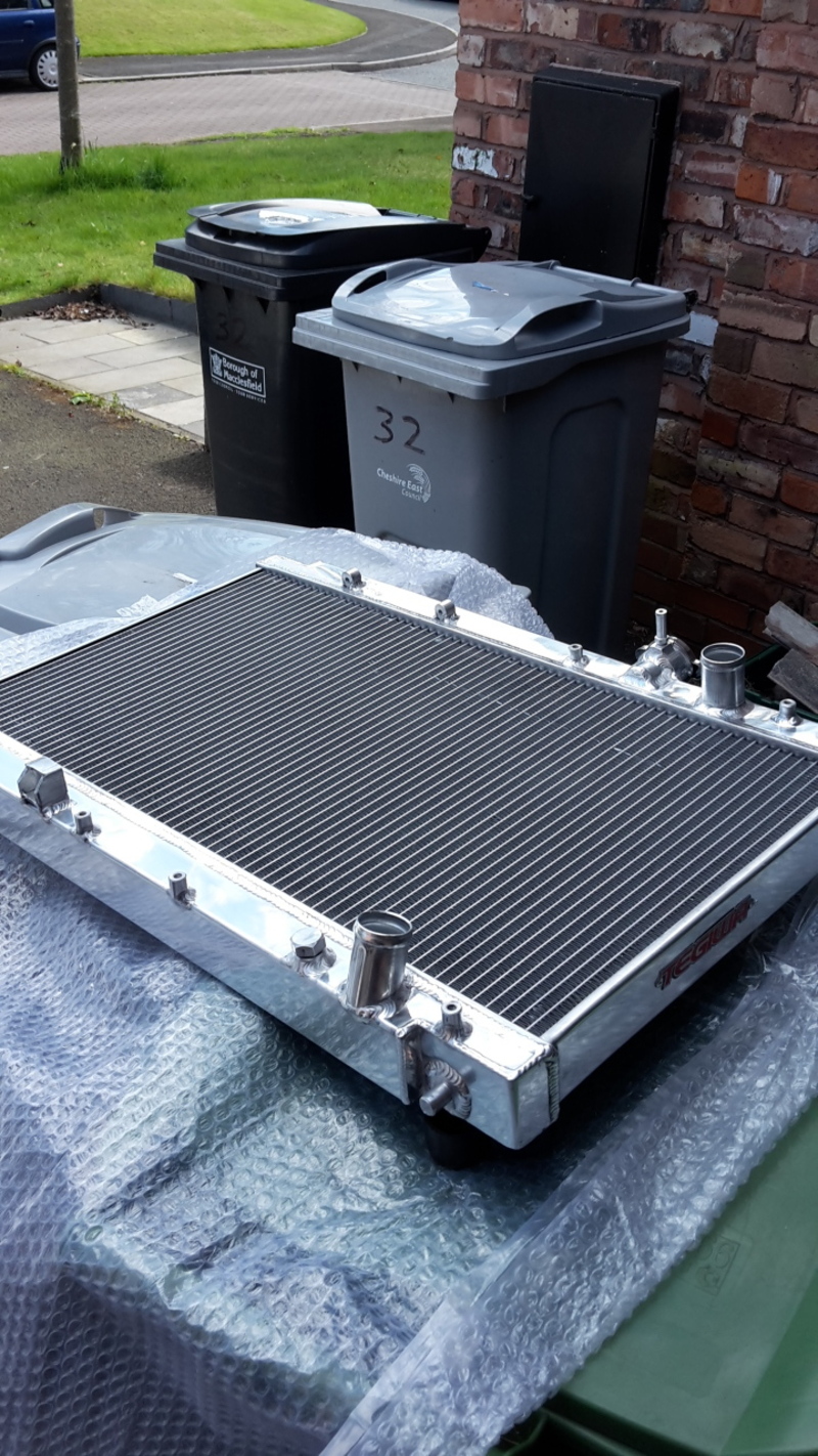

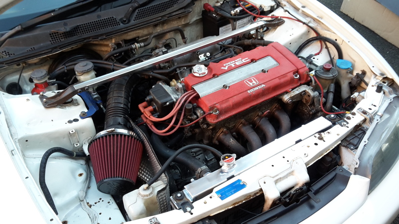

Noticed my radiators and little worse for wear definatley worsened since fitting it last year so thought this time it's best to get an ally rad and look after the engine abit better when it comes to trackdays, went for a tegiwa rad -
not the best fitting in the world but with a little tweaking it's in...

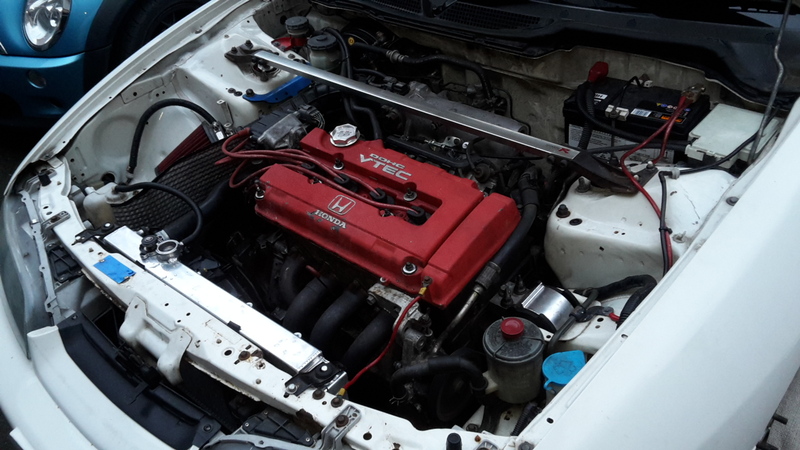

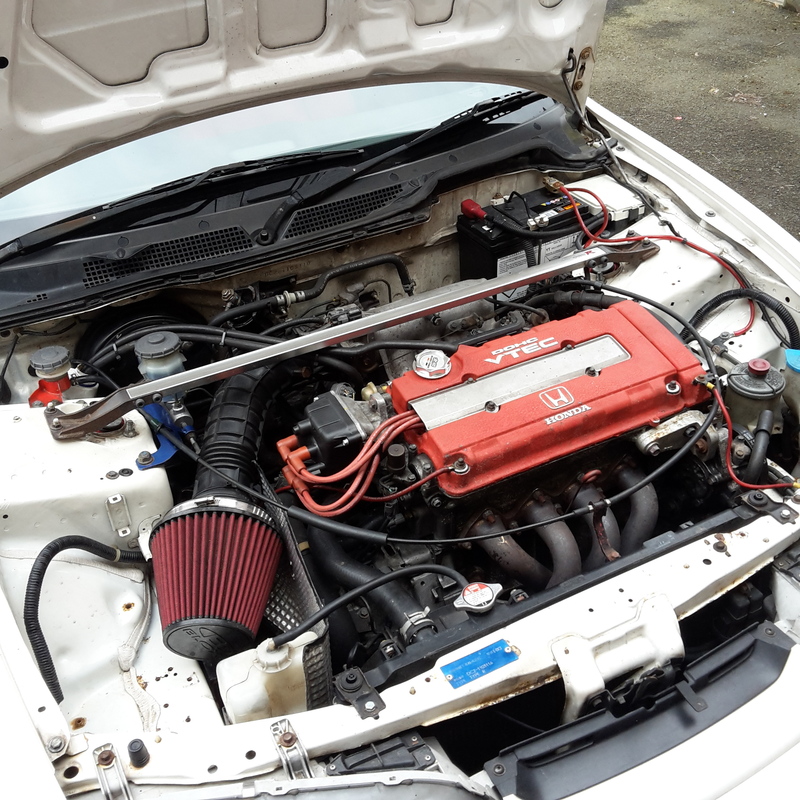

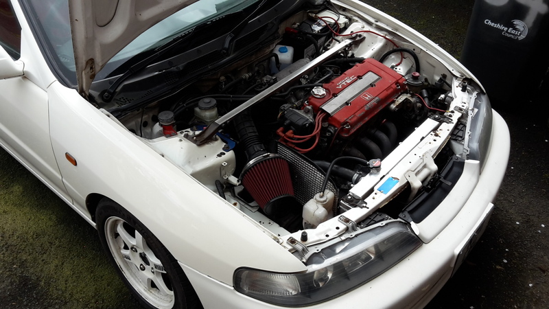

Quick engine bay pic before the rad and cable -
all set for anglesey coastal trackday on sunday :D

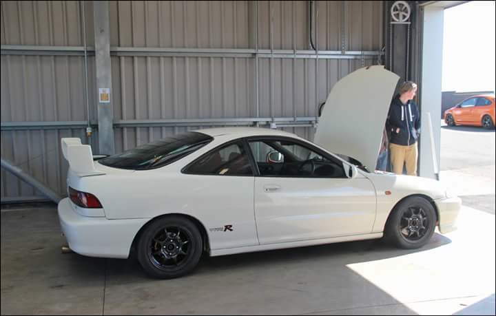

So, anglesey trackday was yesturday on the coastal circuit so missing out on the two long straights and tight hairpin, it looked exactly like this it was perfect trackday weather sun out all day and cool breeze -
On the road for 5.10am only seen about 10 cars on the road on the 107 miles there aha
Struggled getting to grips with the track at first I kept going too quick into the corners as it's quite a technical slow flowing track compared to oulton park

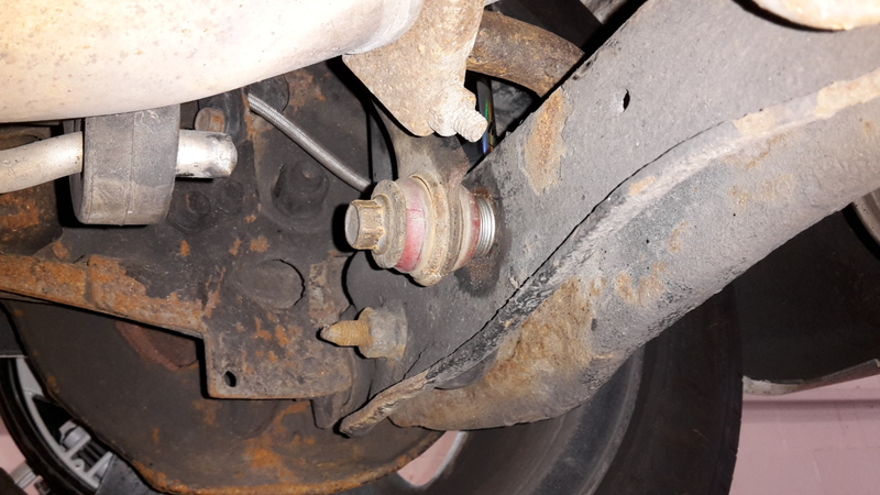

First problem i had with the car was the bolt fell out the rear engine mount, managed to pinch one from a guy in the paddock then got it in after trying this position aha -
so got that sorted easy fix at first thought I thought it mightve split or a driveshaft failure luckily not aha, so then continued the day altering tyre pressures etc then after dinner I lost gears braking into the 30mph left hander which was worrying... After re bleeding the clutch it sounds like the pressure plates failed on the clutch as it selects gears fine when the engines off and when the cars cooled it goes in gear just about.. so afew new parts are on order
Few pics
so engine still pulls like a train, due a service now and brakes were better than last time out on track but mainly because there's little braking there at Anglesey, here's the only vid I got the session after dinner/one before the clutch plate gave in, roll on new parts arriving. .. enjoy! -

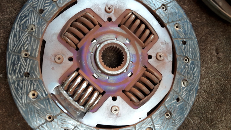

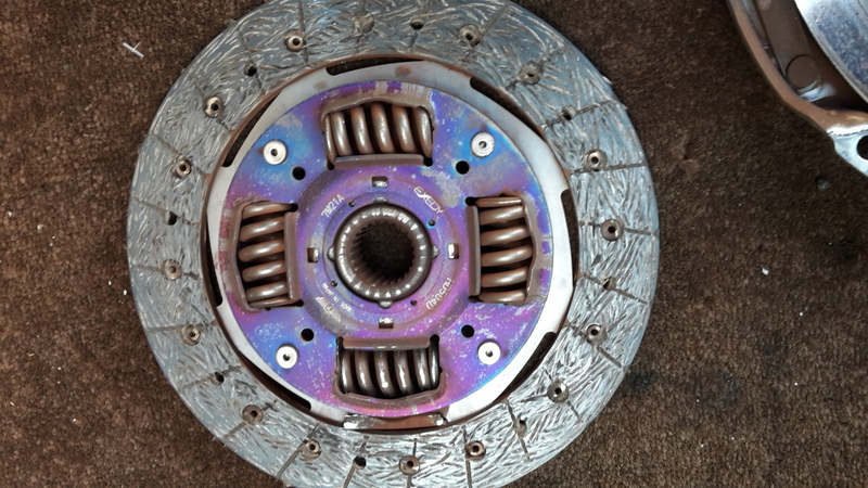

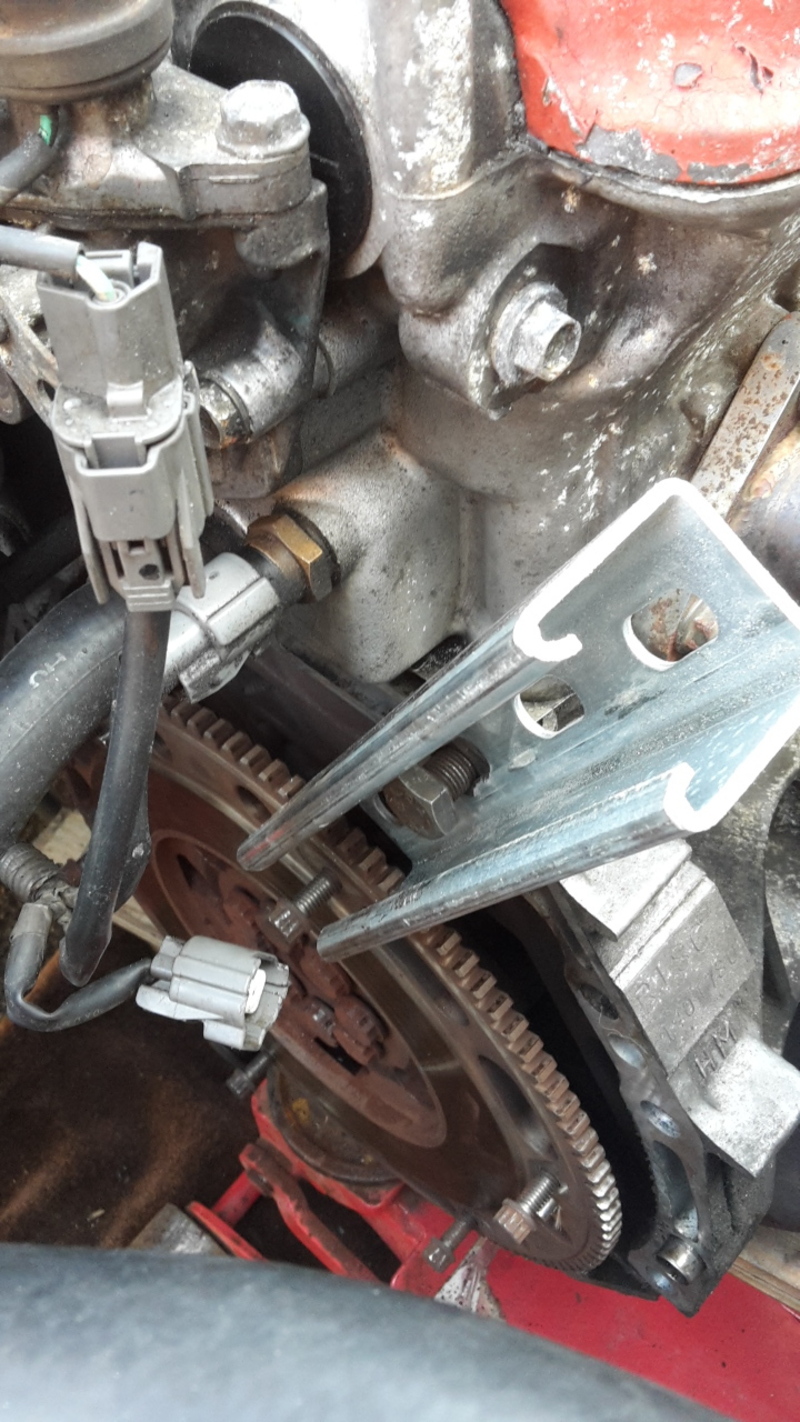

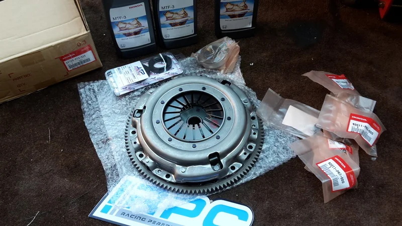

So... old clutch -
I am glad I didn't order an exedy oem clutch haha
Found out I also already had an exedy lightened flywheel too, so removed holding it like so -
new 'parts' -
Genuine 98spec clutch kit
Rpc 3.6kg flywheel
New flywheel bolts
New diff seals
Genuine oil
All swapped with no issues apart from clipping the speedo sensor when lifting the box back on so I've been and got another and all is good again, bled up with some typ200 fluid totally cleaned and regreased all the pivot points on the clutch arm and it feels nice and light, lighter than the old clutch feel!

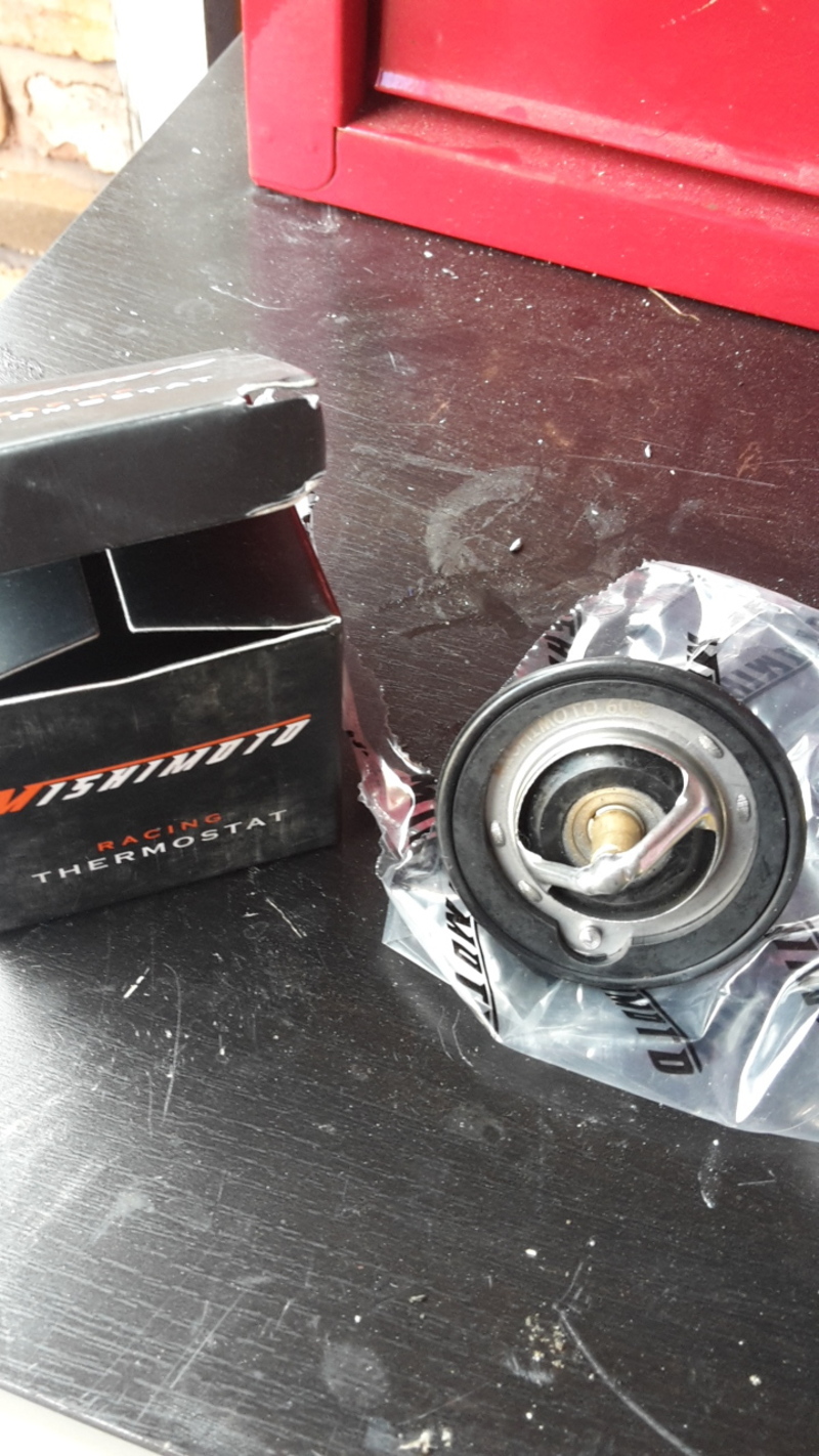

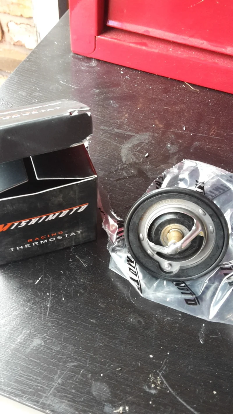

Had a problem with the top rad hose bulging at Anglesey so I changed the hose and the stat for a rather expensive mishimoto 60degree item -
so the bulgeness has gone but now because of the massive radiator and such a low temp stat when driving it literally mustn't get much hotter than low 60s as it barely moves off minimum which makes me think hmm is that actually ok or maybe it's just overkill... with the old thermostat and oem knackard radiator it never overheated but dash temp gauges are always abit give or take... so I've now got a blueprint oem 78 degree stat to swap then it'll be getting left i think, if I still had the oem radiator I would've kept the low temp stat in!

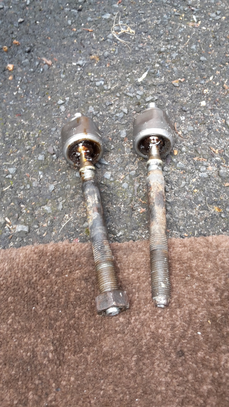

Changed the track rods the other week, the nearside was abit of a pain with access issues, they were way past their expiry date I think -

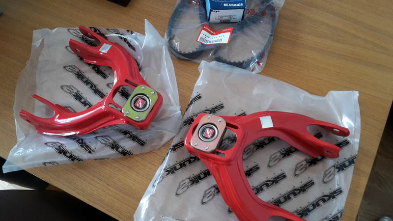

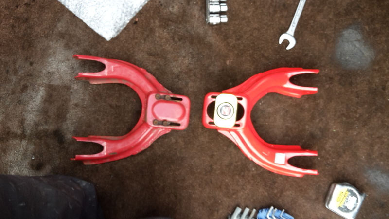

Bought some pro series skunk2 camber arms and a new cambelt from Tegiwa -
new vs old -
Fitted and camber maxed out at I think around -3 degrees, will see when I get it aligned next!

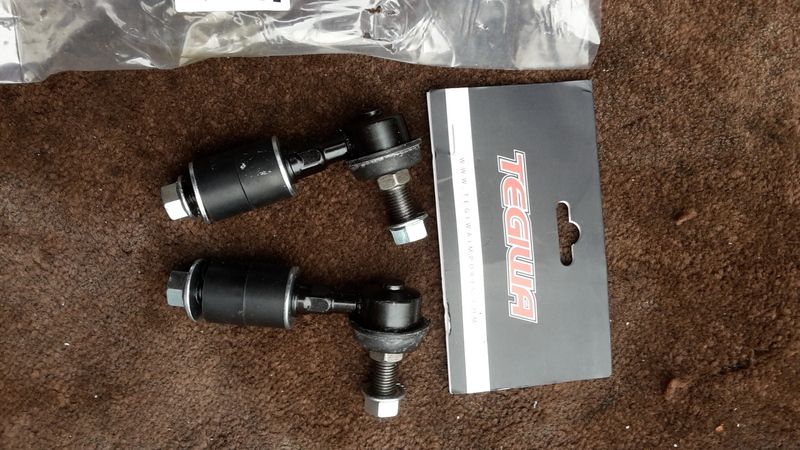

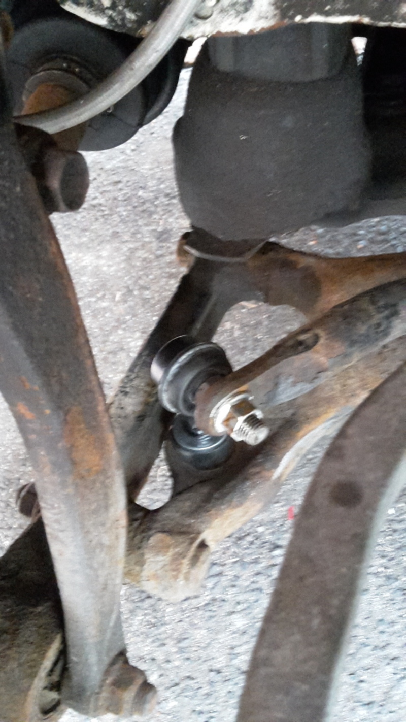

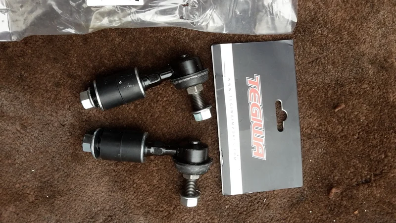

next up was new Uprated drop Links -

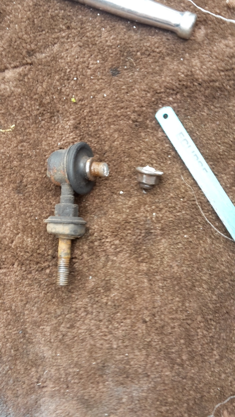

one of the old ones was just spinning so had to attack it with my manual grinder, hand was battered after half an hour of sawing away again with no access to get a saw in -
new fitted -
so needs aligning again and I need to get round to doing the cambelt, also got a waterpump to do at the sametime!

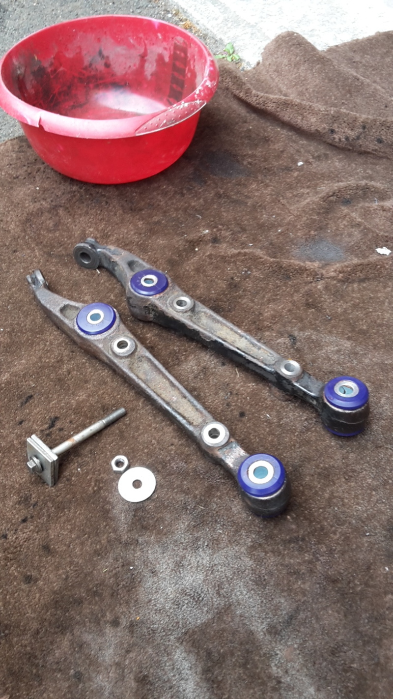

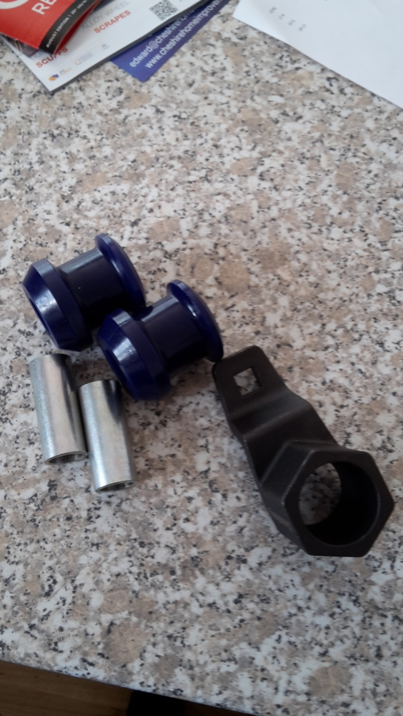

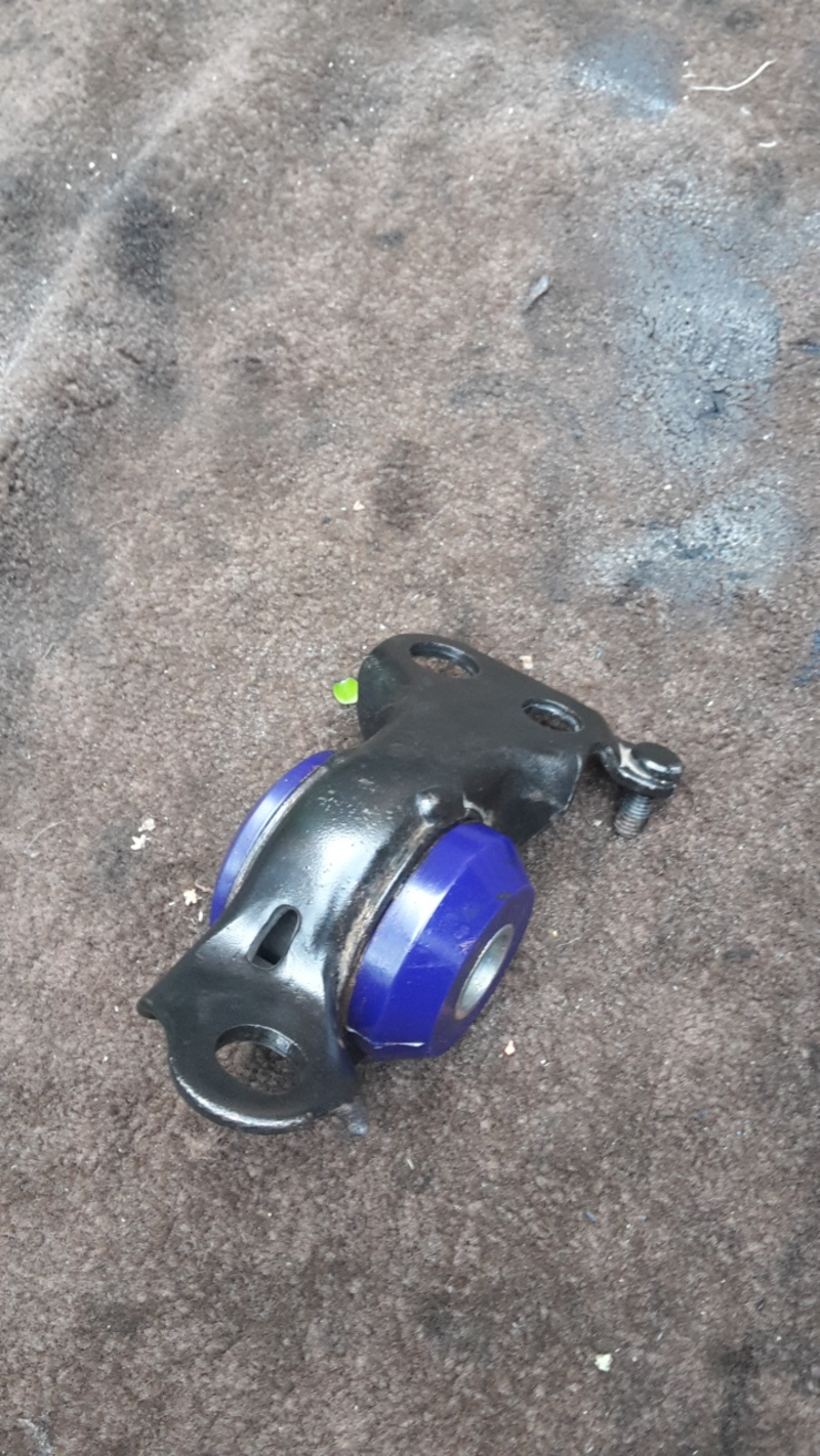

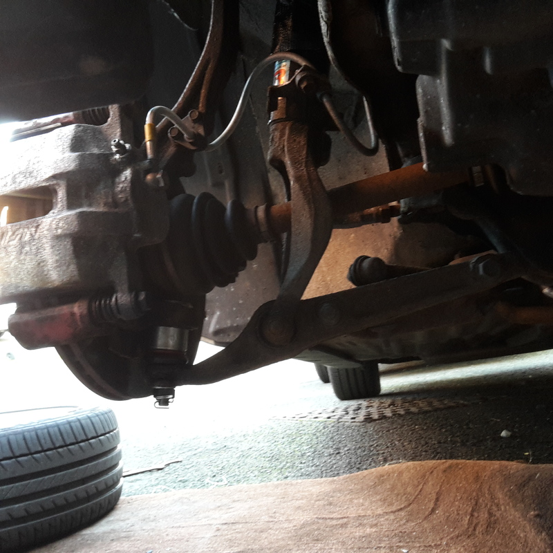

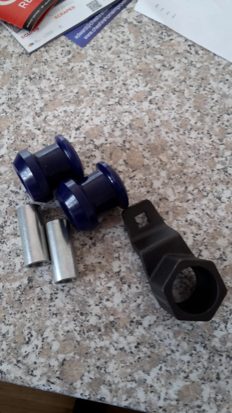

Before taking it to get aligned I thought I'd polybush the lower control arms, went for Superpro bushes. Burnt the rubber and cut out the races, then after some advice I softened up the bush in boiling water and made my own little press with a bolt and washers and wallah 4 bushes done -
I've also ordered the others, the larger rear bush on the other part of the arm, yet to fit them yet -

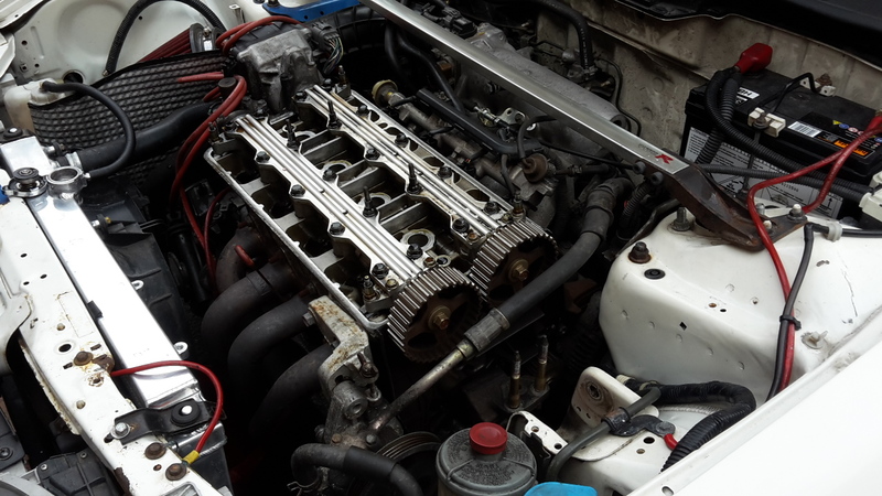

that hex tool in the picture is the crank lock tool as I had to order as a buzz gun wouldn't budge the crank bolt to do the cambelt nor would a breaker bar with a mate holding the engine in gear on the brakes...
So i changed the cambelt and waterpump last night, easy job once you've got your head around the backwards turning engine when tensioning the tensioner! The old belt looked long overdue so glad that's done with! -

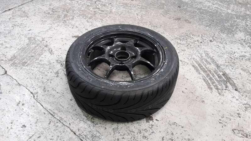

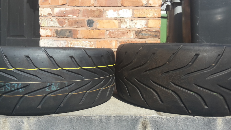

picked up some 205 R888s last weekend, Compared to 195s -
going to get them fitted when I get it aligned in a week or two once I've fitted them polybushes!

205 R888s fitted to the stock wheels (6j et45) as they'd scrub if i fitted them to my trackwheels (6.5j et38/40), painted satin black too as they needed a freshen up anyways -
Will be taking both sets of wheels to donnington I think compare the 195s on the wider wheels and these, if these are better ill be removing the front spacers (can't do that unless there's no going back as i had to chop the studs down to fit the 17mm spacers so I've ordered some new genuine studs to have ready just incase) and swapping the tyres!

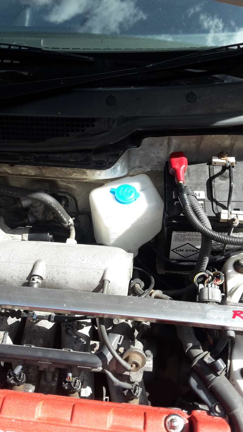

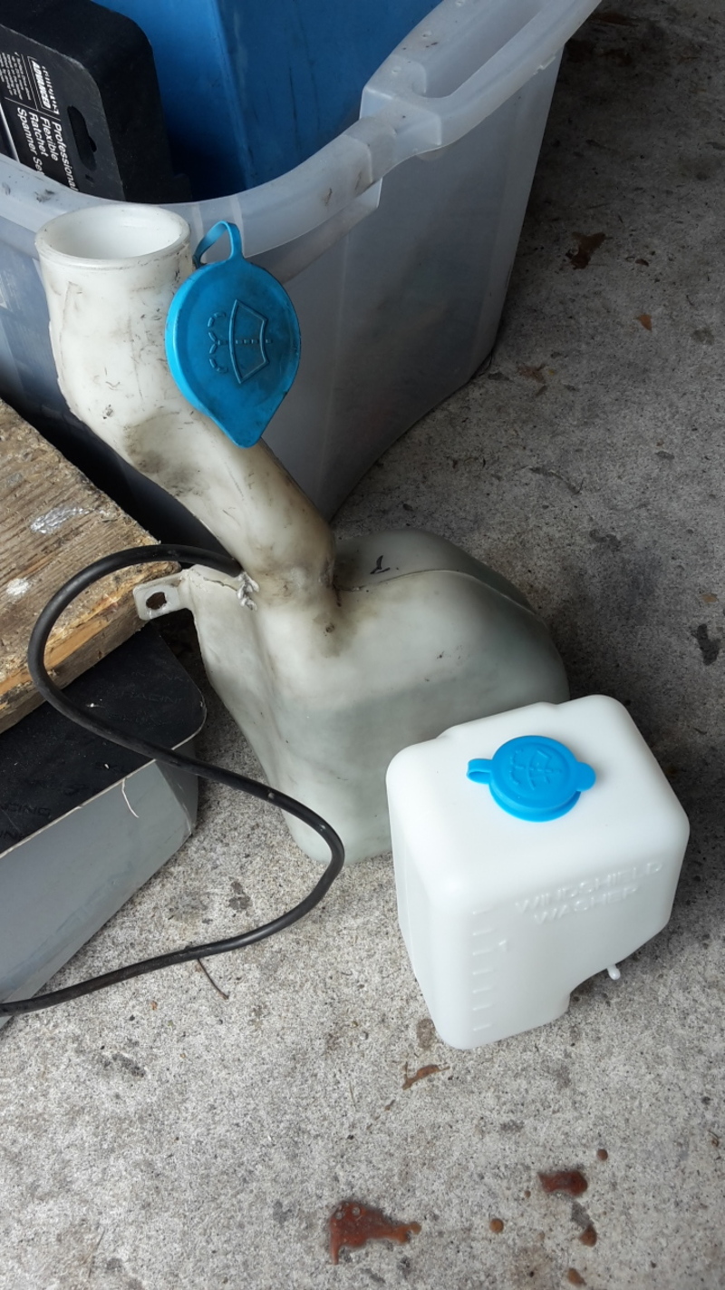

Ordered a small washer bottle, Morris minor one to be specific aha, more on that when it arrives
  JDM Dc2
New washer bottle vs original -
Fitted onto the bulkhead -
fits quite there and now both front arches behind the bumper and totally clear now for brake cooling!

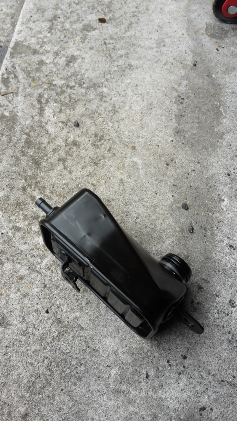

Had an oil leak on the crankcase breather, was going everywhere so decided not to put it off any longer and sort it, turned out to be the O-Ring where it slots into the block so nipped to B&Q and got an assortment of them and fitted the best one -

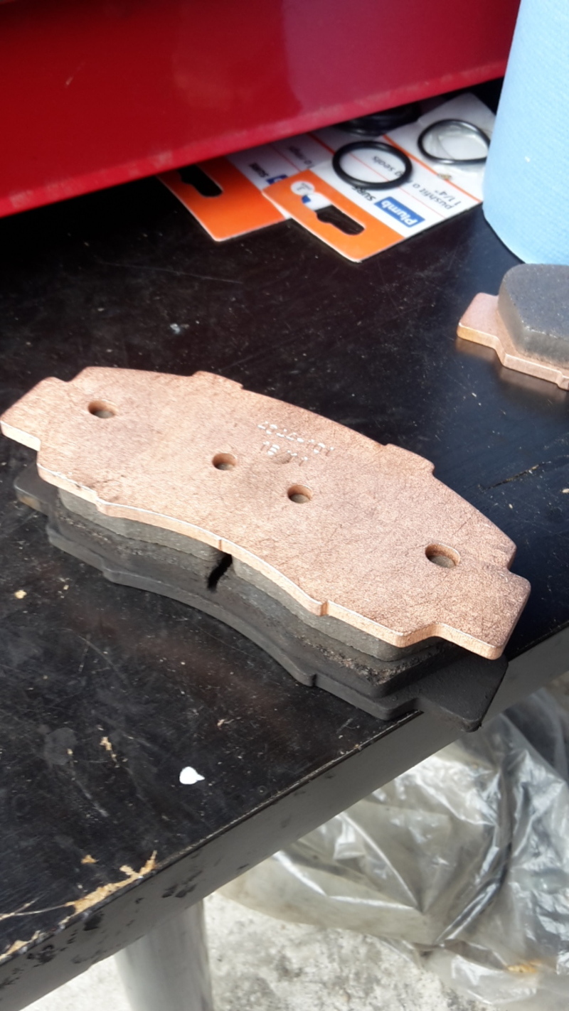

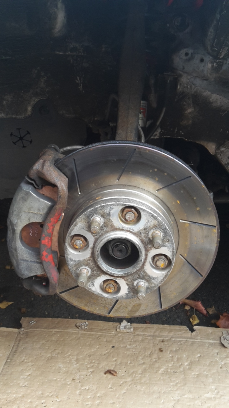

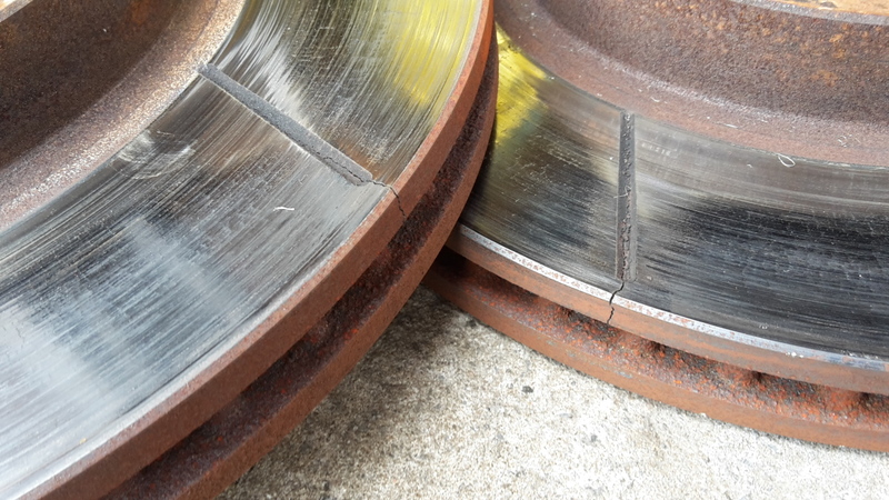

Decided to change/uprate the brakes again from the ds2500s with Donnington being a heavy braking circuit and oulton only 3 weeks after so I've gone for Carbon lorraine RC5+s, compared to the ferrodos not quite as much pad surface area -
To go with them ive decided for the first time to try grooved discs so they keep the pad permanently clean after being advised to by numerous racers! -
only done 50 or so miles on them so not really pushed them properly yet ill save that till Monday at Donnington :)

Good thing about the CL's is you don't have to f**k about bedding them in like Ferodo.
They're a much better pad i think.

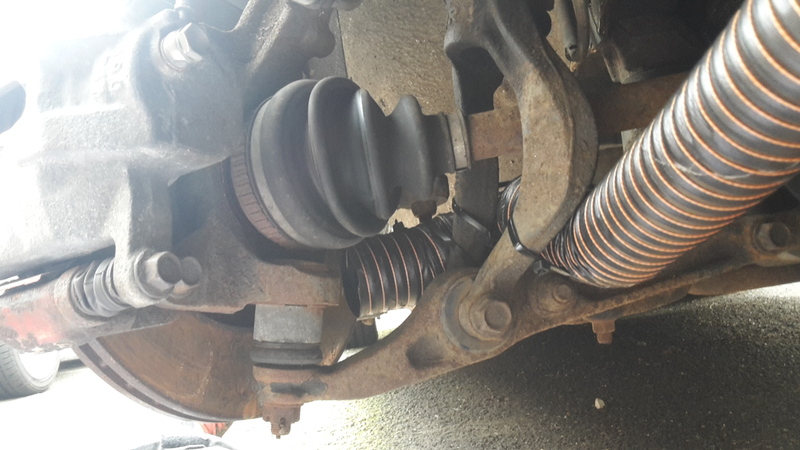

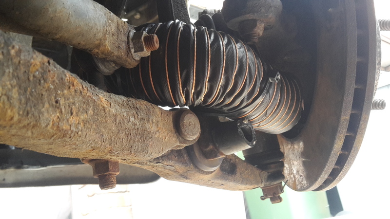

CV boot changed, brakes rebled (still not amazing), alignment on Tuesday, roll on Oulton on Saturday!

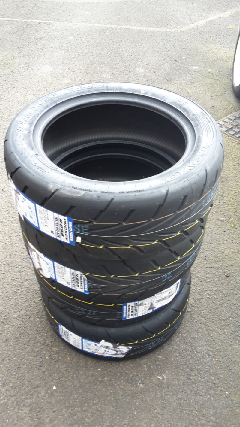

Been a while... Anglesey prep and update, but first a couple of pics after a clean, still scrubs up alright in the pictures considering its on 175k miles aha -

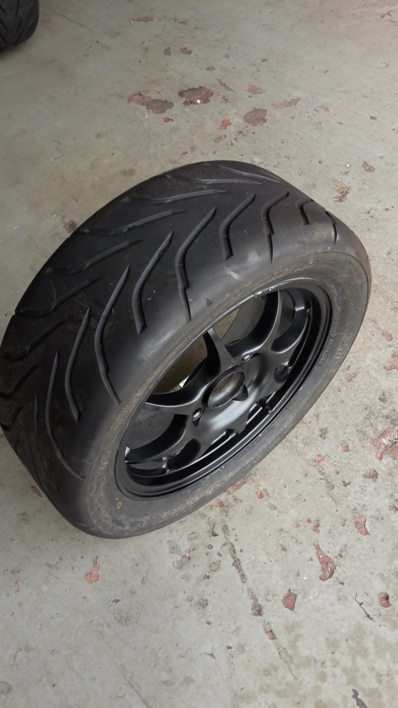

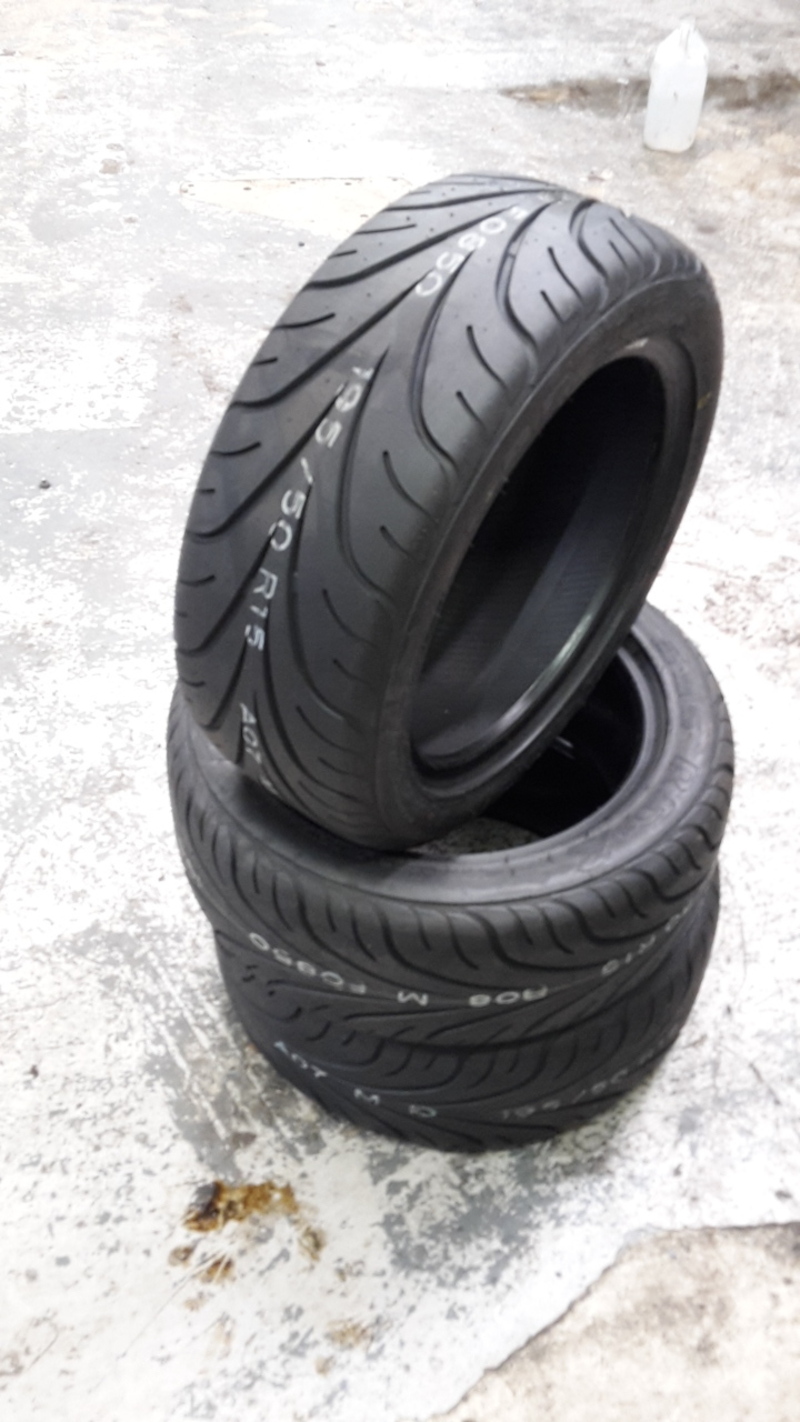

So... New Rubber, 195 50 RSRs -

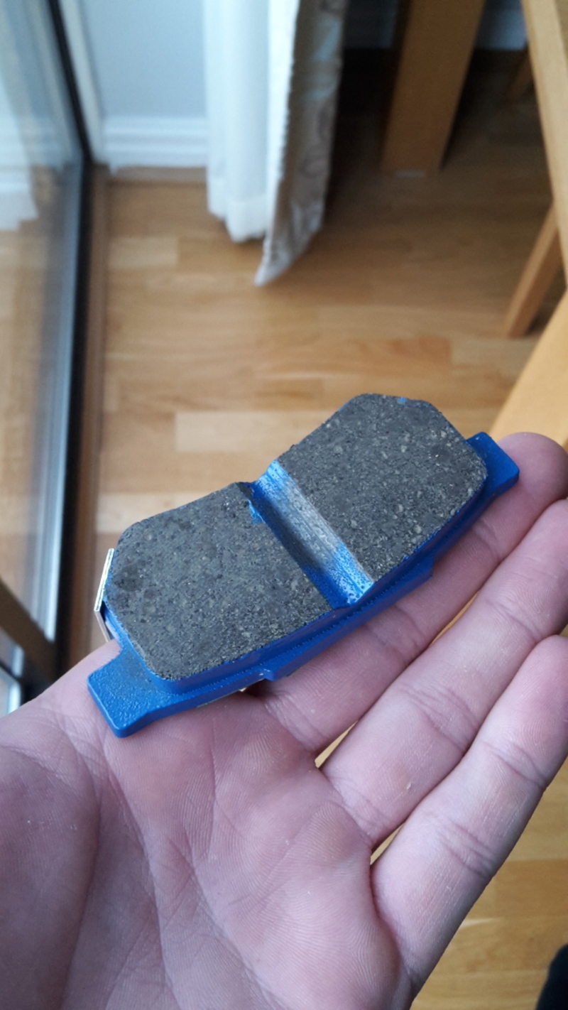

Spare Rear pads for when the time comes to change, Blue Stuffs being 47quid cheaper than my current DS2500 rears so worth a try, so small these like a Bourbon Biscuit! -

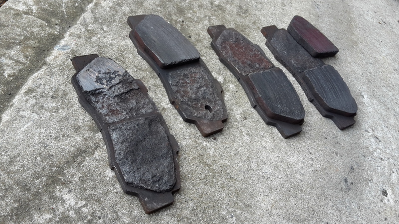

So the Trackday itself... was bloody soaking first thing as it didn't stop raining till around half 10, the back straight was abit scary at 110mph with lots of standing water it felt like the car was floating aha, gripped awesome as usual the Michelin PE2s never disappoint even when the track dried out around half 11ish they were still awesome with a 95% dry track! the only pic I had from the day -
After a couple of Dry sessions my Brakes were getting slowly worse/spongey until the pedal went to the floor at 120mph I thought enough enough enough I need to come in and re-bleed it up, turned out this was the case -
...awesome, Carbon Lorraine RC5+s not even half way worn the compound had literally just fell off and trapped in the caliper, luckily I had my old spare DS2500s with me so I threw them in and rebled up it felt the best it had felt all day, the turn in felt mega in most of the corners really impressed with the RSRs!

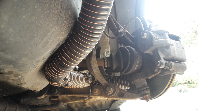

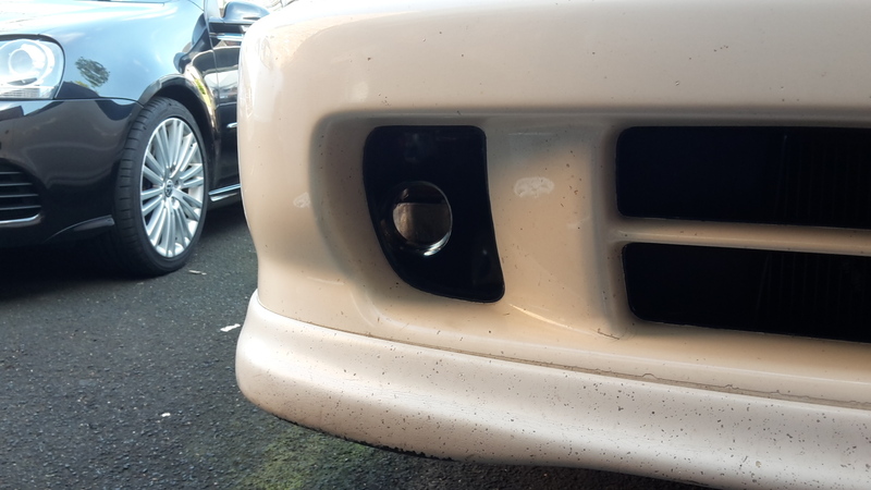

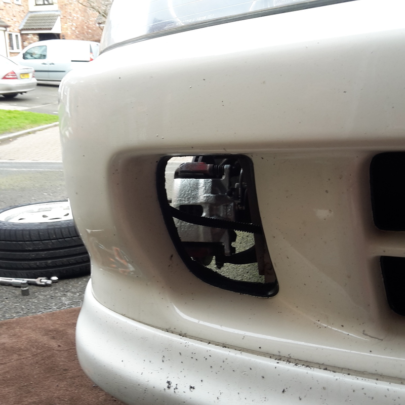

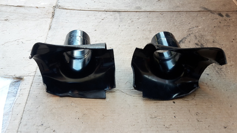

So after doing loads of thinking of how I'm going to be able to get a duct/shroud to fit my bumper with not wanting a big duct on the outside of the bumper as they look gash and too 'in yer face', I measured the inside of the bumper and looked on ebay and every motorsport site at all the ducts available and literally nothing would suit as the chassis' obstructs about 30% of the space where the ducts needs to go...
So i got a pair of Deep Gutter outlets from work and set about making them fit with a hacksaw and a blowtorch.. about an hour later I ended up with these, you can see where I've bent the inside of it out to get around the chassis, tie wrapped at the top out of sight and siliconed around the edges and on the tabs I made on the corners -
So with the shape of the bumper there's ~200mm of air being forced in/through! Happy days nice and subtle and not "hey look at my ducts" like the ones that are fixed to the outside of the bumper
Then I done some eyeing up with some pipe lagging to see the most efficient route to the back of the disc where the biggest area of the centre of the disc is available, then ordered 2m of 51mm pipe from JJC. Whilst I was waiting for that to arrive I made up some reducers to get from 63mm to 50mm!
So all piped up, well away from the driveshaft and wheels and as close to the disc as is possible on full lock -
Fitted my spare blank discs for now and all bled up again since Cadwell, brakes are great again!
