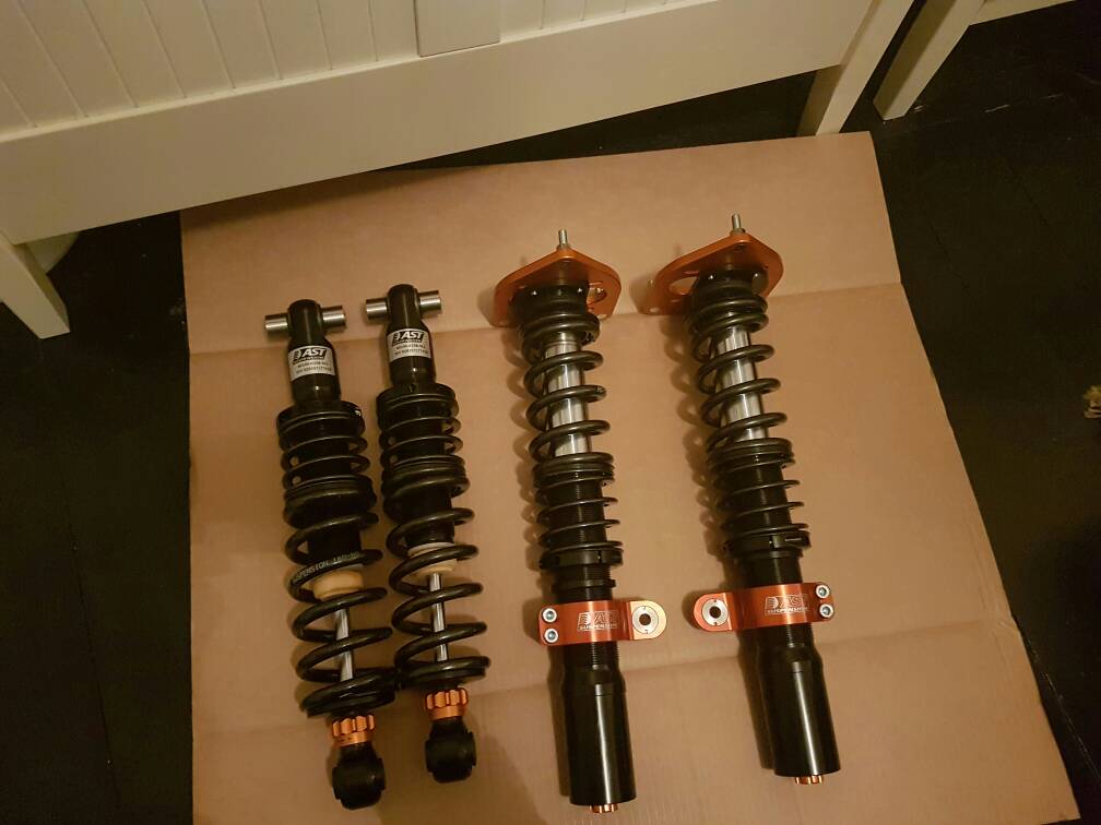

Get a cage and just replace the shocks and get some cooksport spings, that is what I use and they are fantastic for the money people have even commented on how good they are when I have taken them out and they are running AST's.
Cooksport are fine for a road car (granted slightly harsh)
Way too soft for track only , unless it's for your mum [emoji12]
M.C..
Nothing wrong with mine only driven on the road to and from track, and they seem much better than some other cars I have been in with coilovers and about £1500 cheaper than AST's.
All depends on what you want and if you are loaded, if you are trying to get the last 1 second out of the car fine but I just go on track for fun.

No a cost thing at all , it's how soft they are , and honestly nothing about bragging rights or anything .
Obviously they are better than some 400 quid coilovers off eBay.
Suspension setup is something I have spent years understanding.
With all respect if you have driven to a track on them you won't have any idea what they are like on track
They are too soft and certainly so for a track only car
If you wanted a fast road compromise with starter track use sure it's a start but please saying they are good on track is misleading
Try yours on track and your opinion my change
M.C..
It is a track car I have done more miles on track than the road, the only road miles are to the track for a track day (have to drive it as I don't have a trailer or car that can tow) and as I say they are fine, agree not as good as AST's but AST's will not be as good as Reiger 3 way adjustable and on it goes all I am saying is they are better than most springs and better than cheap coilovers and if you can't afford everything all together they are good.
Have a look http://www.cliosport.net/threads/my-bg-182-track-car-build.725592/
I misunderstood your comment "only driving to and from track"
However my opinion on how soft cooksport are still stands
I think a good track option at a lower cost than ast and up (and having played with 3 way ohlins few people outside of pro Motorsport need or can set up correctly )
Bilstein B14 with stiffer more track orientated spring rates would be a great track setup on a budget
Updated arb another excellent upgrade plus adding a rear bar but they will need setting up .
Yes cooksport are better than standard and I certainly agree better than poorly valved cheap coilovers .
Whilst if forced to race on a soft setup you can drive round it I found cooksport soft and frustrating in weight transition.
In the wet they would perform well .
