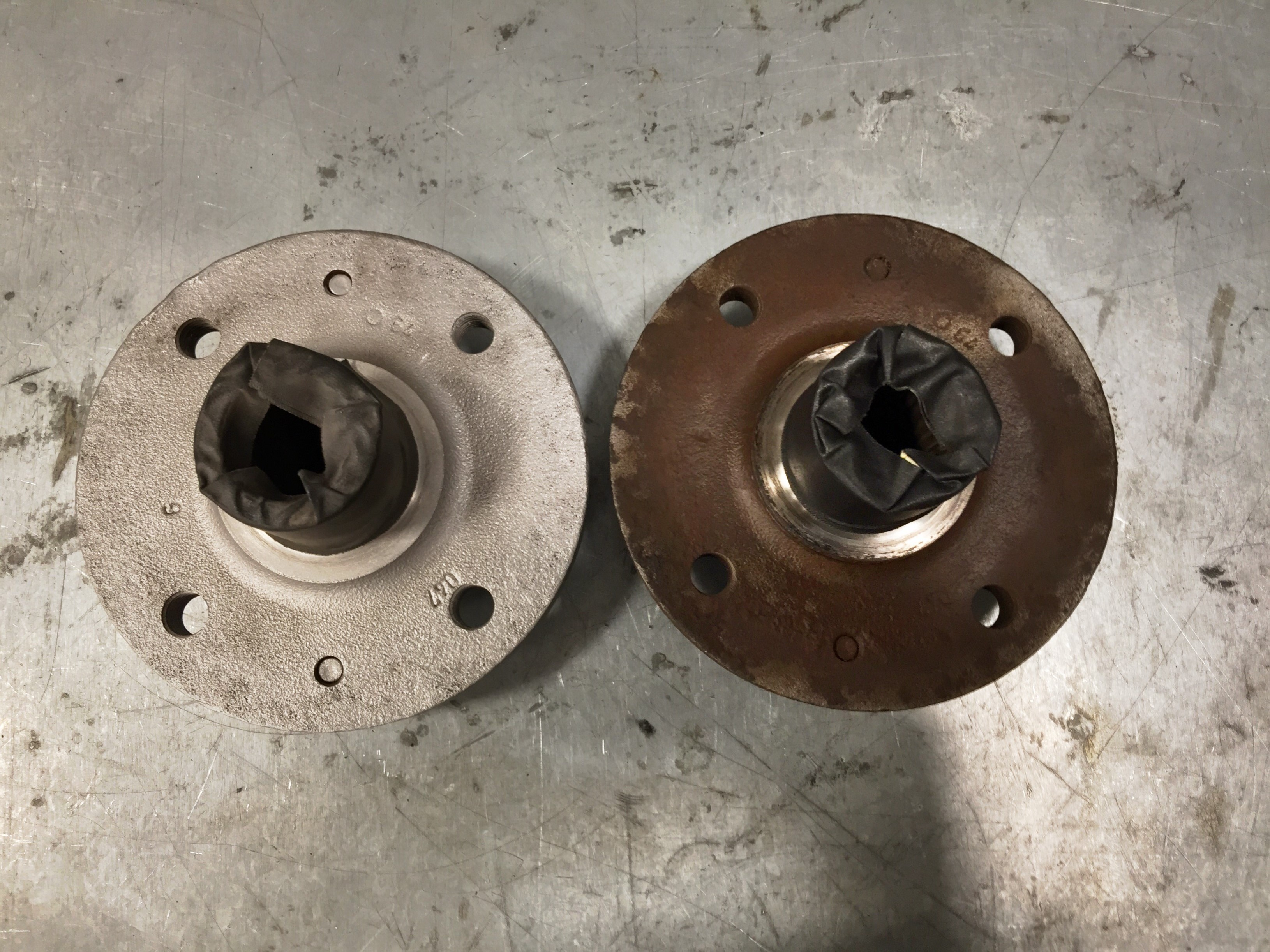

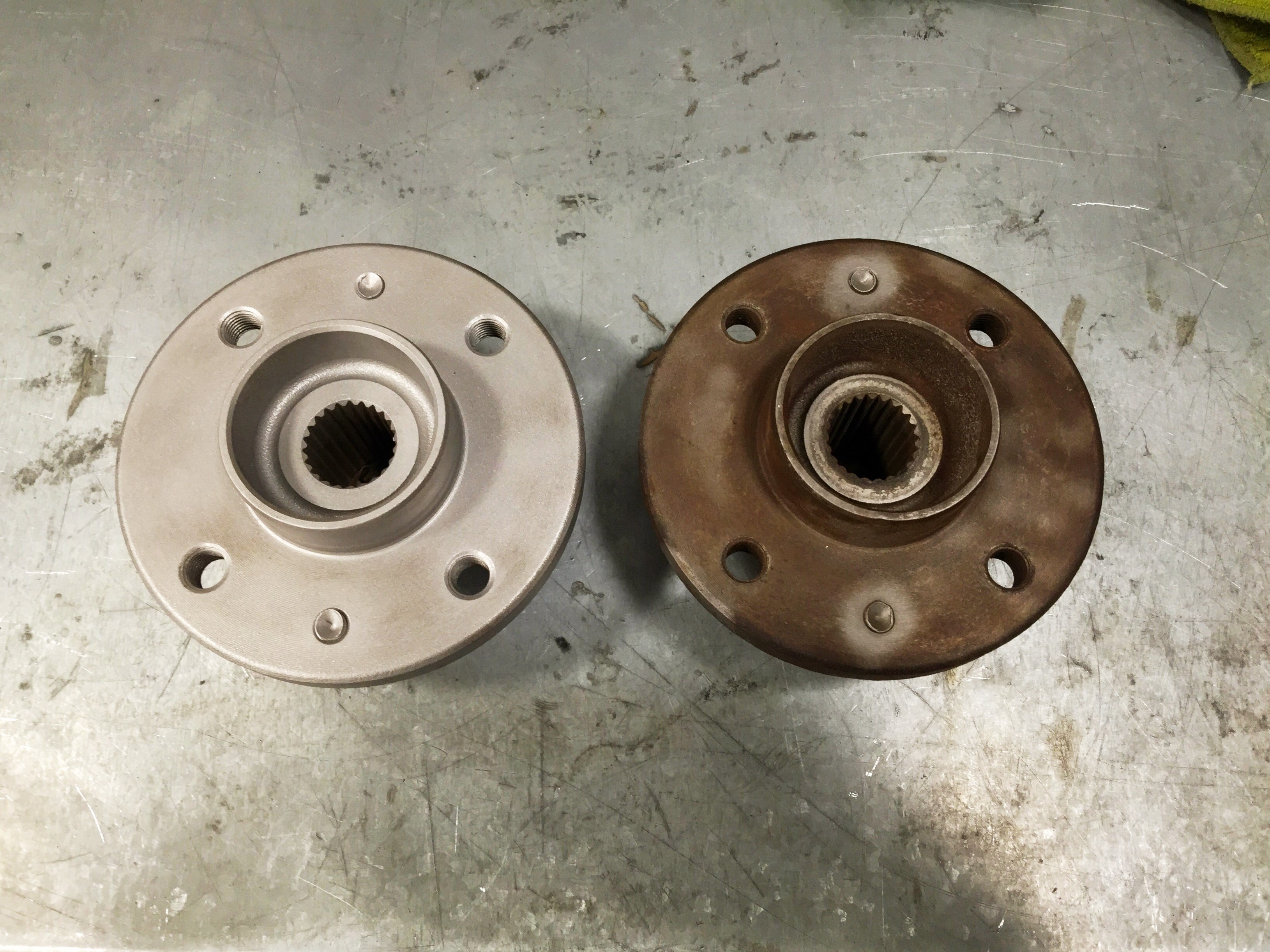

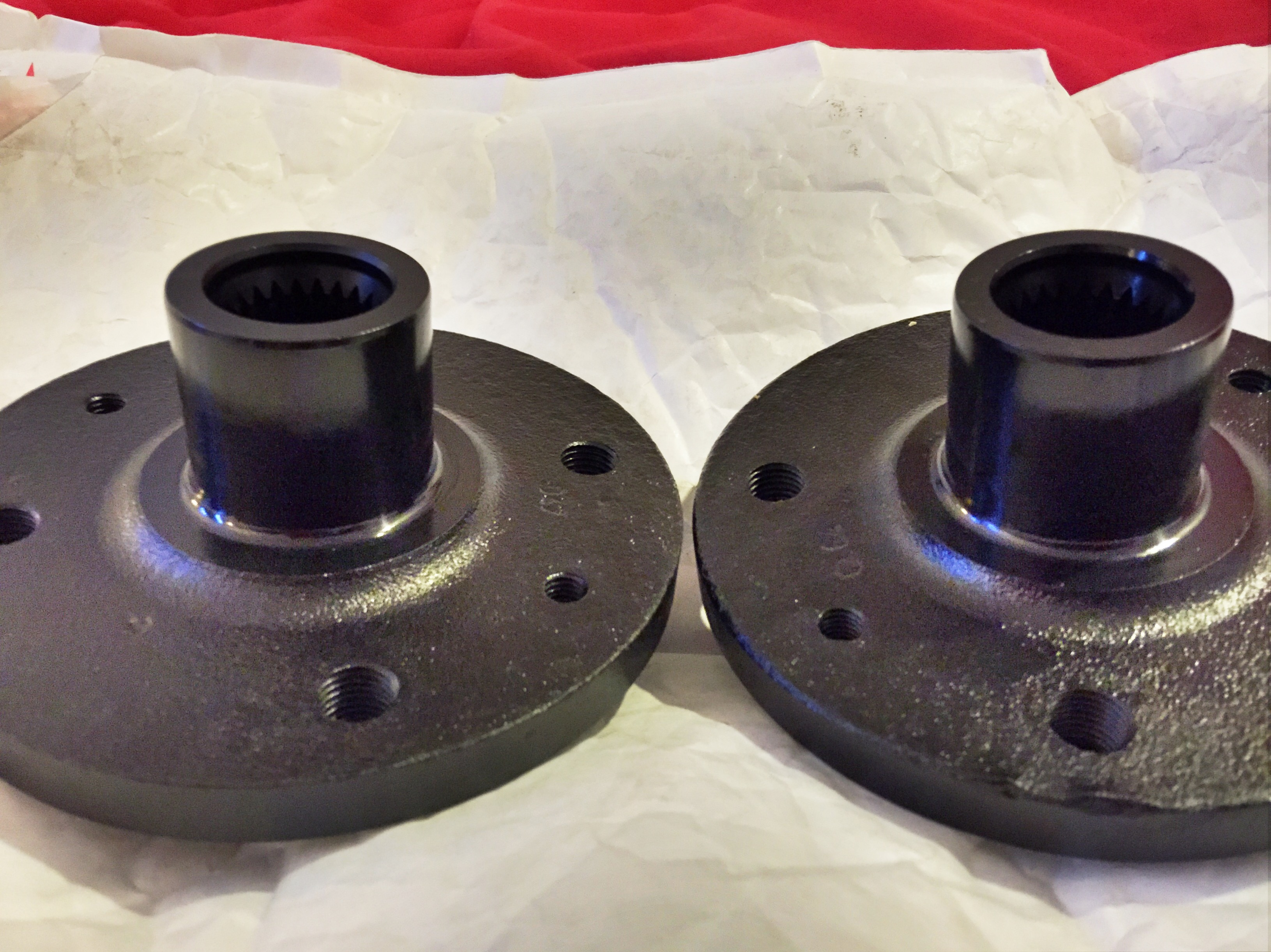

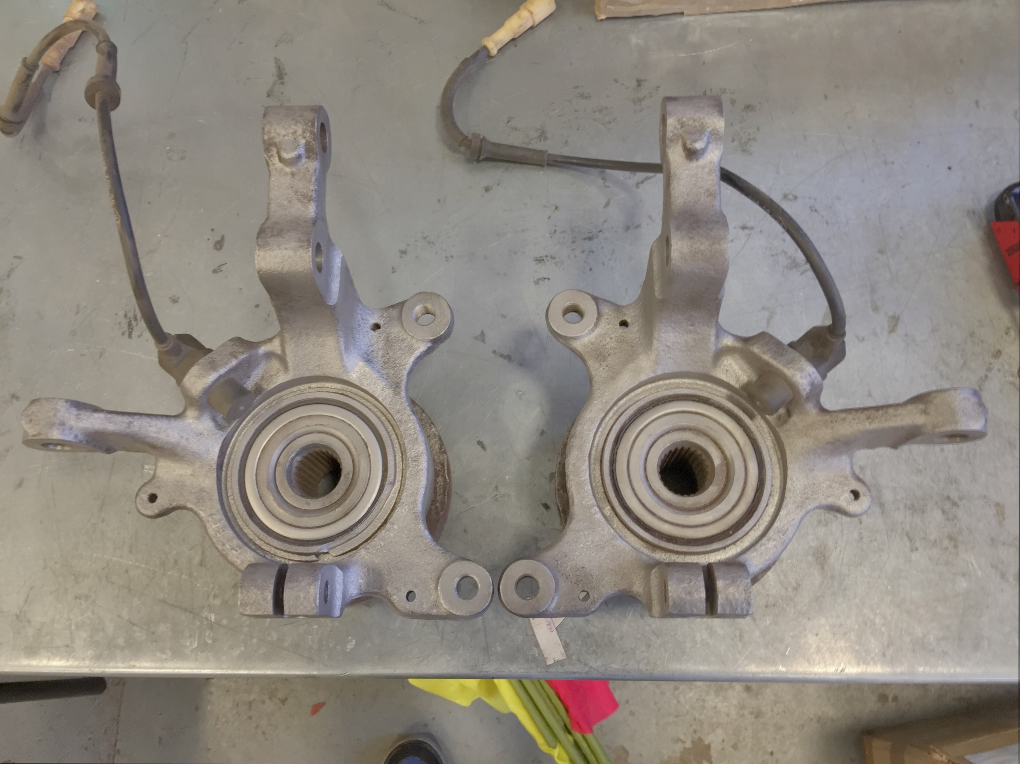

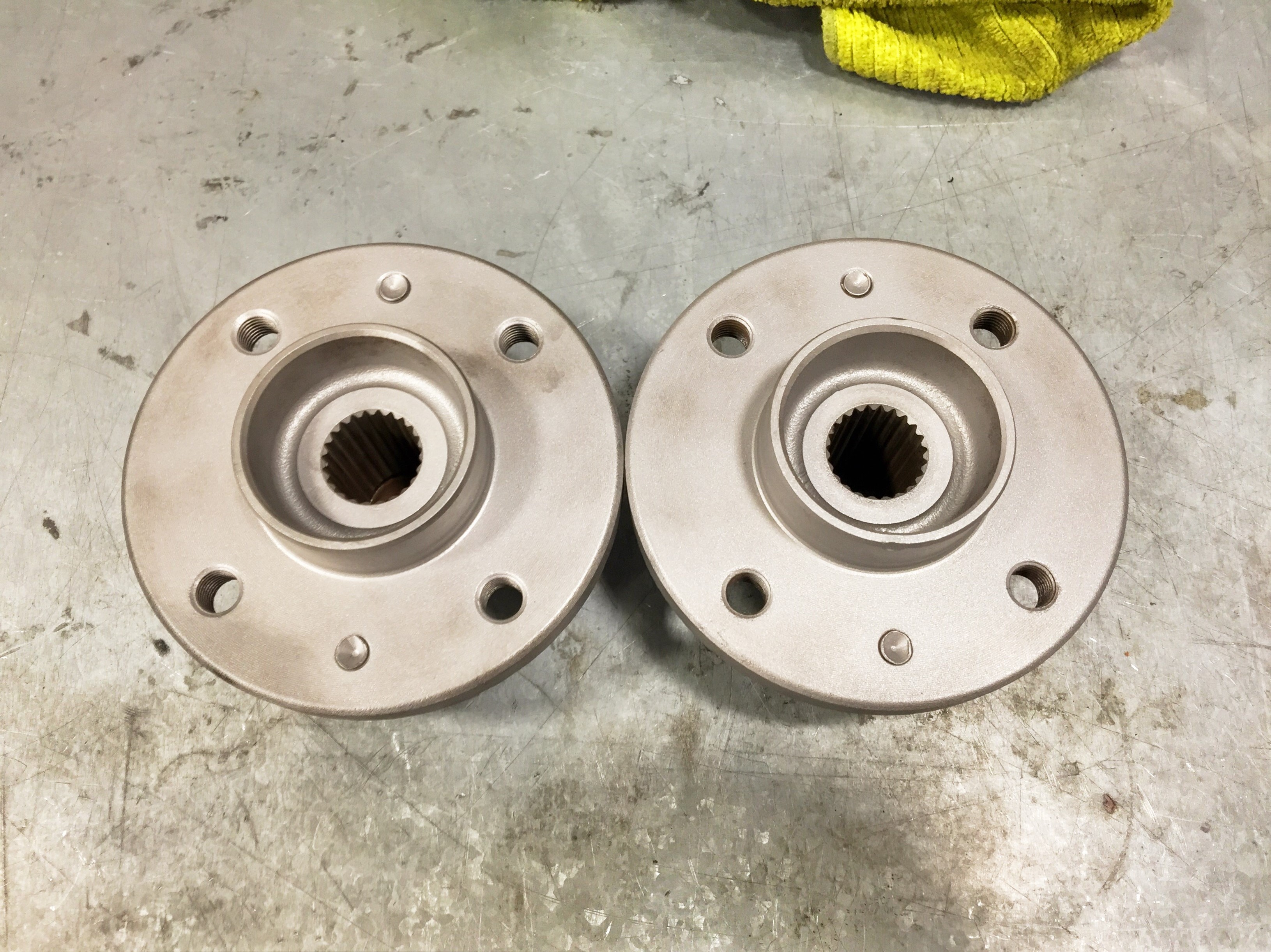

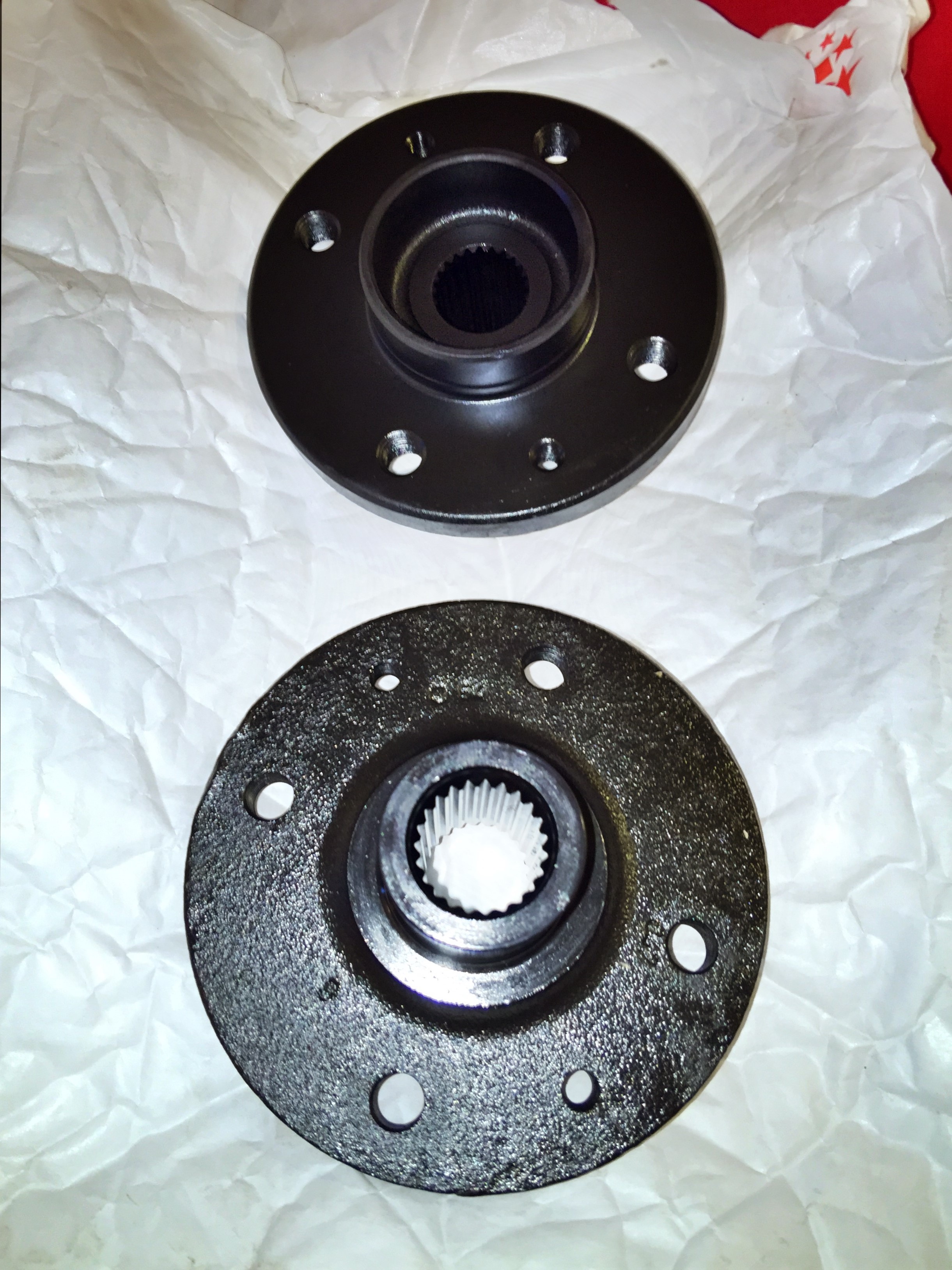

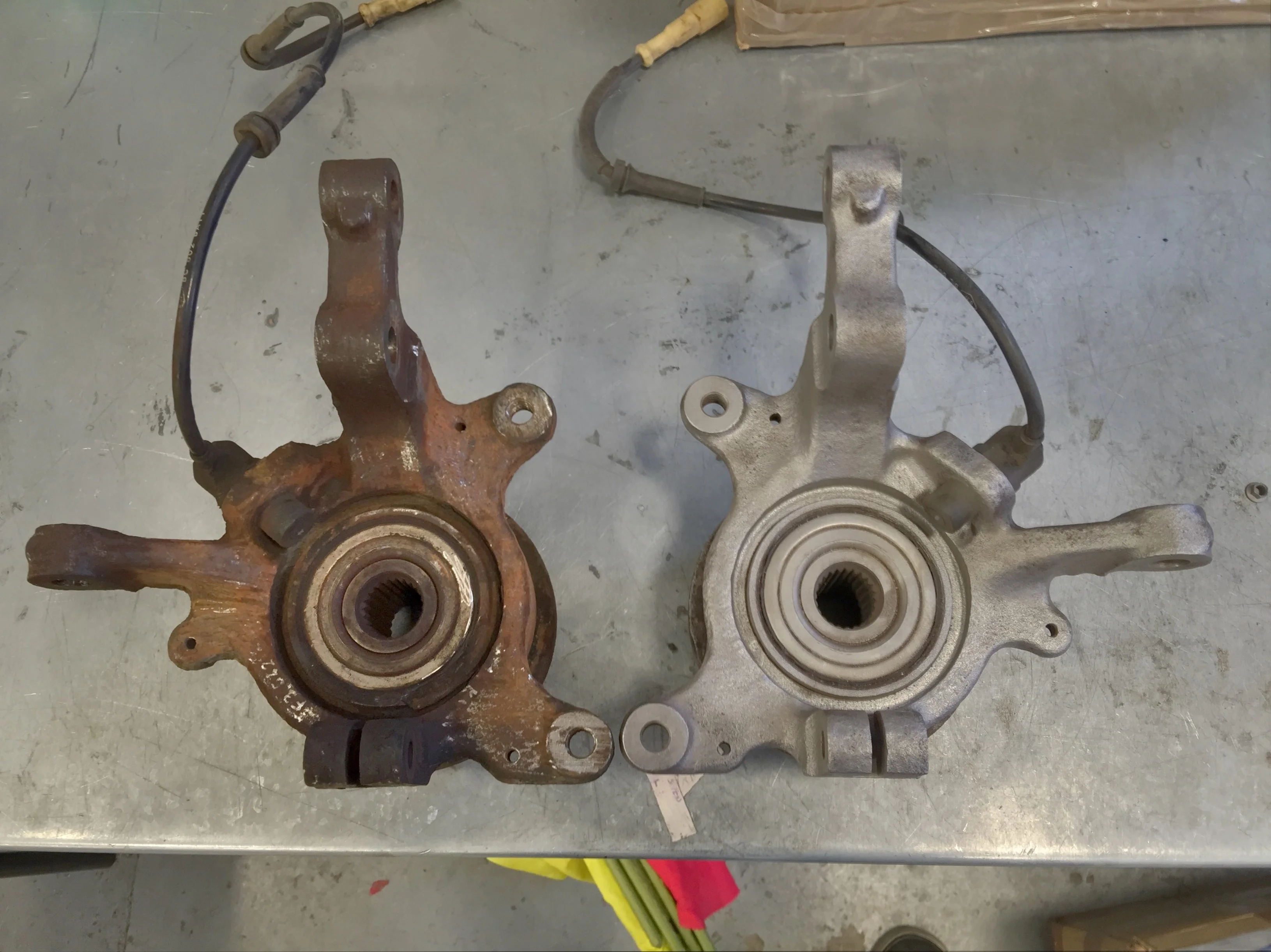

So began taking advantage of the sandblasting cabinet at uni which made short work of the rusty hubs I sourced from a cup 182 (my car is still on the road)
Really made a good job bringing them back to life and left a superb finish prime for powder coating

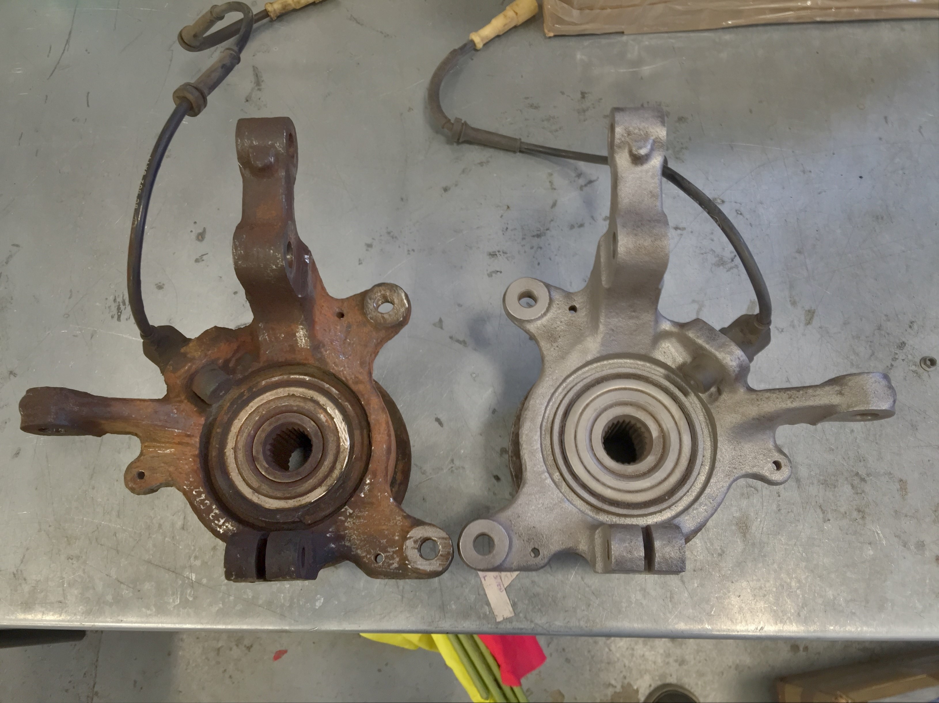

Both front hubs done side by side, the old bearings were left in to protect the bearing surface as these are getting replaced anyway.

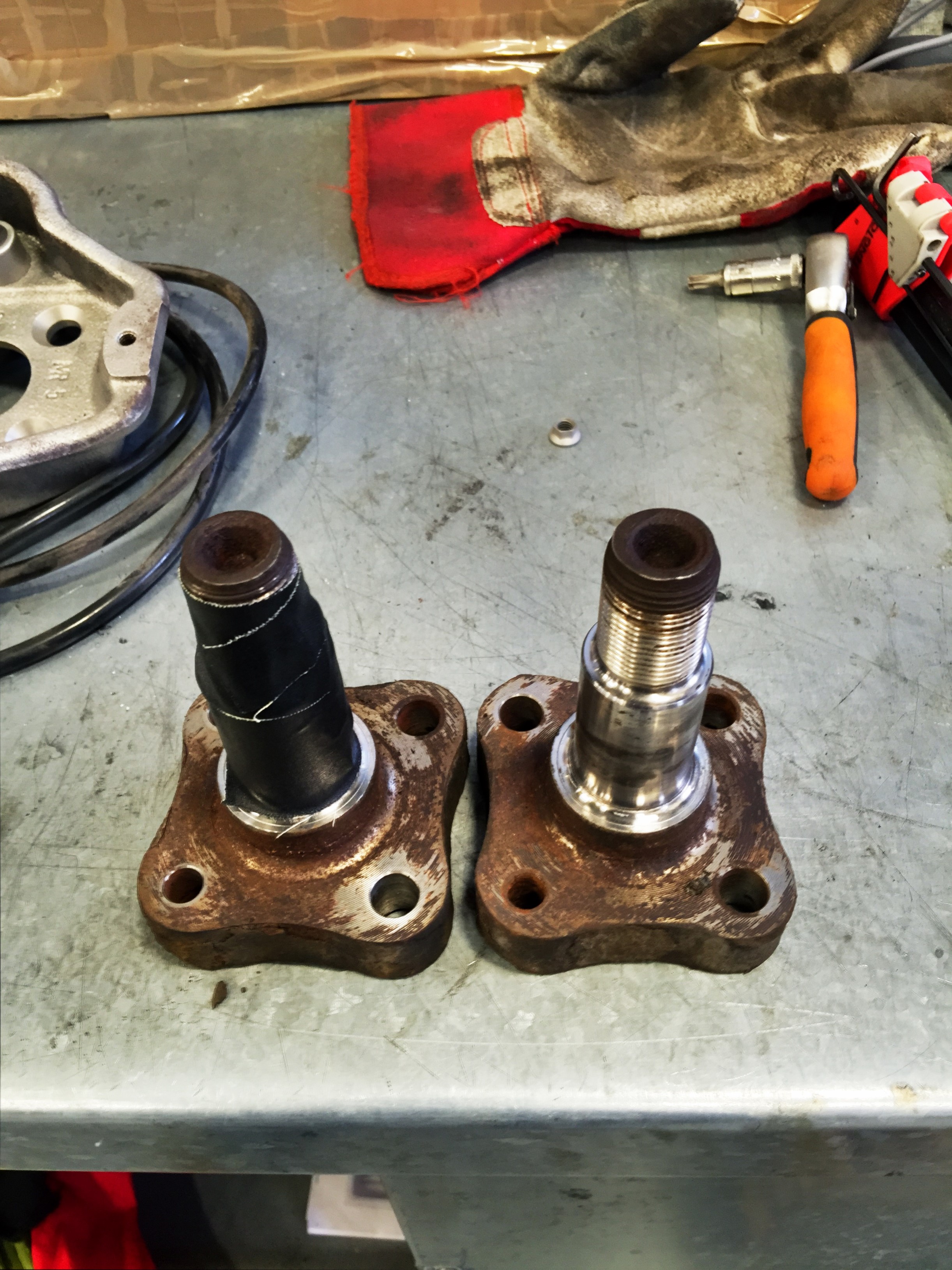

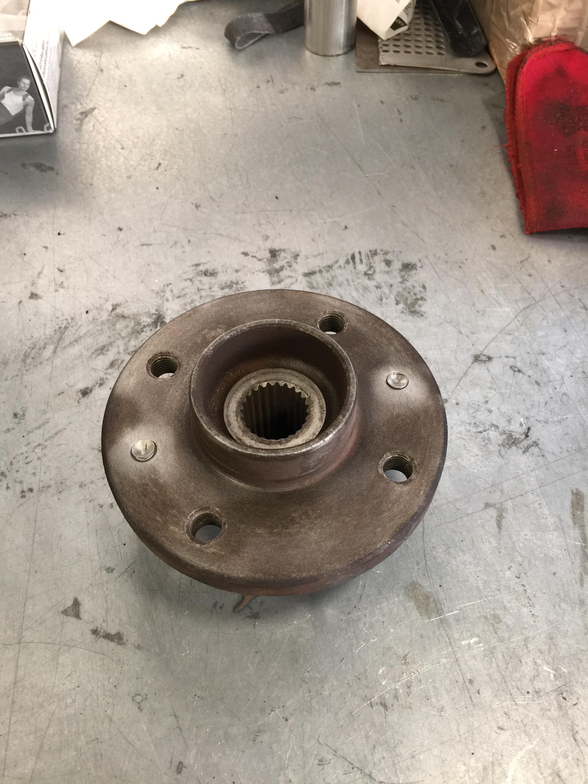

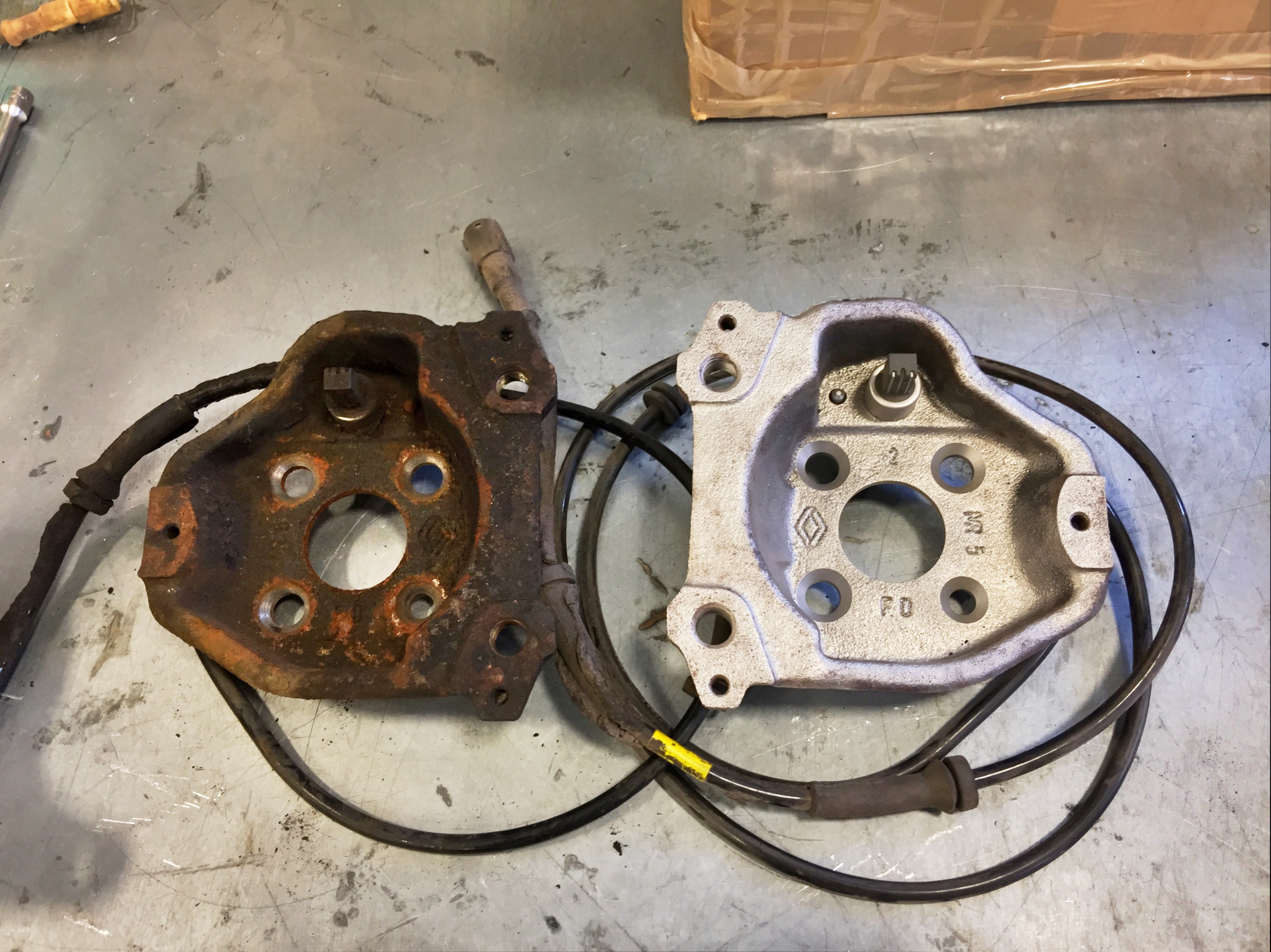

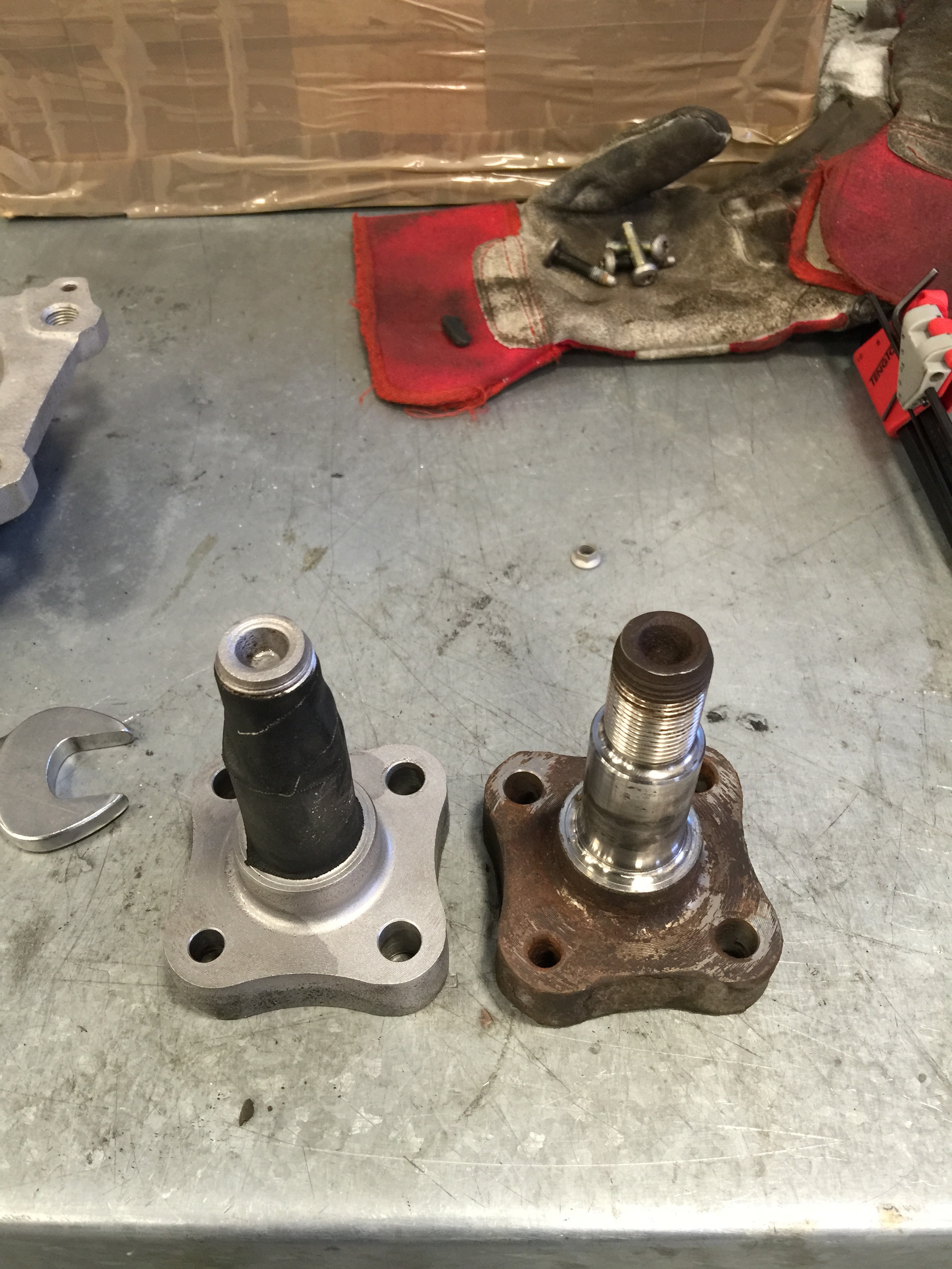

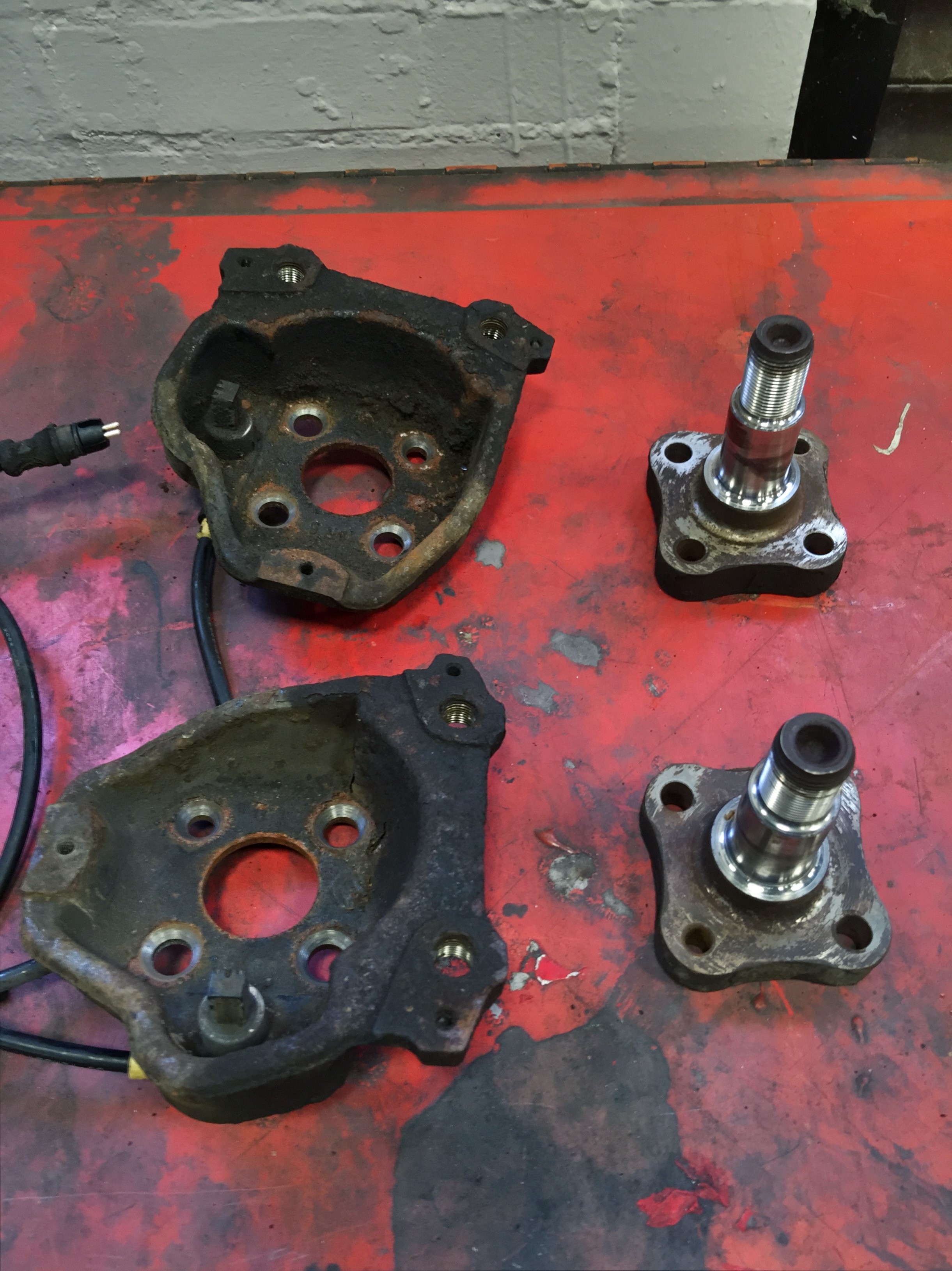

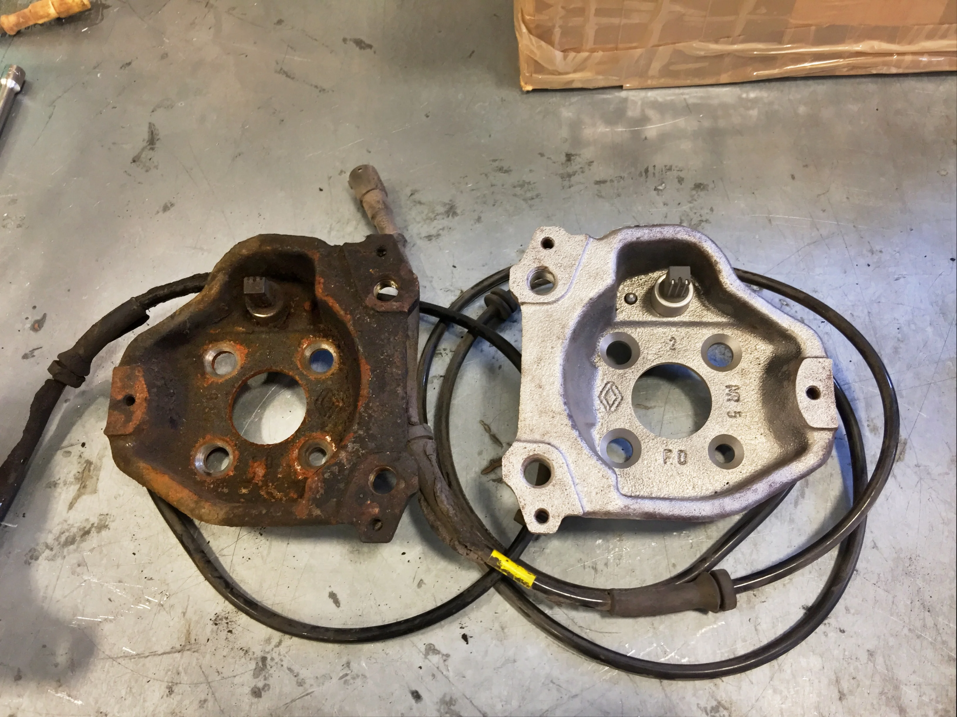

Moving onto the rear hubs and stub axles, these were really bad, so bad I decided to dremel them before sandblasting to prevent big pieces of rust blocking the cabinet up.
The results were fantastic

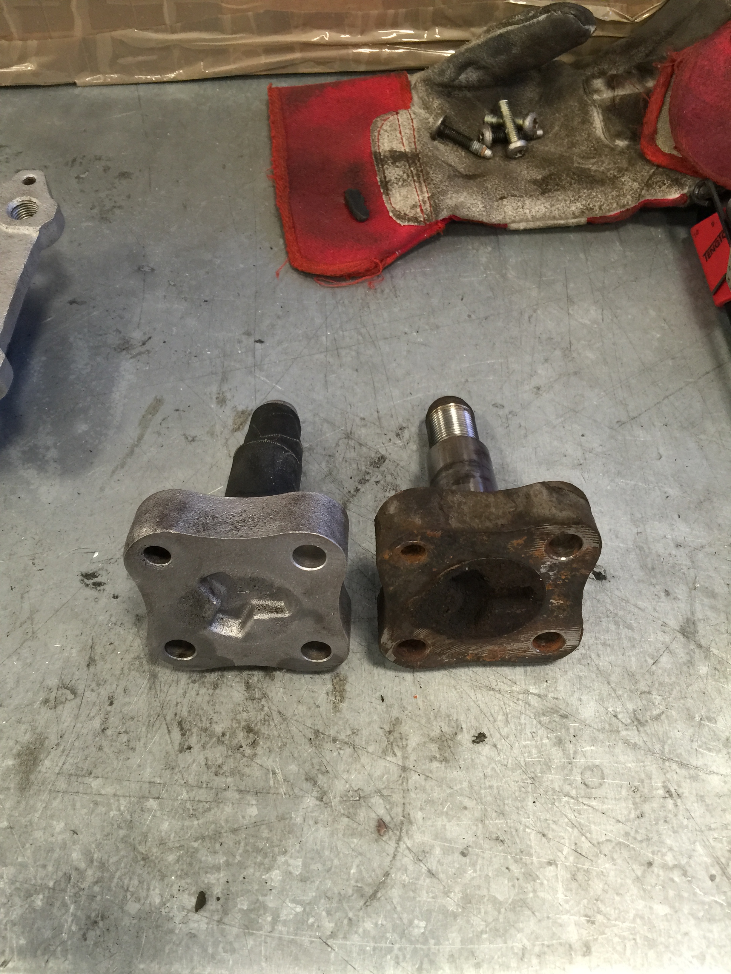

Onto the stub axles and in the mean time I was killing the sensors with FIRRRRREEEEEEEE!! DIEEEEEEEEE!!!!!
Again old vs new shots! Quite therapeutic sandblasting.

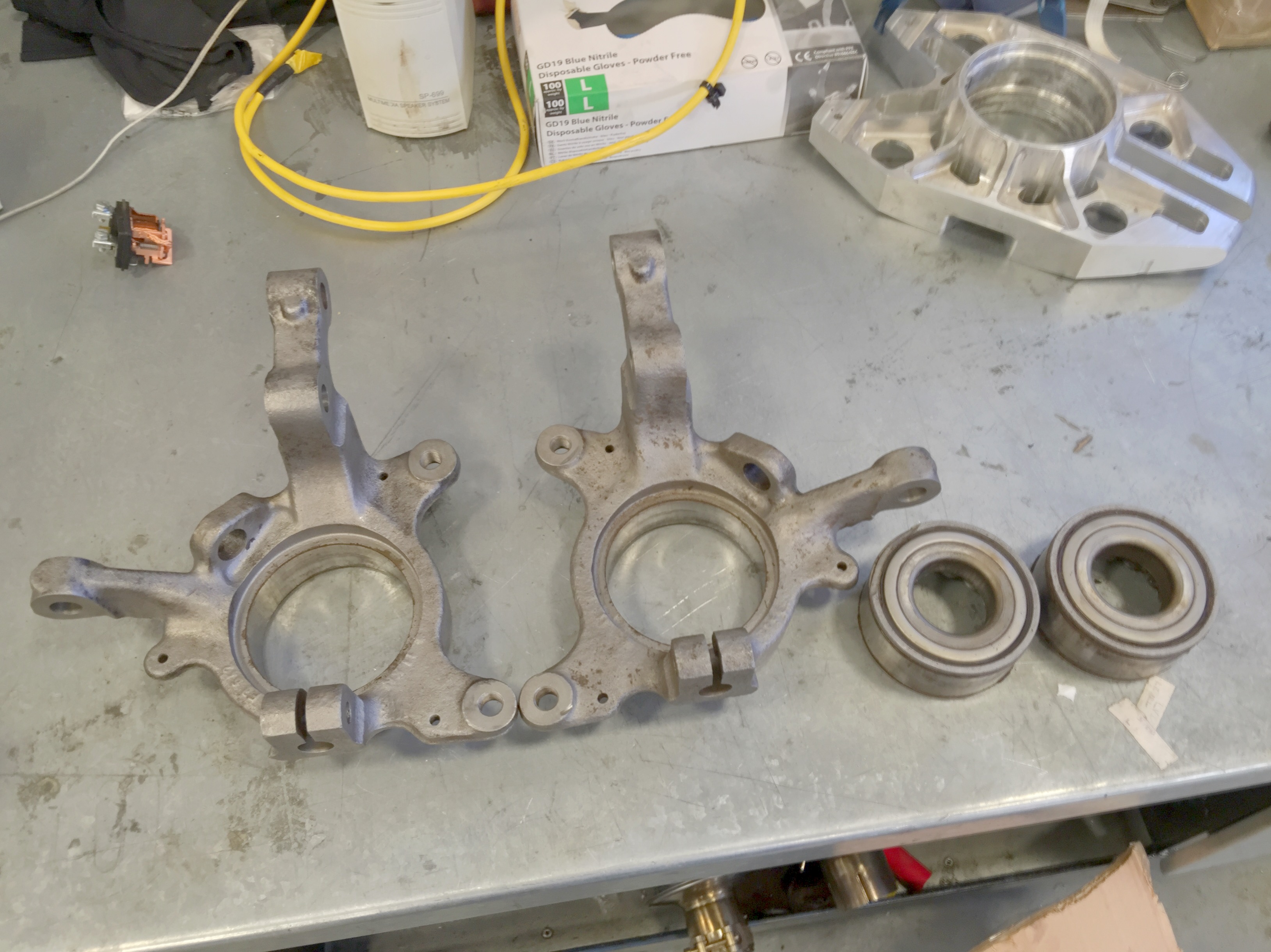

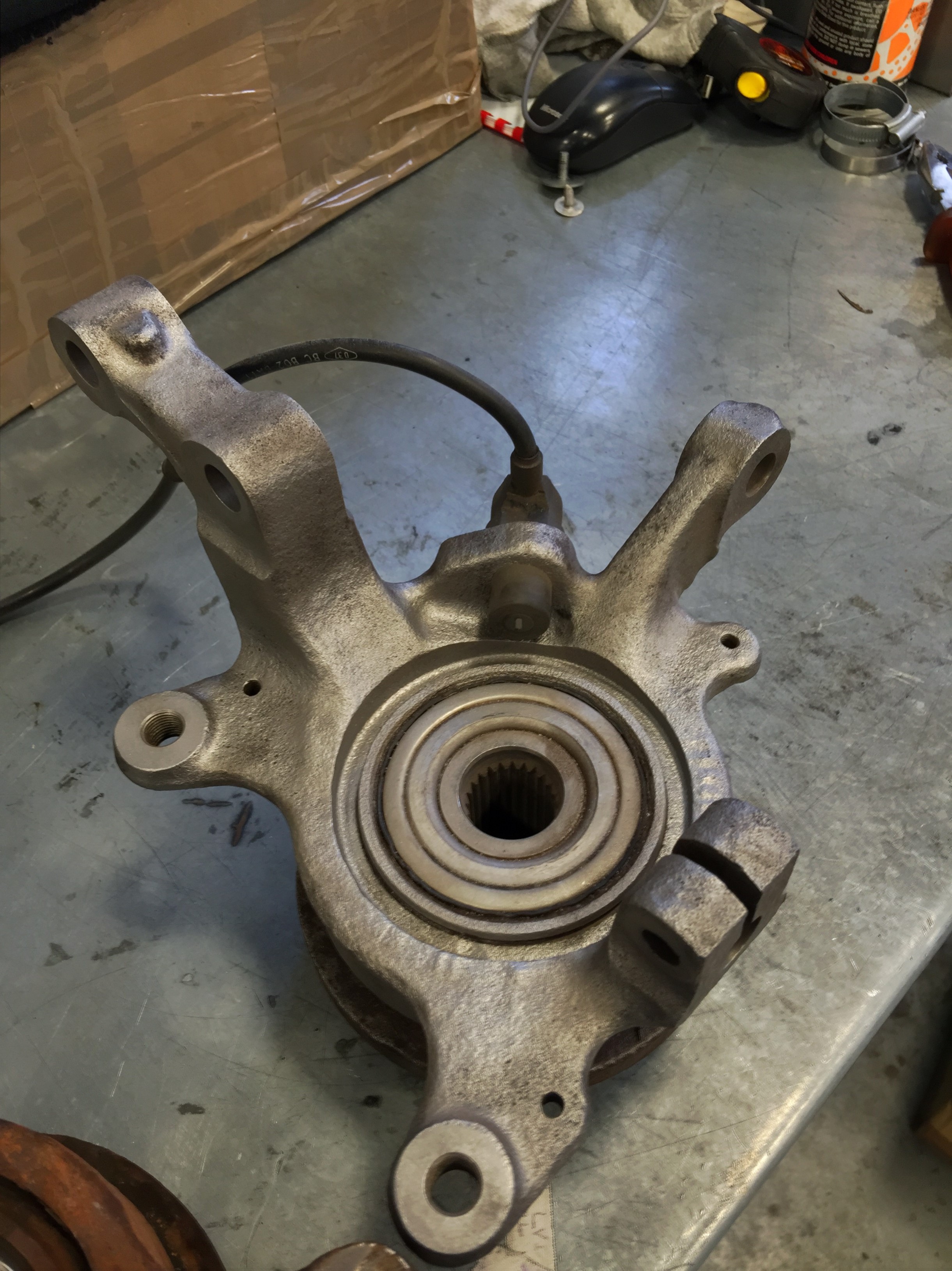

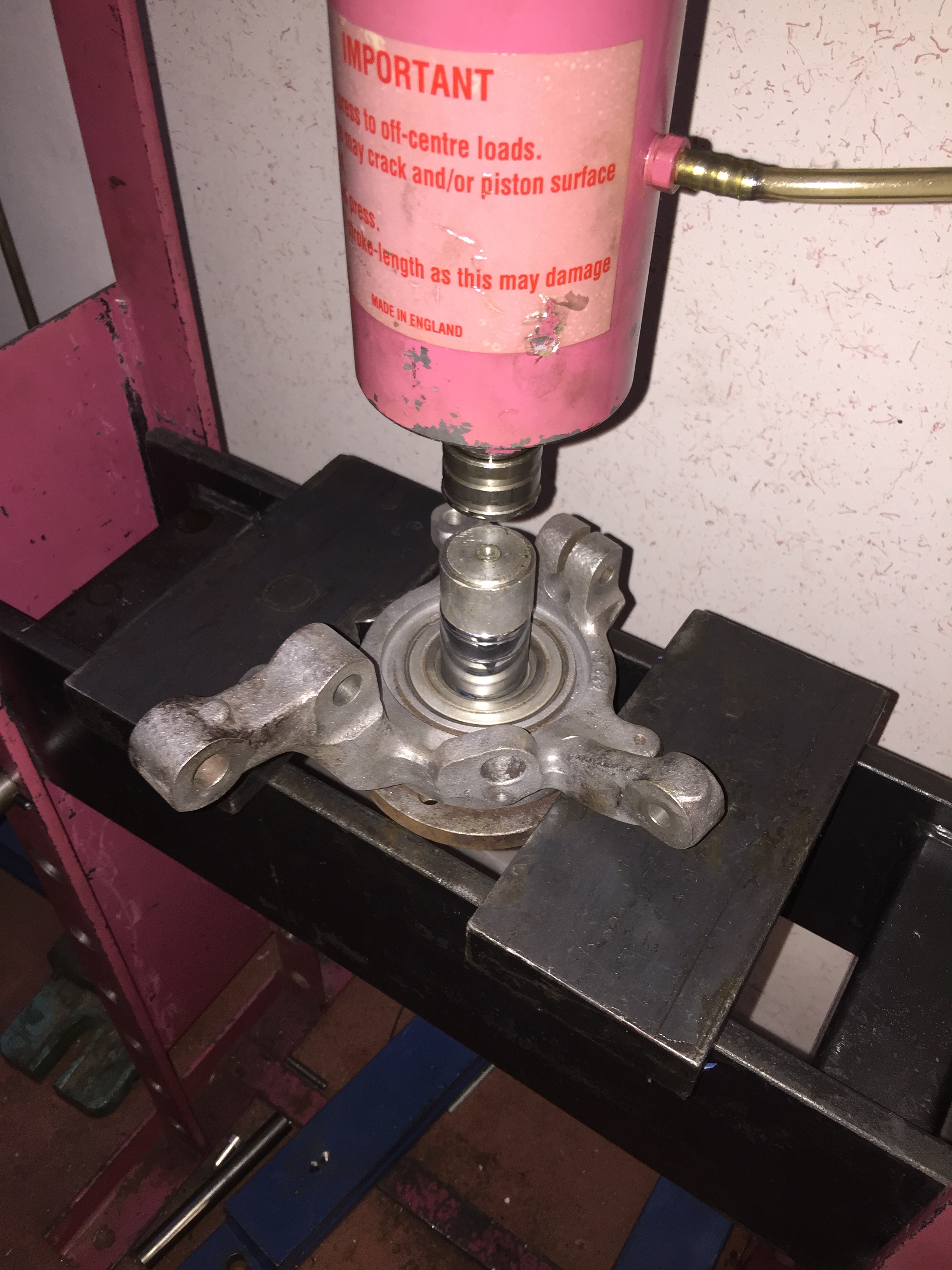

Next up was to press the hubs and bearings out...
Pressed out the hub from the upright using an alloy slug to prevent any damage. Came out easily enough with a 20tonne press

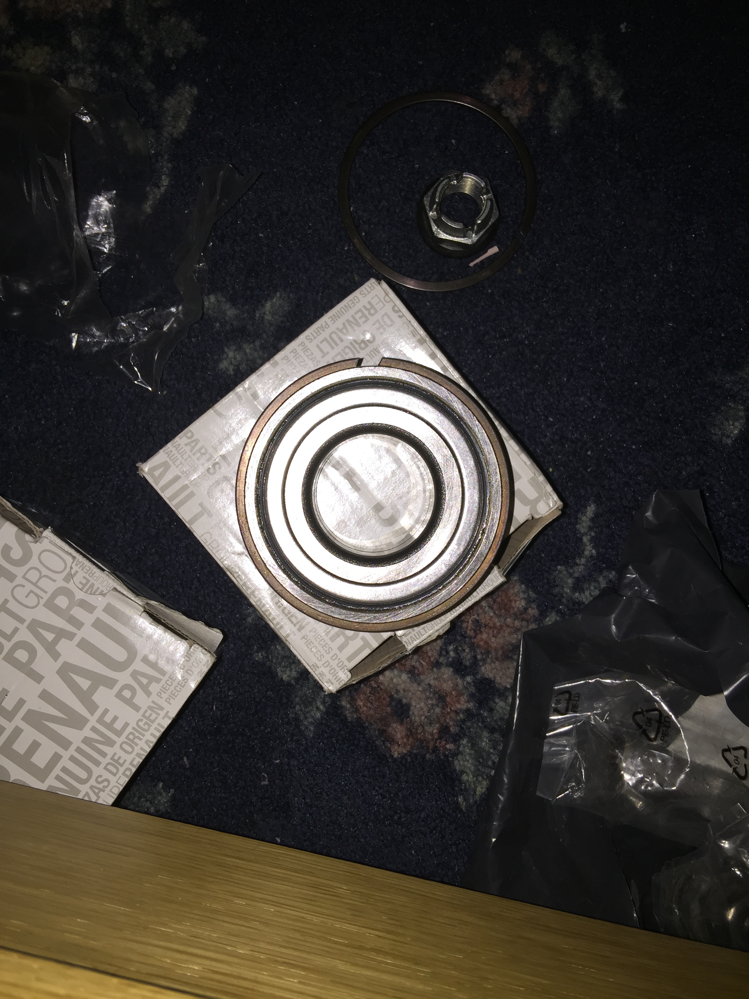

New cup bearing (slightly larger over stock)

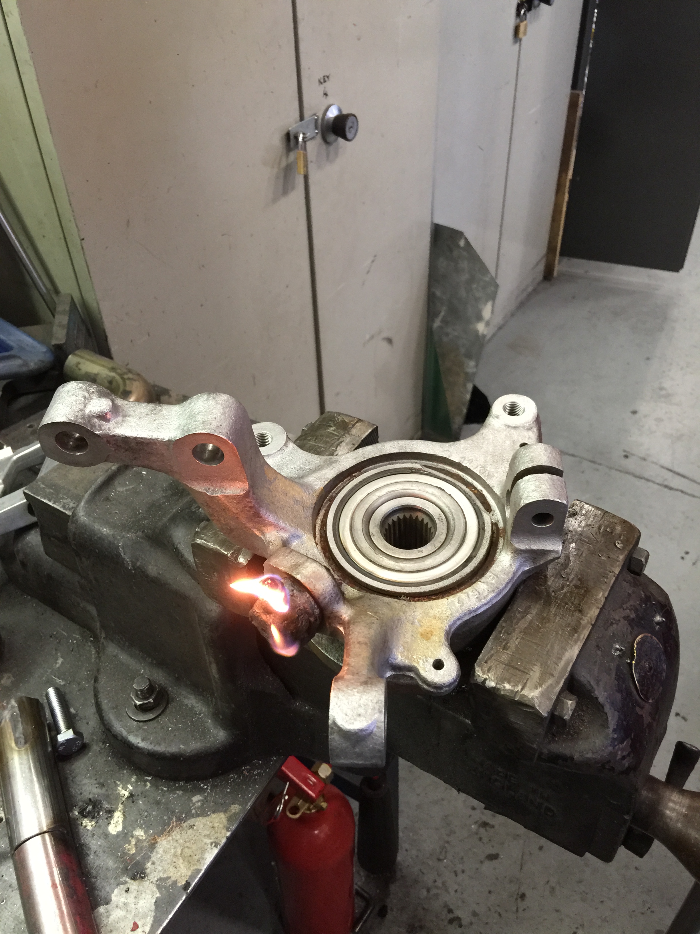

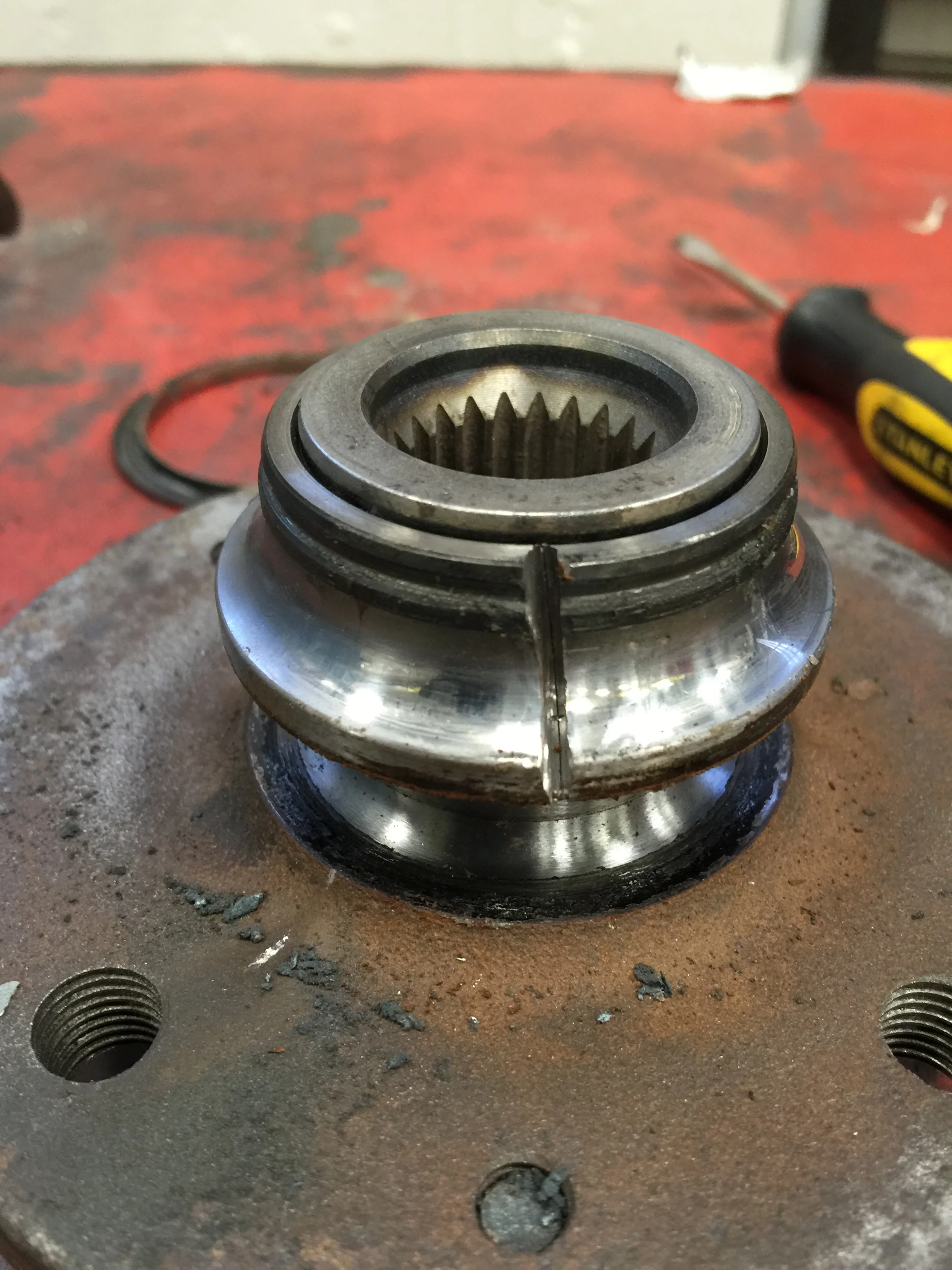

Hub released, the plonker who owned the car obviously hasn't had much experience get seized bolts out before! So these disc bolts will need to be drilled, no problemo just extra hassle really. The hubs were priced up taking this into consideration, hope they don't suffer from run out, was going to get them clocked up on a lathe but time is a b**ch.
Carefully dremel'd the bearing race off until it cracks free, did it with no markings made to the shaft.
Before and after shots.
Always mask off any bearing surface, as the sandblasting changes the tolerances.
Just need to drill out the snapped disc locating bolts, admittedly they aint really needed especially as ill be running with bolt on spacers but my OCD wasn't happy!! haha

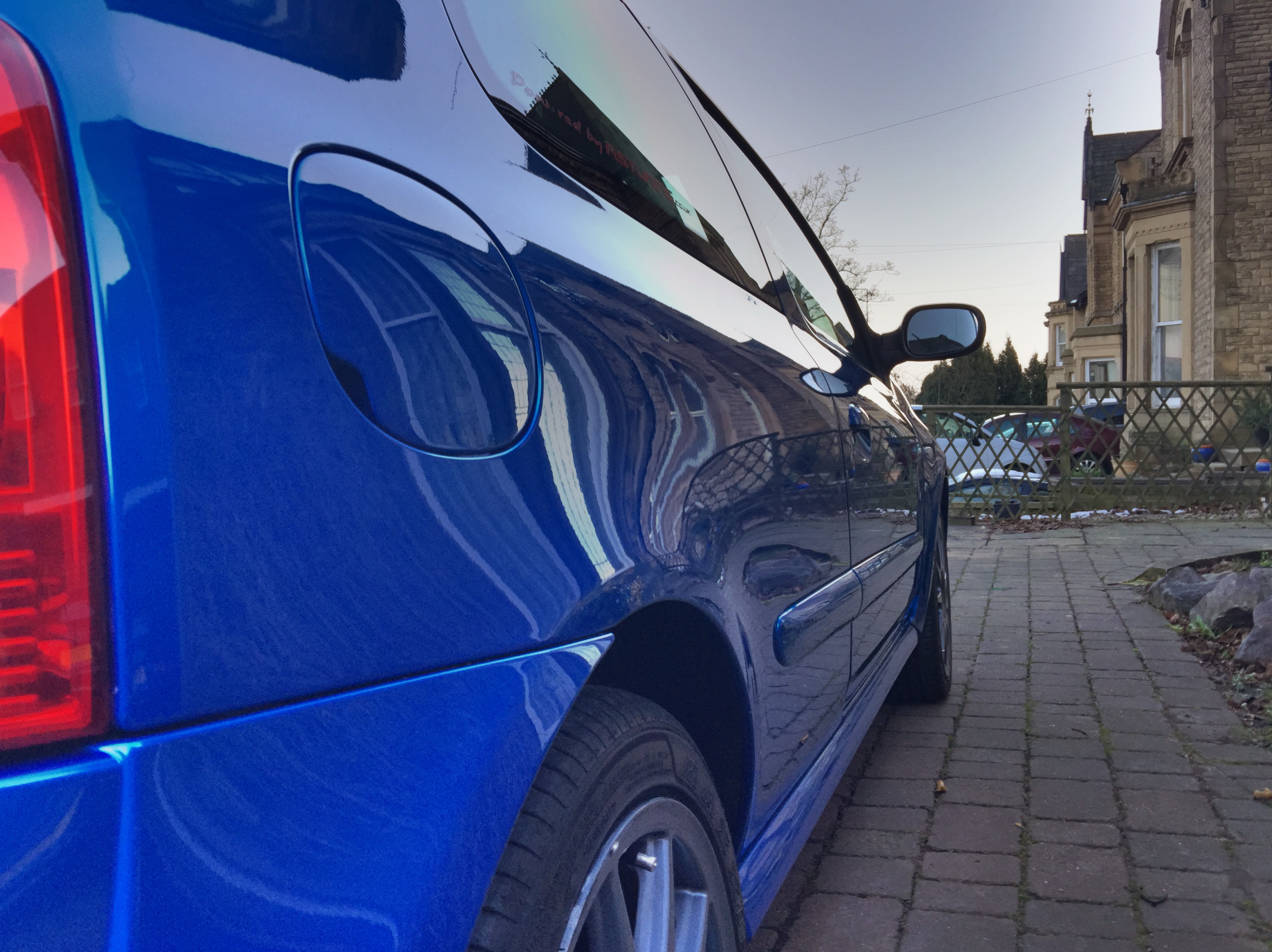

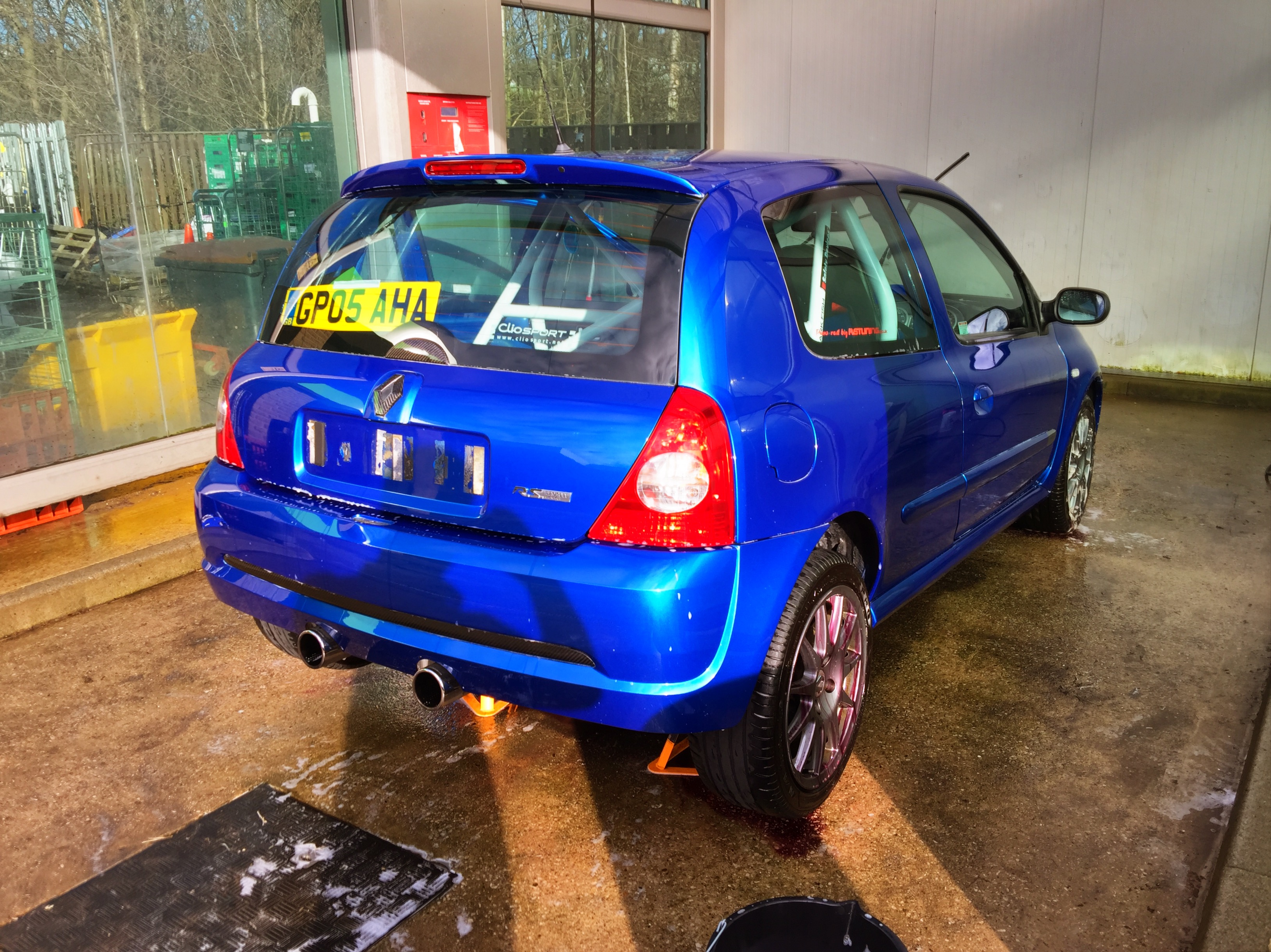

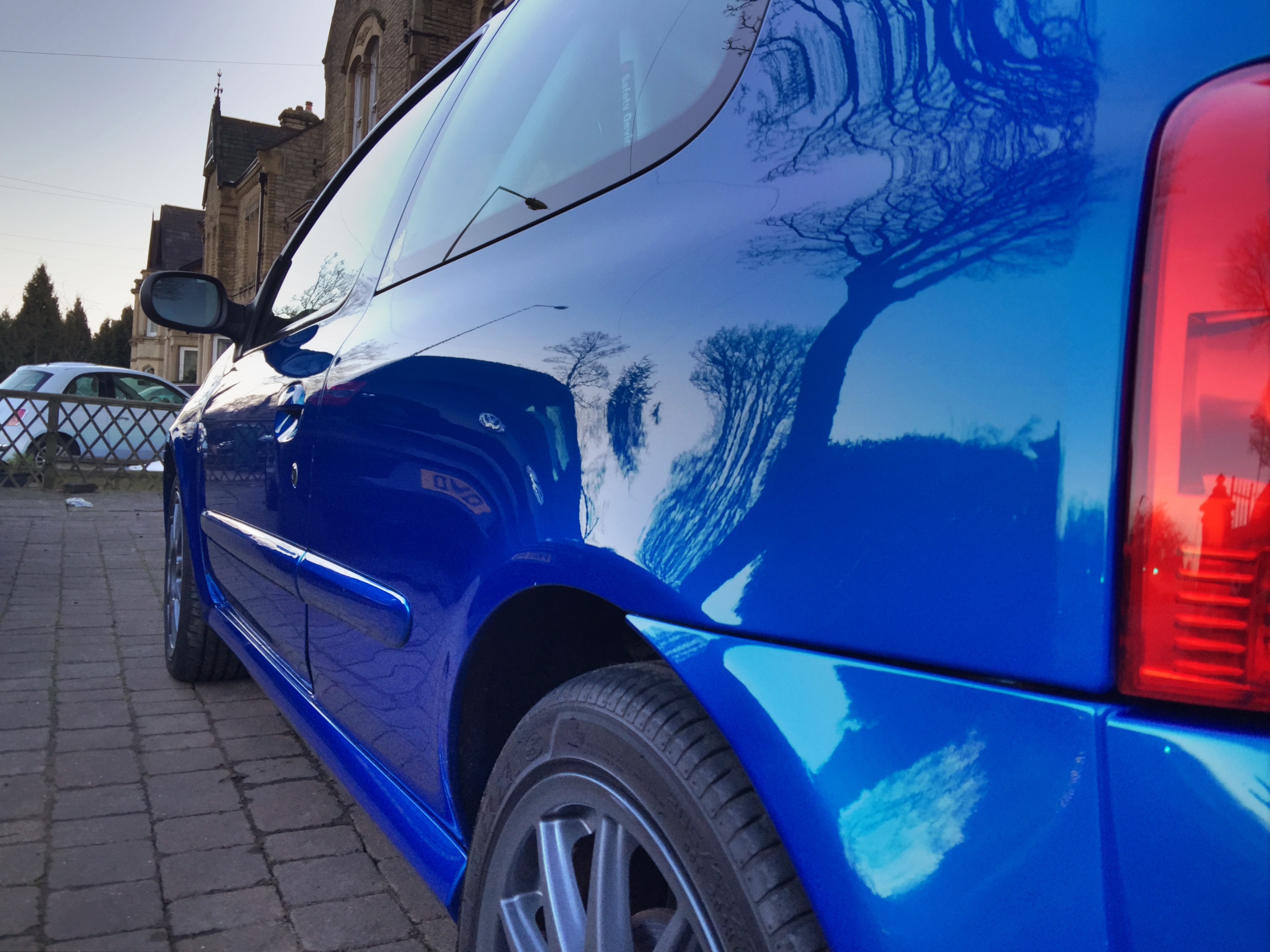

Quick wash, seal and a polish, my plate fell off during the great winter snow depression, think my foam pads absorbed some water and it froze off haha.
My car most certainly doesn't have the best paintwork bt it does clean and polish up well.
Love this shot from my house
Hmmmmm dat arch gap! Saving them cats!!
Frozen bead shot!

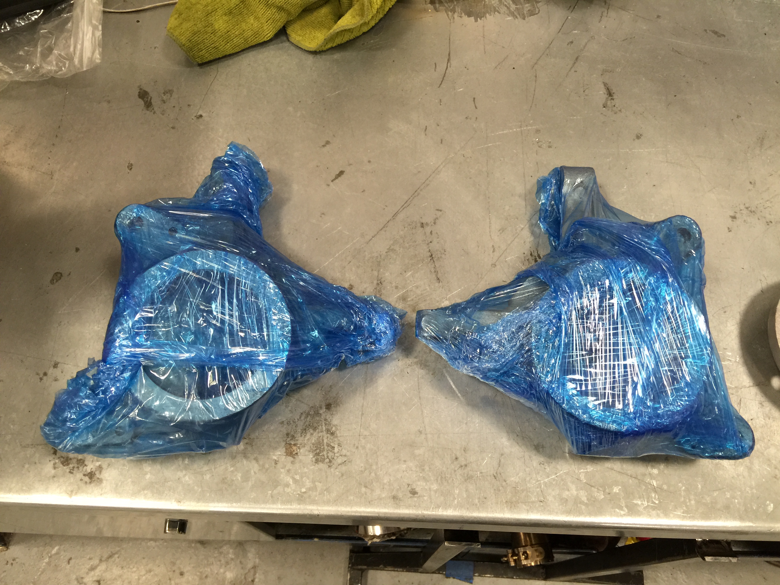

Uprights all finished and wrapped up ready for powder coating!

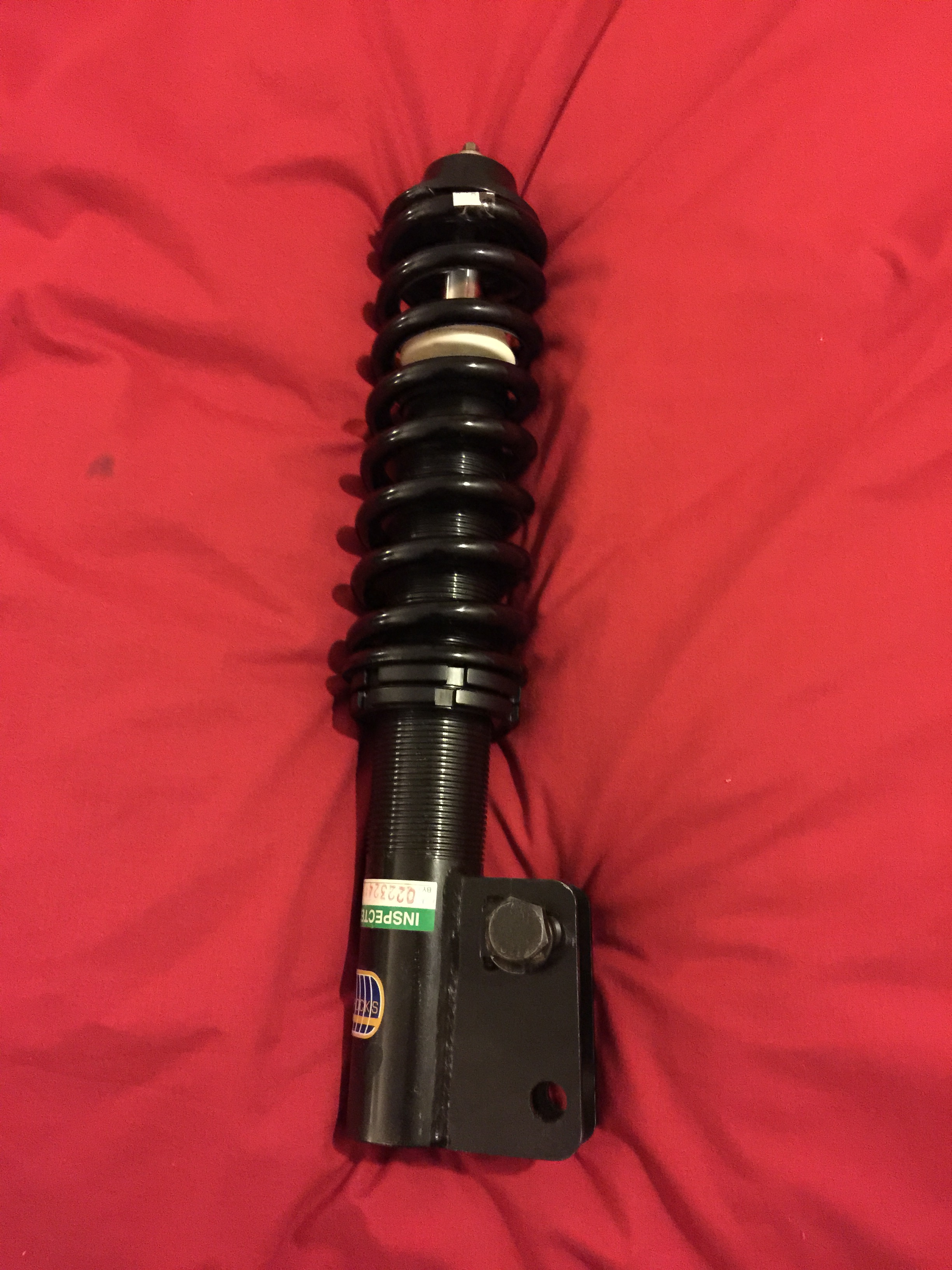

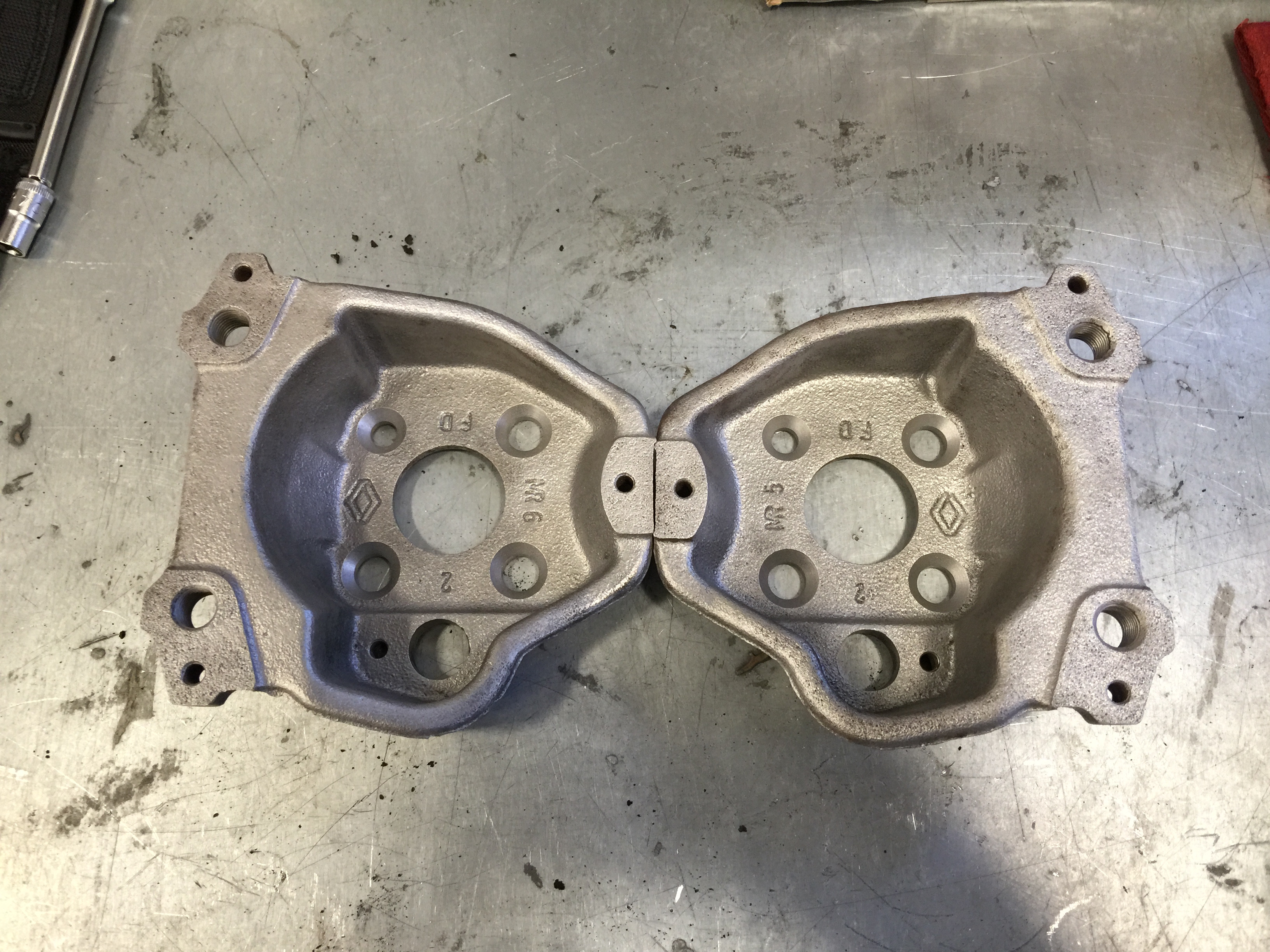

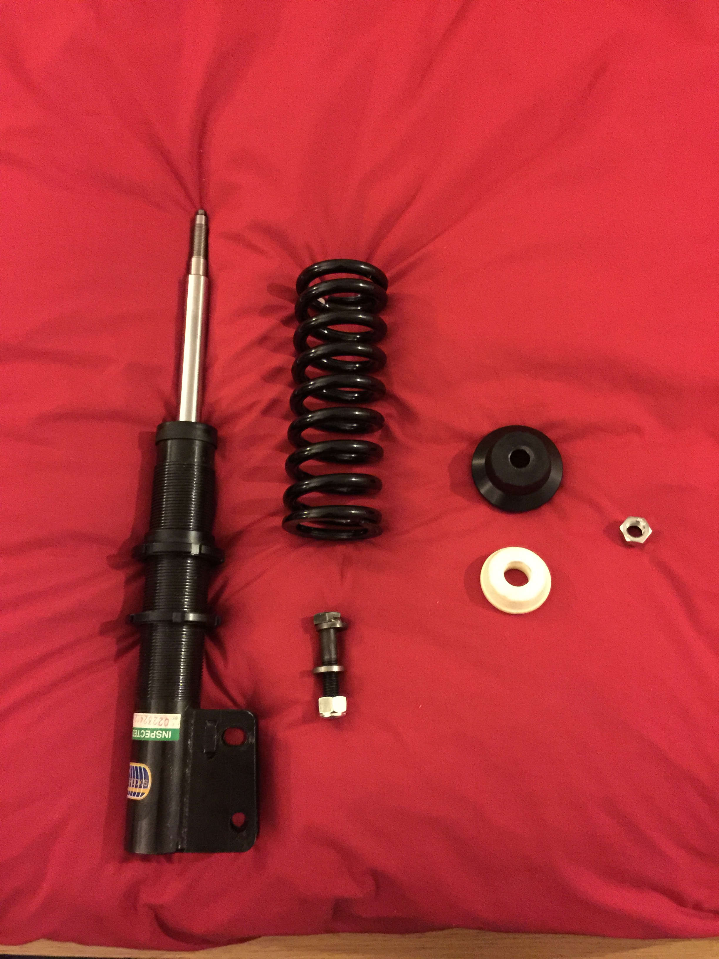

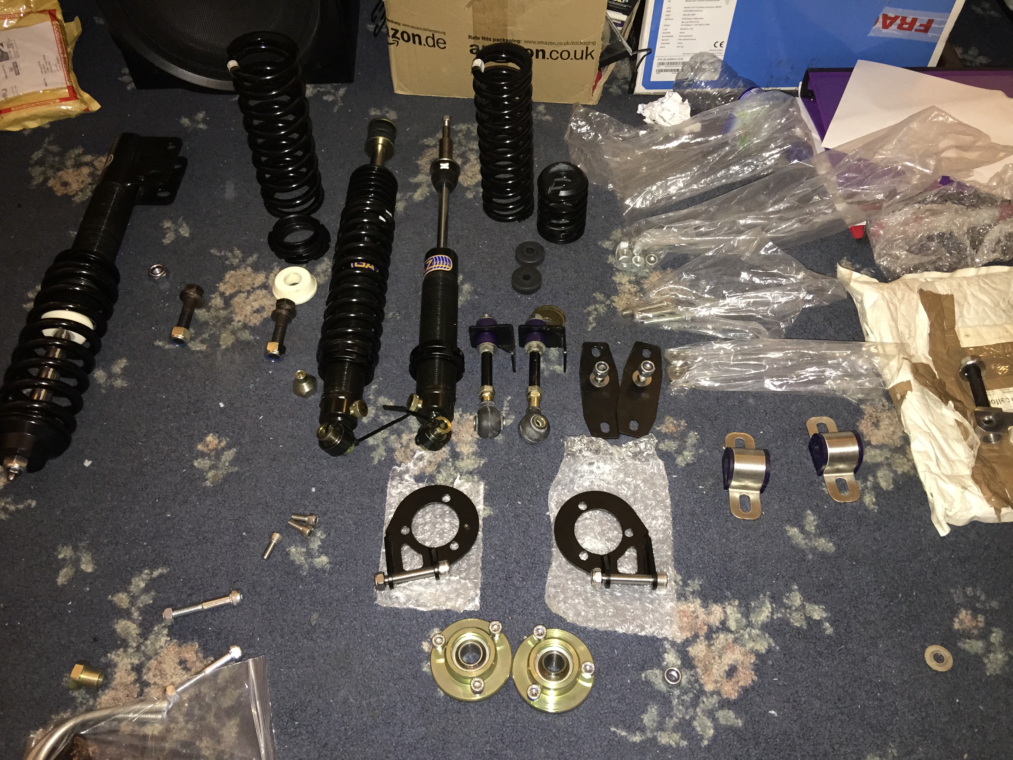

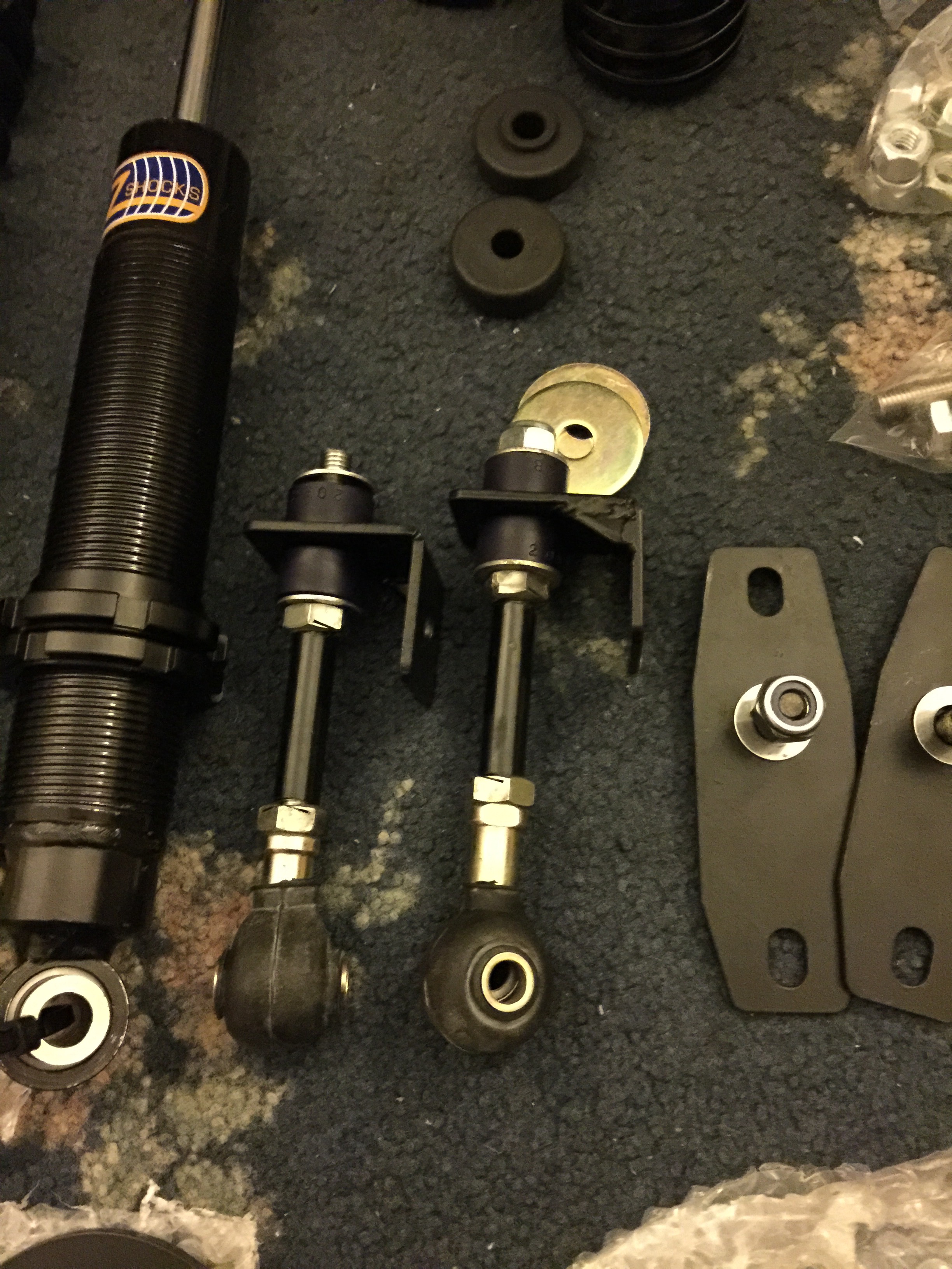

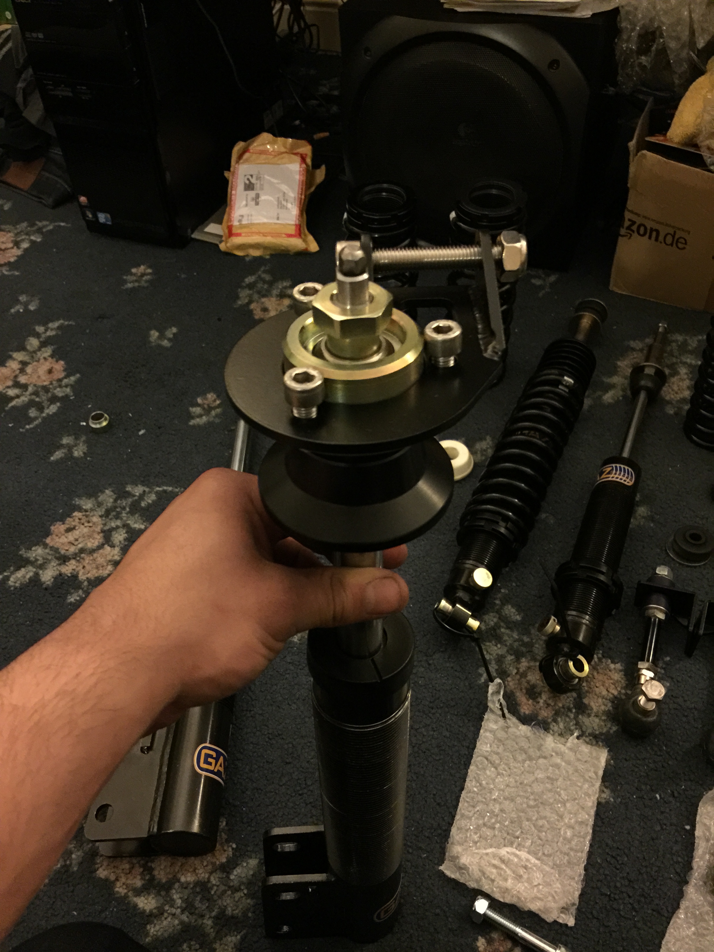

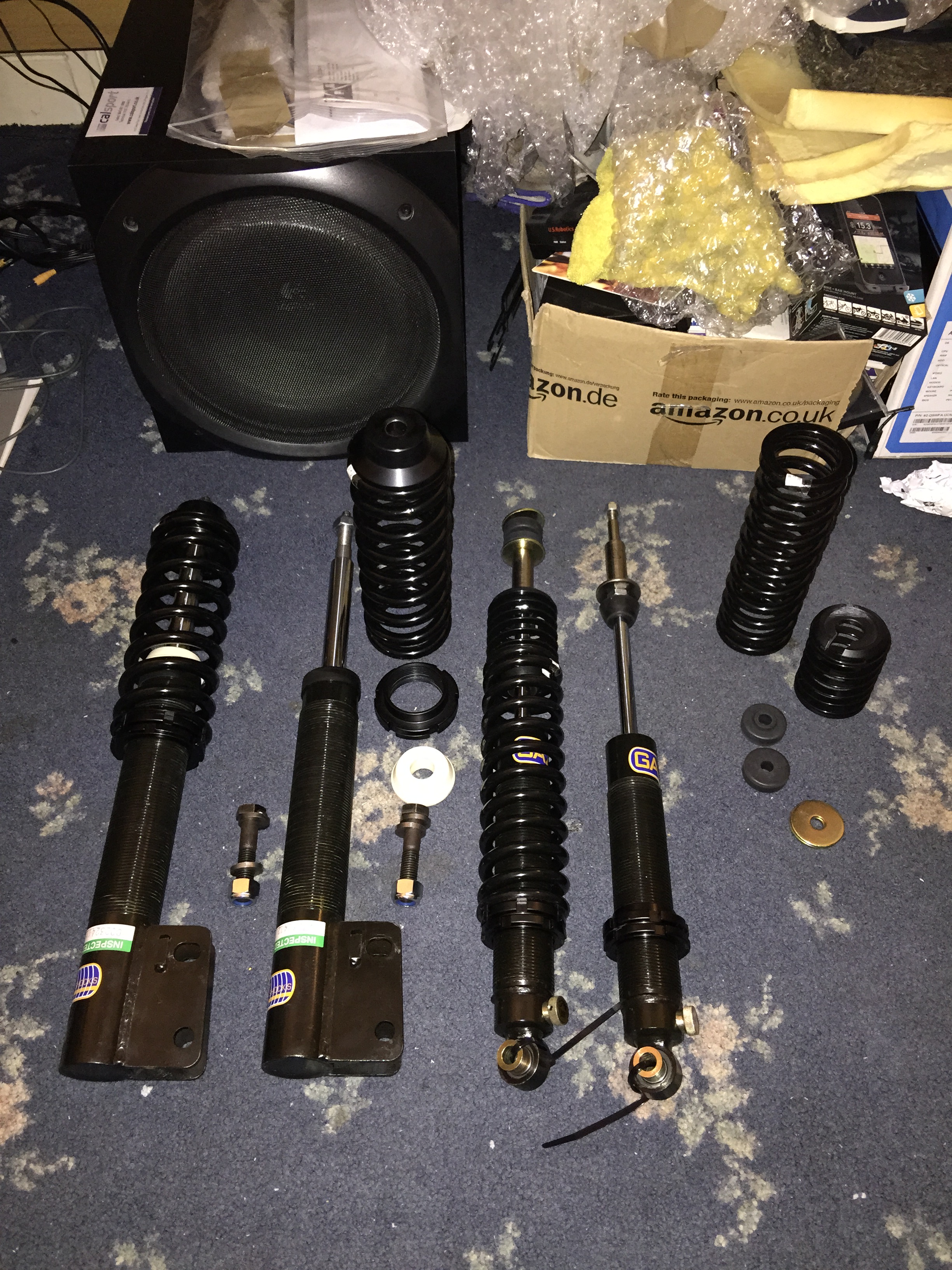

New style GHA's from GAZ courtesy of Mr @Weeksy not sure if hes still on here anymore but what an absolute top bloke!!
The new iteration comes black oxide coated,rear coilover unit and spherical bearings (upon request).

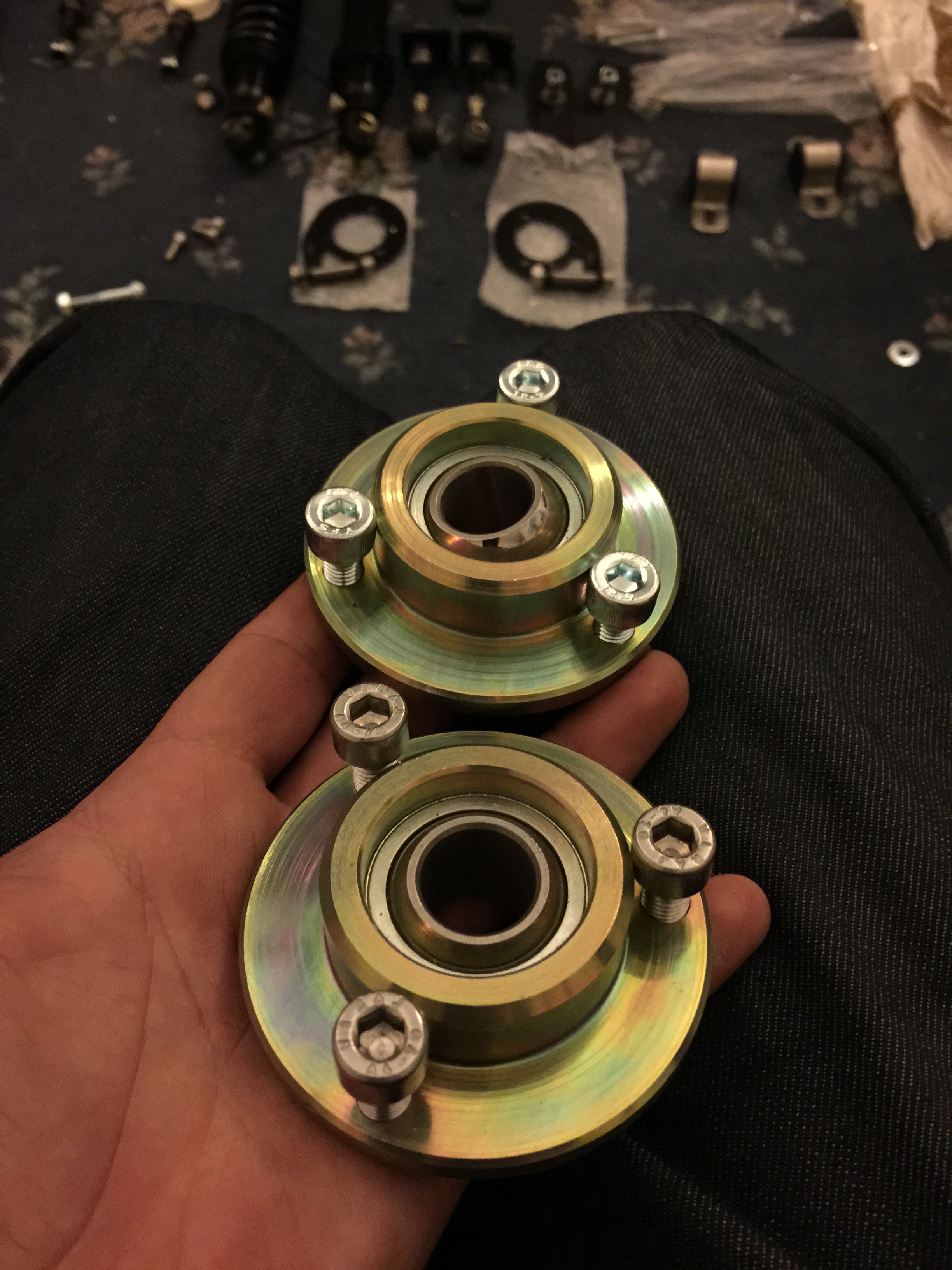

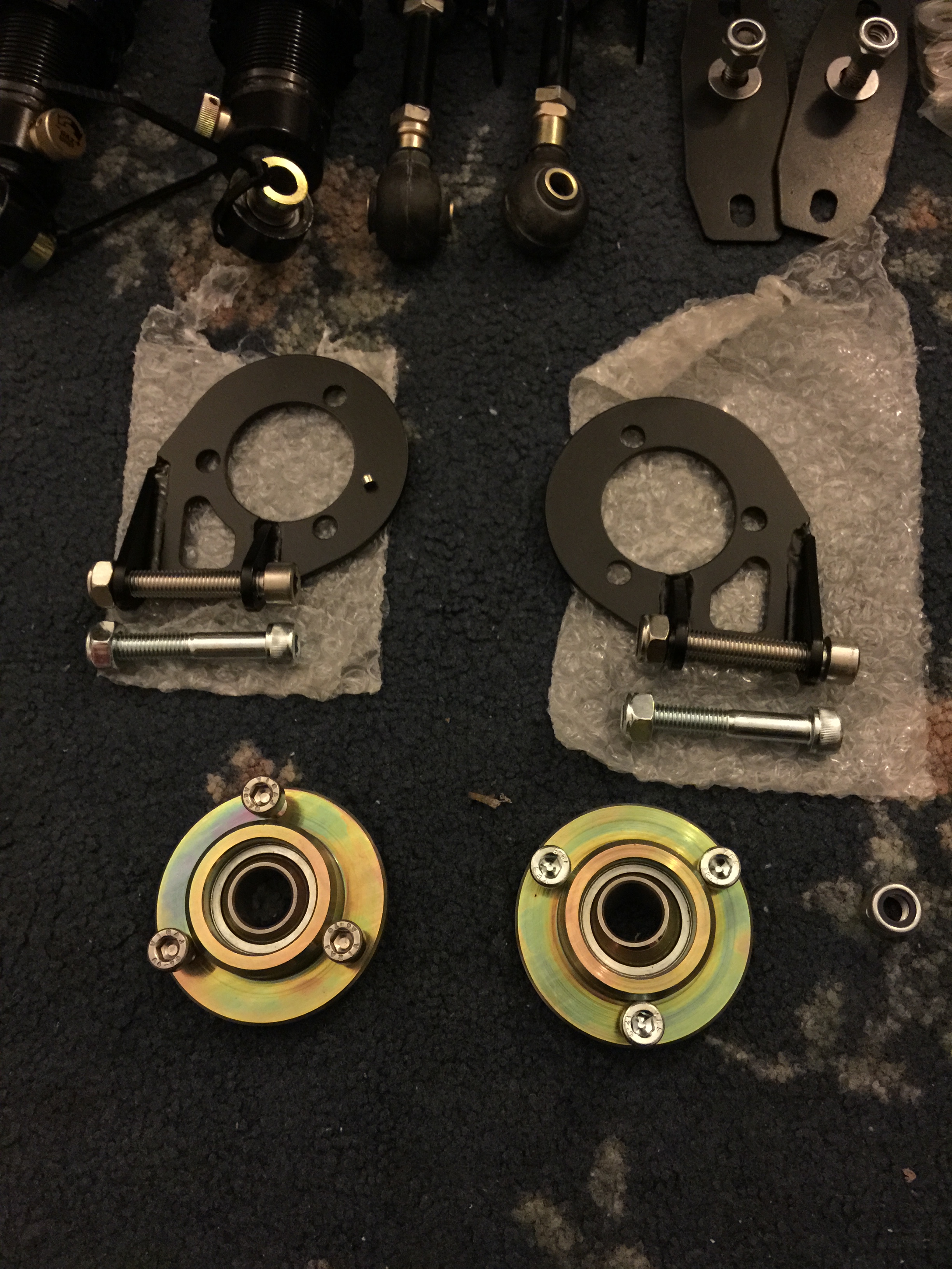

PMS top mounts, just swapping out all the nasty plated bolted with stainless steel items.
Mmmmmm rose jointed drop links yummy

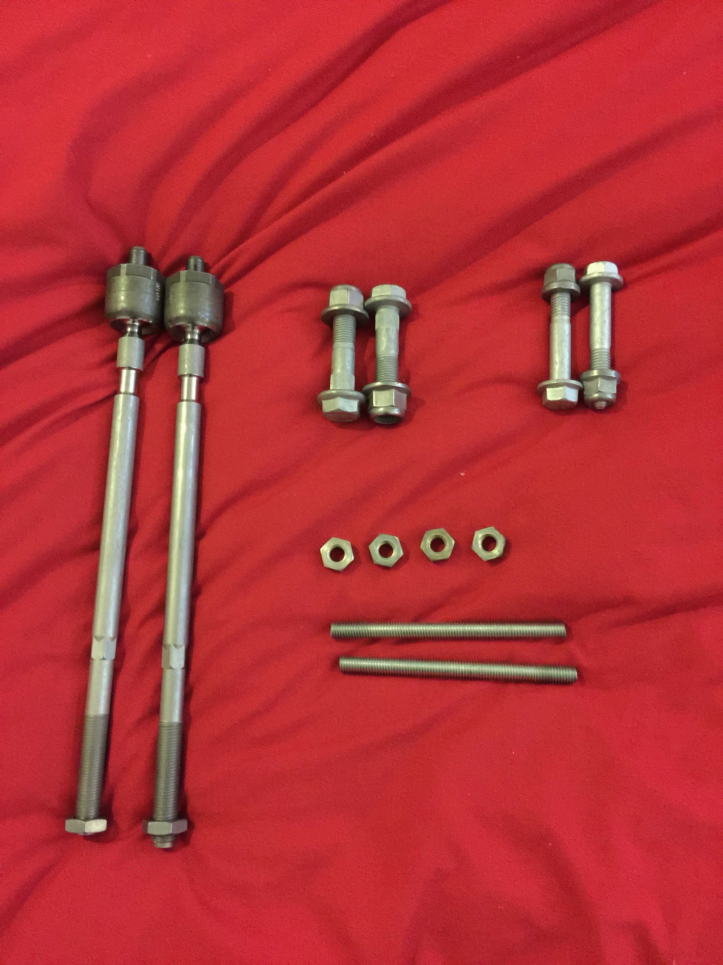

Hard to tell on the pics but the subtle differences here are plated mild steel bolts vs the high tensile stainless steel jobbies
Checking fitment of the PMS top mounts on the GAZ GHA dampers, no problems here.

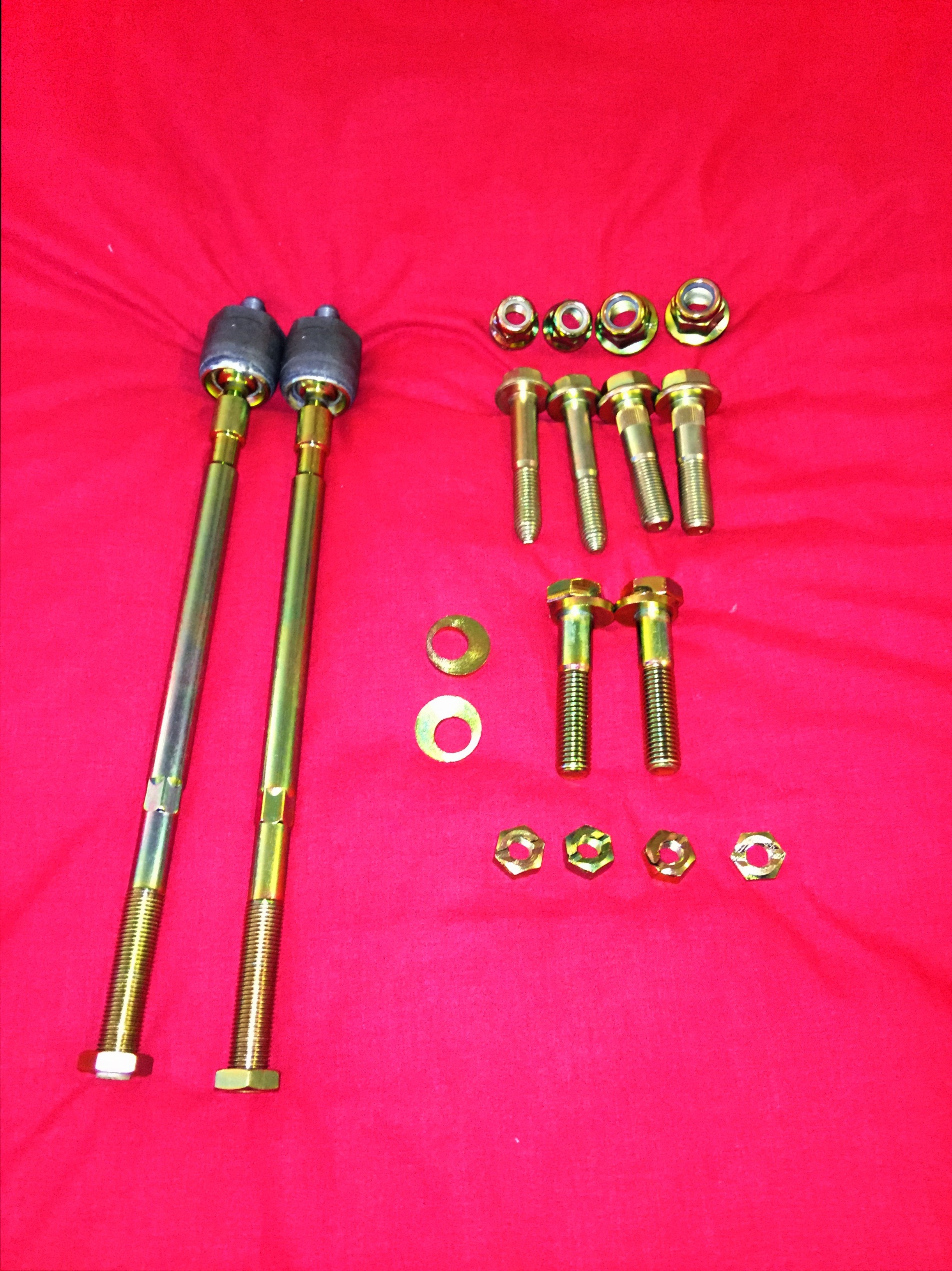

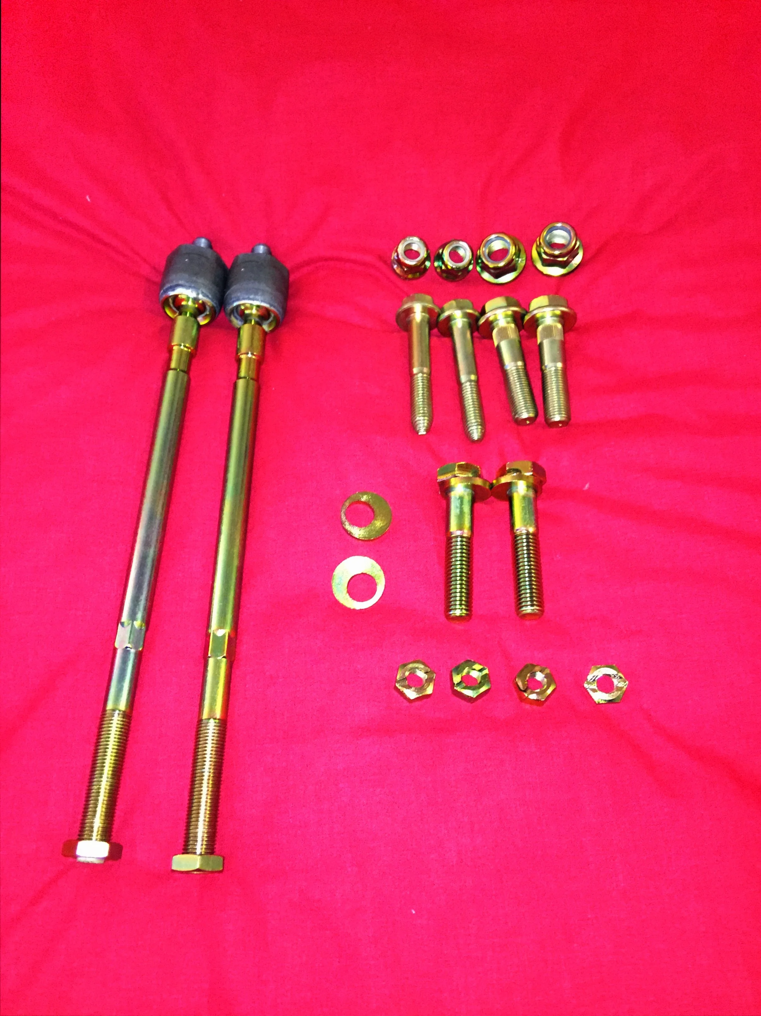

To add to my previous comment @smiffyboy im using new Genuine OEM Ren bolts that have been clear zinc plated then followed with a CR+6 yellow pass and de-embrittled for 8 hours to prevent hydrogen embrittlement. Not usually a fan of yellow passed zinc but the quality is outstanding
Before
After, it was so shiny it messed up my cameras focus haha makes my red bed look pink hahaha
  • Like
Reactions: Gus

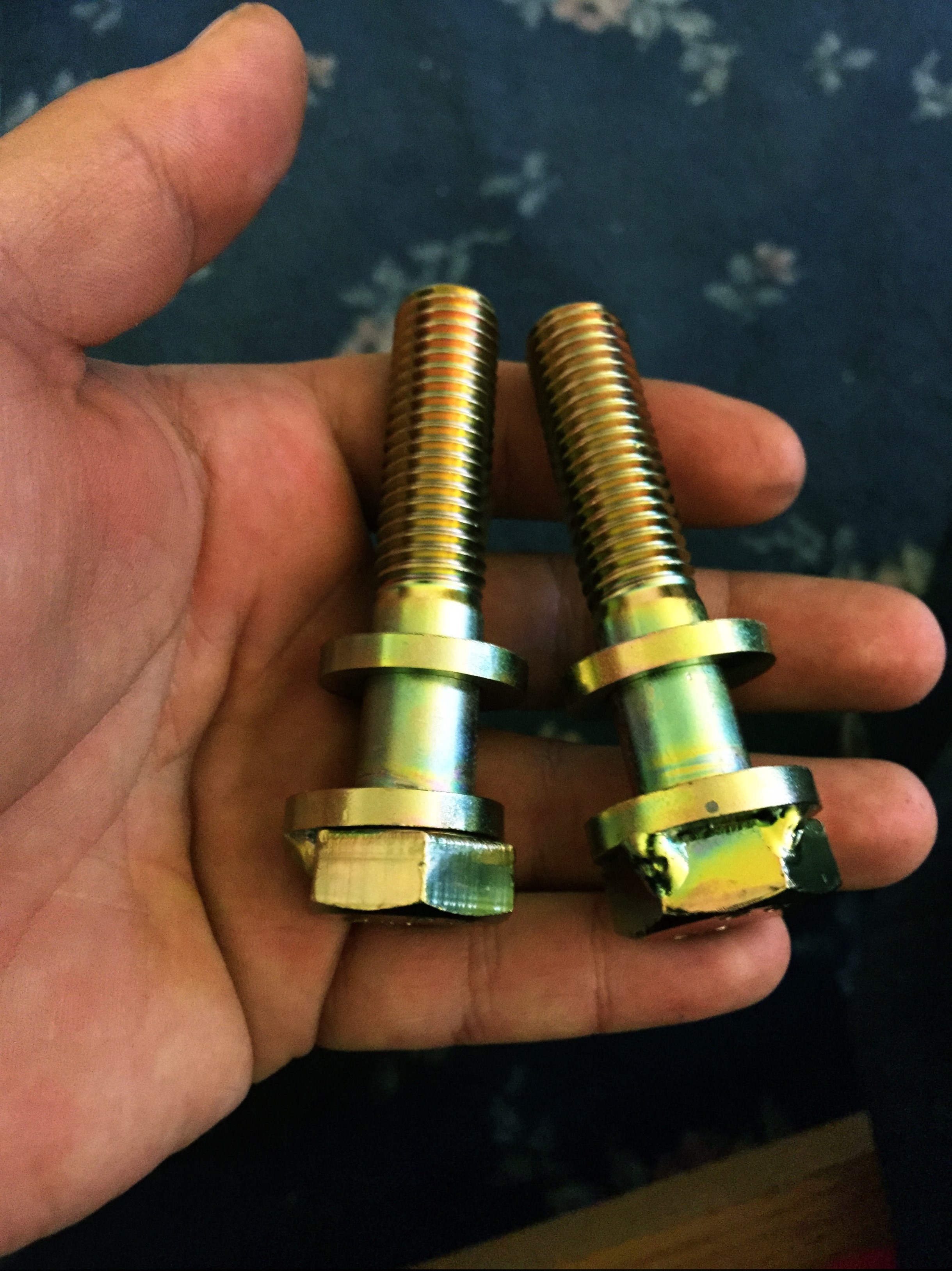

GAZ camber bolts came out great, these were a must, due to the eccentricity washer that is welded on is unfinished mild steel, would have rust before I had chance to fit it to the car

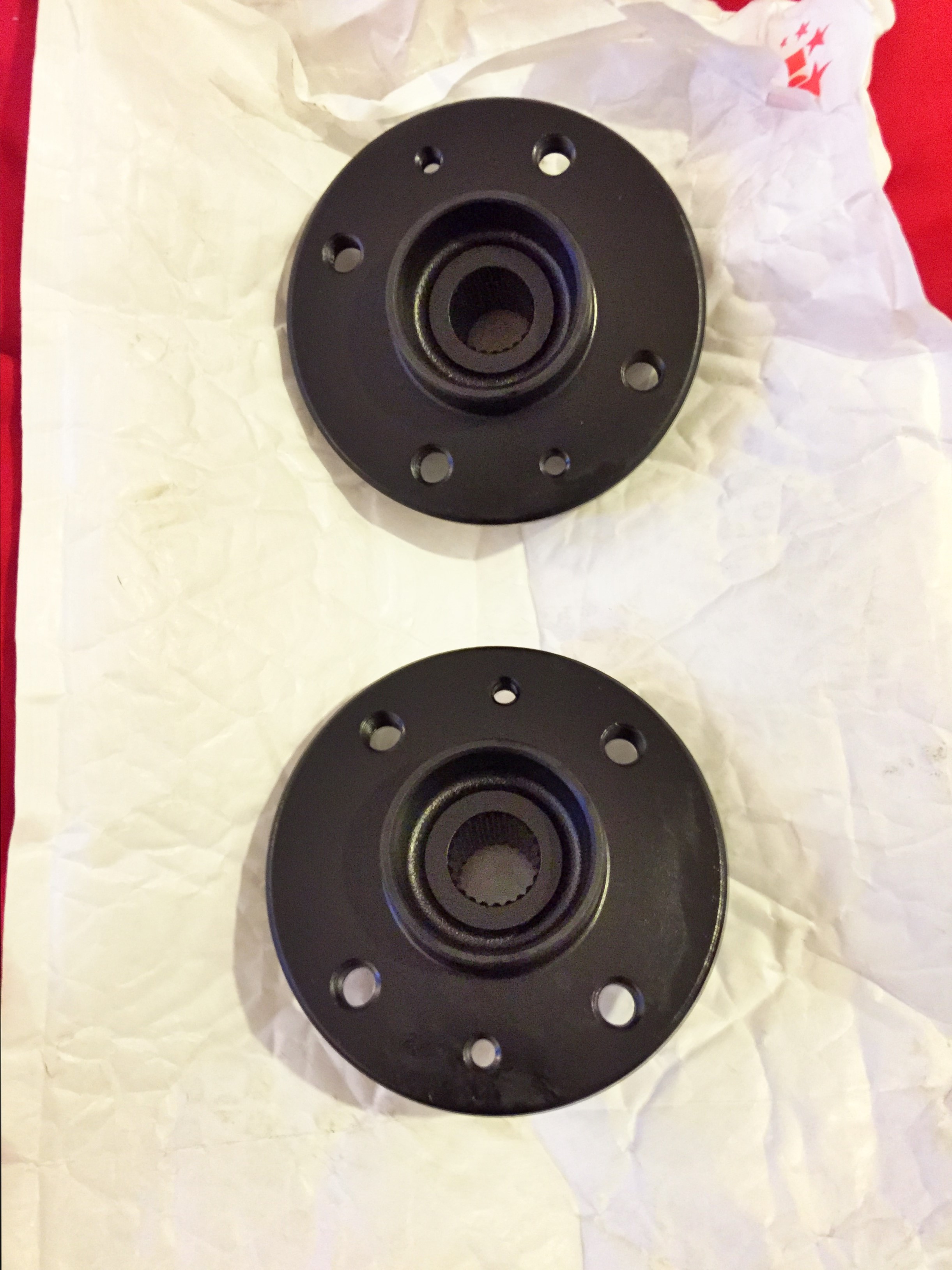

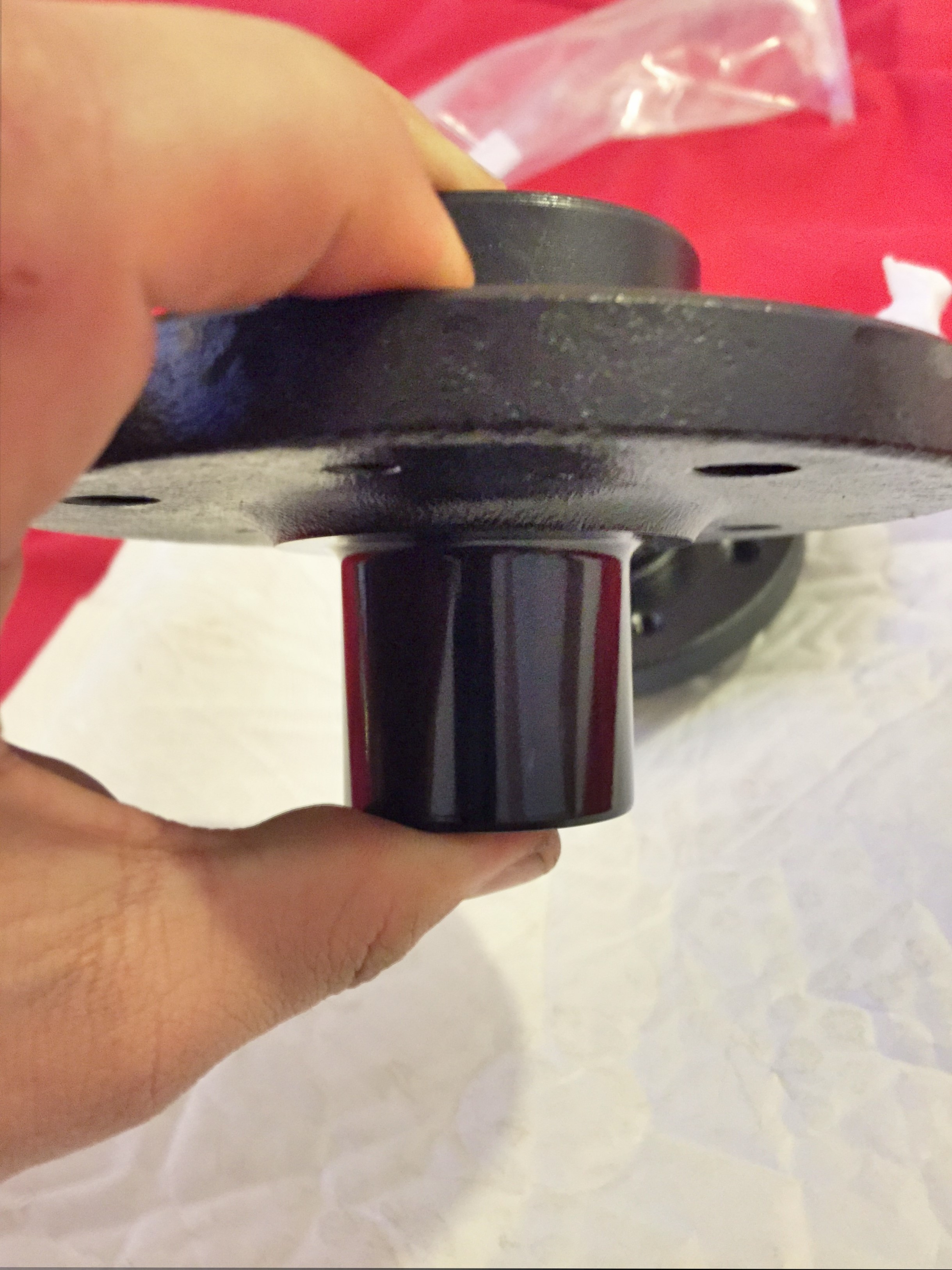

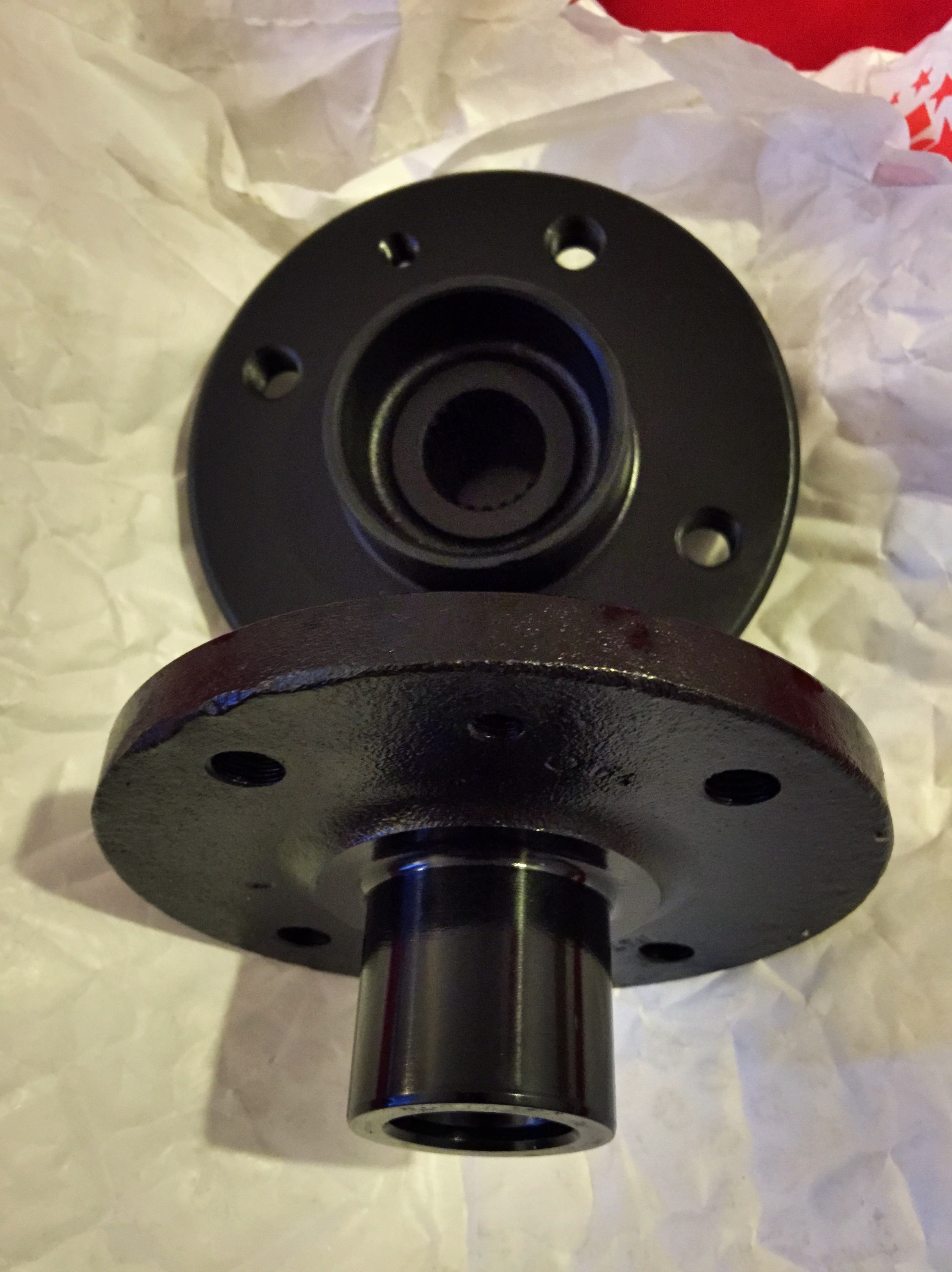

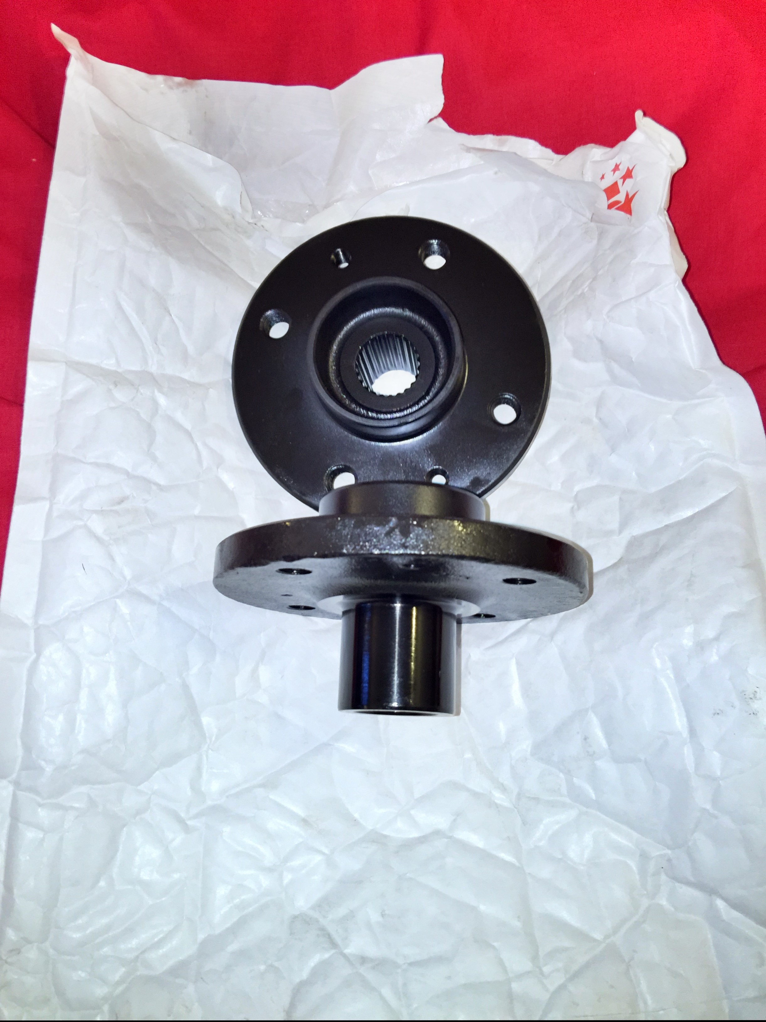

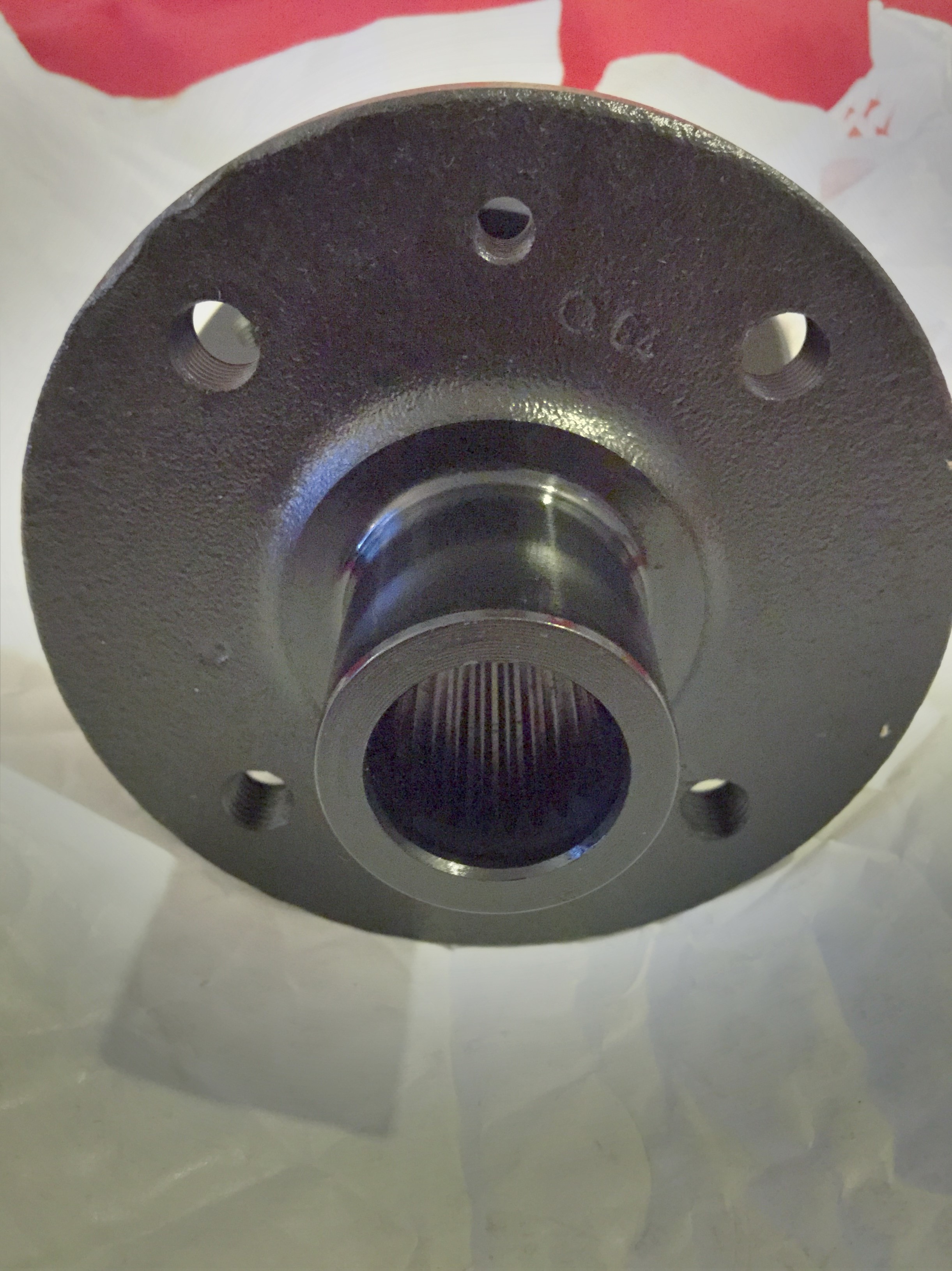

I also had my hubs Hot Chemically Black Oxide Coated, which is a chemical conversion coating, and unlike zinc that is merely applied to the surface Black Oxide Coating is a result of a chemical reaction between the ferrous metal and the Oxide salts, which means it doesnt increase the dimensional tolerances, so was the perfect process for my hubs i.e. for the wheel face, driveshaft spline and the bearing stub type shaft. Where as paint couldn't be applied to any of the mating surfaces.
The photos don't really do them justice, the finish is superb and is like glass!! Really happy with the result!!

The yellow passed zinc look nice and fresh, Where did you get that done if don't mind me asking ? My dads currently doing a full restore on one of his Tvr's and is wanting to do some of his bolt.
Have a nosey on this thread http://www.detailingworld.com/forum/showthread.php?t=201688&page=11 Great thread of a really clean Clio sport.

Im not usually a fan of the zinc stuff but they really have done an awesome job, they do come out well especially on new bolts. Got them done from a place called Moss Metal Finishing, not far from me mate give them a look up, highly recommend them!!
And if you do use them mate, say that the University of Huddersfield recommended you. They sponsor our Formula Student Team so would be could them brining in new customers from it, and they'll look after you too.

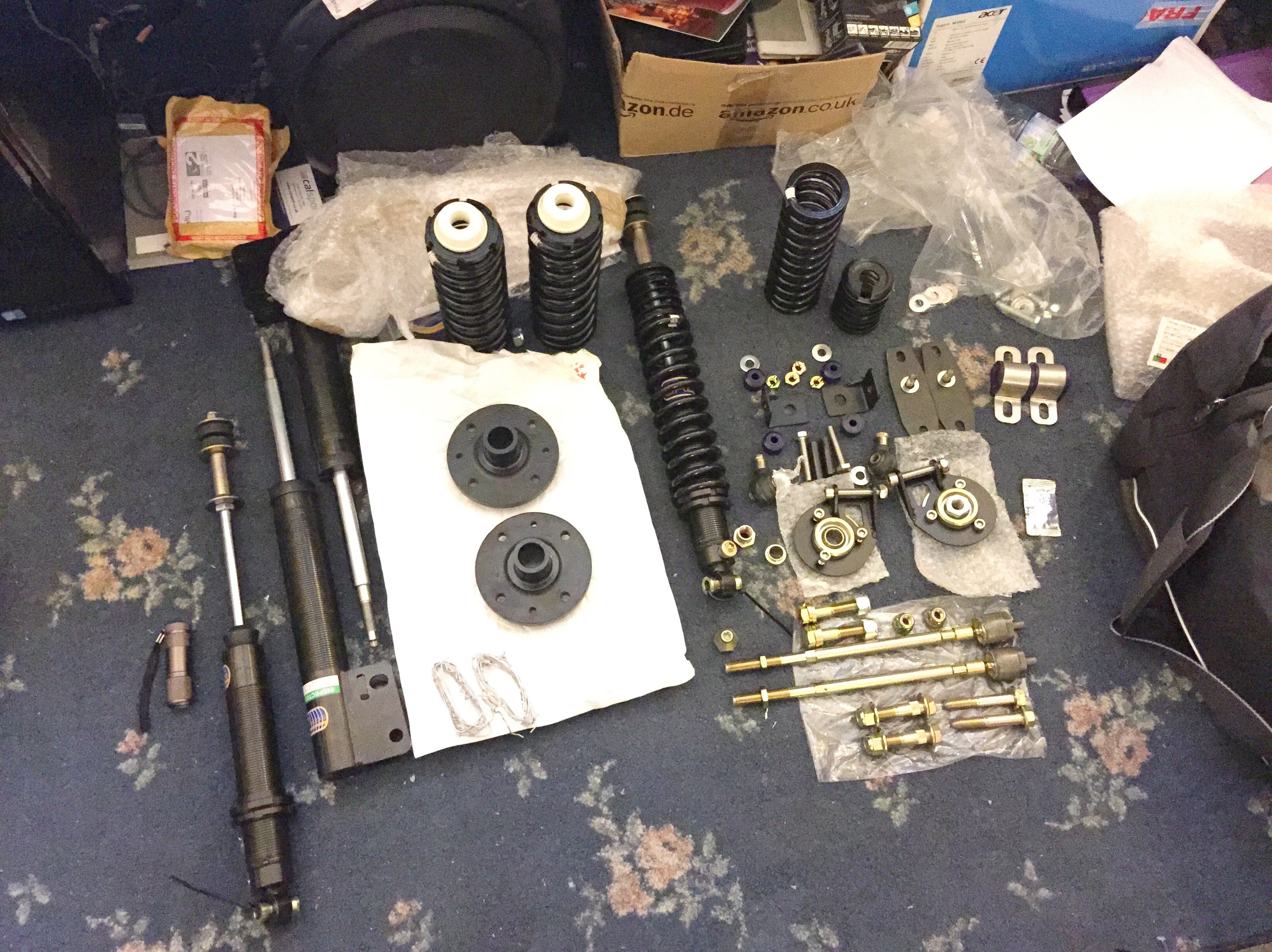

Ive got a massive collection of stuff gathering on my bedroom floor too! When the weather is good and i'
ve got everything I need ill be fitting it all up.

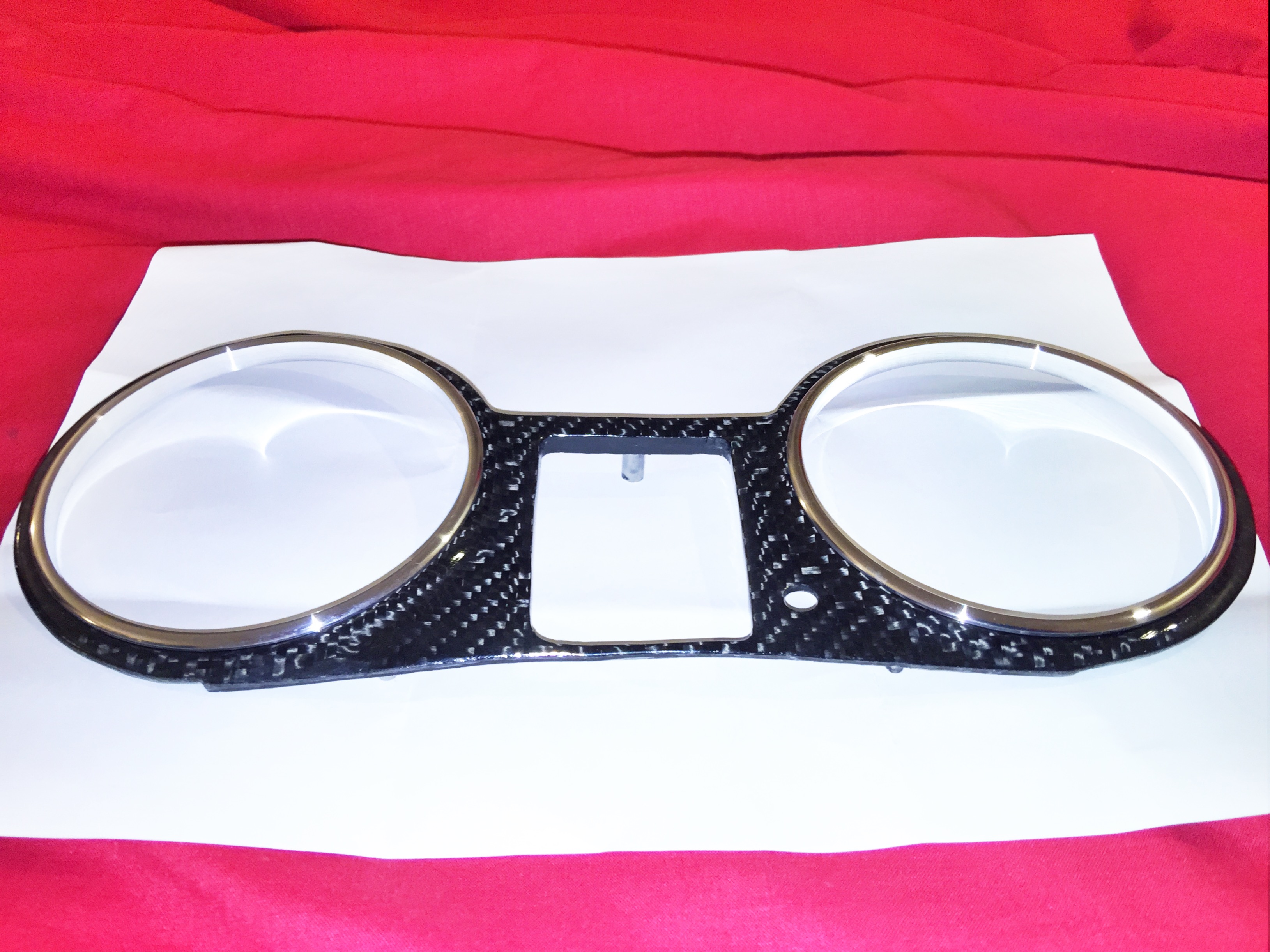

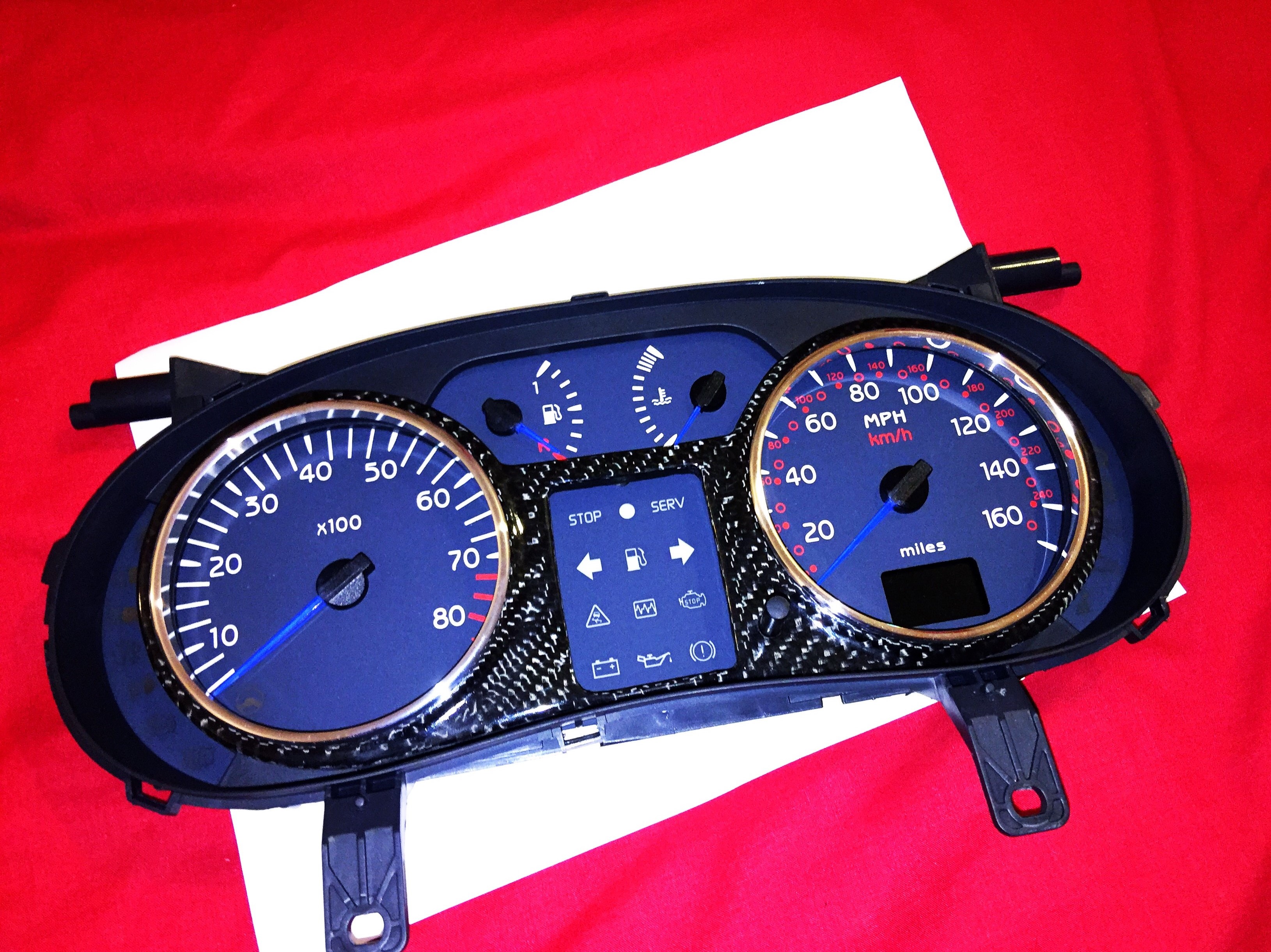

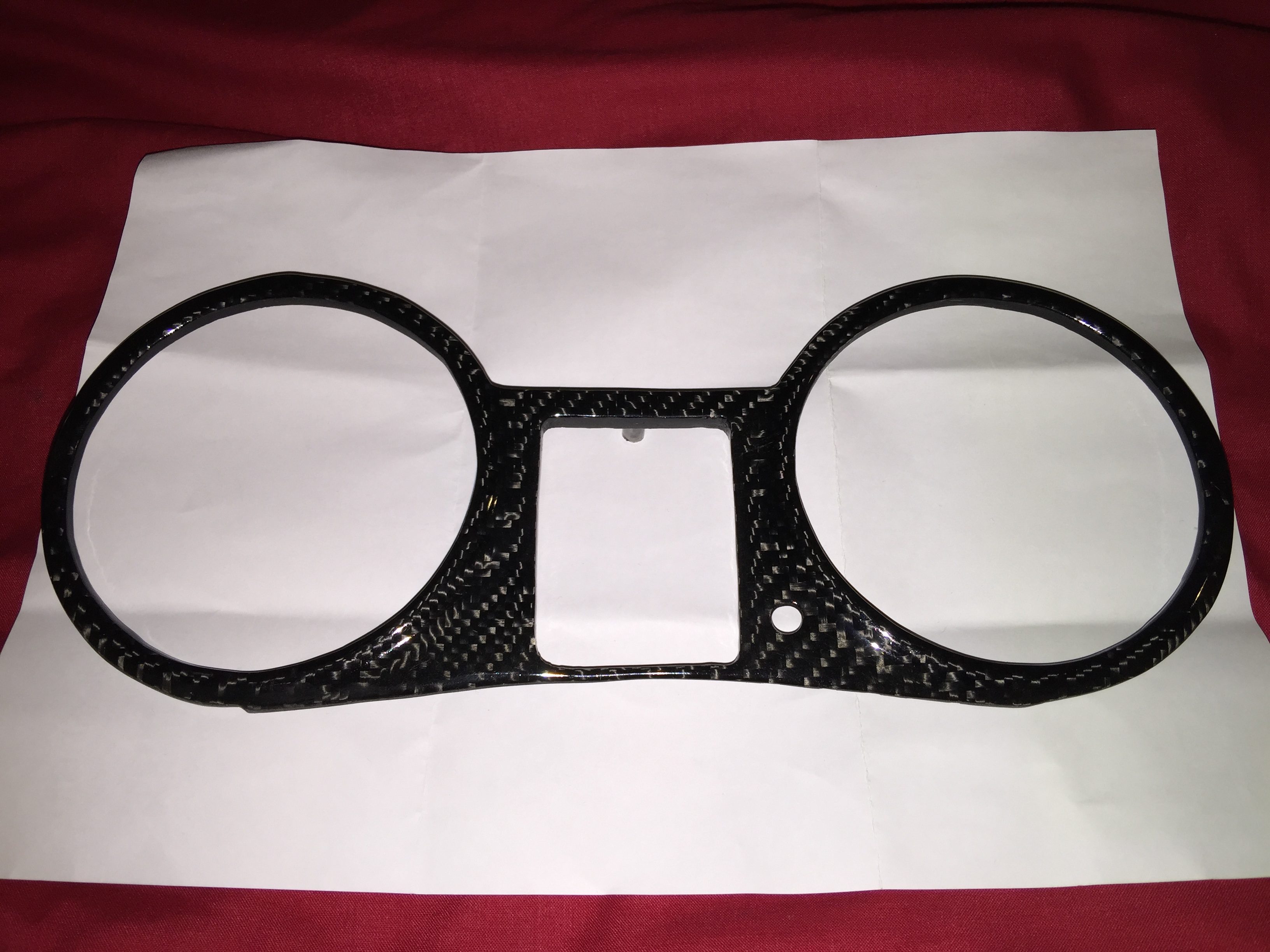

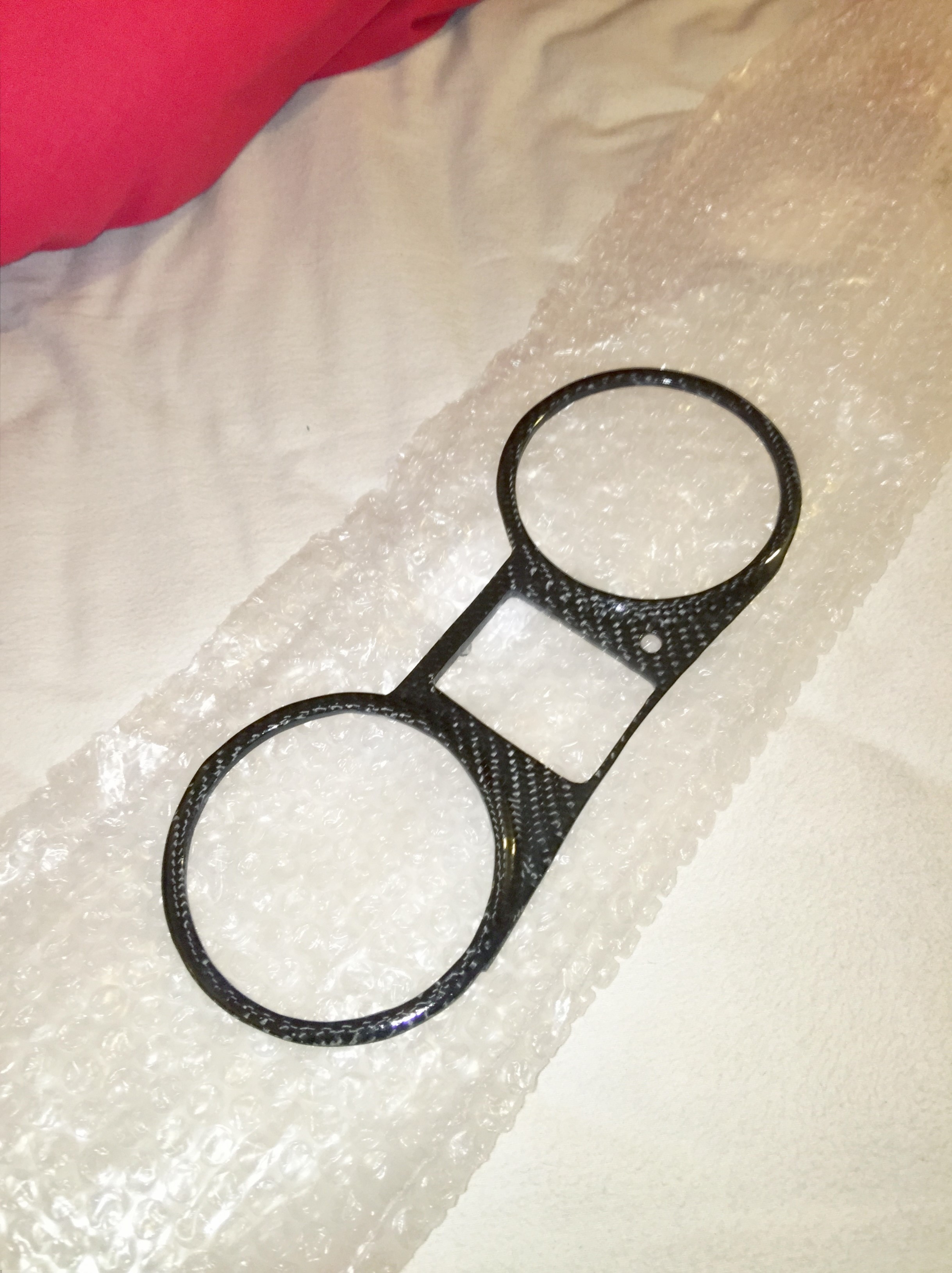

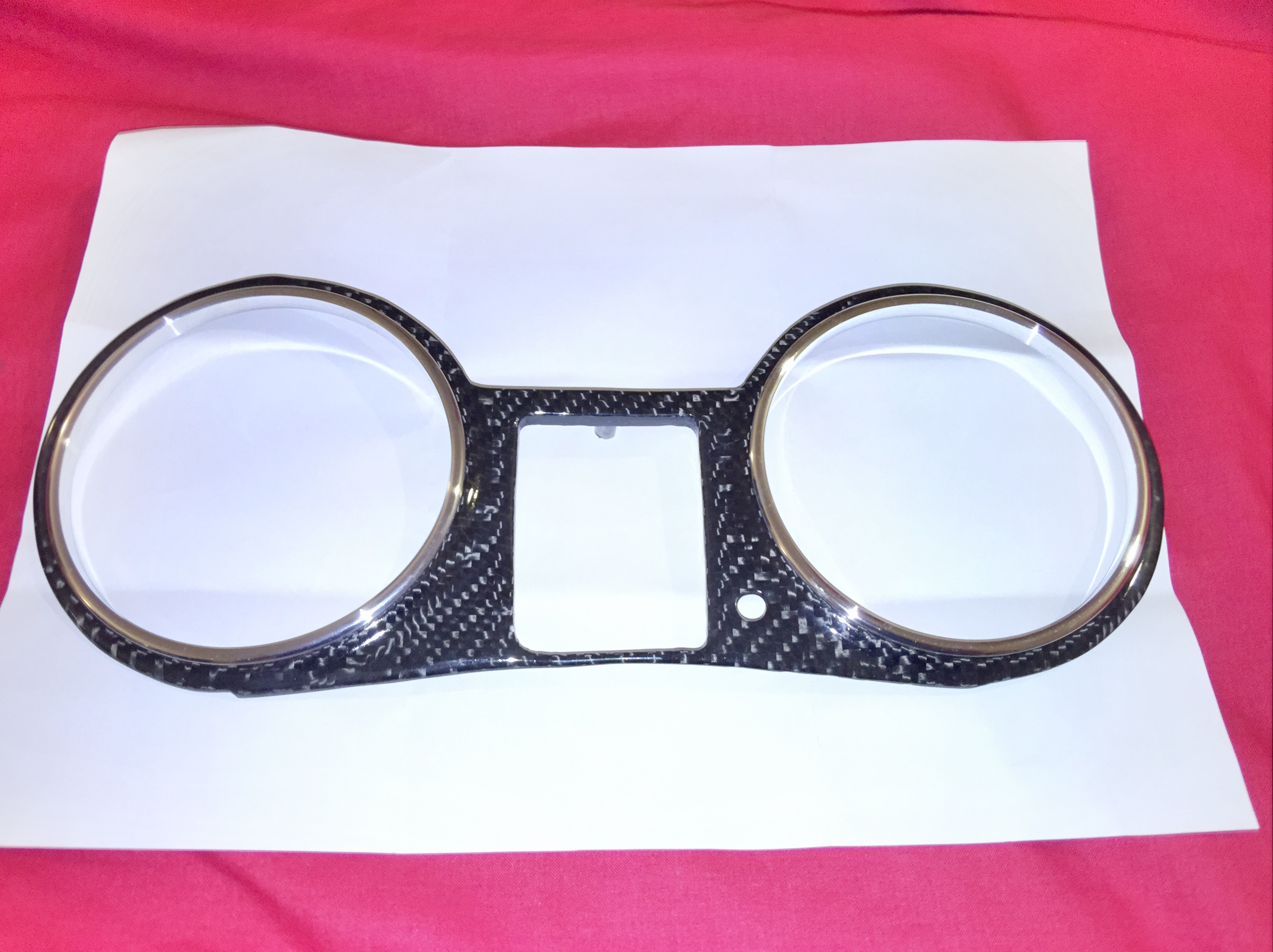

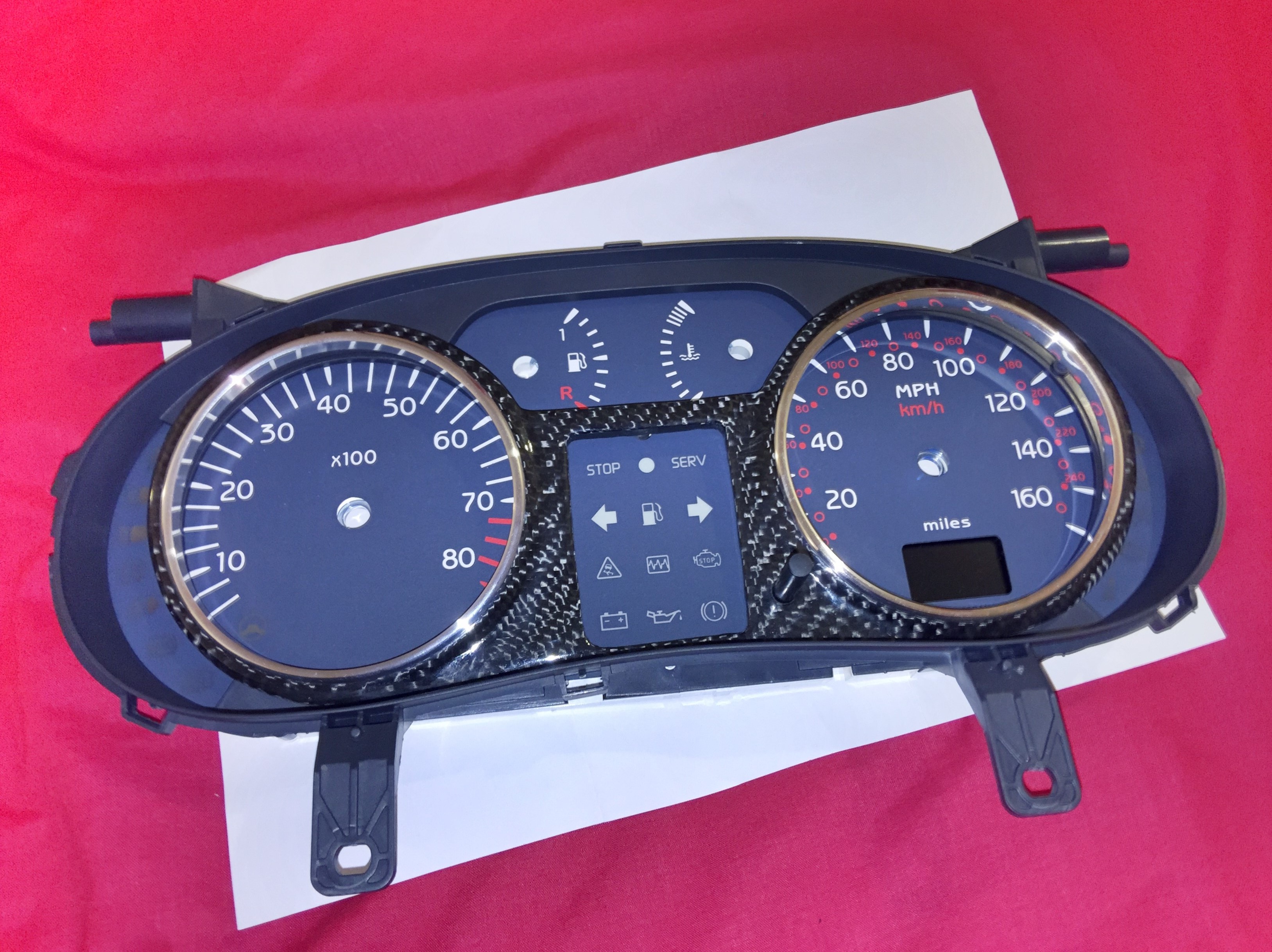

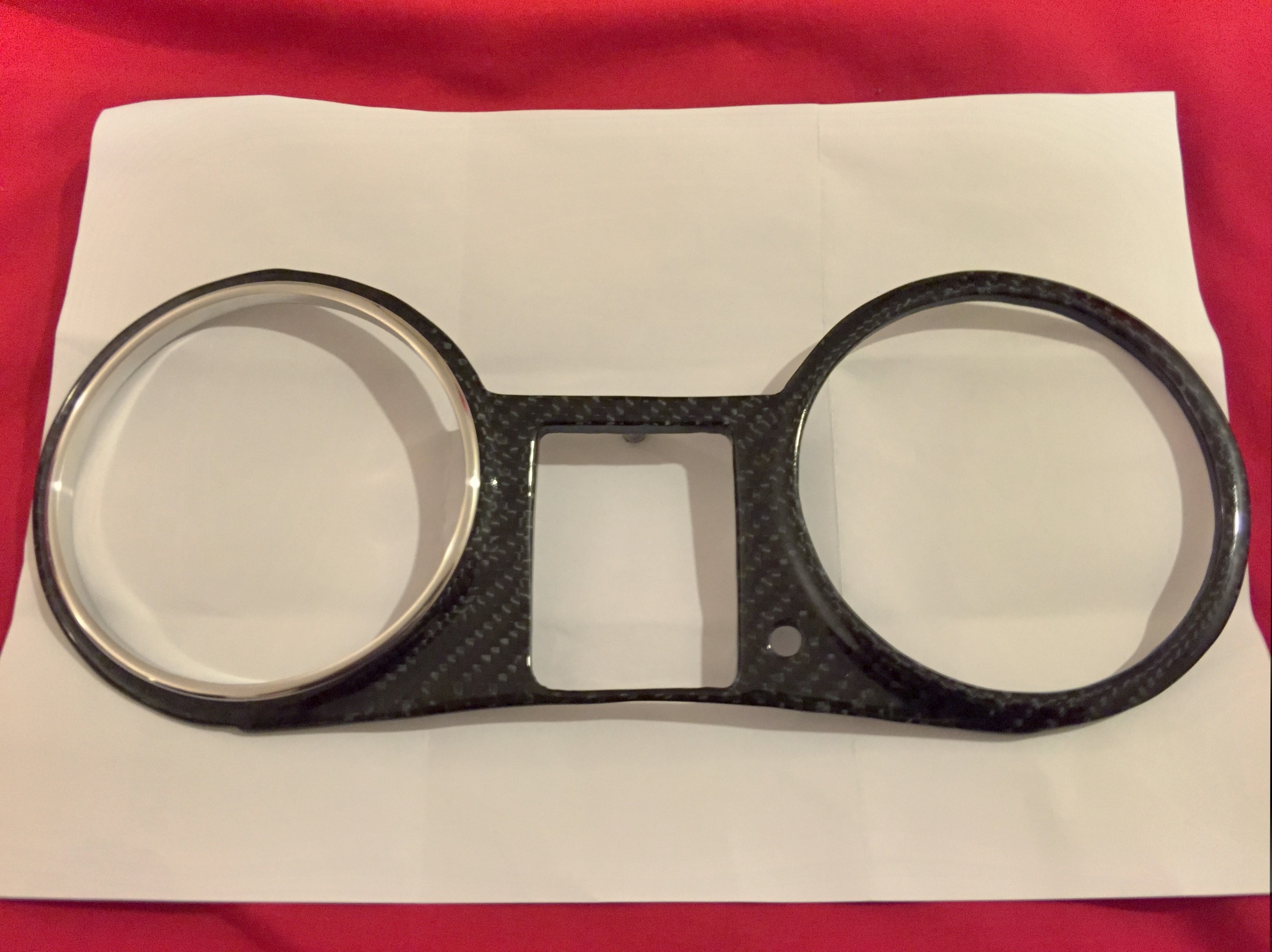

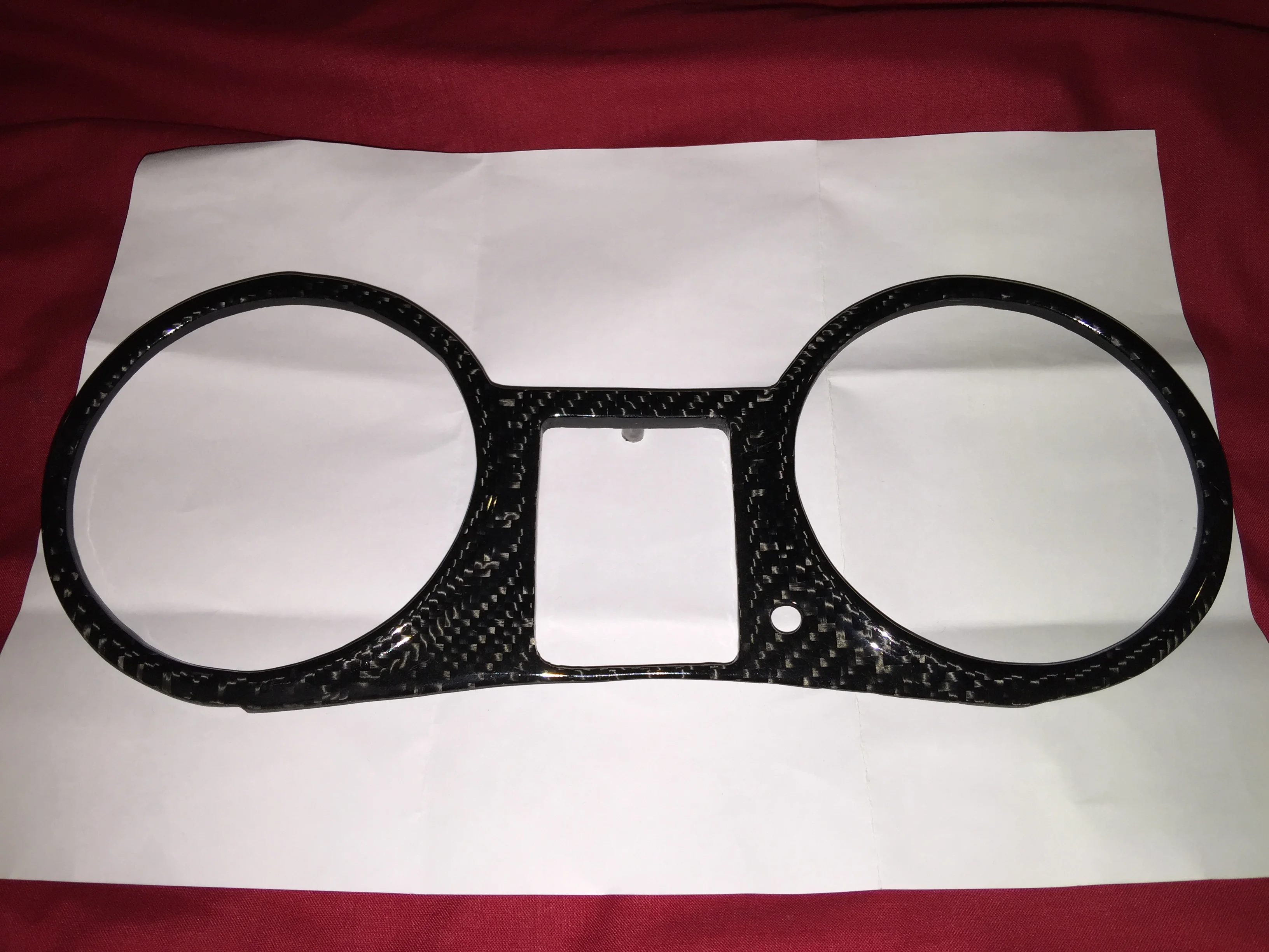

Also had all my orange dash SMD's changed to white and blue along with carbon skinning my dial fascia too, purely just update the dated look a bit, I know its unnecessary bling for what will eventually be a track car, but I want to build a track car that is also a nice place to be on the inside too. Why not eh haha also painted my needles blue and bought some aluminium dial rings just to accent the carbon, next on the list will be a lockwood dial kit as the original one looks a bit lame next to all the new bits.

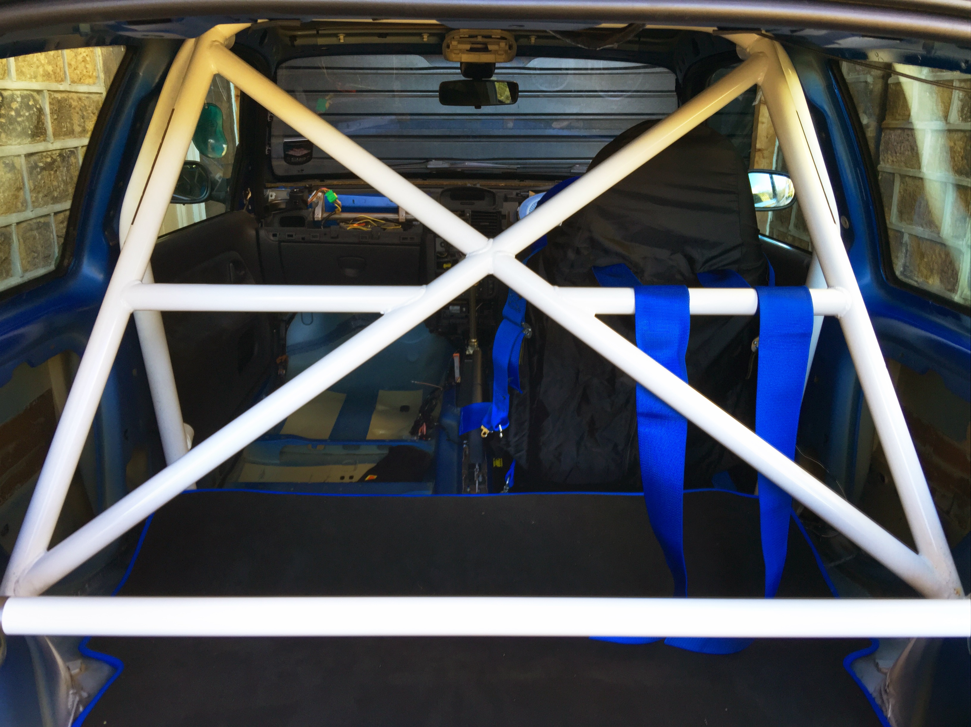

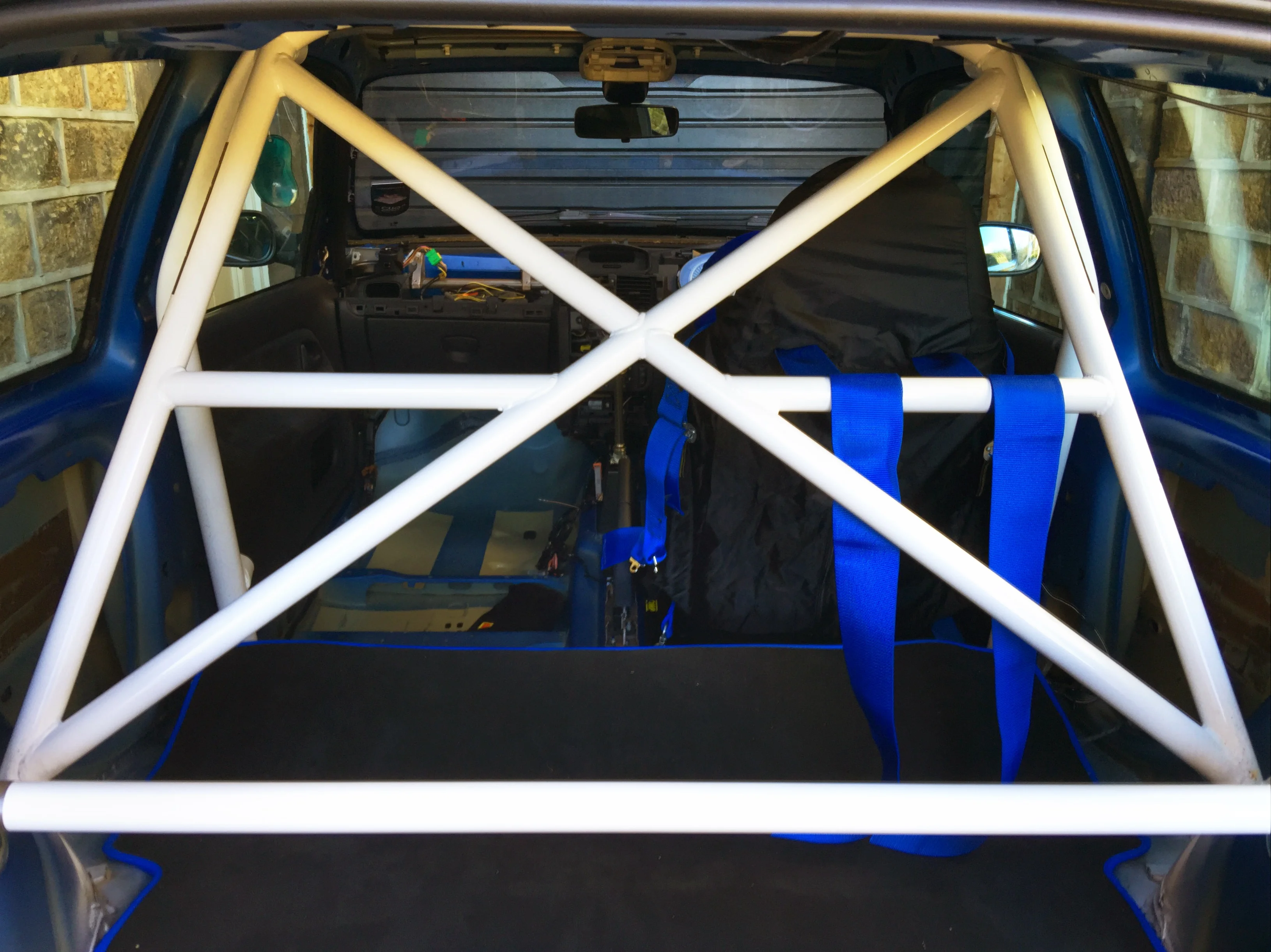

Painted my rear brace, did have plans to weld this into my cage but but changed my mind. Also courtesy of my misses I have a new roll cage companion haha! Flat Eric FTW!! Bloody miss those adverts pahahaha
