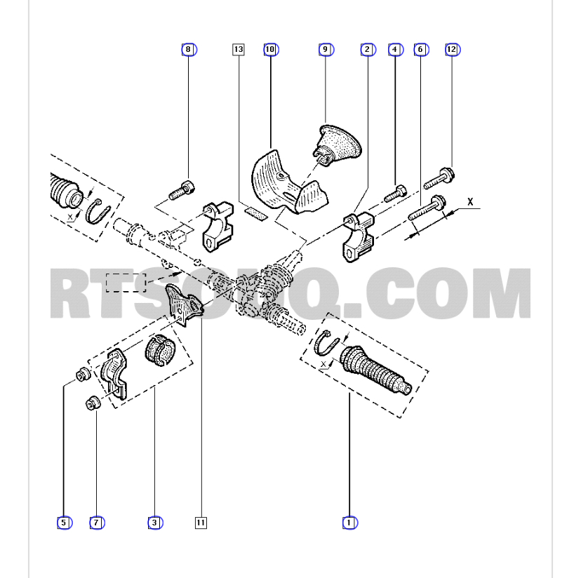

Converting the Clio to EPAS including a DCI rack. Whilst I sent the subframe away for powdercoating etc. I seem to have misplaced the bolts that attach or attached the original rack to the subframe.
I notice the DCI/EPAS rack has no bushes and bolts direct to the subframe.
Anyone know what bolts I should use? I'm guessing M10 10.9 tensile?
Thanks,
Feel like @Mr Underhill probably knows. ha.
Mr Underhill

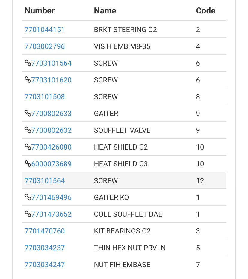

From memory they were different lengths so rather than me c**k it up, here’s the diagram with part numbers to help you.
I remember having to retap a thread in one of the brackets as it was cross threaded and that bolt was M8 x 75 mm x 1.25. But as I said, they’re slightly different lengths.
