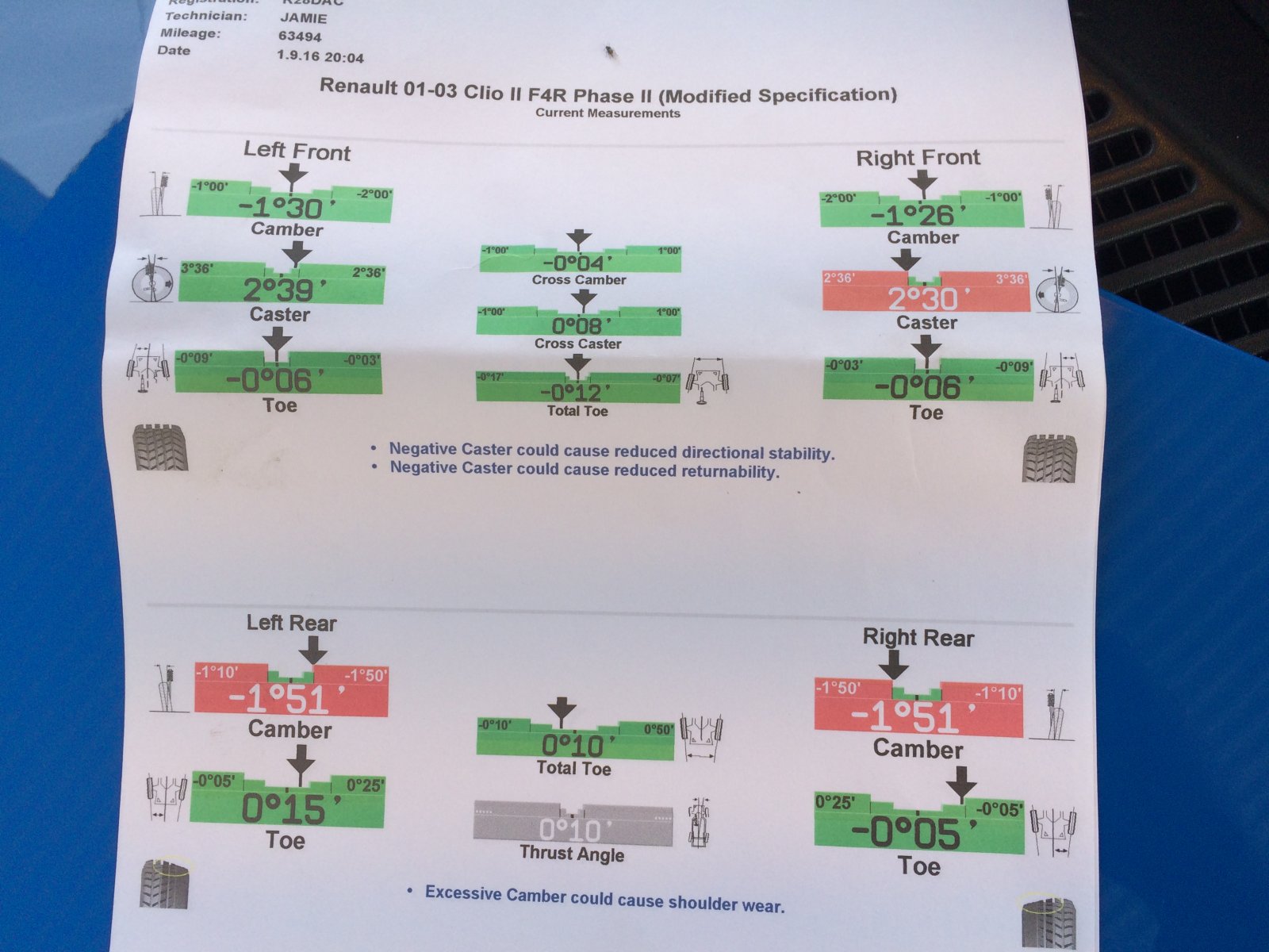

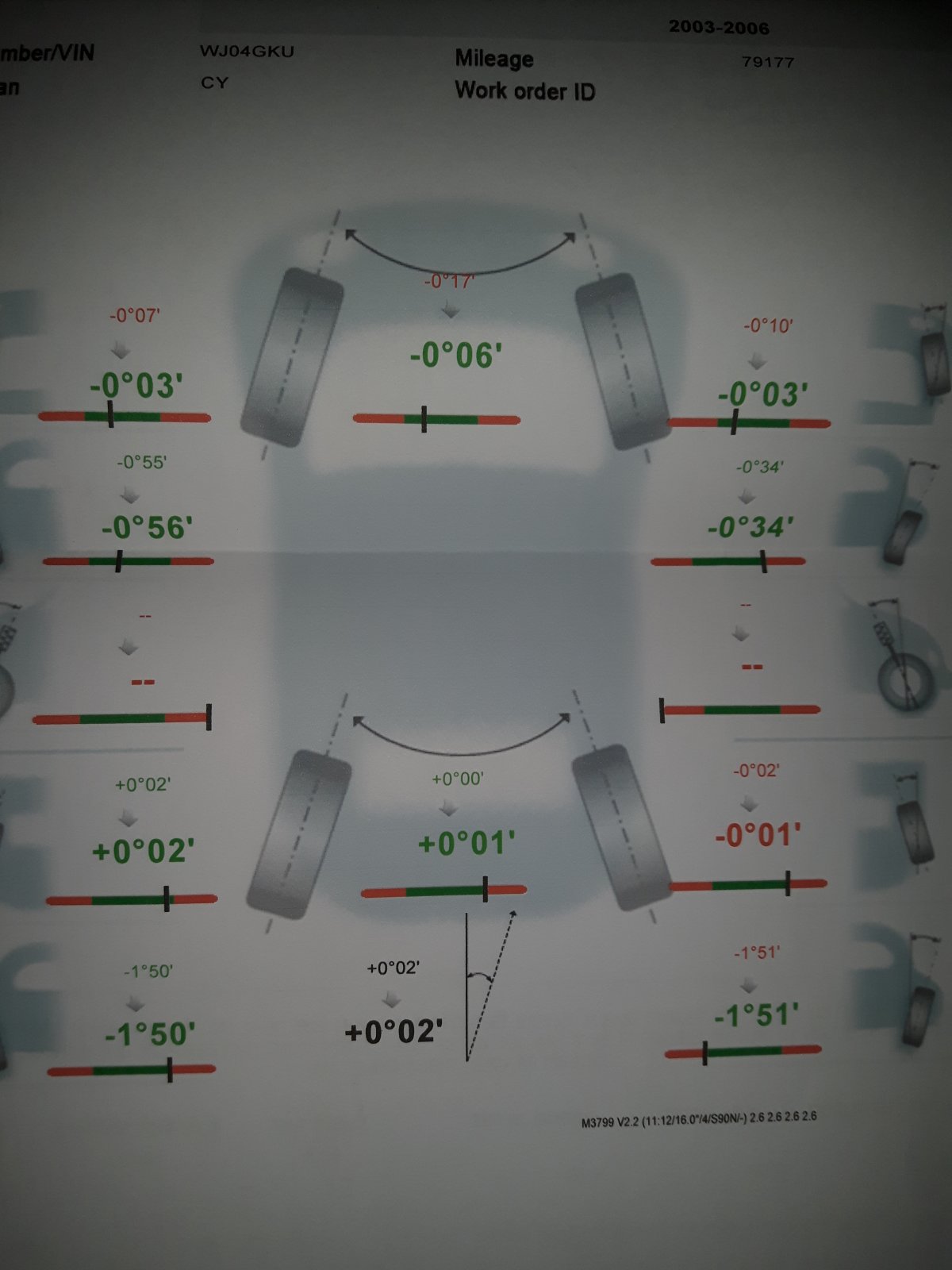

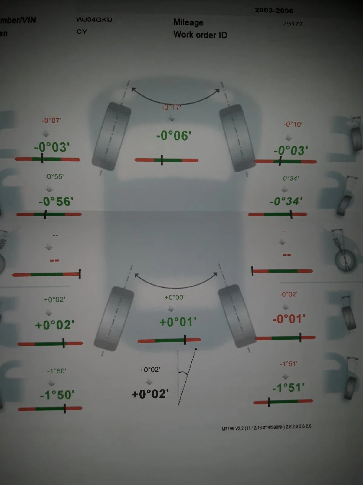

Yeah my 182. Did my photo of my alignment work? Can't see it on my phone.
All that info is lost on me tbh. As is some of the alignment printout, it doesn't suggest what was before/after or ideal readings

Cup packed wheels arnt et35. You have the standard clio wheels? And the photo works
When ever I've had my tracking done they have allways had matching tyres mate

And the settings look fine
Strangely, that spec sheet is stating toe out for fronts, which is confusing me, as I`m sure mine has always been set with -12 minutes toe in.
I`ll check with them tomorrow.
Sorry, just noticed spec sheet won`t open.

Are my settings ok then? Can it really be just my cheapo rear tyres?
Factory settings 182/182cup/Trophy Toe-out 12' +or- 5'
182 wheels in all variants are ET45
Also the print out should say Clio ll Phase 3 the operator has selected the phase 2 172 settings.
