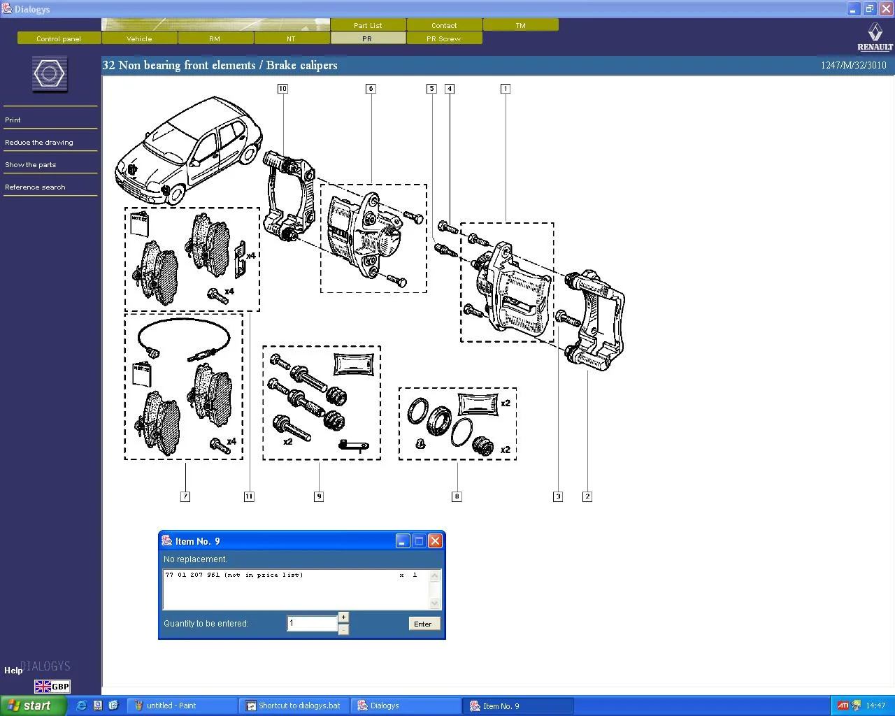

Am trying to order a brake guide pin set for my car and have stumbled across a problem. Using the version of dialogys i've got i've pulled up the part no 77 01 207 961 for the kit, rang the stealers and they're priced at £17 but apparently there for a twingo???. They've given me another part no and a price of £32 for the kit.
Obviously i'm not going to order the £32 ones when there the same as the £17 ones, i've attached a picture of the dialogys screen as i've definetly entered all the details correctly afiak.
Does anyone know if the twingo uses the same lucas calipers as the Mk2 16v Clios ? Or can confirm the part no ?

If parts were interchangable then that would sell at the same price.
There are different sized sliders just pay up Renault prices or go a Halfords etc and get some copy cat parts.

Just found it strange that even though its an older version of dialogys both parts are still avaliable and why should it come up for the Clio if its the wrong part ?
