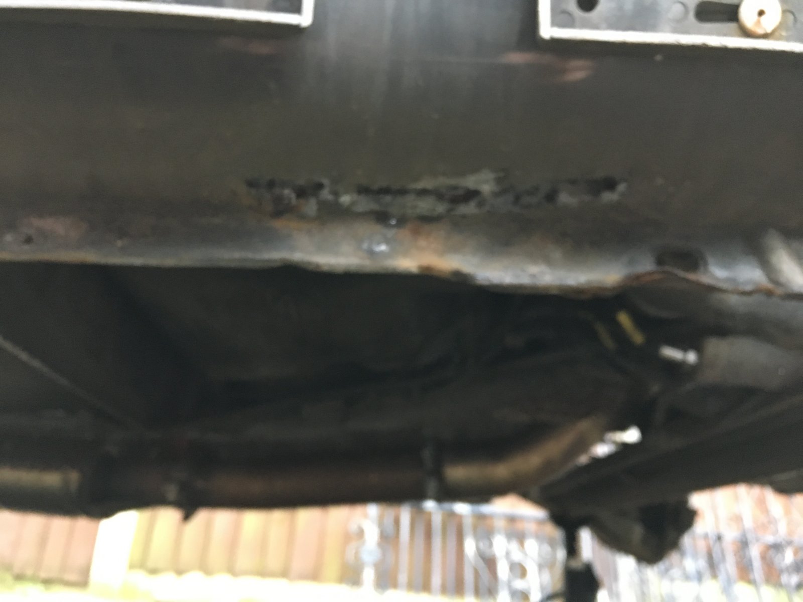

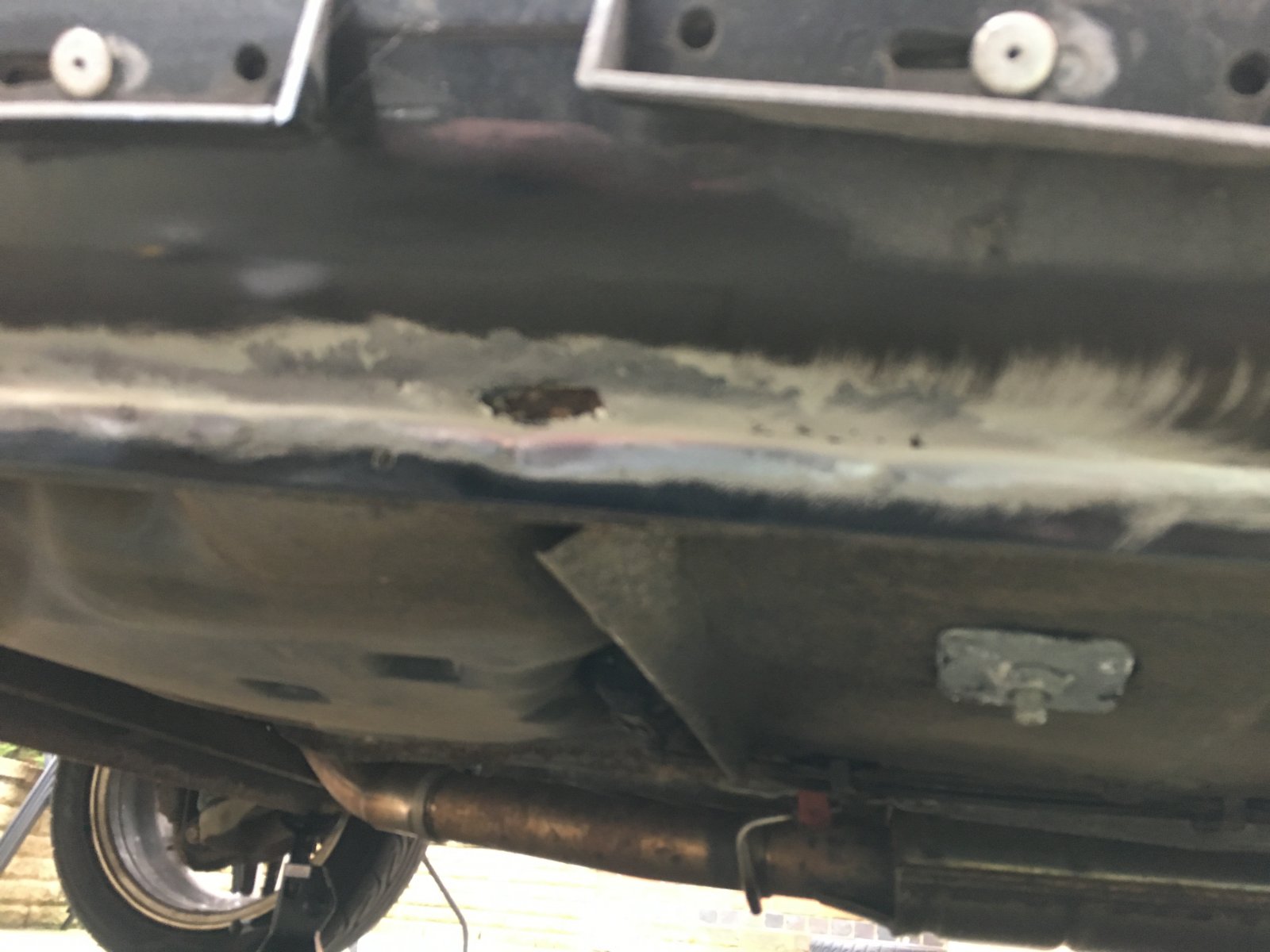

Pics below. These have been plated but the sill will need doing, about half on each side along with the rear arch/sill/inner quarter junction.

Repair for me, the cill panels aren't expensive. Plus a lot of shells will have the same issue so once you have repaired you know its solid

Just get it fixed, nip it in the bud before it set's in. They are under the skirts anyway so whatever body shop you get to do it can just blow it in now problem. I would be surprised if it cost you more than £3-400.

doesn't look too bad tbh chap, repair i'd say. can you poke a hole in any of the problem areas with a screwdriver? if not and its still solid enough it'll be fine for a year or so i'd say.
I could do, used a crowbar and didnt take much effort.

where are you located? Seeing as its hidden behind the sideslirts I wouldn't worry too much about it. Just get a mobile welder to do the welding then paint them up.
that's what I would do personally
Coops Mk1
  Lots of Scrap...
mmmm, maybe its worse than pics show then! either way still reckon patch it up, gonna be easier than a full reshell
