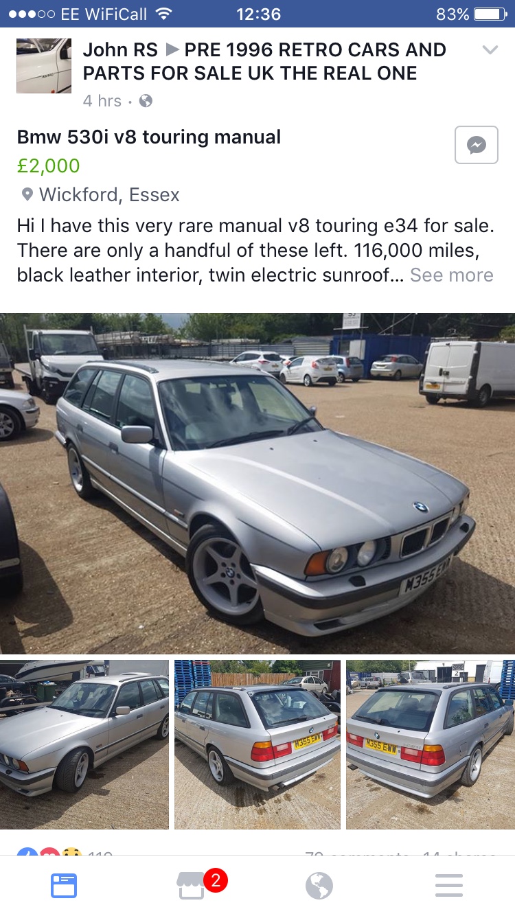

Daniel
  Whichever has fuel
@Jaff.
Jaff.
I was going to say it seems a waste to rip that apart Daniel.
I suppose I'm asking a lot to find one that's riddled with rust with a good engine and a manual gearbox lol
