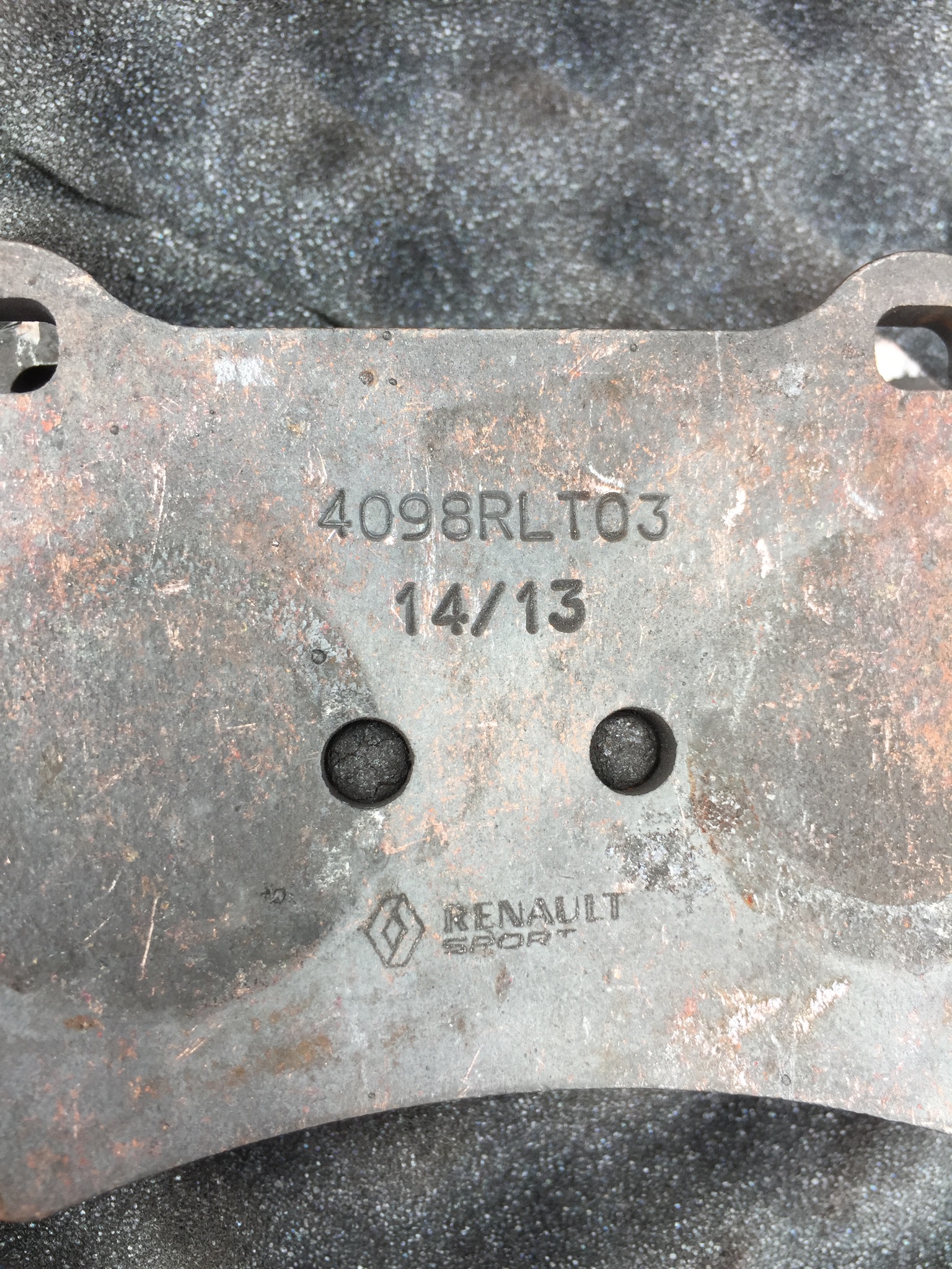

What coolant do they run is it just the same as the 200 cup or is it something different ?
Also where can I get these pads from ?
Or are there any other pads to consider for the front ?

It's the type d stuff for the coolant mate and the pads are cup racer specific. Or in other terms, ds1.11's!

O right didn't realise they were similar pads. The pads and discs are the same as a 200 cup road car with regards to sizes and stuff I know they are different compounds but sizing I would assume are the same ?

Yeah braking wise they are identical. Ds1.11's up front and ds2500's at the rear. I'll be running that on mine.

The rears at the minute are ds2500 and the pads pictured are on the front
I will get the fronts ordered next week :)
