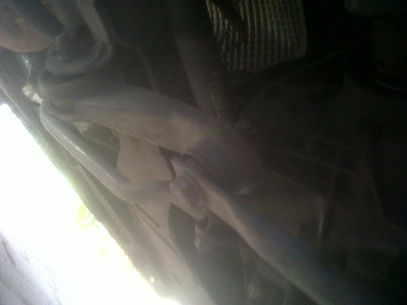

Got a few bits to get done to keep the car tip tip, and to top it off got a screw in a tyre, not happy, anywho... im just double checking everything like i usually do, dont like to be stuck under the car wishing id asked before
Dont laugh :eek: dog bone at the back correct? just checking ;)
So again checking it simply unbolts once that bar at the front is taken off?... then new one gets bolted on yeah, nothing needs supporting bar the car...?

All done now, code given by JackJack was current and correct so cheers for that mate, Price has gone up to £25.94
Very easy job, the bar at the front needs to be unbolted slightly furthest towards the engine, then the bolt facing down taken completely out, then the large circle with the mount inside, spanner one end, ratchet to unbolt the other, take out, put in, bolt up.
Can feel a noticeable difference, still feels like somethings a bit lose,
