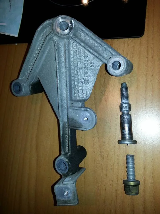

Well i found the reason today.

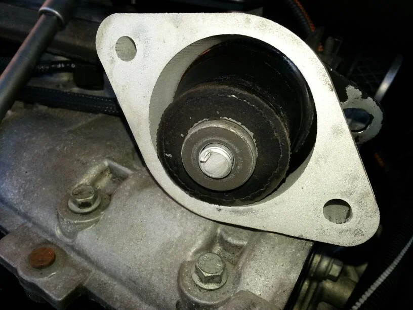

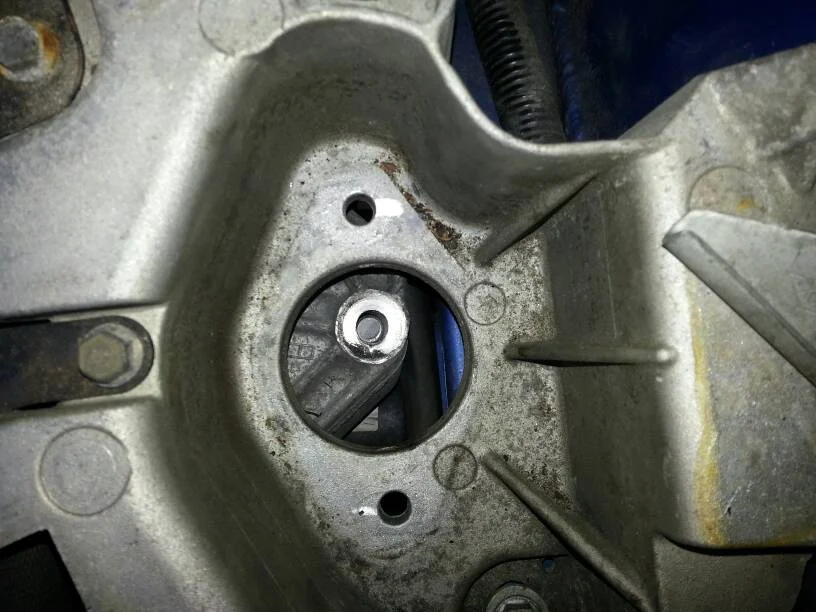

The bolt coming up from the gearbox has snapped quite a deep way into the box.
Any idea on how to remove that bolt?
Is it a renault part, or just a piece if threaded rod?

Personally, thats a new mount needed I'm afraid.

Depends what kind of tools you have at home, them mounts can be had for pennies anyway but.....
Centre dab the bolt, drill a hole carefully in the centre, soak in wd40 for a while if the piece is tight and then use an easy out or an old male torque socket to wind it out. Or nut over the top and weld the broken bolt to the nut.

SUPPORT - GEARBOX - 77 00 434 628 (mount, maybe diff depending on your part GB version) RRP ~28.40 GBP
PIN ENG SUSP PAD - 82 00 689 102 (pin, maybe diff depending on your part GB version) RRP ~20.09 GBP

I did the exact same thing, if you look at the mount where the bolts goes through it looks like it is threaded although both I got hold of had knackered threads..
