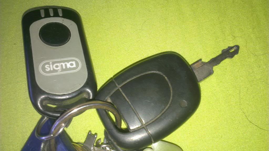

these cars do not come with an alarm as standard. you must have an aftermarket alarm installed.
if the alarm is armed and you use your car key button to open the doors, it will not dis-arm the alarm because the key only activates the cenral locking. so the alarm is still active when you just use your key if you know what i mean! you should have a separate alarm fob button aswell to deactivate the alarm, using the alarm button should open your doors aswaell.
like this............
