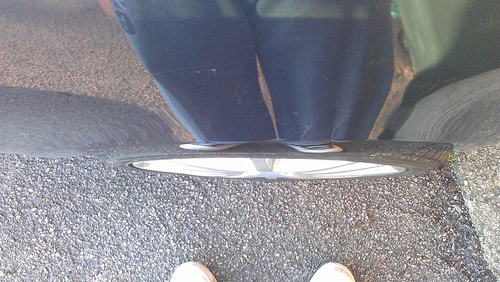

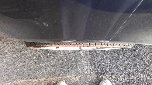

Fitted my coilovers today, and got them aligned. Stupidly, didn't get a printout so going back tomorrow to get one.
However, just noticed my passenger side front wheel sticks out further than the driver's side!?!
Passenger's side:
IMAG0580 by johnpape83, on Flickr
Driver's side:
IMAG0581 by johnpape83, on Flickr

My first question is did you just have wheel alinement or the camber adjusted? The camber looks like it could be your problem.

that camber issues mate. go take it to get hunter allined! they know what they're doing compiared to most ' allinement ' garages
Ah, Well I asked for alignment! So they might not have touched the camber at all then? I know I should've asked for it, but it's clearly out! Surely that should be done as well?!

Have you got spacers fitted or after market wheels?, they look like they are beyond the wheel arch unless it's the angle you've taken the photo at.
Spacers fitted, but it wasn't like that before I fitted the coilovers.

Your camber is way out.
