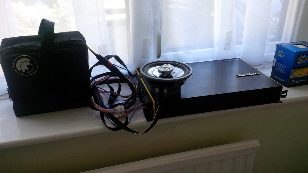

UPDATE.
I decided to do some testing on the amplifier. To do this I took the amp out the car and plugged it into my test gear (see below) with no RCA's connected. Left plugged in for 10 minutes to see if the sound from the previous videos happened. Which it didn't so I know there are no issues with the amplifier. I also did some stress testing by hooking it up to two full range speakers and playing some music. Adjusting the HPF and gain settings to get the correct sound for the speakers. The sound quality from this amplifier is pretty incredible! I've uploaded a video here. (My phone does not pick up bass very well so it sounds a little 'thumpy'. Anyway I've had no feedback / interference through the speakers at all.
Amp Testing Gear by Thomas Brentnall, on Flickr
So I have put it down to the wiring in my car, I know that it's not the RCA or speaker cables as I unplugged all of that and used a single speaker and short piece of wire and still got the same effect. As previously mentioned I have also moved the ground and also tried a different ground cable from chassis to amp so I know this is fine.
Next steps
This has already been previously suggested, but I just wanted to confirm the amplifier was okay first. I will check all of the connections on the charging circuit to ensure no damaged wires. And potentially then do the 'big three' upgrade (however I can't see how the size of the cables will matter at this stage as no music was being played through the system so there is only a tiny current draw)
Cheers for you help!
