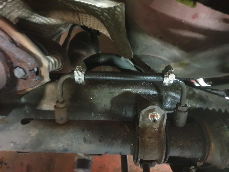

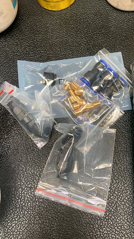

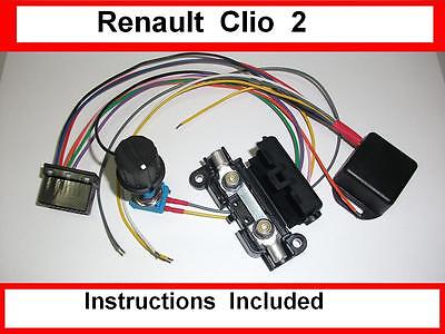

Epas wise you'll need a few bits.
column from a 1.2 or lower spec model with the ecus
this controller from eBay:
you can buy a pipe from eBay for the rack to loop it or you can do like my mate has done on mine seen here:
Untitled by blair mccaffery, on Flickr
you can also buy blanking plugs from eBay or pms for the other bits on the rack. but again mine has grease lumped into the holes and does the job, depends how pikey you want to be.
im sure that's about it there's loads of stuff on here about it if you hit the search.

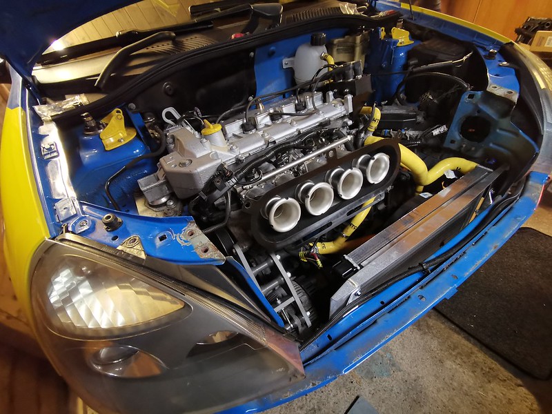

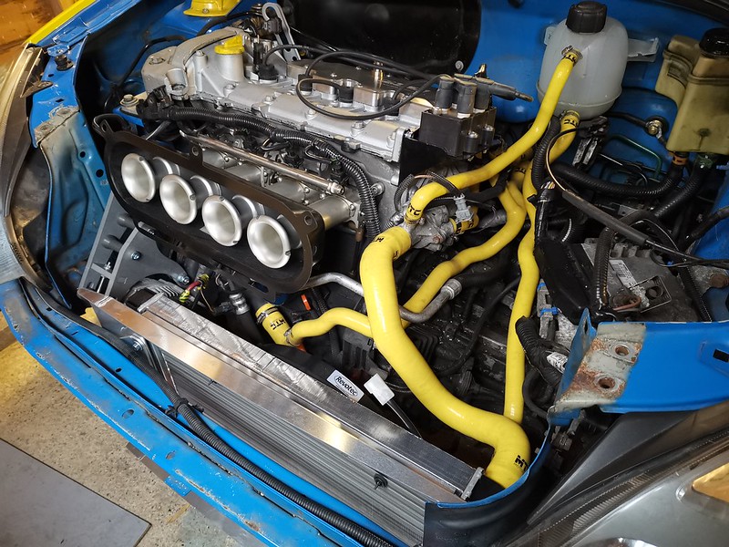

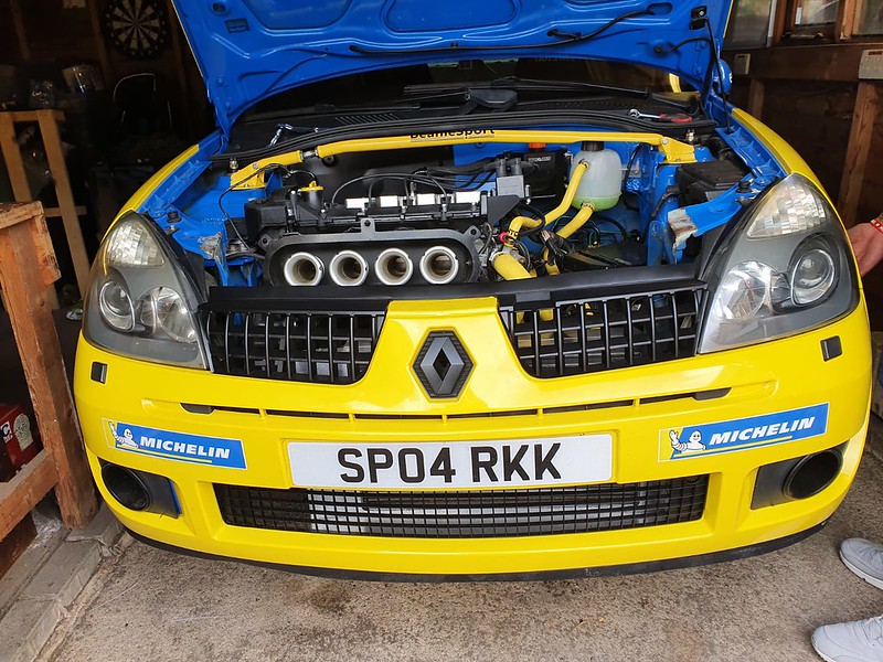

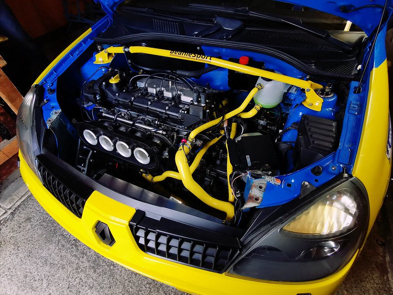

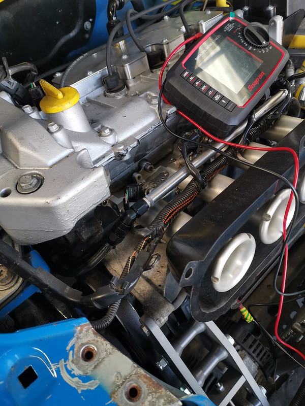

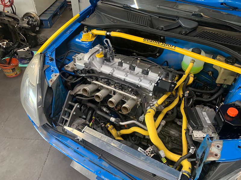

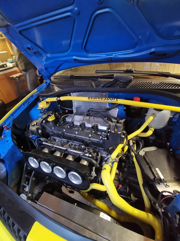

Made some progress on the 182 ITB install today. We managed to finally mount the Bodies in position. The bolts have been nothing short of a huge pain to gain access to, however the end result certainly looks good.
The PMS radiator and Revotec Fan have been fitted, easily the nicest job we manged to get done today. Its starting to look a little bit like a functional car again.
Still plenty to do over the next couple of weeks;

Here's some pictures from today, I've also put a thread up in the 'Engine' Section for advice on the existing connections from the upper manifold. as I'm a little confused as to where these now go?
182 ITB Progress by ANDREW COLLINS, on Flickr

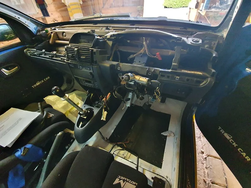

Pictures, although these are awful. Gives you an idea of what state it's in. Also on the look out for new wheels, so if anyone is keen on a swap perhaps?

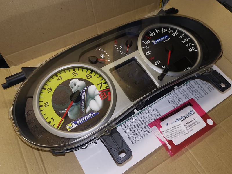

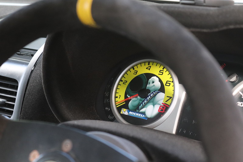

The dials had made are fitted, no picture yet of these installed as it's too dark inside the car currently.

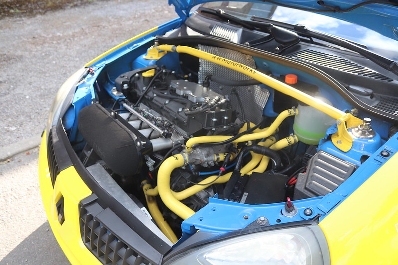

Made some decent progress on this the last couple of weeks, a number of jobs are completed now the car is back on the ground.
The following tasks have been completed;
Epas Conversion
New Alternator
PAS Delete
AeroCatches
Air Con Delete
Oil Catch Tank
New Dials
Gen90 ECU

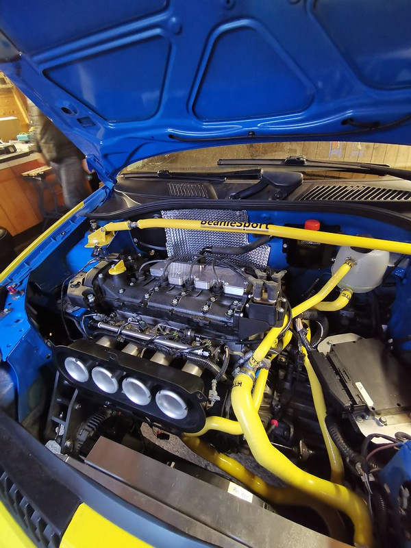

We're got a couple of people coming to help with the initial start to make sure it's running right in early October. Soon as it runs i'll be booking mapping with Chris at EFI. If we're looking maybe a track day before the end of the year!

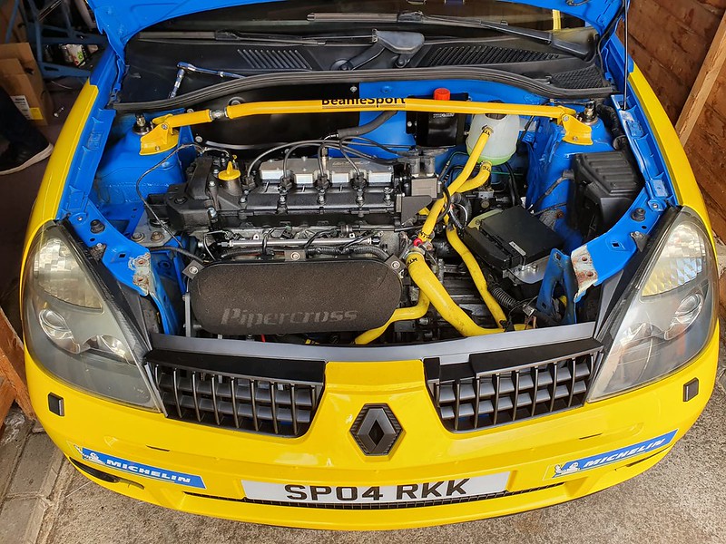

Here's a couple of images for now, excuse the messy wires I'm not cutting anything back until it starts.
ITBs Fitted by ANDREW COLLINS, on Flickr
Bonnet Aerocatches Fitted by ANDREW COLLINS, on Flickr

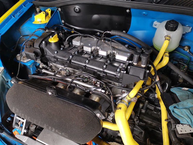

Update Time
It's been a couple of months since I last updated this, not much has changed for quite apparent reasons. However we managed to get it started for the first time. Although it needed a new battery and a lot of encouragement.
We're now fine tuning and balancing the bodies again as it sounds like boat on start up, almost sounds like 3 cylinders. Whilst we await further parts and instructions for a couple of specialists we've carried on tidying up the bay.
We've painted the exposed metal from the removed slam panel in J45 Blue which makes the front end look less like crash damage. Fitted the new Nimbus Heat sheild which was fun! Replaced yet more bolts in and around the bay and we're now labelling up which wires we can start removing from the loom. Ideally we'd like it mapped and driveable by the end of December.
Lastly we've secured some new wheels which are at City Wheels this week. I hope these with the recent engine work will transform the car.
A brief image for now and hopefully some start up videos from this weekend!

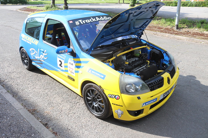

Update - Photoshoot
I spent a couple of days over the BH weekend last week cleaning the 182, it has not been cleaned inside for a very long time. The outside was treated to a full wash & dry, followed by a wax. I wasn't expecting much from the paintwork but I think it came up really well.

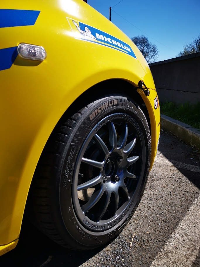

I'm still not convinced on the wheels yet, so if anyone would like the TD 1.2's in Anthracite. I'd be open to any exchanges.
I've taken the car to Bicester Scramble today which was a really great day.
I'm also on the look out for new fog light surrounds as mine are in a bad way. New headlights have been ordered which should freshen up the front.
Anyway, here's some pictures.

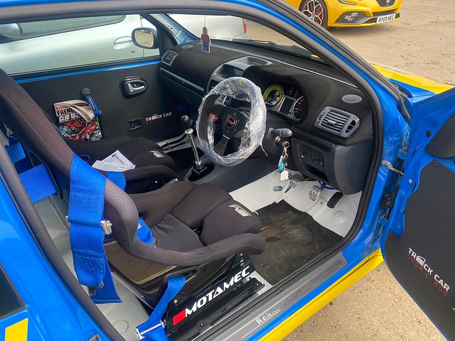

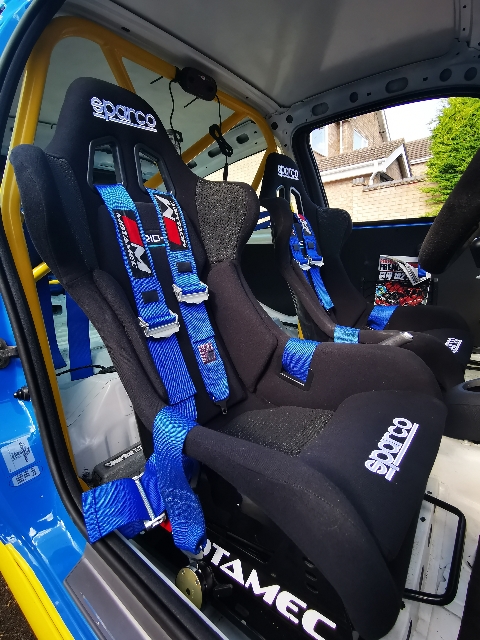

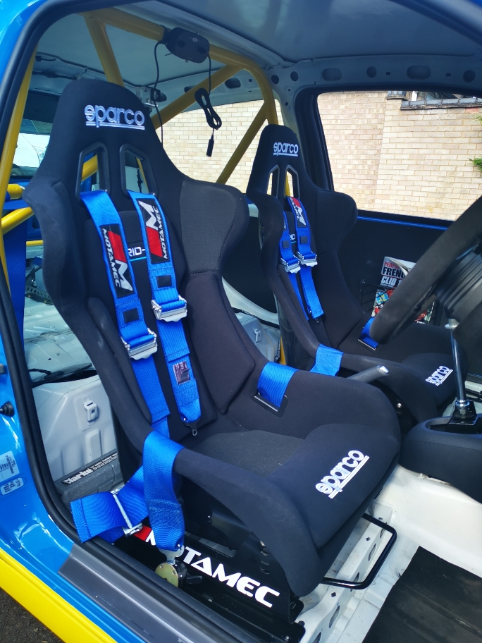

Nice positive update. New seats, it was my birthday on Friday and my partner surprised me with new seats as I was thinking of upgrading them to something a little bigger!

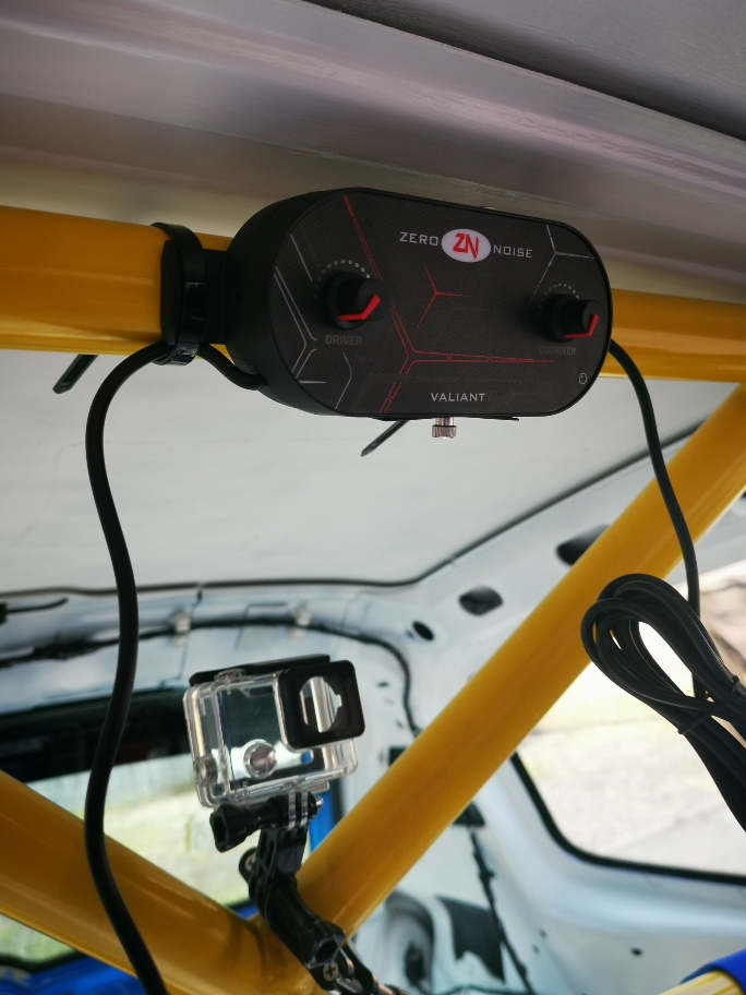

Also fitted a nice 'intercom' unit to the cage, as our helmets have the mic & aux feature. Makes sense to use this now.

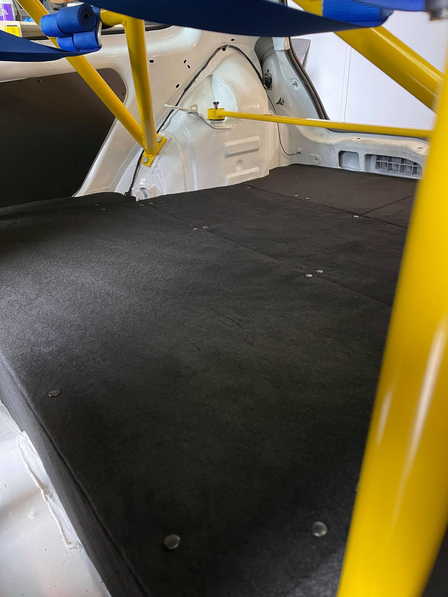

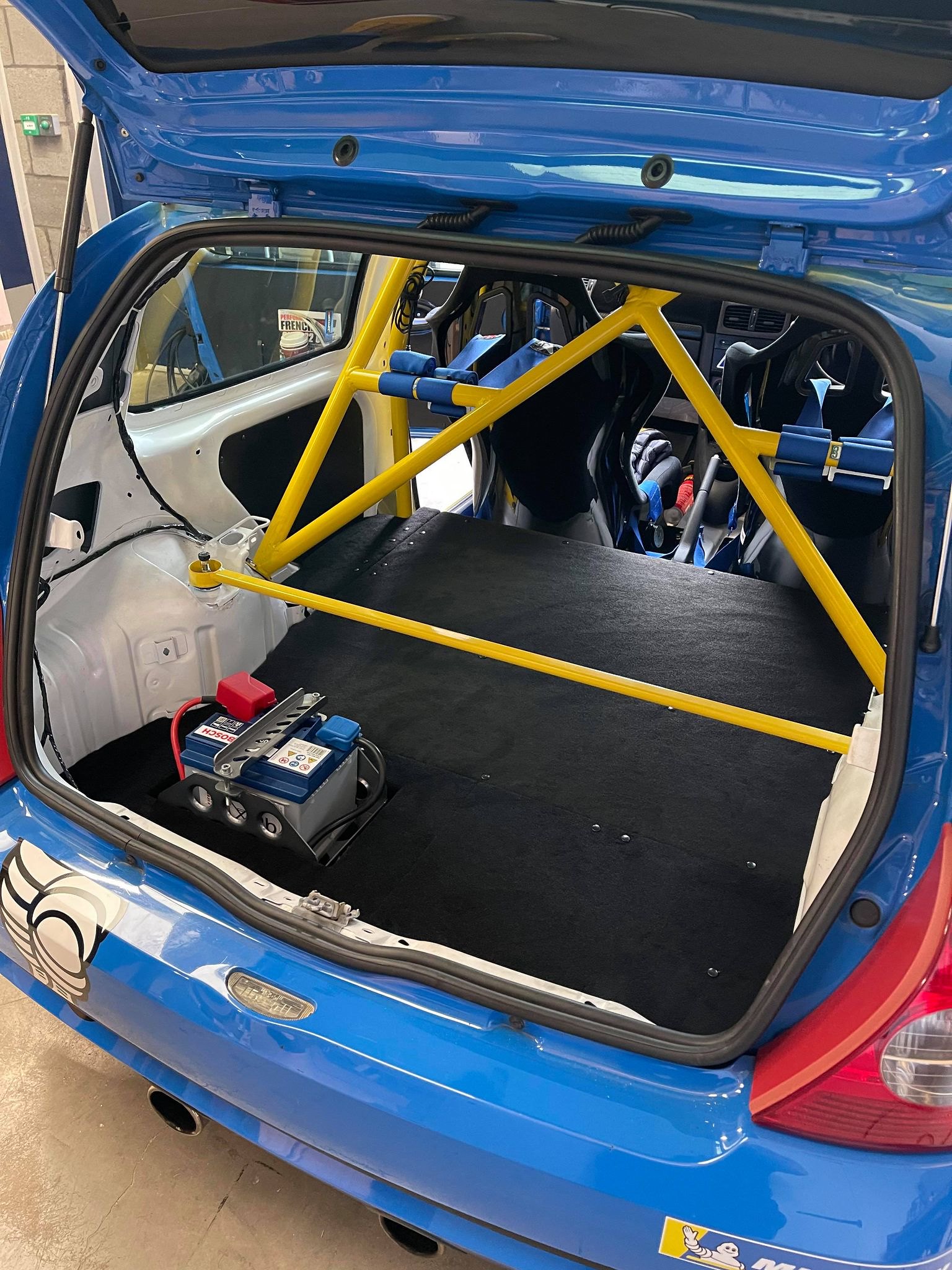

Update - Front End / False Floor

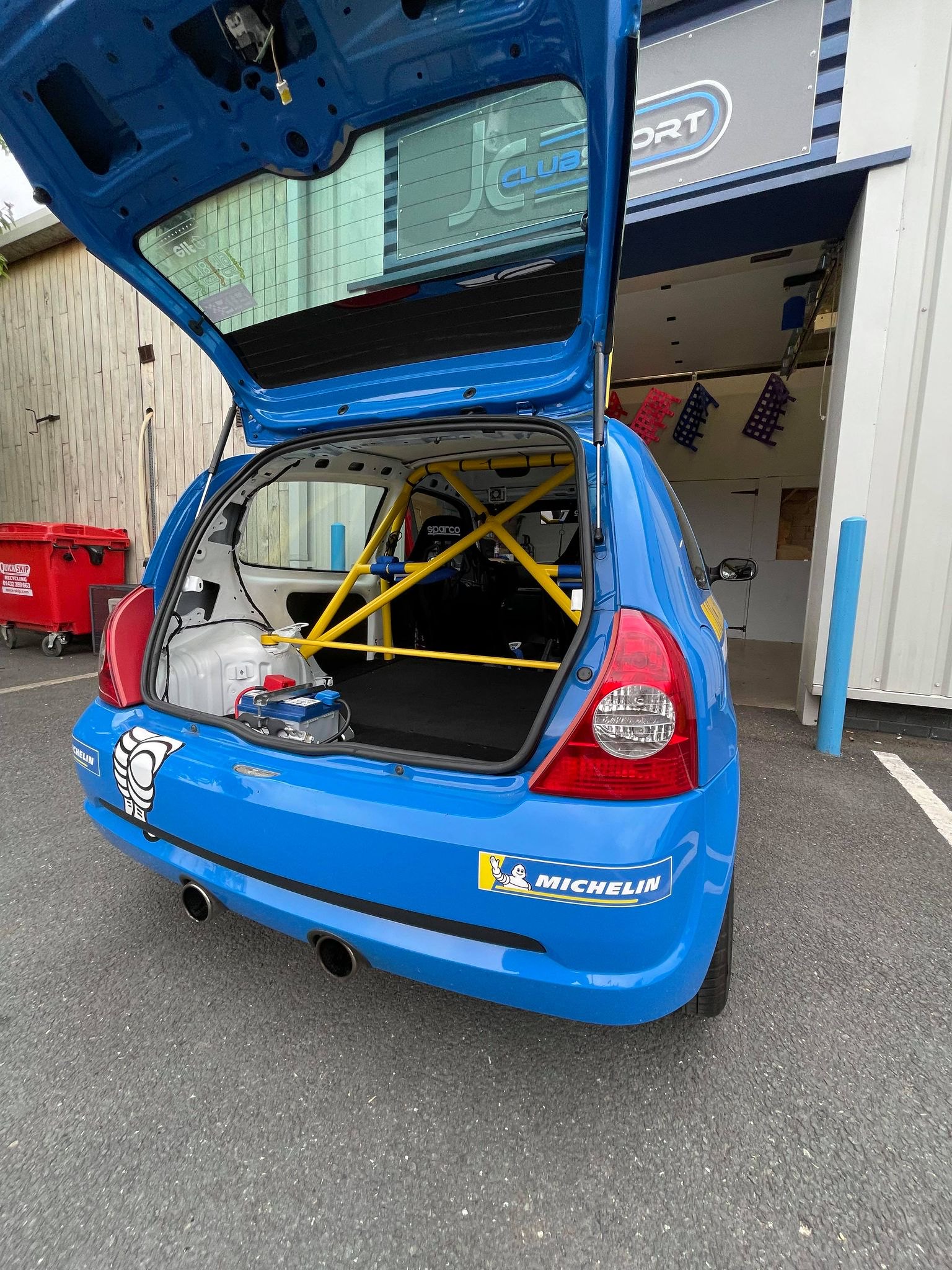

Following on from my update above I came across a company who specialise in building custom false floors for track/clubsport cars. Contact information for them is below;
HOME | JC Clubsport
They did a great job, as the white paint inside had quite badly worn over the last couple of years. The quotes to respray we're silly! So I dropped the car off with JC Clubsport on a Sunday and they did all the work same day. I think it finishes the interior really well. We also managed to fit fibreglass footwells which I didn't manage to capture.
0d1787_2d1f19f8942a4e109059c7309cefc61b_mv2 by ANDREW COLLINS, on Flickr
0d1787_8edf18fa2441403799d7eb01978a048e_mv2 by ANDREW COLLINS, on Flickr
0d1787_7e8557dd2c584c369a26efa73e0de323_mv2 by ANDREW COLLINS, on Flickr
I have one or two finishes touches to add inside but the bulk of the work is now done.

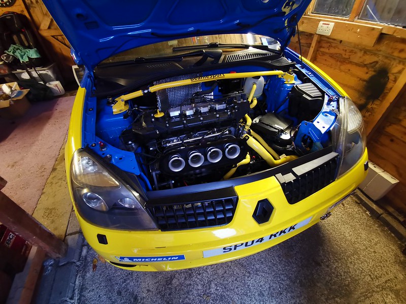

In terms of the front end, I had a new set of Depo Lights, Front Splitter and Fog Surrounds. Yesterday all of the above was fitted and I think the front now looks a lot cleaner and fresher.
Front End Refresh by ANDREW COLLINS, on Flickr
