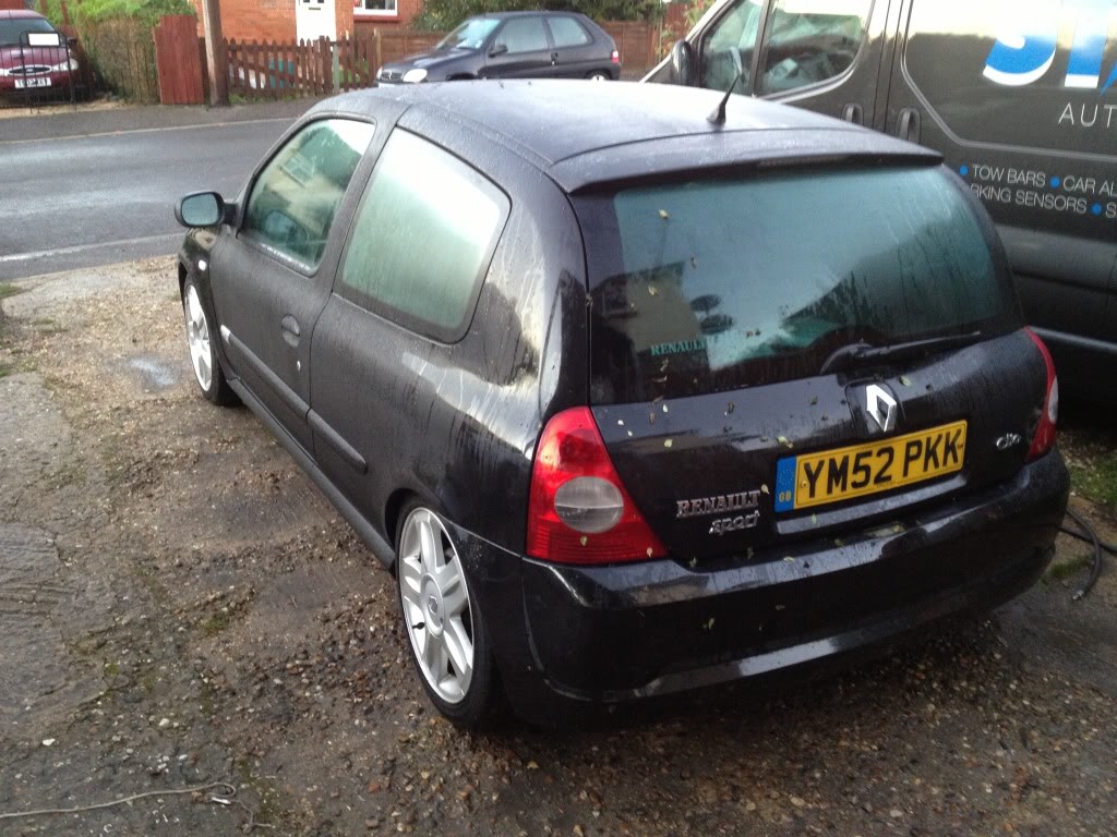

Searching ebay randomly Thursday night, Happend across this and clicked buy it now within 10mins of finding it :D
Picked it up yesterday, Needs a few bits (which I already knew!), Dephaser rattle, leaky rad, covered in dents from hailstones and finally the brakes are shocking where its been sat for two months with no MOT. Also needs a bloody good clean inside and out, but for £500, I love it.
Get it to mine later (curently at my brothers).
Plan is to fix it up, and most likely sell it on, Might have a buyer for it already too!

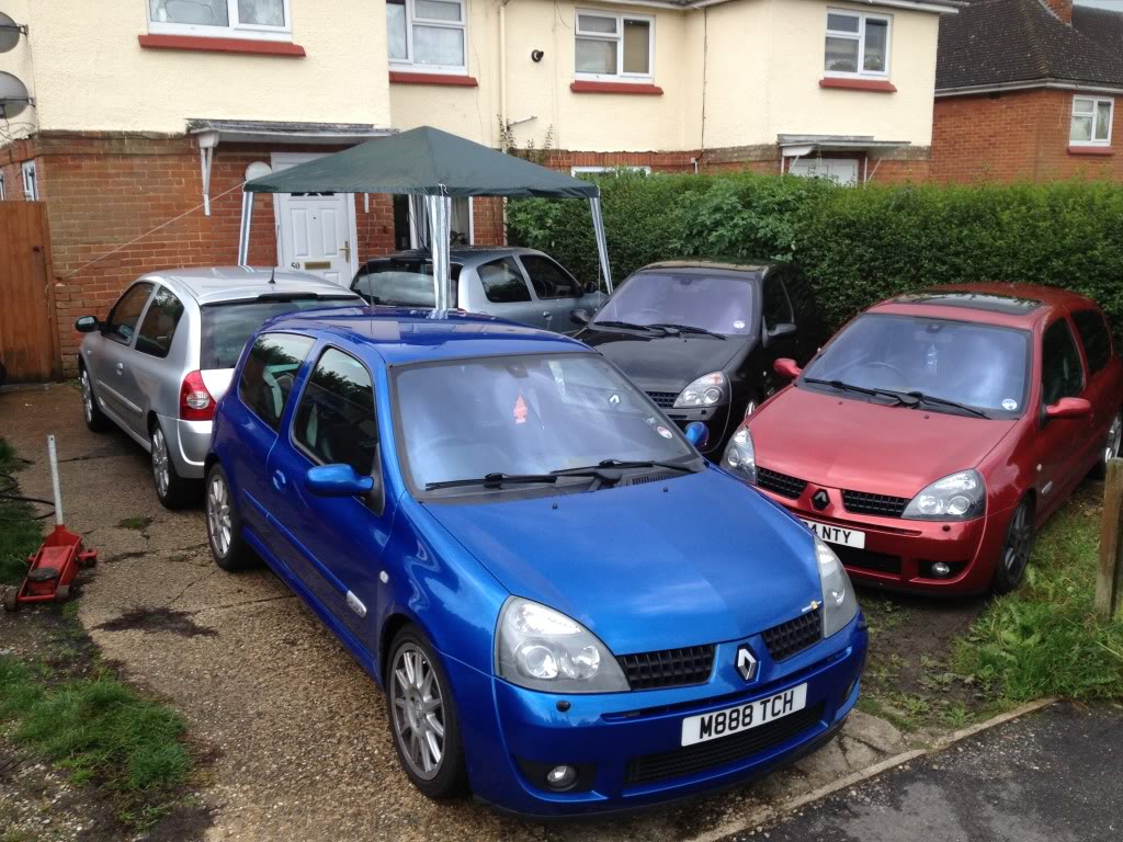

This will be the third Clio on my drive atm, and the second 172.
Hopefully more later!

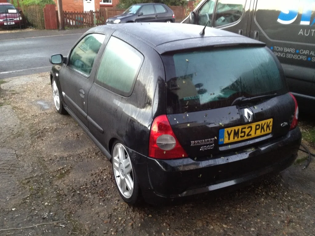

Today was a bit oif a clio day...

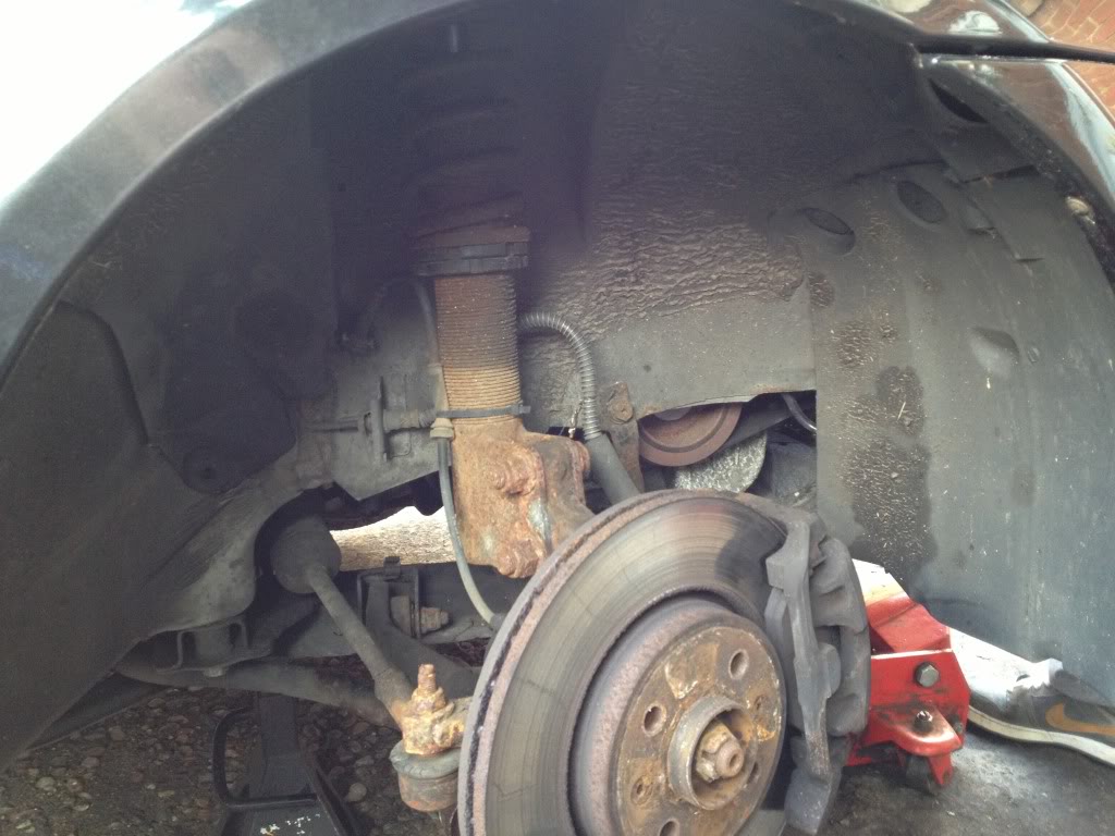

Gaz Coilovers! In need of a refurb!

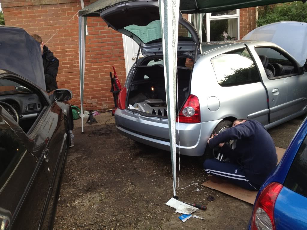

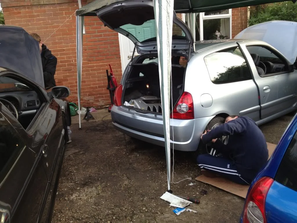

b**ches at work (See ParisPeach's thread for referance when I was working on his car!)

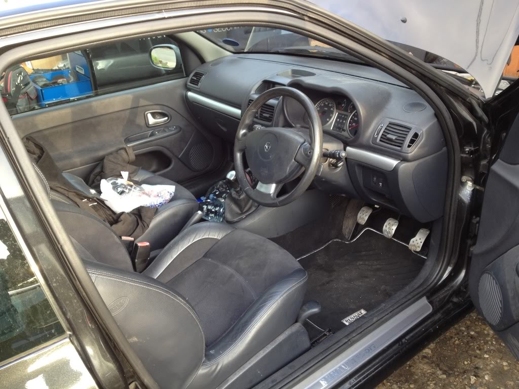

Interior is in need of a bloody good clean, steering wheel has its usual melting and broken thumb grip, but its not bad really.

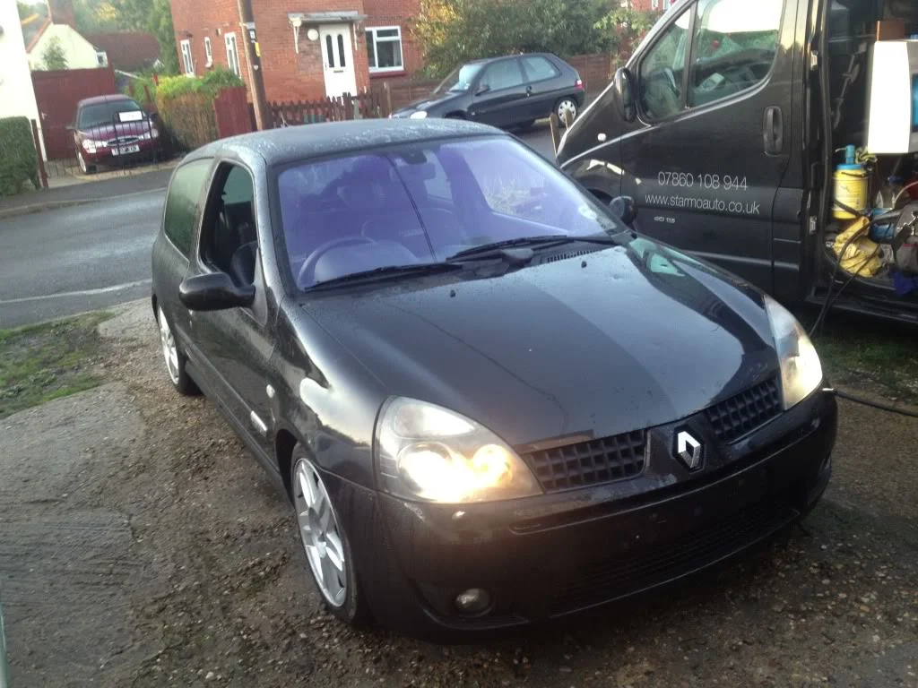

How I got it today.

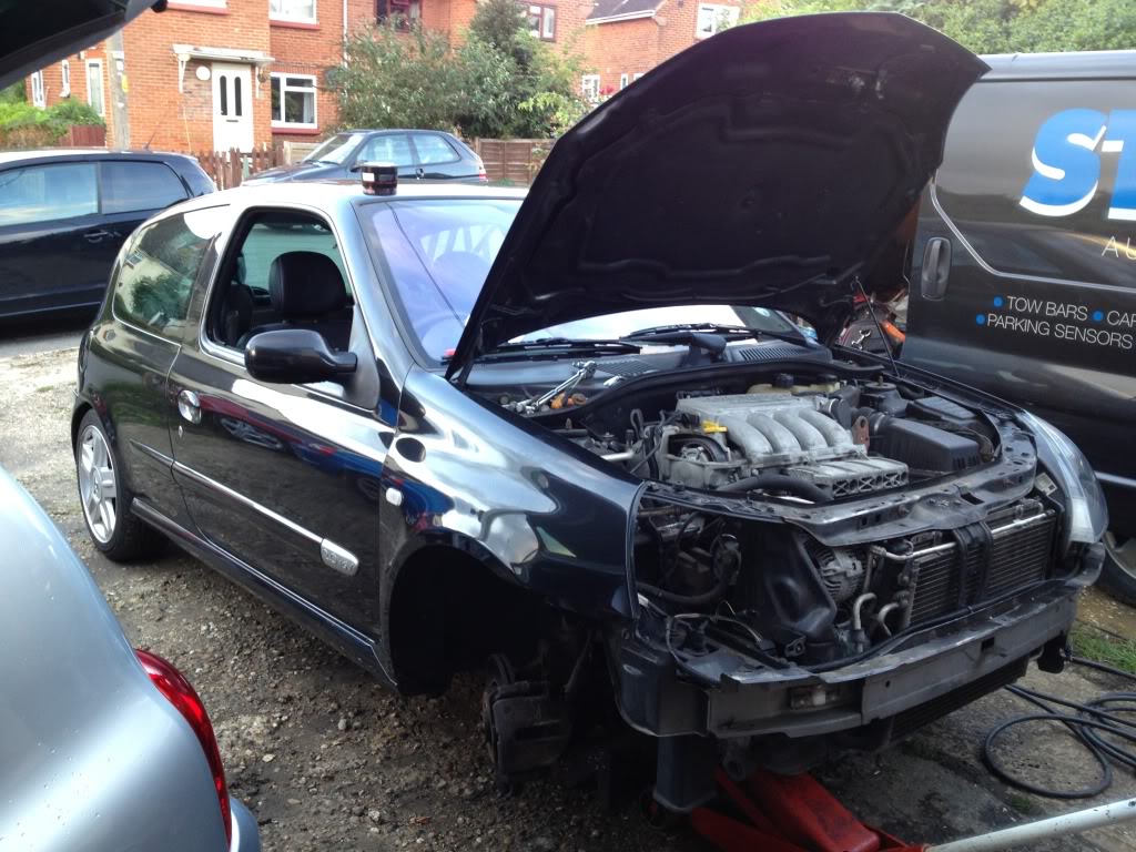

Another day, Loads more progress.

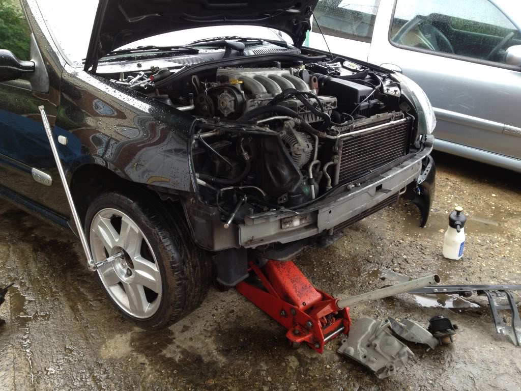

Cambelt kit arrived (Gates belt) so stripped the car tonight to get it fitted.

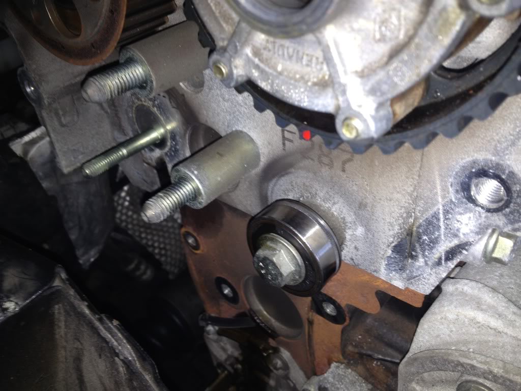

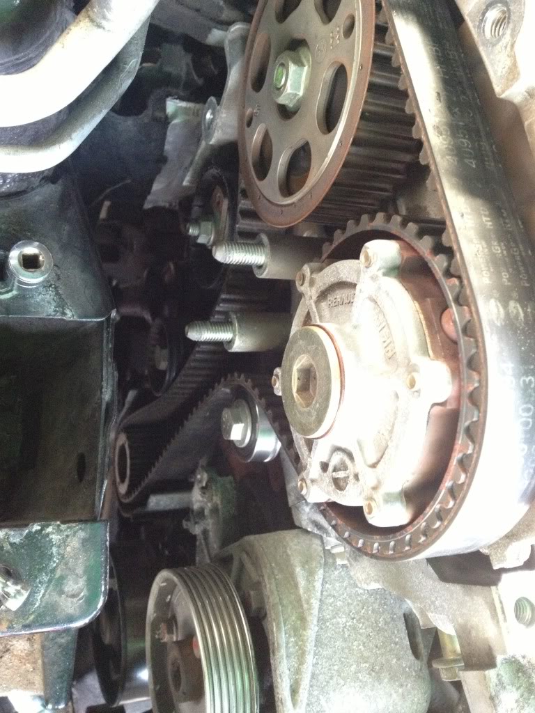

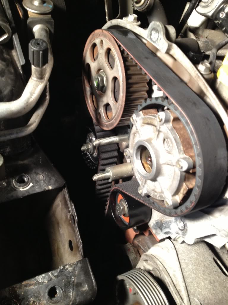

Removed the top belt cover and was greated by this...
For those that don't know, that is one of two cambelt idlers, the plastic you can see has broken off. Bloody extreamly lucky it hasnt done the belt, and most likey where some of the noise is coming from, and the reason for the belt being so slack! It was a genuine Renault belt and there wasn't any real signs of it being apart before, so its either managed 95k on the same belt, or it was changed a few years ago, however the belt was in quite bad shape. As per the Silver 172 I did before, this highlights why its important to do it at the right interval!

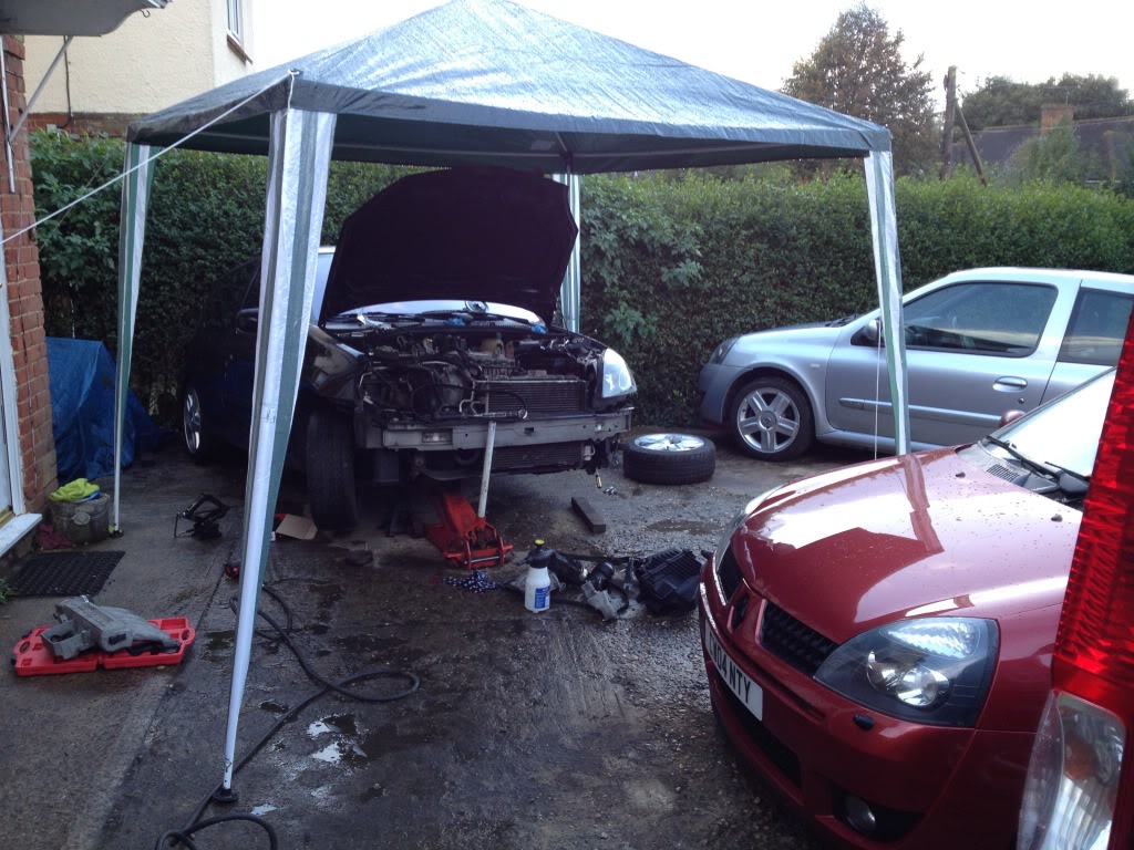

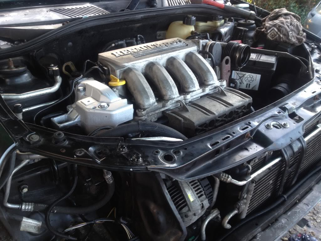

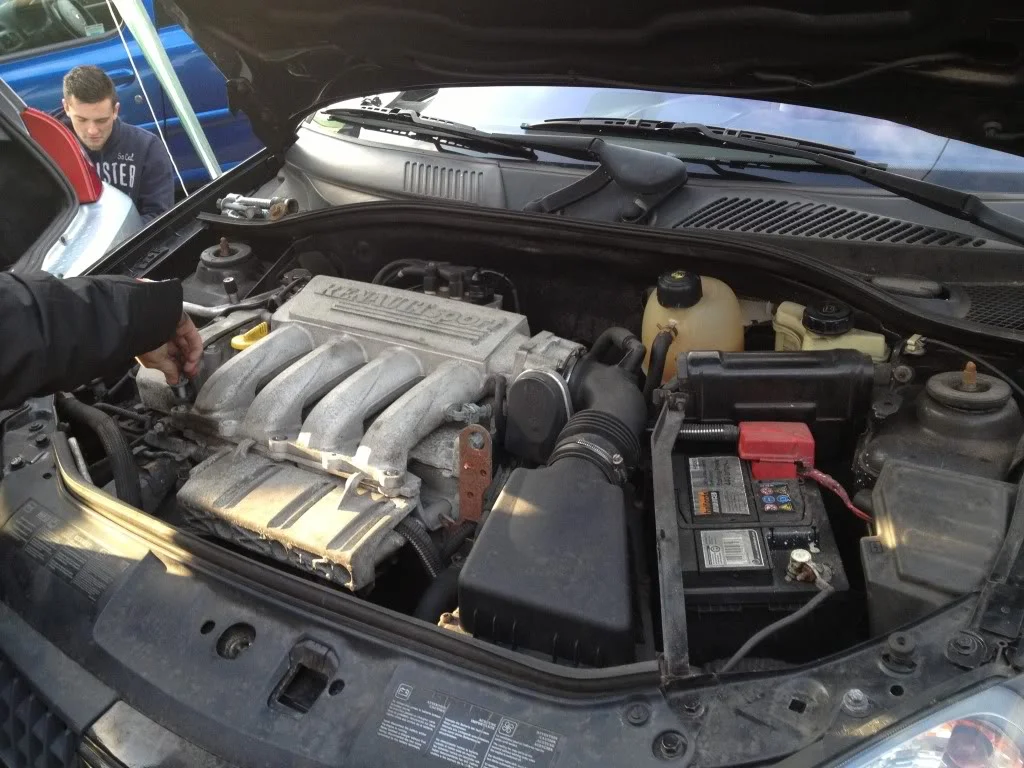

Got the rest off...
Renaultsport Driveway, in luxury non rain mode.

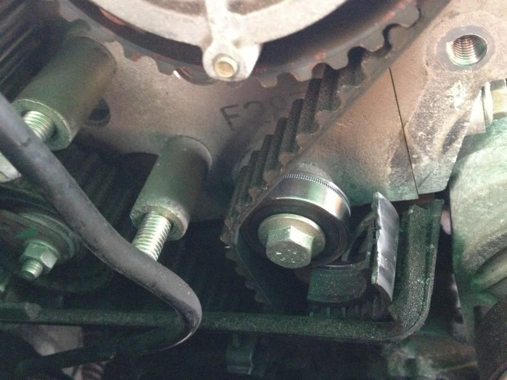

Mostly removed, Ruined idler just after
New belt and dephaser

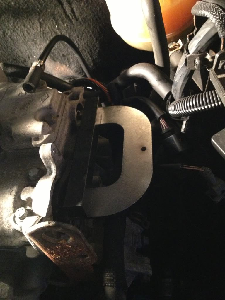

Fitted using proper cam tools (and proper cam pulley locking tools used to tighten pulleys!)

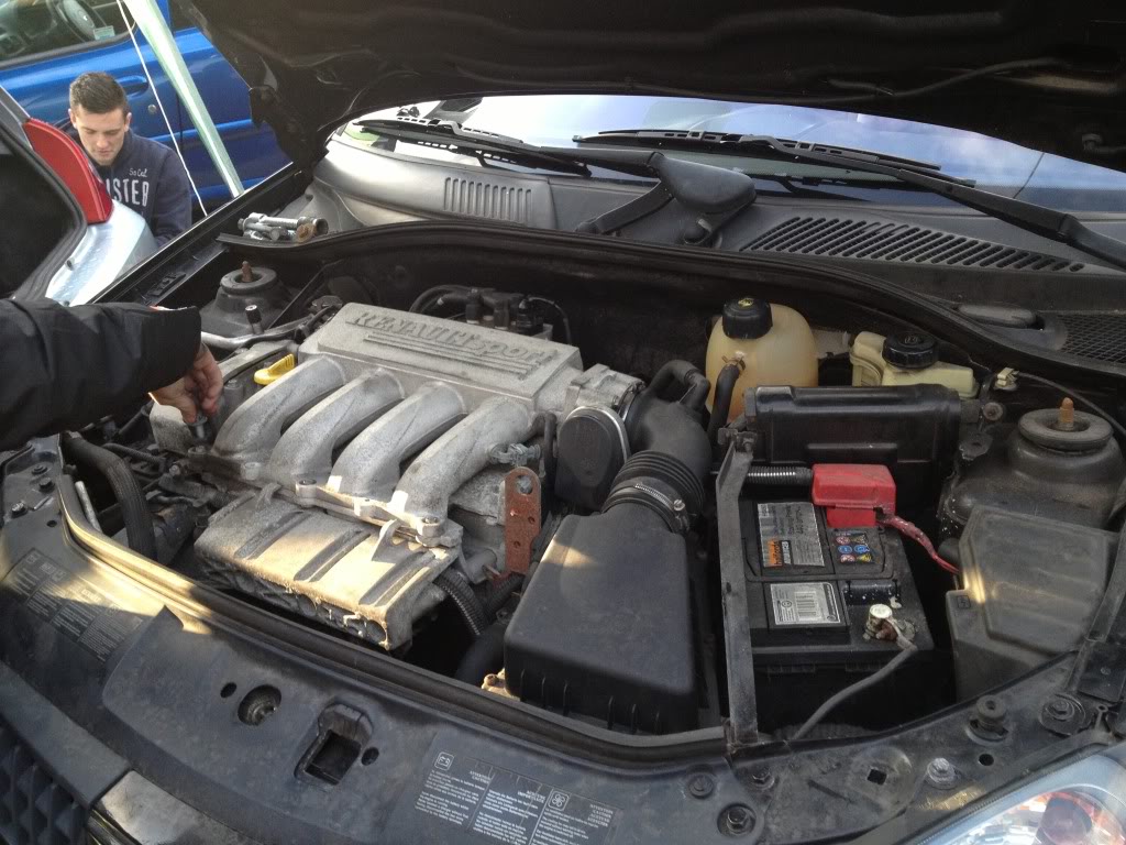

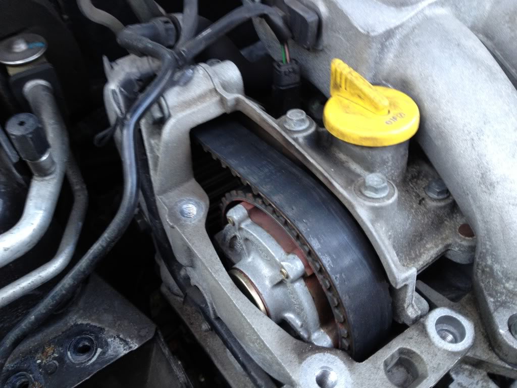

Then, the moment of truth (Cap left off dephaser as I wanted to check it all afterwards)

Liking the drive way. You was lucky with that idler mate!
Bloody lucky, the first thing I did when I picked the car up was start it and rev it quite hard, plus moving it around my drive etc, Could have snapped at any time, although I imagine if it was going to go, it would have gone on the previous owner who only really stopped using the car due to the noise!

Nice way to get oil onto your new belt. I would have also changed the oil before starting it with the new dephaser pulley.
  Many.
I actually loled at that. I cleaned up the oil, and none of it went onto at all. That is new oil, what came through is clearly what was just sat in the oilways etc. I'm not a f**king idiot.

Never seen a pulley like that before!
I've seen it before, normally on cars with snapped cambelts though!

f**k me, that tensioner won't last long like that!
I'm still surprised it lasted this long!

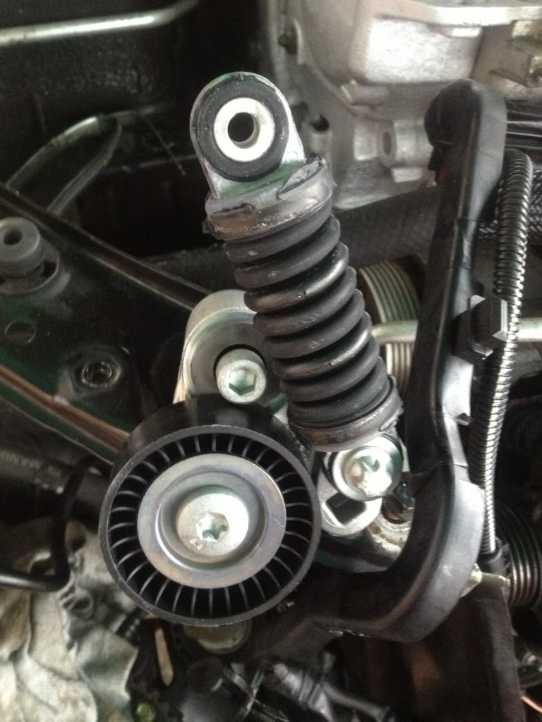

Aux belt kit, Forgot a pic of the full kit, but heres a tensioner... lol
Mostly back together...

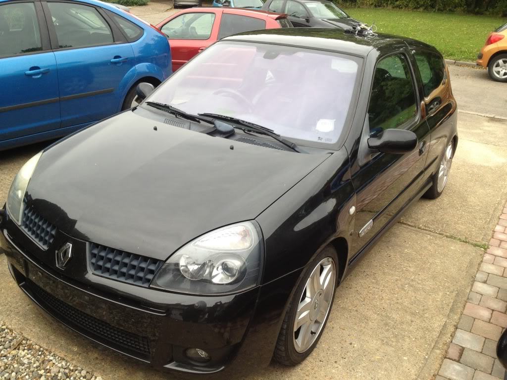

Then boom, All back together and running sweet
Taken it for a 100 yard test drive, seems good, freed off the rear brakes from being sat, Few more bits to do, but plan to book MOT ASAP.
