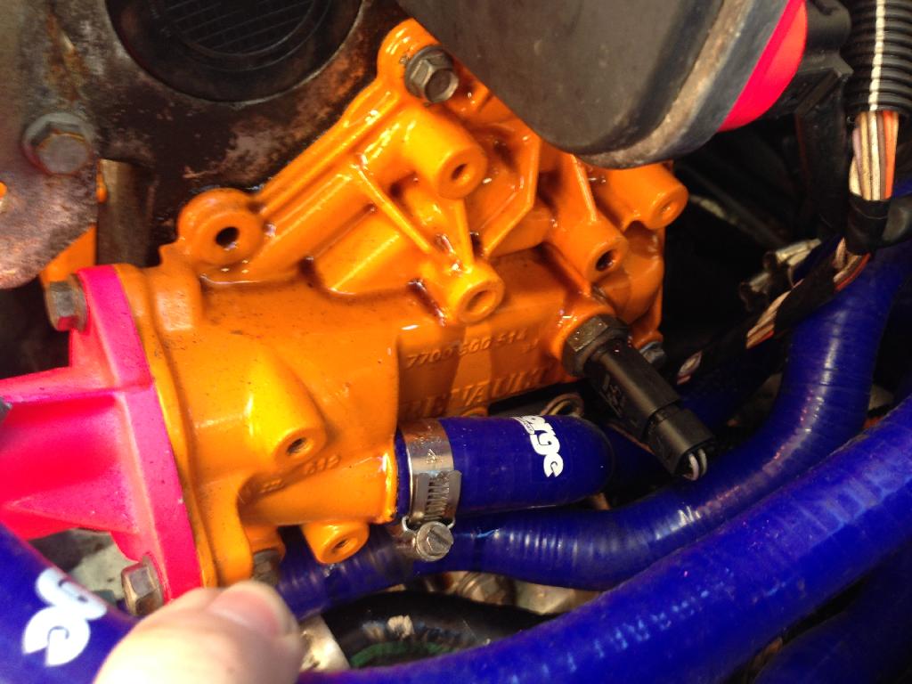

The car won't fire up still !

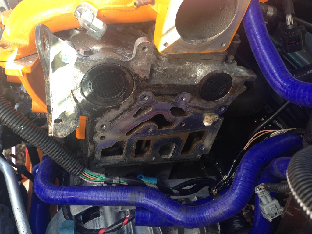

ive got a square with a zig zag on dash now but I've noticed engine oil is leaking out the side !
  dan's cast offs.
you've got loads of bolts missing from the stat housing, will be coming from behind that, think one of the bolts missing will give you an oil leak for a kick off.
  clio 172
Doh ! Will find the bolts for them in my box .
Was unsure if them holes were for fixing a bracket for loom or summit .
Hopefully its it's just that
  dan's cast offs.
top right has a bracket on it, middle front has a short bolt in, it's a bung for bleeding the cooling system.

You will see the housing with gasket and bolts and everything else on the right of the picture

pressed metal gasket behind the housing, this will be no use though if you don't have all the bolts in as one of the bolt holes goes through into an oil return (?) in the head and will piss oil out if the bolt isn't in.

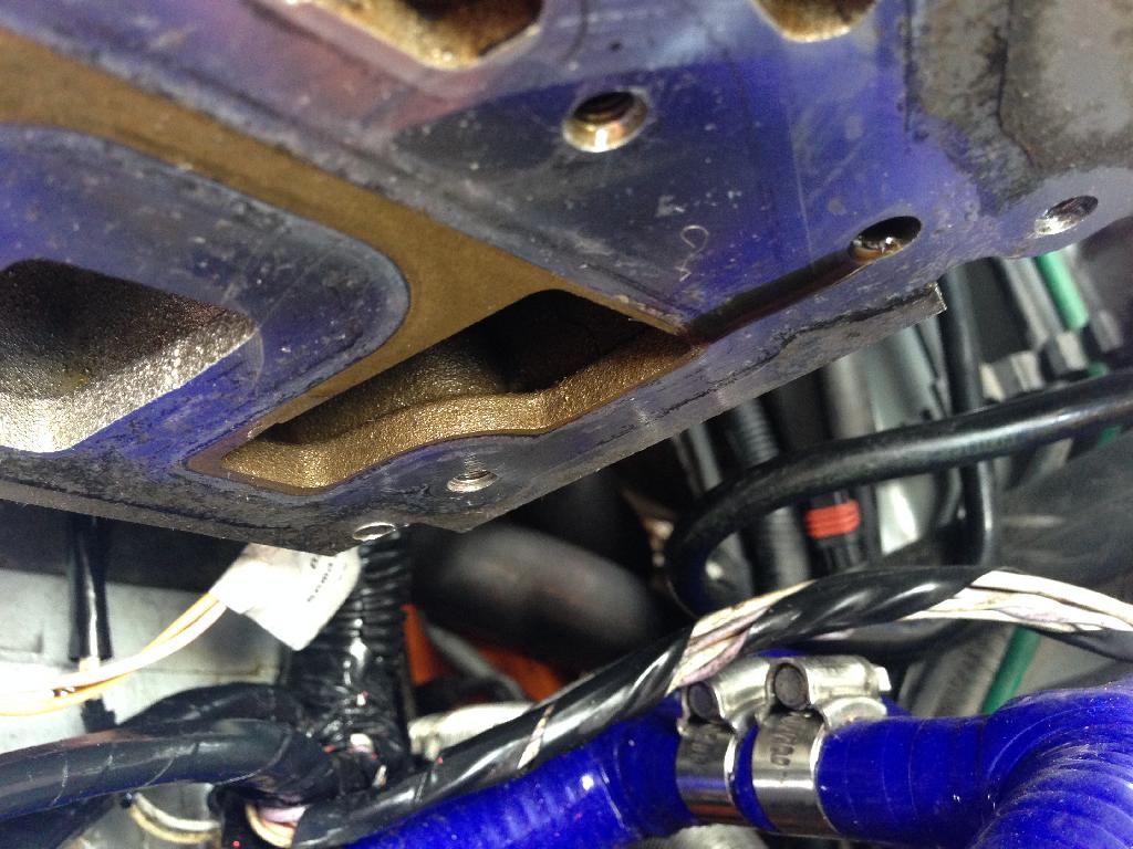

Got a gasket but it still seams to
be leaking down through thr gasket . There a little hole in the side of block where it seems to weep . Is this some form of oil return ?

Yes I had all the bolts in now buddy. Just doesn't seem to be sealing very well ! I may use some sealant too ?

Can see the oil , I've rebolted it all up with new gasket . Will see if it still leaks
I like yourself would be worried if oil was dripping out like that.
Surly something is not right inside that hole
