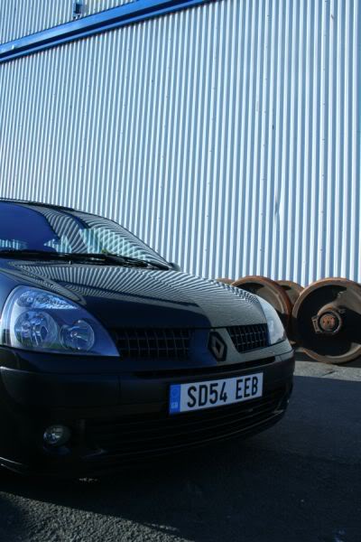

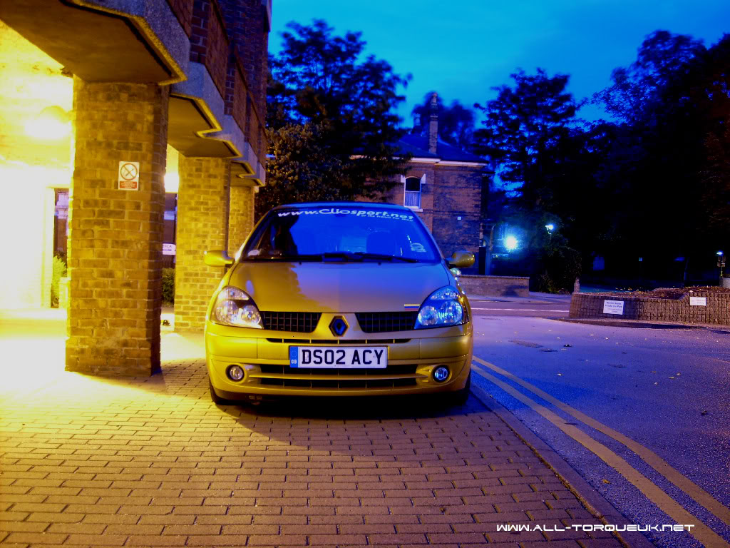

  M235i / 172
Thats mine.
  Static Low
Done mine last week.
Sanded down with wet & dry ermm 800 fine..
2 coats of primer and then 2 coats of paint & that was me.

Oh quick responses and photo's.
Both look great btw. :)
