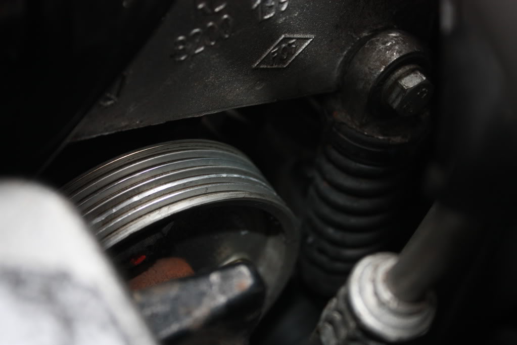

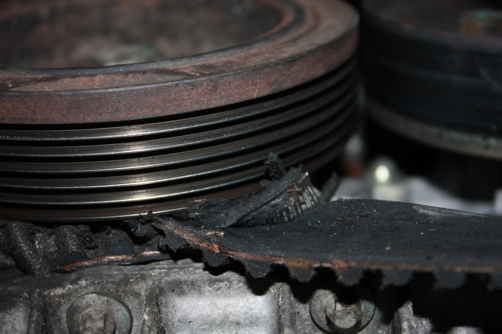

Hi guys, i broke down yesterday and upon opening the bonnet i noticed my belt had snapped,i believe this to be my auxiliary belt but i was wondering if i could have some confirmation on this and if so could it have c**ked anything else up. i have recently had the cam belt changed about a month ago and im hoping this hasn't effected anything on that side. I don't know much about cars so any advice would be great thanks.
clio 182
04 reg
photo from the top
photo taken from the bottom
  AB182, Audi A5 3.0
that's cam belt buddy, aux belt probably snapped and took out cam belt as well ( they do this). From he pics it doesn't look like the cam belt has snapped as such, but the aux belt may have caused tit to slip and thus bent valves ect. Hard to tell though from pics. If belts were only done a month ago, take it back as it should be under warranty.

Thats your cambelt hanging out in the last pic, aux belt snapped and gone inside the cambelt, engine is toast.
I see your aux belt kit wasn't changed at the same time, tensioner looks very old. Naughty naughty.

Aux belts, when they fail have a tendancy to take the cambelt with them, theres a fairly high chance thats fecked aswell.

Judging by the look of where the remains of the timing belt rests I'd say its smashed thru the plastic mid cover to... be sure that is replaced not glued. Its role is very important
