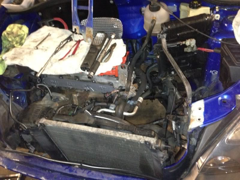

I'm following budgies guide to taking the box out the top.
I've got out everything listed pretty much apat from the driveshafts which I'll do in the morning and the starter motor bolts.
Where the hell are the 3 bolts holding the starter motor in place? I can't even see the dam thing!
Had my hand and camera down behind the manifold and can't seem to work out where the bloody bolts are
