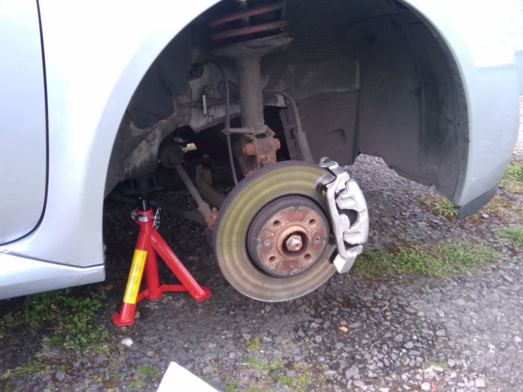

Well this is thursdays task.
Just wondered if spraying them will be better or will painting them with a brush be fine?
Are the calipers a pain to remove so that i can give them a proper paint or do most people just cover up the disc etc and take care with it?
Thanks
