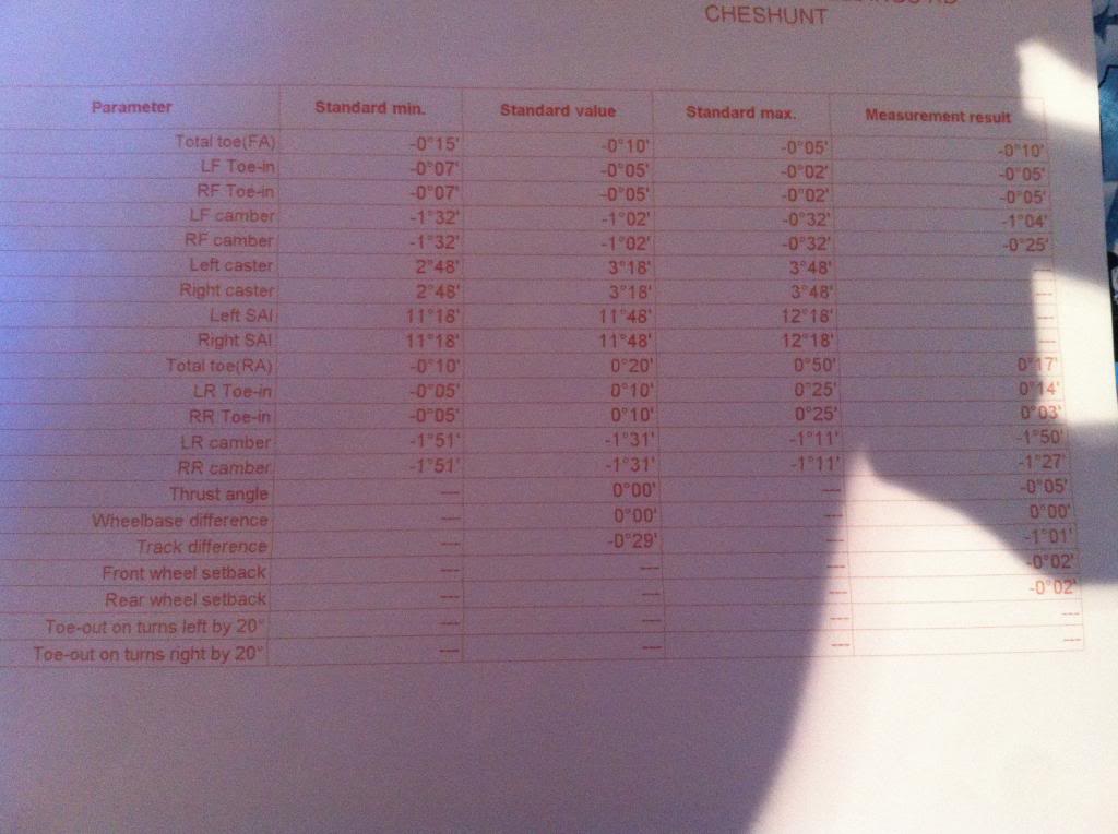

Today I went to get a 4 wheel alignment done on the 182 as it'd been 2 track days and 10,000 miles since the last one.
All seems well with the results according to the garage, but I can't help but feeling the camber is a bit far off? I'm assuming this is something the garage can't adjust, is this something I should be worried about, or that could significantly affect handling?
The car is a used for fast road and pretty much 1 track day a year. I also do a few motorway miles each month too. I can't say I've noticed much of a difference between one side and the other on turn in etc, but I hate the thought of my car being compromised.
Here's the printout:

Cheers Fred! Yeah I thought that about the printout, expected the one with the green and red bits. This was a new garage I gave a try, first time I've left an alignment place and the steering wheel actually be straight tbh
