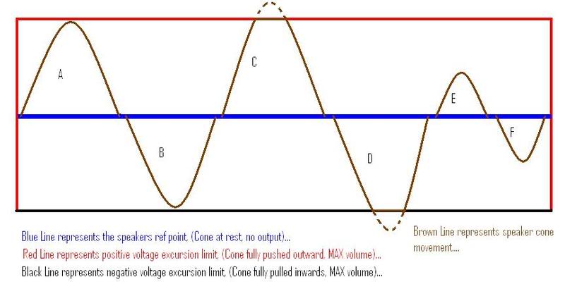

What's clipping and how can you detect it?
Amplifiers have 'gain' controls so the input signal voltage can be adjusted to permit the amp to achieve full output power, if the gain is set too low, then the amp won't achieve full output, if the gain is set too high, then the amp will reach full output too soon & signal 'clipping' will occur....
The RMS voltage of a 'clipped' signal is much higher than that of an 'unclipped' signal, so heat generated from a 'clipped' signal is much greater than that of an 'unclipped' signal.....Essentially, 'clipping' = BAD NEWS....
A 'clipped' signal can be heard as distortion, basically as the speaker cone reaches full excursion, (max power), it simply stops and sits at full power for the extended time spent at full voltage, (extended duration at the peak of the wave form), whilst the cone is stationary heat build up in the coils is greatly increased, (in basic terms, the coil acts in a similar fashion to a heater element)....
This would be easier to explain using a sketch.....You should at first realise that a speaker receives voltage through both the negative & positive terminals, positive voltage pushes the cone outward, negative voltage pulls the cone inward....an amplifier has two voltage rails, ones positive, ones negative....once the max output voltage of these rails is achieved, then clipping will occur, (no increase in volume can be had once an amp is clipping although RMS voltage will increase).....
KEY;
Trace A & B = Amplifier running at full volume, (GAIN SET CORRECTLY)
Trace C & D = Amplifier running 'clipped', (GAIN SET TOO HIGH)...
Trace E & F = Amplifier running below full output, (GAIN SET TOO LOW)...
If you check the peaks of TRACES C & D you will see the time or duration spent at full voltage is much greater, (the wave form is squared off or 'clipped'), this is where the heat generated is at its greatest.....
