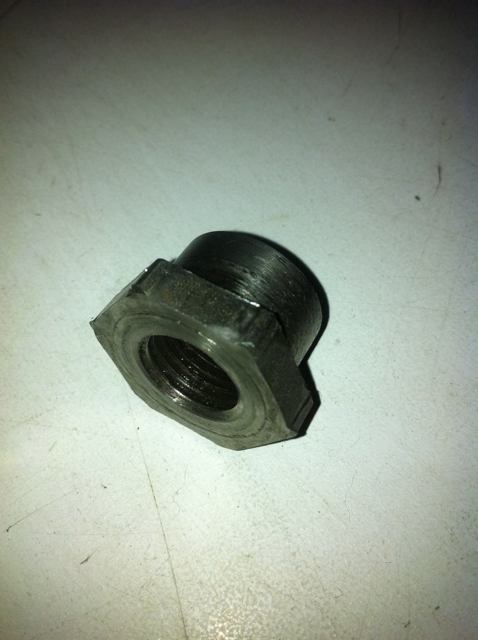

So there's no nut underneath on this, after searching threads and looking at pics etc I'm thinking that it's just the wrong nuts and they're too big, so I'm after some shallower nuts but haven't got a clue what I need with regards thread pattern, and also should they be 21mm 'cos mine are 22mm.
Appreciate any help guys.
  182 Cup
I have just had an email back from ktec with regards this issue and Sean has informed me that the nut was revised a while ago and is now 4mm shallower and he is going to send me some, thanks Sean, as always brilliant help/service from ktec.
