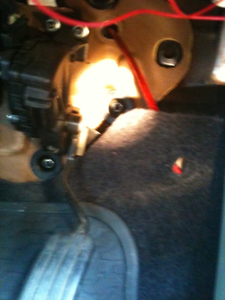

I'll take a pic tomorrow for you weather permitting, I mean go through the gromet above the clutch pedal then pull the wire into the engine bay then send the wire around the engine bay and use clips at the top of the firewall (underneath the trim)
  Ph 1 172
Pair of pliers pull the bonnet release cable grommiy back Fred power cable through
Remove colant bottle so you can get to the bulk head.
Little hint if you tie a bit of nylon string to the end of the power cable and feed that through first you can use that to pull the power cable through.

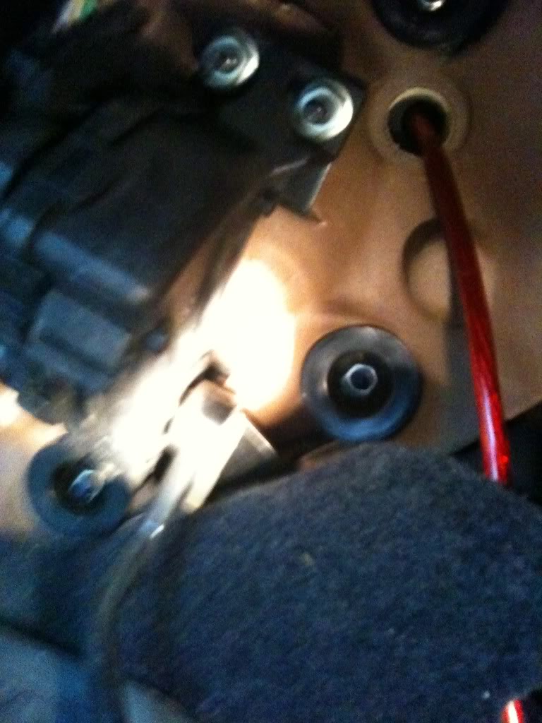

So am I better off going through the hole above the clutch then? I am guessing its not the same hole used for the clutch cable, that would cause problems right?
The bonnet release cable grommet looks huge and has a pipe on 1 end and what looks like duct tape on the other side that has melted. I am 90% sure im looking in the right place, it would be at the top right (battery side) of the car running down near the windscreen wash bottle?
Is the bonnet release cable actually behind the lever in the car? I found a single cable just further up behind the dash that goes through a metal hole with no grommet which I assumed is the release cable.

You have to take the black bung out first :)

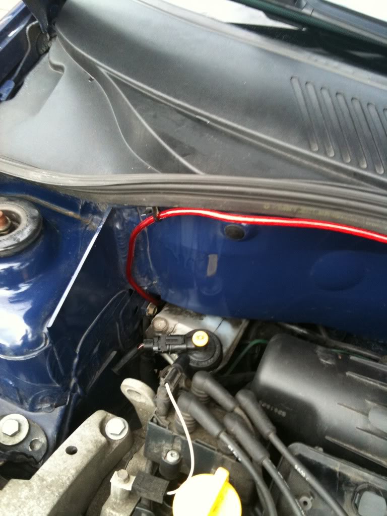

Ah right, that looks a lot easier. I am assuming I just remove that black plug (circled below), or is it that other cable just above it? Is it a clear route through to the engine bay and comes out near the brake fluid container like your other picture shows?
Looks pretty simple if that's the case.
EDIT:
Actually ignore above, it has to be that red cable above where I circled in the picture above. It's a clear route through to the engine bay or is a bit fiddly to get it through?

its pretty easy its much easier to go from inside to engine bay, but it is very easy, although hanging it around your engine bay firewall is slightly harder, I used photo frame clips :)

Hate to triple post but I managed to get this done!
I found the rubber grommet on the inside of the engine bay where the bonnet release goes through and poked the grommet out with a screwdriver, then the cable went through easily. Only problem is I now have no rubber grommet on there and the edge of the hole in the firewall is rather sharp, but I will try putting a different grommet on it today.
