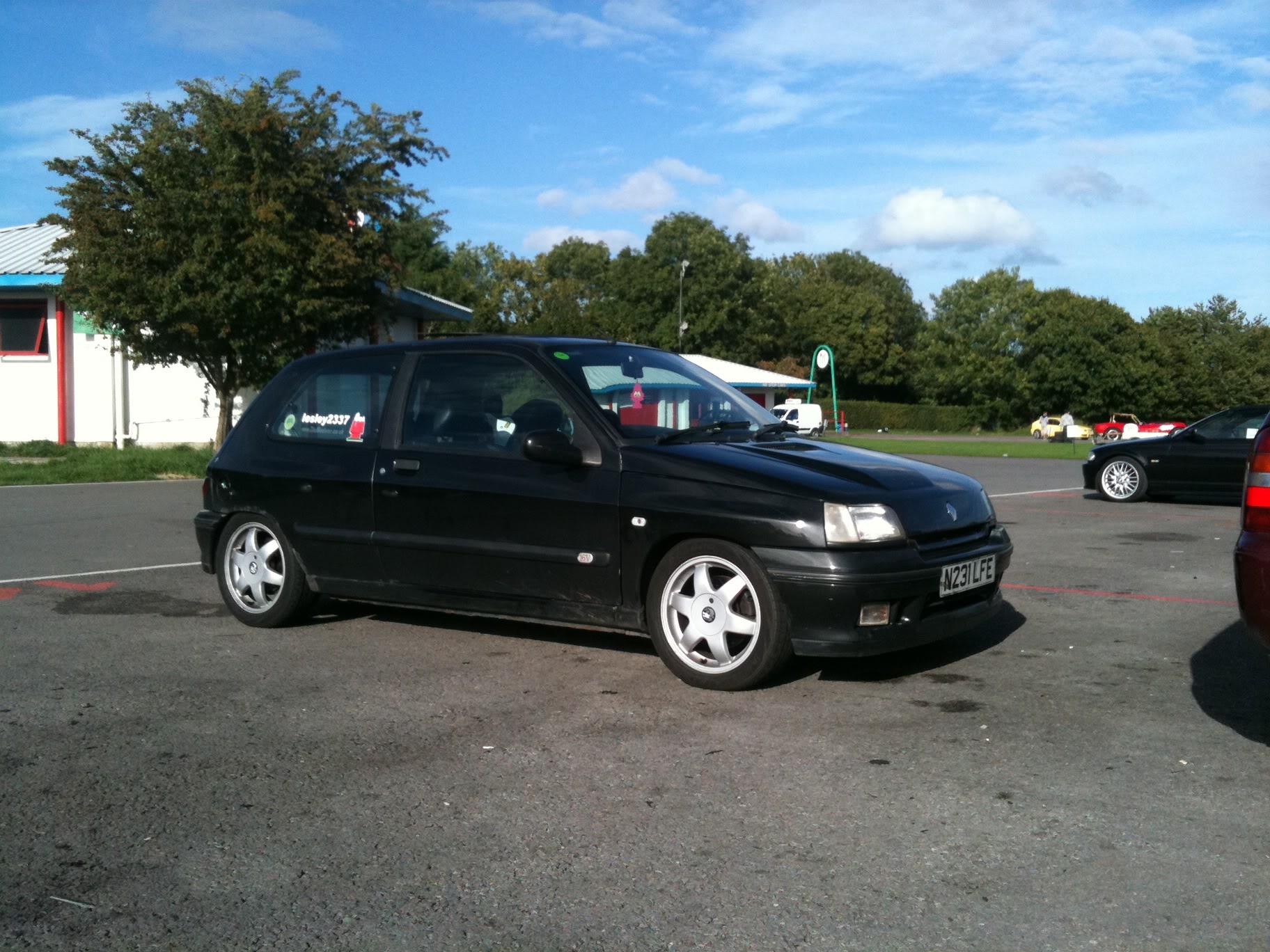

I made up some adaptors to fit vauxhall cesaro wheels to my mrs mk1 clio that she used to have:
Those were 49mm offset though, are you sure your mates are 40mm? What age of corsa is it? Do you have a picture?
  182/RS2/ Turbo/Mk1
Yeah it looked really well ollie, suited it far better than on her 172, they look a bit lost on that.
Yes Daniel she is.

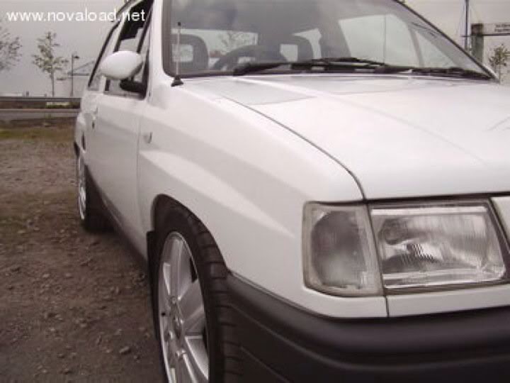

This was my nova back in the days (10years ago) with Megane alloys they fitted perfect, nova was ET49 & I'm 99% sure so are the Megane wheels so you should be fine, dependant on the bore size.
Yes Daniel she is.
Im used to looking at novas a lot after six years working for total vauxhall mag. That looks a lot lower offset than 49mm!
