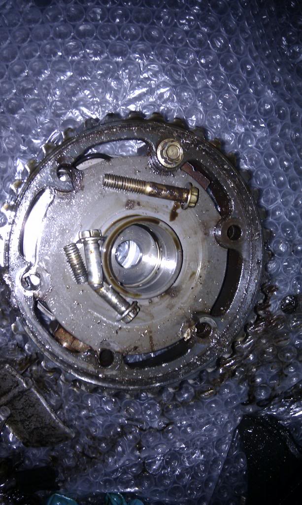

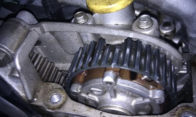

Valve to piston contact if the dephaser completley collapses......but i have heard them tap on for years!!!!
It can't collape! it just moves from stop to stop. The only one I've seen break has the oil seal torqued to a mind blowing tightness which cracked the housing and it went bang under load
  DON'T SEND ME PM'S!!
  Clio Sport 172 Ph2
Dan.... i know they go from stop to stop ive had em apart & the Mazda 6 VVT, similar thing.... but the pics you show there..... that could, cause damage... just sheer luck if it didnt on the one you had. And as for the centre cap with oil seal......its only nipped to 25Nm's!!
