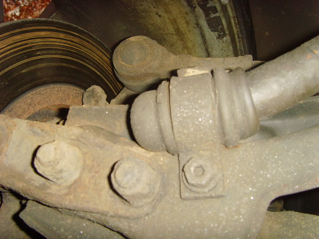

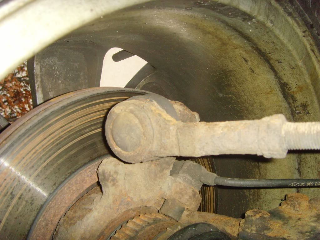

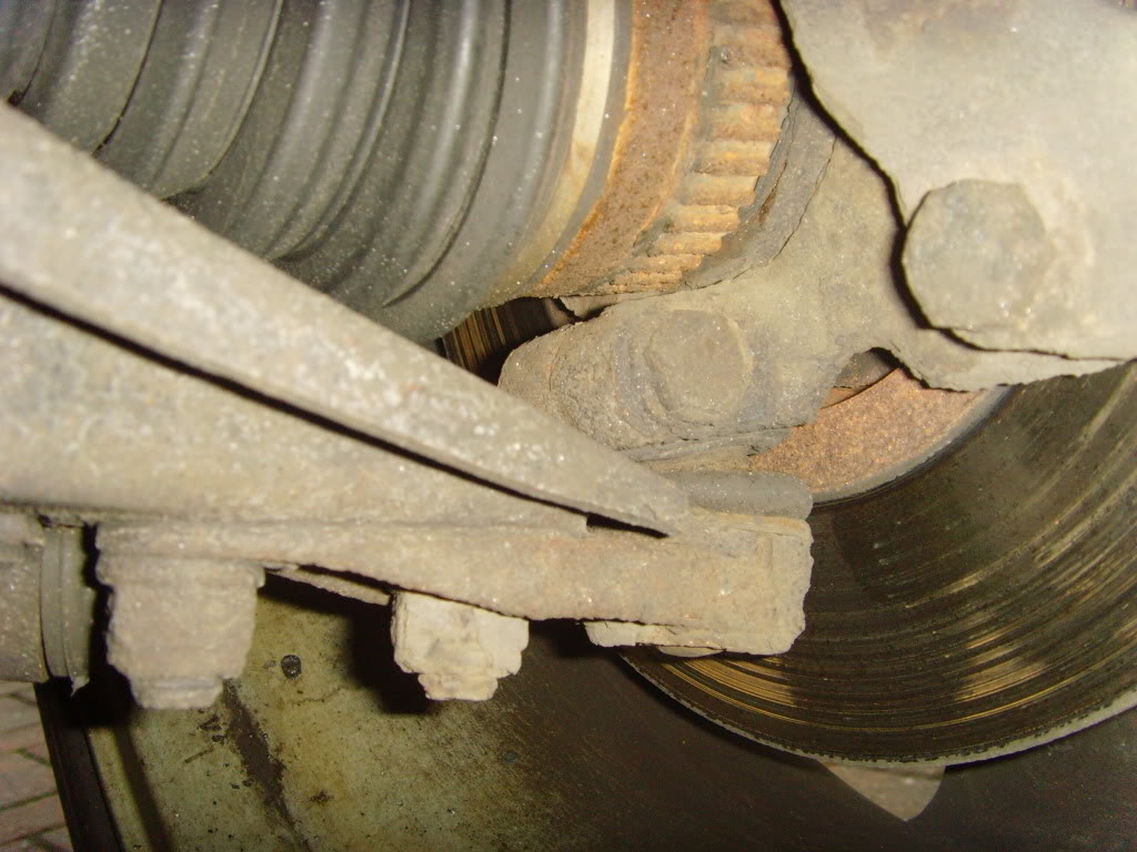

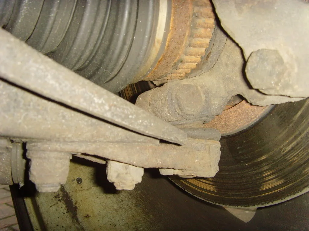

Ive put the top mount washers on and they havent done anything, ive looked at the ARB bushes and they look pretty good, ive got a feeling that its the CV joints on both sides! Anyways ive got some poor pictures and videos if that helps!
Now i dont know if these videos will be of any use but il upload them anyways the first one is putting some pressure on the bottom of the wheel and turning it and the second is wiggling the drive shaft and there is some play in the CV joint:
