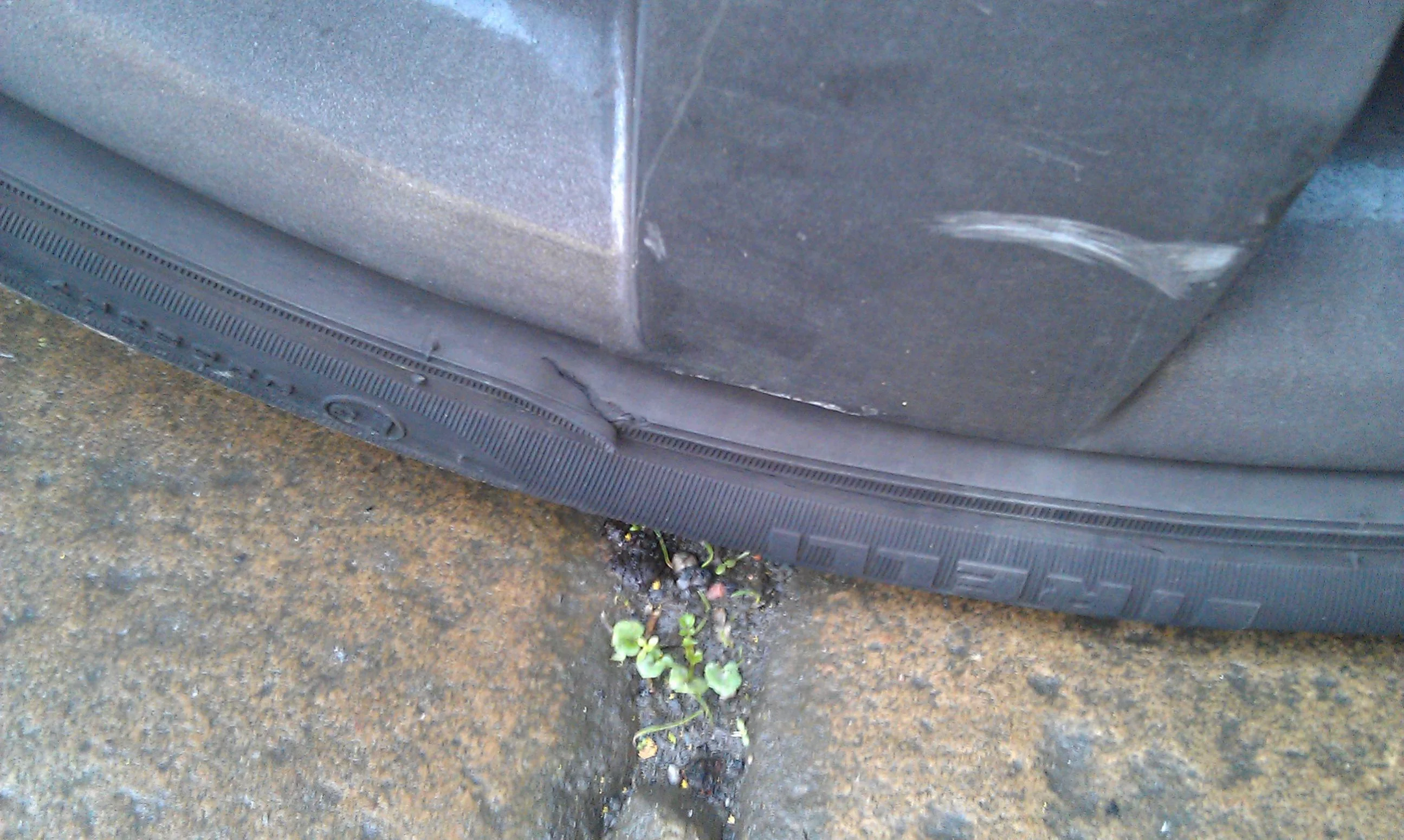

Got to work today to find a inch long gash in the tyre wall of the front left; IMAG0401.jpg
The fronts are Pirelli PZero, and the rears are Yoko A539.
Should I swap the tyre like for like? Would there be any implications on handling etc if I were to put a Pilot Exalto on as a replacement?

As said, advice will be to replace in pairs but nothing to stop you just replacing that one.

Think I'm going to buy some Uniroyal Rainsports, look like a good choice for this time of year. Any opinions on driving with the tyre in it's current state? They will be changed asap, ordered from Camskill today, but in the mean time what would people do?

It should be fine, just take it easy. But you're doing the right thing changing it.
I've seen far worse come into work and its been like that ages because they don't want to get rid of it whilst it has useable tread.

It shouldn't get any worse. I would imagine you have just caught a curb or similar and as long as it hasnt gone down to the canvas it should be ok. But peace of mind by changing is a good move. I never change one tyre always a pair. Makes me cringe to see different tyres on the same axle. I have know people with 2 well worn tyres get a puncture in one and put a brand new one in its place leaving the other as it is.

You've created a weak spot in the strength and structure of the sidewall. As such it is far more likely to 'fail' if you load it up.
Don't stress it and you should be OK until it's changed.
