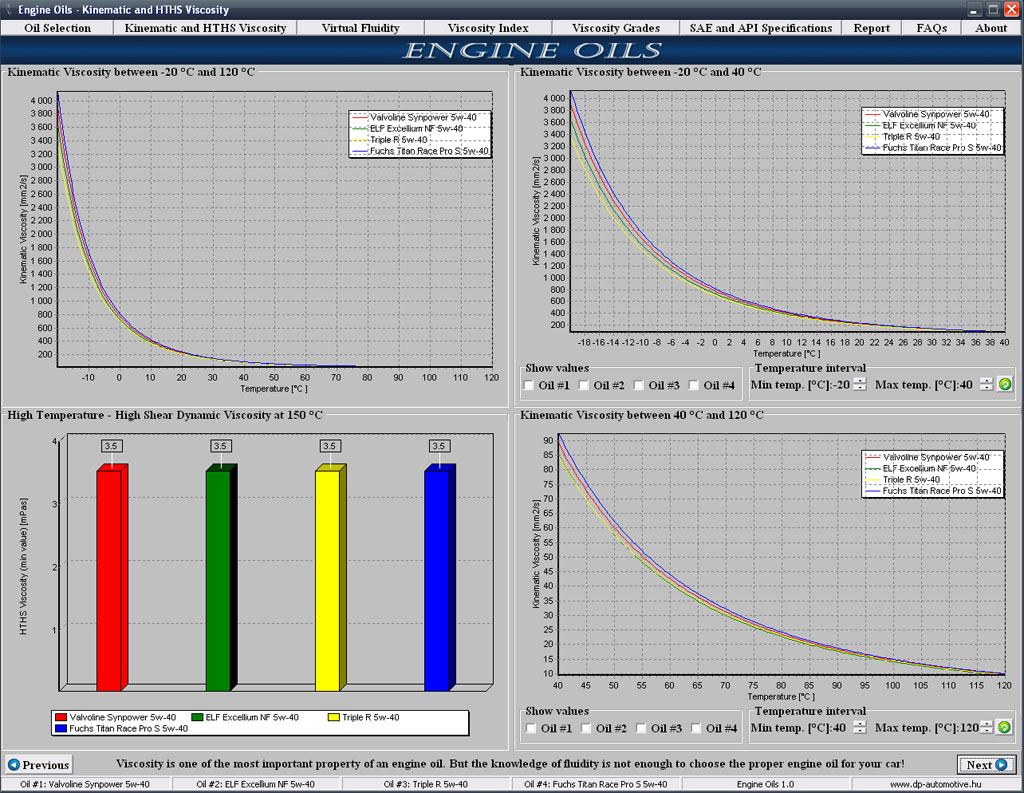

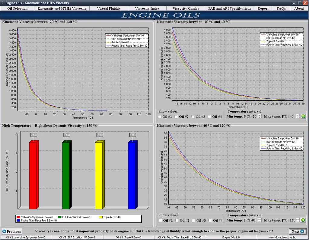

Here is the kinematic viscosity diagrams of the followings oils: Valvoline Synpower 5w-40, Elf Excellium NF 5w-40, Triple R 5w-40, Fuchs Titan Race Pro S 5w-40:
Unfortunately HTHS viscosity values are not included in the 4 oils' datasheets therefore the lowest HTHS values which match SAE J300 are represented in the chart.
