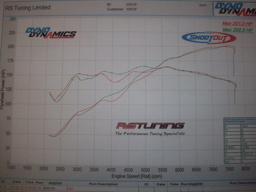

what size are these TB's chip? wondering weather to put my OEM TB back on now as like i said the 64mm version has never fully settled,problem being my car has been mapped with the 64mm TB on so will it be better to stick with it?
here's my graph after fitting the 64mm TB and Y pipe decat,as you can see i've lost a touch of power between 6250rpm and 7250rpm but gained a fair bit of torque + bhp mid range and the car feels better now,i know you say the enlarged TB's doesn't work but can a Y pipe make that much difference mid range? any help is much appreciated...cheers
