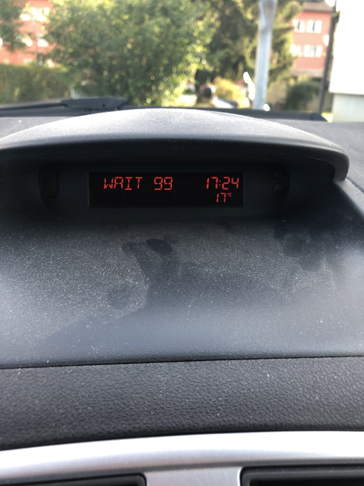

  Renault Clio 1.2 TCe
Error Code by Clio 1.2
its coming number 99 intel 38 and back again form beginning!!! please i need help
