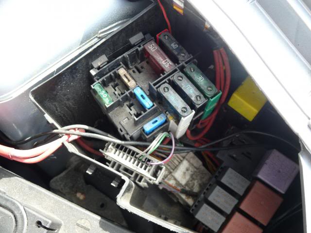

Car was in at Renault and they couldnt find anything wrong with my car, they said they flushed the ECU of faults and checked some things then gave me the car back. This had already been done by a local garage so I knew this wouldnt fix the problem even tho I took the car back and gave them the benefit of the doubt as surely they wouldnt give me car back that would cut out again :)o) I took the car for a spin and it never happened (but it doesnt always happen, its an intermitent fault) When I got back from the run I checked over the engine and within 30 seconds of looking I found the below wires had rubbed against each other causing the core of each wire to be exposed and they were touching each other :confused:
http://www.btinternet.com/~paulj.ewing/wirestwo.jpghttp://www.btinternet.com/~paulj.ewing/wirestwo.jpg
I have wrapped them up and cable tied them away from each other. Can anyone tell me if these wires touching would cause this fuse to blow:
http://www.btinternet.com/~paulj.ewing/fuse.jpg
Does anyone know what that white thing the pink wires goes into, you cant see it in the pic but there is a green thing (very technical i know) attached the white plastic thing.:D
Wires touching can very often be the reasing for shorting.
Shame Renault didnt spot it.
Id tape up all potentail wiring like that There always room for them to touch and short otherwise.
Those fuses in the box are for thengine relays I think so they all important.
The fuse circled above has blown again in my brothers Cup, once replaced it works fine.
Is there anyone out there that knows what the fuse is used for? We need to have a rough idea of what is causing it to blow.
Cheers
that fuse is most likely for the injection locking relay. it is one of the small black relays you can see in the bottem right hand side of your pic. will have to check on the diagram at work to be more exact than that.

Its just i have that problem, the small fuse blowing and cutting engine. 30 amp near the relays. Wondered if anyone has seen this before and why it could happen??
