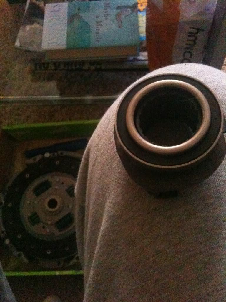

got my kit through now, and the first thing i checked was the bearing.
Now it looks totally different to that one pictured above as you can see in the pic below:
is that the correct one? im guessing iv got the wrong kit now tbh...
  Astra 1.9Cdti SRi
ye it has fred,

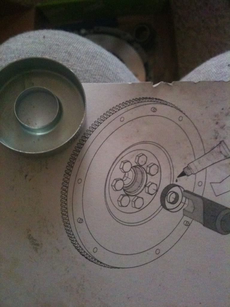

Is that were the clutch fork sits in ye? also got like this cup type thing, thats suppose to go into the flywheel :s,
  Astra 1.9Cdti SRi
There you go..
no idea what its for tho, or wether il need to remove the old cup from inside the flywheel
